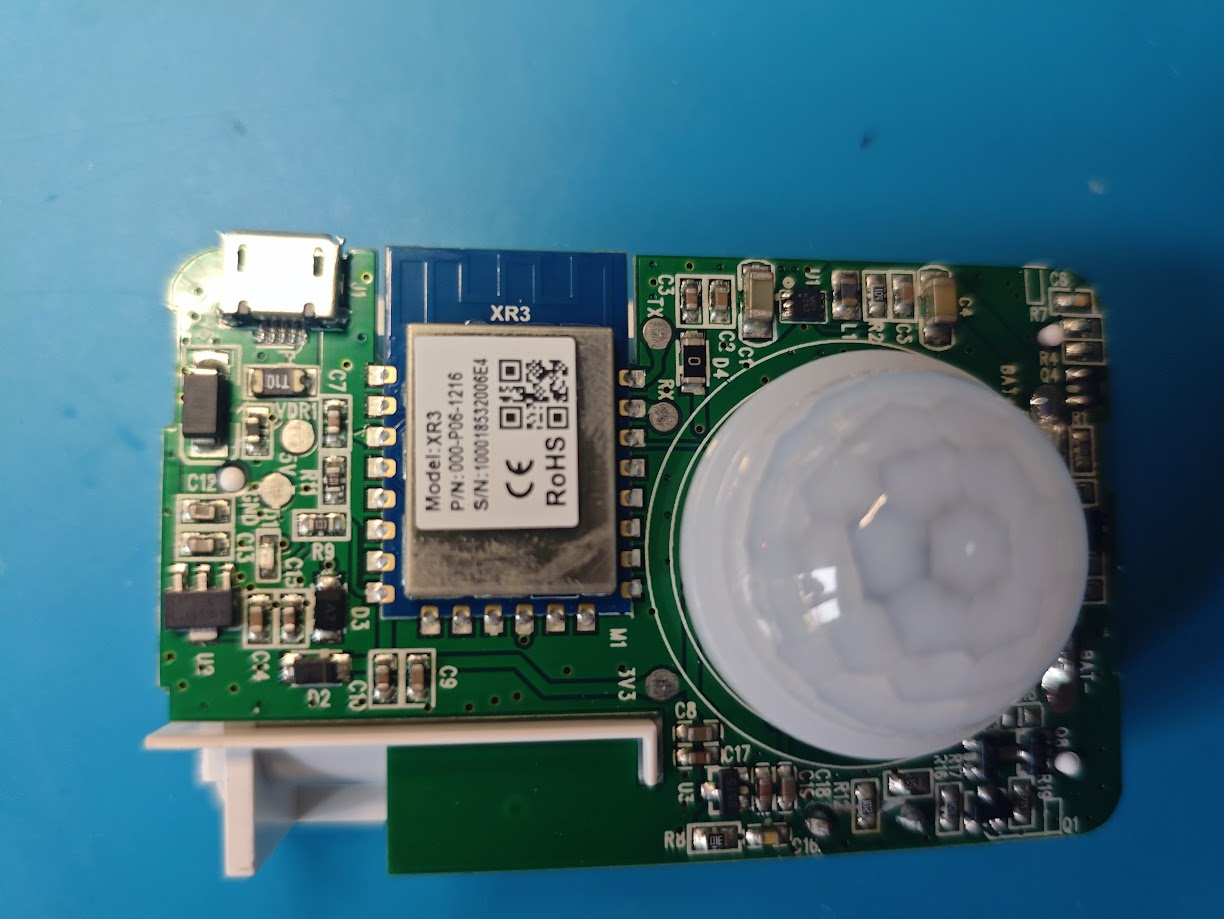

Can this XR3 P06 PIR sensor be flashed over OTA?
No, XR3 devices do not have OTA flashing support yet, so this P06 cannot be updated over OTA at the moment [#21088959] You will need to flash it by soldering to the board; only a basic soldering iron and solder are required [#21088959] There is an XR3/XR809 flashing guide on the forum if you want to try it [#21089108] The maintainer also noted that XR809 OTA is still not working and may be a challenge, with HTTP OTA attempts failing so far [#21131093][#21131128]
  • #1 21088914
    sumitnz
    User manual for WiFi motion sensor, model P06. Close-up of an electronic module labeled Model: XR3 on a green circuit board. XR3 PIR sensor with visible circuitry and USB connection.
    Is this xr3 pir sensor p06 model FLASHABLE over OTA?
  • #2 21088959
    Posts: 14756
    Rate: 12881
    We don't have OTA for XR3 platform yet, unfortunatelly. XR3 devices are very rare these days. I've only ever got like 3 of them and 2 of them were ordered on purpose (already knowing it's XR3).
    I'm afraid that you will need to do some soldering. Do you have equipment to do that? Only basic soldering iron and solder with solder paste is required.
  • #3 21088961
    sumitnz
    Yes I have soldering iron and solder.
  • #4 21089108
    Posts: 14756
    Rate: 12881
    You can give it a go. We have XR3/XR809 flashing guide on forum. Still, you are one of a very few people to get this WiFi module type...

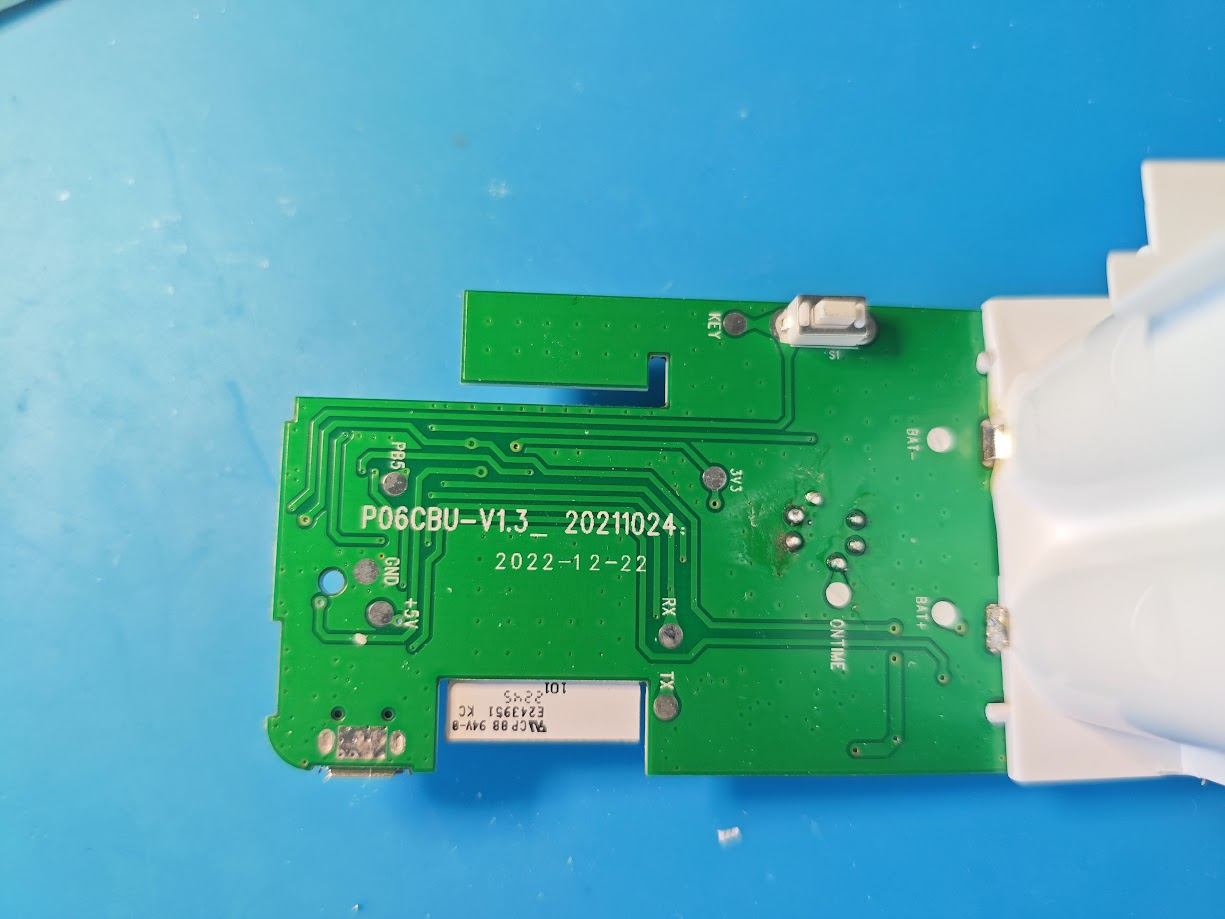

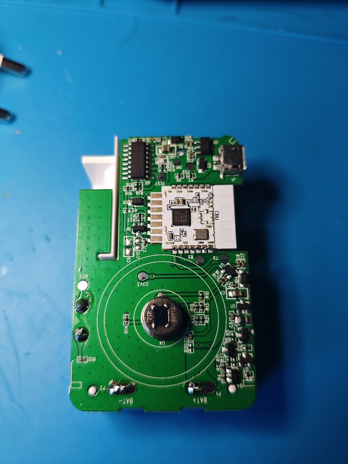

    @sumitnz do you have the link to exact page you bought this device please?
    I have a P06 but sadly it's CBU+TuyaMCU
  • #6 21121396
    Posts: 14756
    Rate: 12881
    How the main board look like? Is this a variation of P06 from first post or a totally new internals?
  • #7 21121405
    Posts: 5213
    Help: 446
    Rate: 914
    similar. but different.
    Close-up of a circuit board with electronic components on a blue background.
    Close-up of a green circuit board with markings P06CBU-V1.3 and date 2022-12-22 on a blue background.

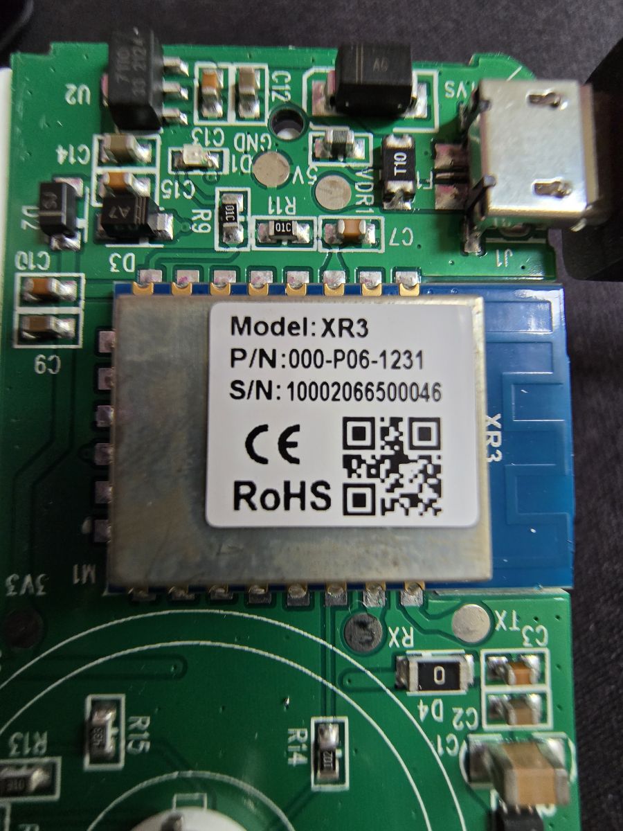

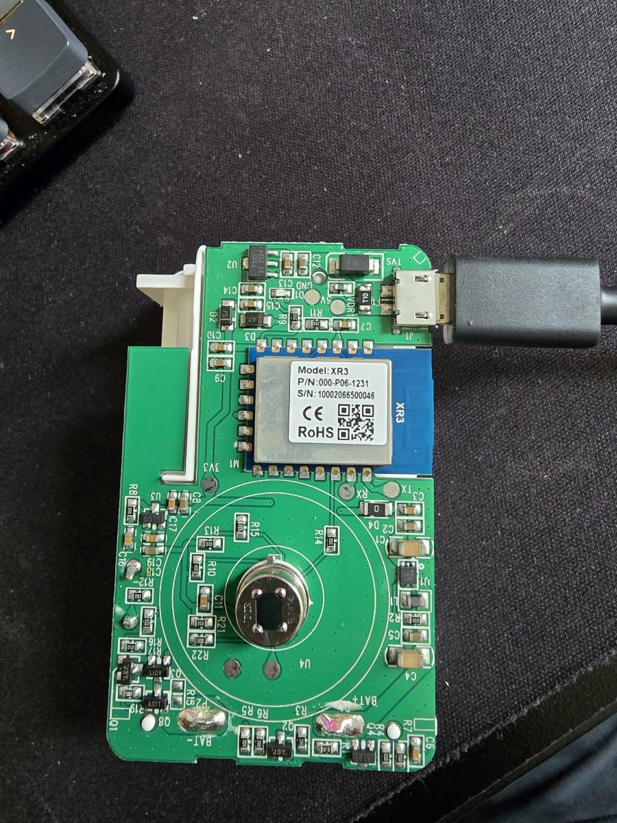

    That's a new XR3 device. I haven't seen it yet. Please make a separate teardown when you got a moment.
    EDIT: Ah, sorry, I must have mislooked. It's indeed the same piece as in the first post

    it's the same P06 variant in the OPs main post...

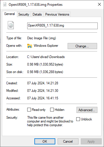

    won't XR809 build also need an OTA flash type file build?
    Properties window showing details of the OpenXR809 disk image file.
  • #20 21146326
    Posts: 14756
    Rate: 12881
    It is very probable that I was testing it locally, with OTA file building as well. Maybe OTA file is not yet included in the Github build artifacts because I have never got OTA working in the first place.

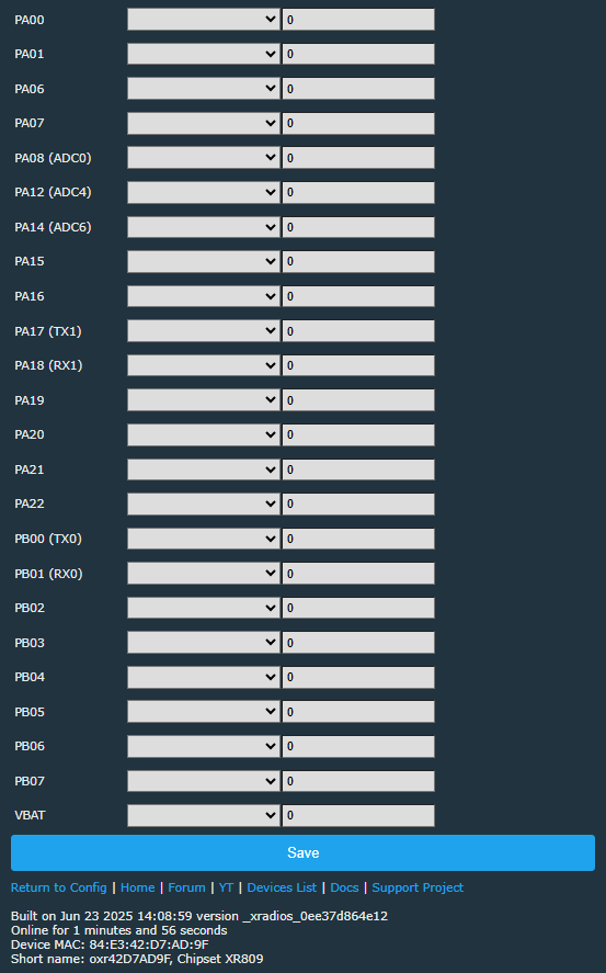

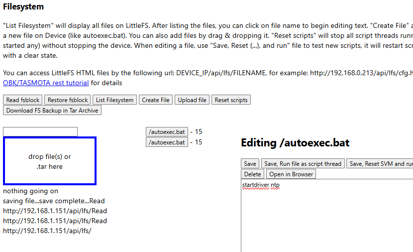

  • Xradios OTA flashing and feature update test
    #22 21587457
    Posts: 5213
    Help: 446
    Rate: 914
    insmod wrote:
    Xradios update test
    LFS for all, Easyflash for all, OTA for all (XR809 not working, XR872 no image generated yet), Pins for all, berry for XR806.
    Implemented PWM, ADC (including VBAT), UART, watchdog in APP, delay_us, RSSI and ip addresses, remaining heap size.
    Fixed MAC for XR806.
    https://github.com/NonPIayerCharacter/OpenBK7231T_App/actions/runs/15826444795
    XR809 _xradios_0ee37d864e12
    first boot after flash to erased XR3 + client joining AP
    pins
    XR3 PIR Sensor P06 Model OTA Flashing Capability?
    LFS
    I guess TCP Client is disconnected is not unique to XR872

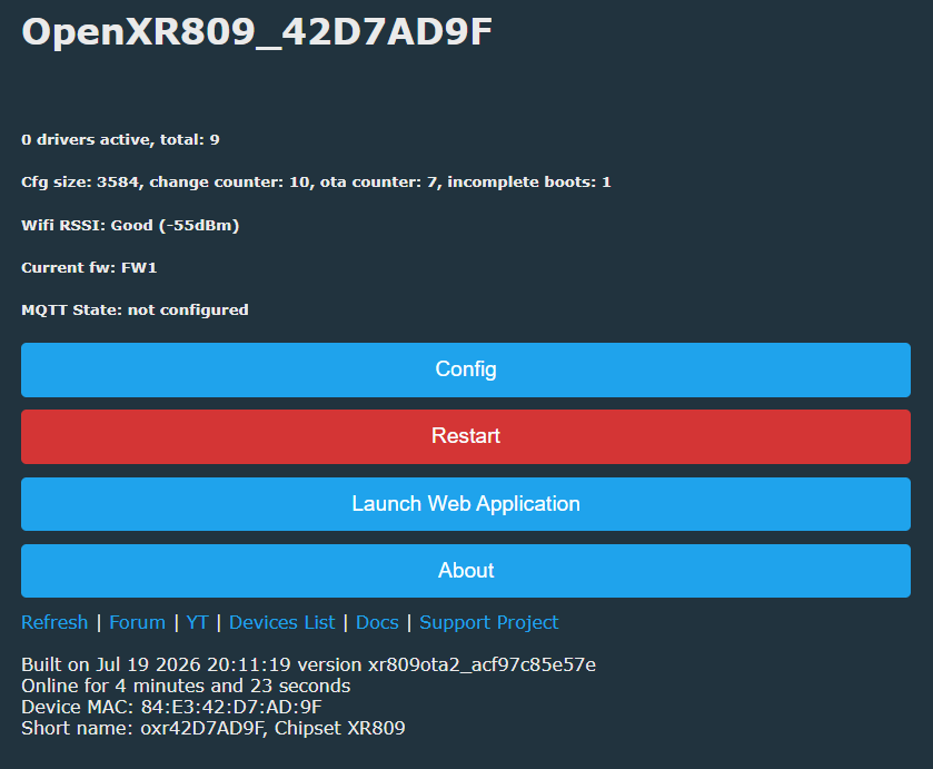

  • SRAM-resident libs enable XR809 OTA flashing
    #26 21941585
    Posts: 5213
    Help: 446
    Rate: 914
    Tuya keeps
    libxrsys
    and
    libchip
    code in SRAM (by linker omission) rather than XIP, which is unavailable during live erase/write. So if we do the same, OTA can be made to work.
    The measured cost is approximately 13.4 KiB of additional SRAM-resident code/constants:
    The final linker map reports:
    I am successfully ping-ponging between slots 0 and 1.
    Added FW0/FW1 active slot to OBK GUI like Realtek ping-pong type.
    https://github.com/openshwprojects/OpenBK7231...a87cb9587c927/src/httpserver/http_fns.c#L1048
    Screenshot of the OpenXR809 status page with system details and buttons: Config, Restart, Launch Web Application, About
    https://github.com/openshwprojects/OpenXR809/pull/11
    https://github.com/openshwprojects/OpenBK7231T_App/pull/2164
    REST and HTTP work
