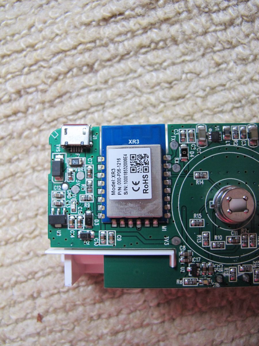

    Hi. I bought a P06 PIR device from Ali Express expecting it to contain an Allwinner/XRadioTech XR809-based XR3 module, and I wasn't disappointed.

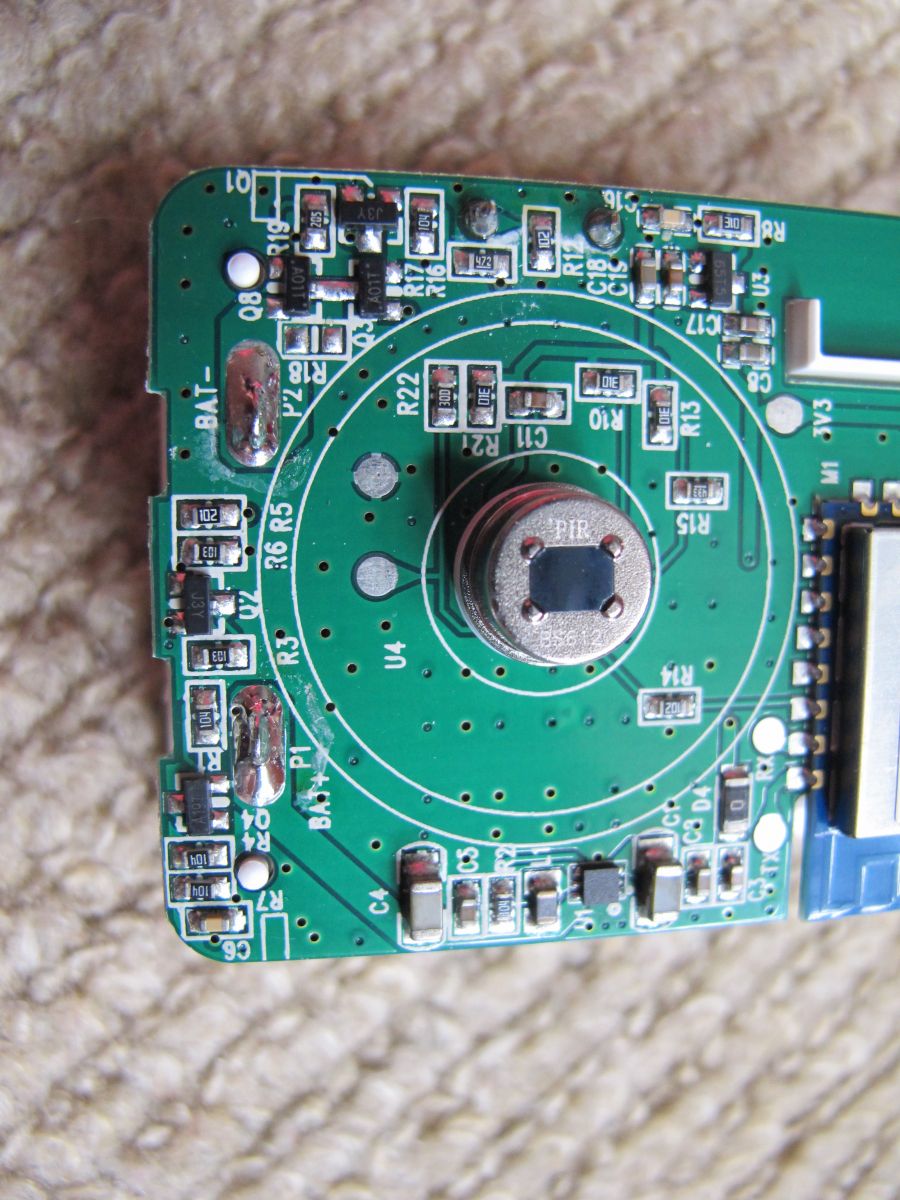

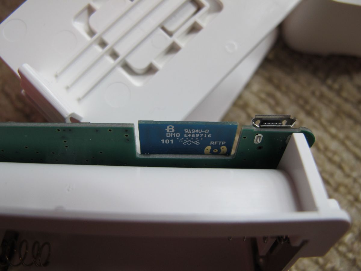

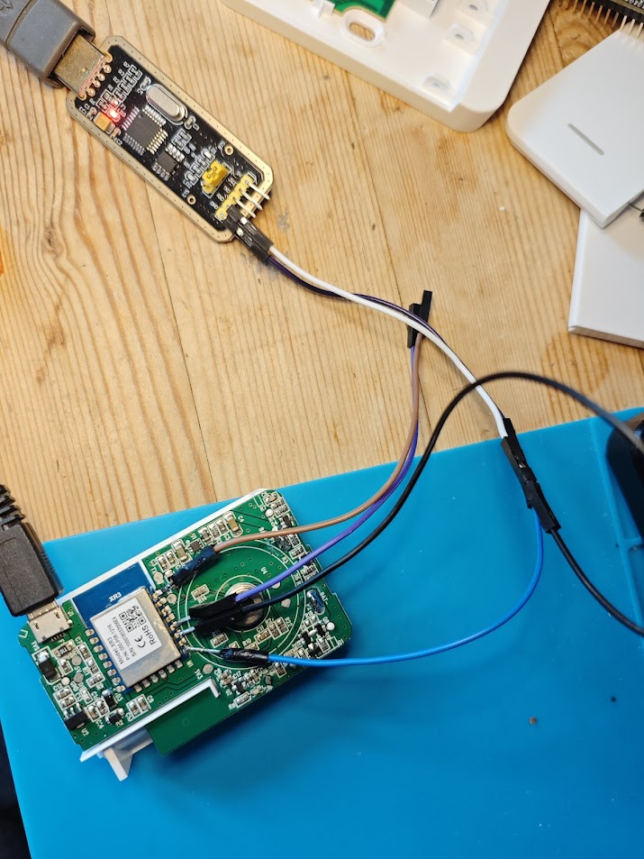

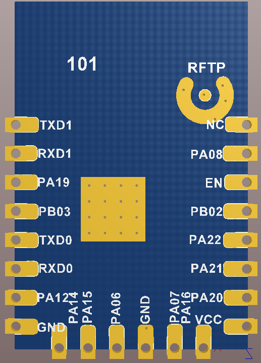

    My first port of call, however, was to capture the UART boot log output. This was achieved by attaching USB-TTL RX to the RXD0 (not TXD0, as expected) of the module. This is the black dupont soldered in this pic. It joins the white where it's connected to USB-TTL RX pin.
    Electronic circuit with connected wires and XR3 module.

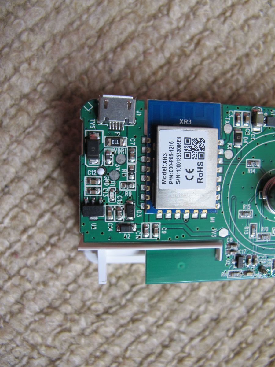

    and the module more clearly:
    XR3 module with visible connectors and traces.
    boot log

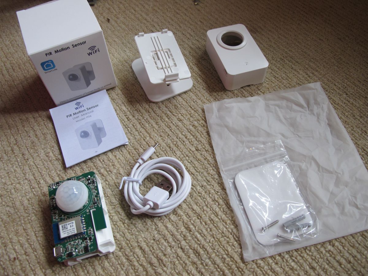

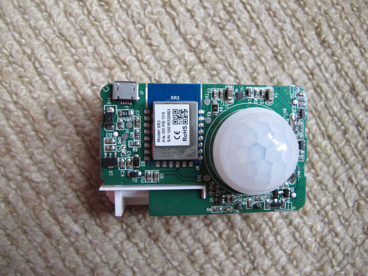

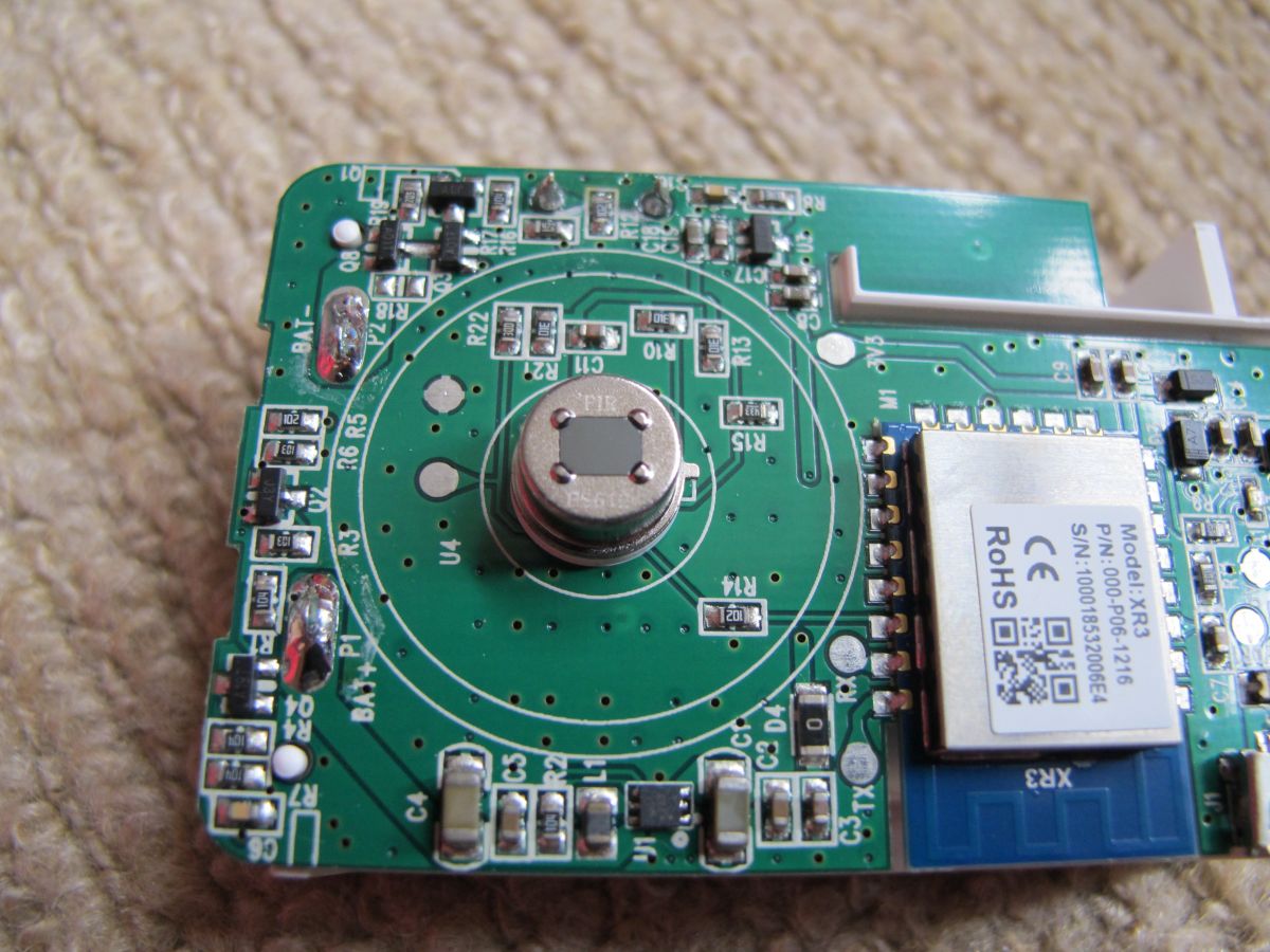

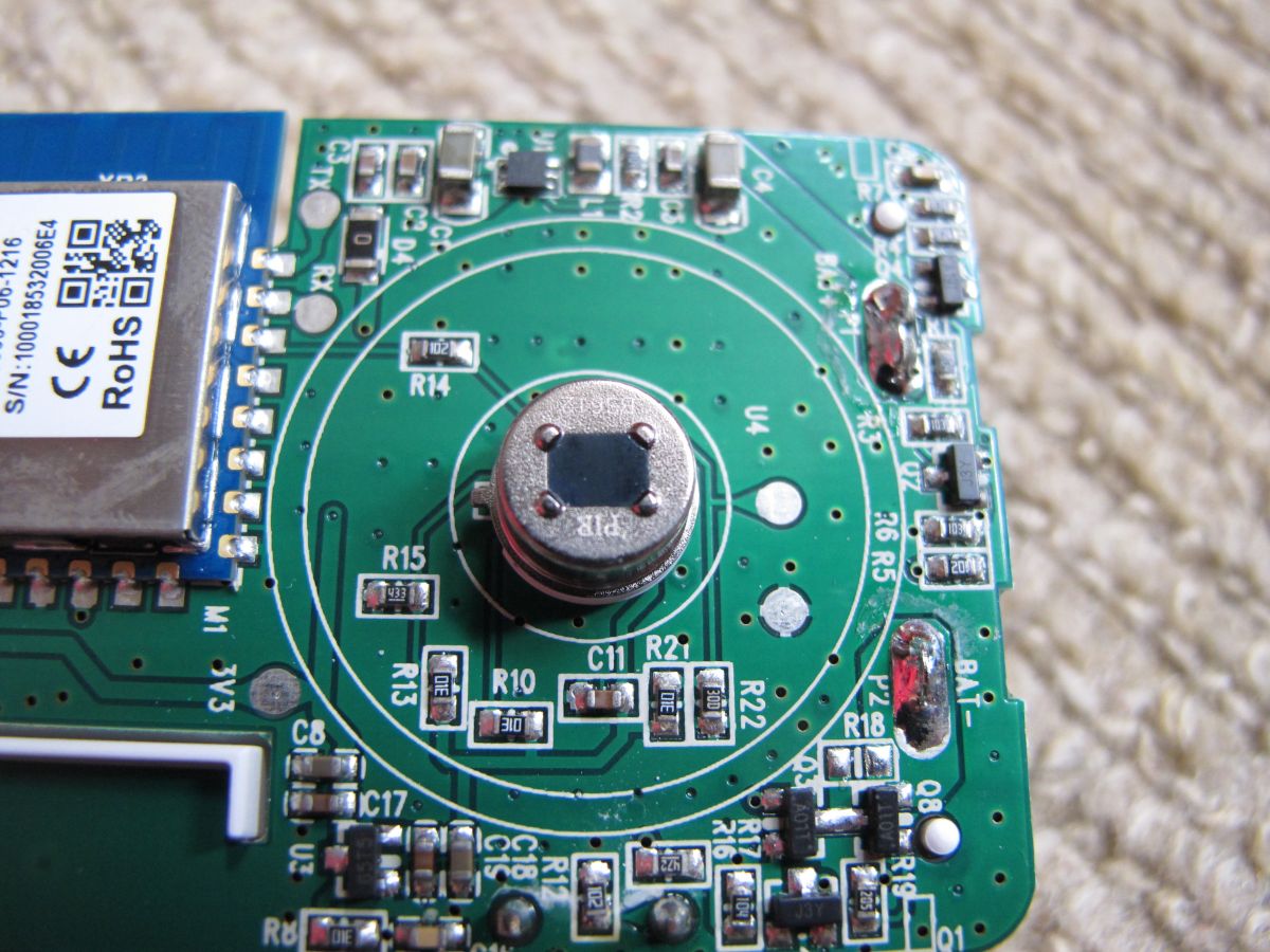

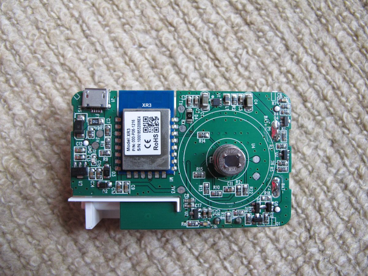

    I need to go out now and I have more to add, including factory fw dump, but for now here are some pics of the device
    Close-up of a circuit board with an XR3 module. Close-up of a circuit board with XR3 module and PIR sensor. XR3 module with a micro USB port inside a device casing. Leaflet with setup instructions for a WiFi motion sensor device. User manual for WiFi PIR Motion Sensor model P06 from AliExpress. Close-up of XR3 module on a circuit board with a PIR sensor. Electronic module with components on a PCB, including XR3 chip and PIR sensor. XR3 module with PIR sensor on a circuit board. XR3 module on a P06 device circuit board with micro USB port and electronic components. Close-up of a circuit board with an XR3 module and a USB connector. XR3 module with a PIR sensor on a PCB. PIR motion sensor P06 with accessories and manual on a carpet. PIR motion sensor box with WiFi and Smart Life labels

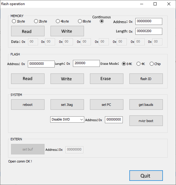

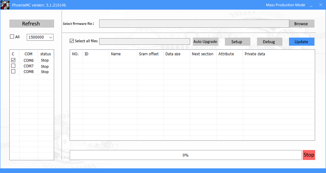

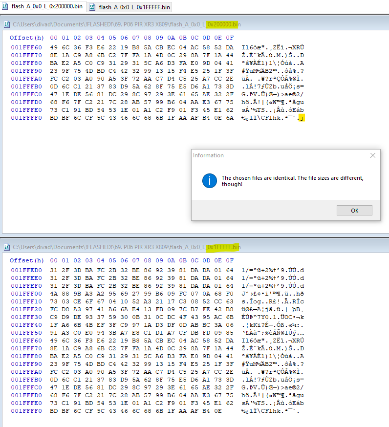

    Looking in PhoenixMC it seems there is a flash erase and read function and so attached is the result of read from 0x0 - 0x1FFFFF (2,097,151 bytes) and 0x0 - 0x200000 (2,097,152 bytes). I thought the end address of 0x1FFFFF would give me the full 2,097,152 bytes but it turns out the following is true
    not sure I fully understand. Anyway, attaching both. I've not braved flashing back factory yet to see if it works.
    Screenshot of PhoenixMC showing a comparison of two binary files with different sizes.
    Here is an edited PhoenixMC GUI with English text
    Screenshot of the PhoenixMC application in mass production mode with a table and firmware update options.
    Debug window
    User interface of PhoenixMC tool for flash memory operations.

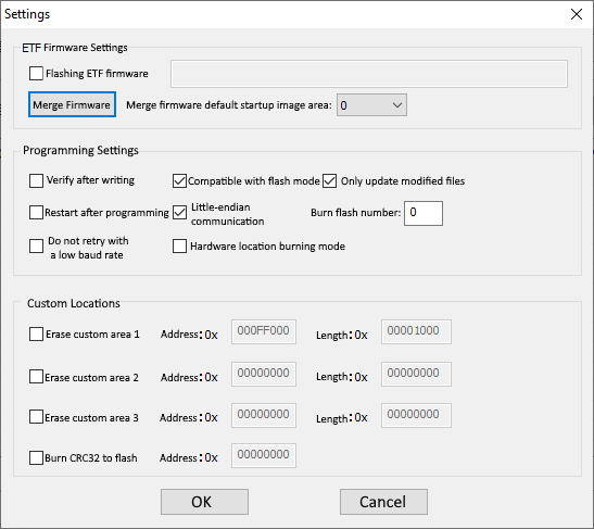

    Settings/Setup
    Settings window in PhoenixMC software with flash memory configuration options.

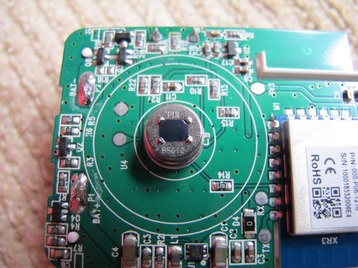

  • PIR sensor uses BS612 with XR809 control

    The PIR sensor is the same BS612 seen in other PIR devices. Including the CBU-based P06 with TuyaMCU. This device does not have an MCU, so all control is handled by the XR3/XR809 module.
    The BS612 is a Senba Sensing Tech component. Datasheet attached.

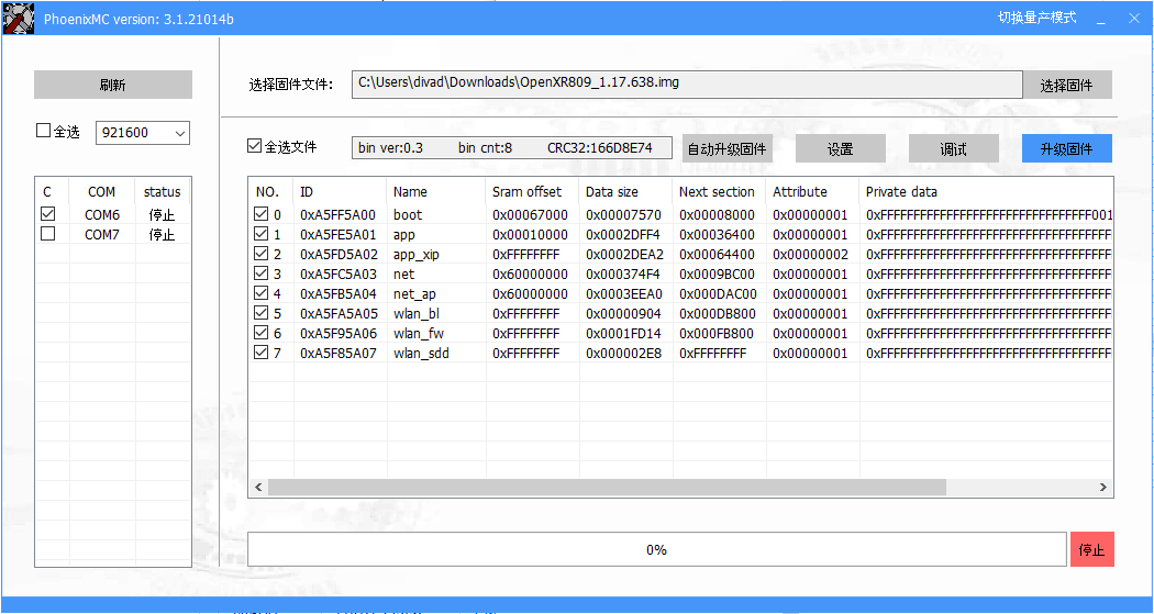

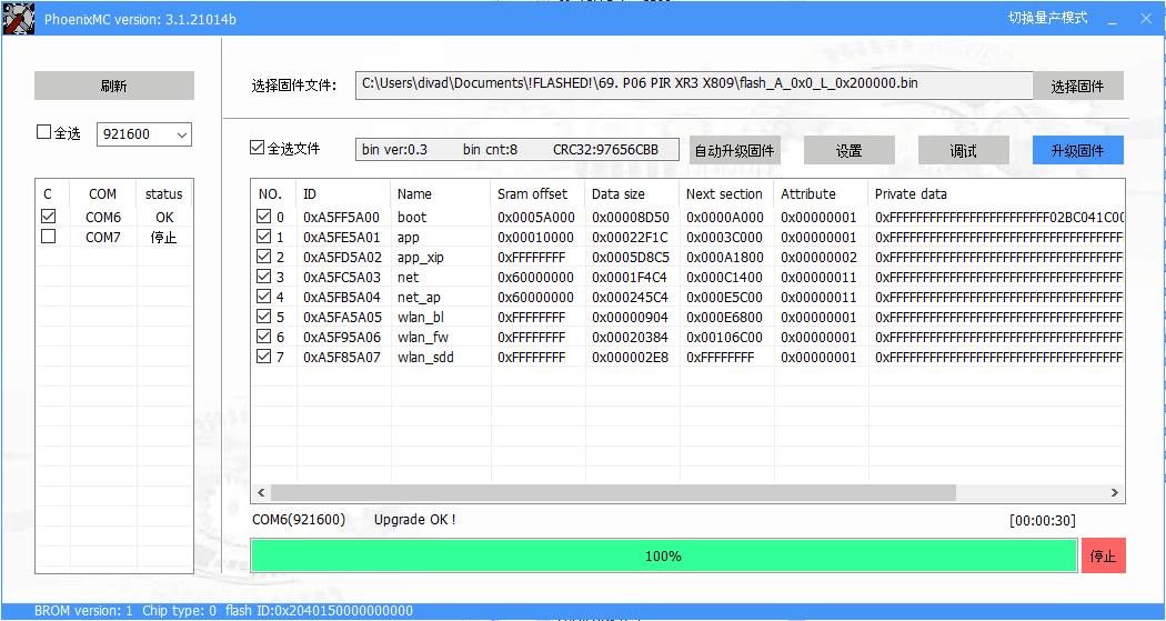

    I believe the flash memory is by Macronix and is one of these two models
    Warning message in phoenixMC_v3.1.21014b about BROM version 1 and flash ID 0x2040150000000000.
    Added after 52 [minutes]:

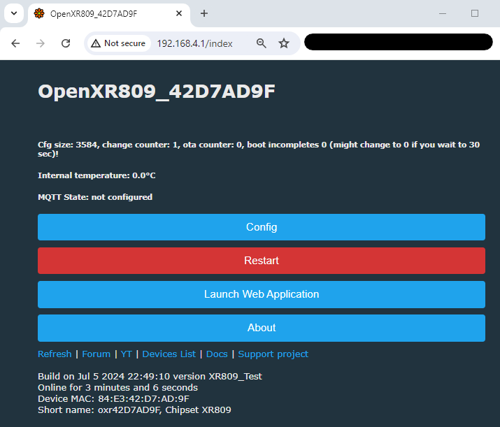

    and now flashing to OBK with PB02 and PB03 pulled low (grounded). I am powering the device by 5V USB, so I have soldered the GND on the module to a cable that is then made common with the GND on the USB-TTL adaptor, PB02 and PB03.
    Screenshot of PhoenixMC software with file update settings.
    Wi-Fi signal icon with network name OpenXR809_42D7AD9F.
    OpenXR809 is on 192.168.4.1 and client IP issued was 192.168.51.100. I had to set manual IP (192.168.4.2) in the same subnet to be able to get access to OBK GUI.
    User interface for OpenXR809 device at IP address 192.168.4.1.
    I also flashed back to factory and was able to pair again with the Smart Life app.
    Screenshot of PhoenixMC software showing firmware update progress.

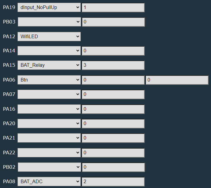

    and using this info from the boot log
    We set this
    Pin configuration interface for XR809 motion sensor
    BUT because there are no drivers enabled in XR809 release, there is no battery driver to run. Also, I'm guessing deep sleep isn't a thing sorted for XR809, so batteries are probably no use here. There's also no LFS for autoexec. Luckily the device can be powered using 5V micro USB. I'll probably unsolder the XR3 for use in ESP universal downloader board anyway.

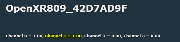

    When motion is detected channel 1's value changes to 1. After covering up the sensor ~30s later the value will return to 0.
    Screenshot of the OpenXR809 interface with highlighted channel values.
