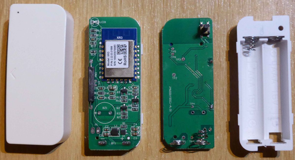

    The teardown of the flood sensor
    This flood sensor looks identical to the door sensor discussed earlier. Even the board is identical. It's easy to get inside:
    XR809 WiFi flood sensor, XR3 Tasmota replacement, open firmware, guide
    Apparently, in order to optimize costs, both versions of the sensor are produced together until the sensor needs to be soldered.

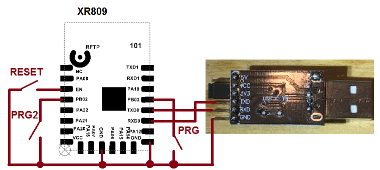

    Uploading the firmware to the XR809
    The firmware upload process is the same as in the previous XR809 topic:
    Open source firmware for XR809 compatible with Tasmota HTTP/Home Assistant
    Please see the topic above for details.
    Soldering and programming (LDO TC1264-3.3V provides power, USB to UART is in 3.3V mode):
    XR809 WiFi flood sensor, XR3 Tasmota replacement, open firmware, guide XR809 WiFi flood sensor, XR3 Tasmota replacement, open firmware, guide XR809 WiFi flood sensor, XR3 Tasmota replacement, open firmware, guide
    You can get the latest binary from here:
    https://github.com/openshwprojects/OpenBK7231T_App/releases
    Programming success:

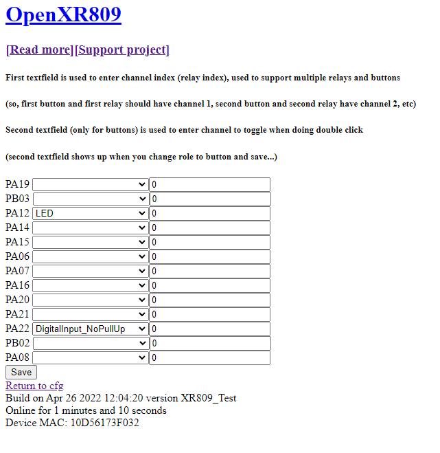

    Configuration page is available at IP address 192.168.4.1 (here you can configure your device; set SSID and pass of your router, setup MQTT, pins, etc). If this IP does not respond, then you need to manually set the computer address to something like 192.168.4.25, because probably DHCP is not working):
    You also need to set the roles of the pins there - for example for the LED:
    After this is set, you can control it via the button (and via MQTT if you configure it):
    But the most important feature here is the water detector. It is on the same pin where the door / window sensor had a magnetic sensor.
    For this sensor, you have to choose the role of the "DigitalInput_NoPullUp" pin, i.e. digital input without pull up resistors or pull down:
    The input with pull up resistor will not work.
    The value in the second column (by default it's 0) it's the index of coupled channel for the given pin. You can have many channels. The channels are used to link buttons and relays (and possibly LEDs) together.
    Here, just to check if everything works ok, I connected the LED and the sensor via channel 0.
    Let's see if it works:
    It works! Of course, if you want to convert the states to the opposite (eg LED or sensor), you have inverted pin roles available, with the suffix "_n". So "Relay" is a normal relay output pin, "Relay_n" is inverted.
    But I only connected this LED for a test. Ultimately, you will give it the role of LED_WiFi - it will inform you about whether the device has WiFi access at the moment:

    Hi, great article. I've just used it to convert some generic contact sensors containing XR3 modules. Did you have an issue with battery drain? Mine now chew through batteries in no time so thought I'd ask if you'd experienced this and got any ideas on how to reduce this. I don't think they actually sleep like the CB3S based Temperature/Humidity sensors I've also done as Homeassistant is giving me a really nice discharge curve with the constant battery state reporting.
  • Autoexec file may enable power saving
    #4 21774713
    matt2_uk
    I do have the same pin configuration so it does look similar, however mine isn't the same unit.
    Photo hopefully here:-
    Disassembled sensor with casing, circuit board and battery compartment
    (This is two units to show both sides of the PCB etc.)
    Interestingly, in that article post #3 has an autoexec file that I've not investigated. If this applies to my unit, then this might provide the power saving that I think I'm missing.
