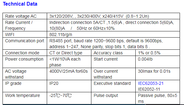

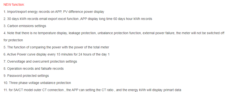

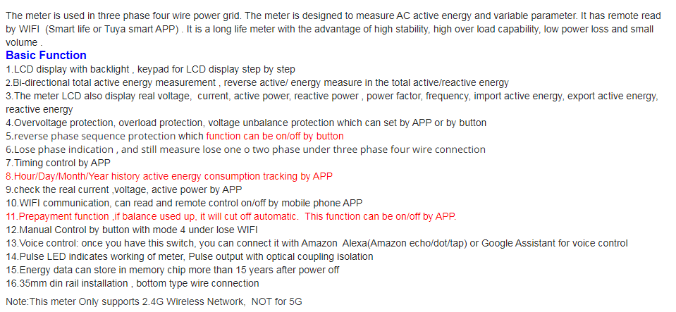

    Photo of the user manual for a three-phase energy meter compatible with Tuya. List of new features for a three-phase energy meter.

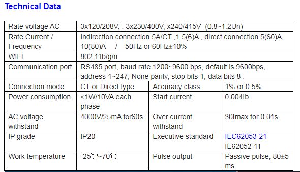

    Technical specifications table for a three-phase energy meter.
    HIKING three-phase energy meter with smartphone app

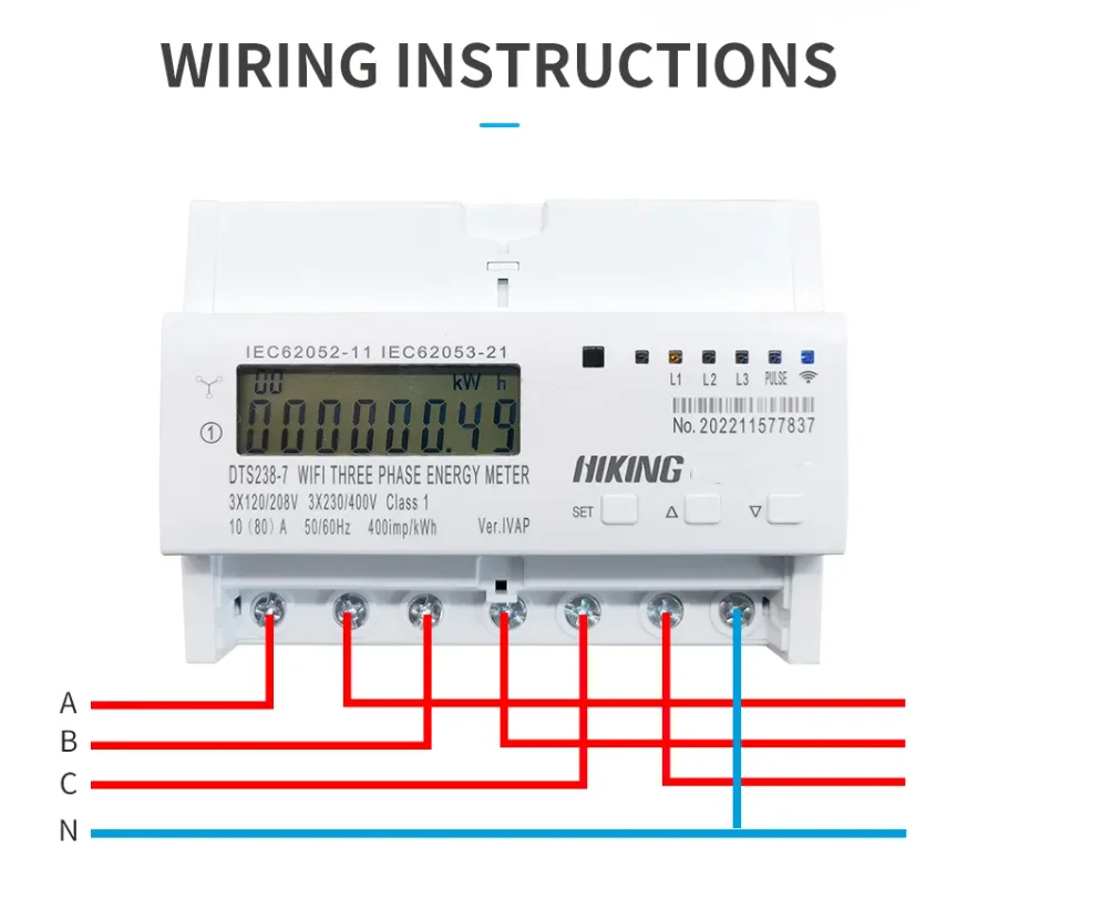

    Three-phase WiFi energy meter with visible wiring instructions.

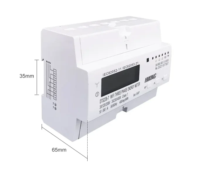

    Three-phase Wi-Fi energy meter Hiking DTS238-7 with visible dimensions.
    HIKING three-phase energy meter with screen and measurements in mm

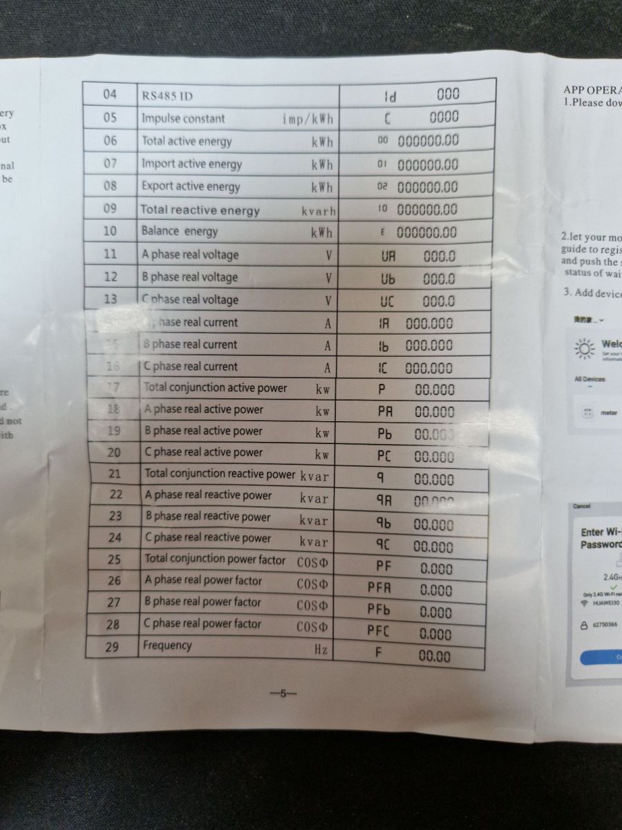

    A manual is included, which specifies the measurements we can expect:
    Energy meter manual with measurement table

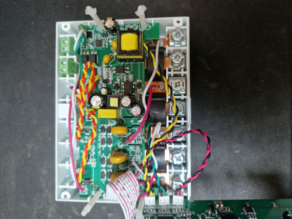

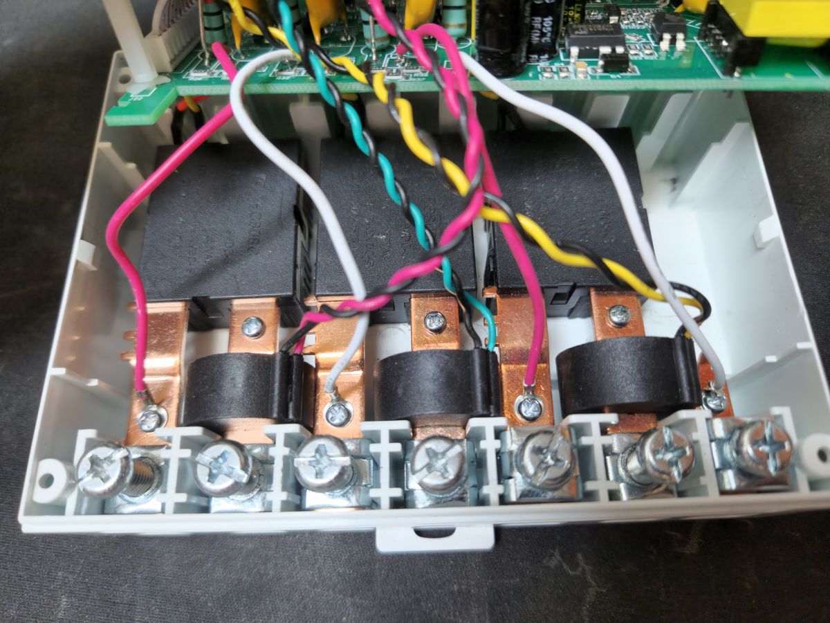

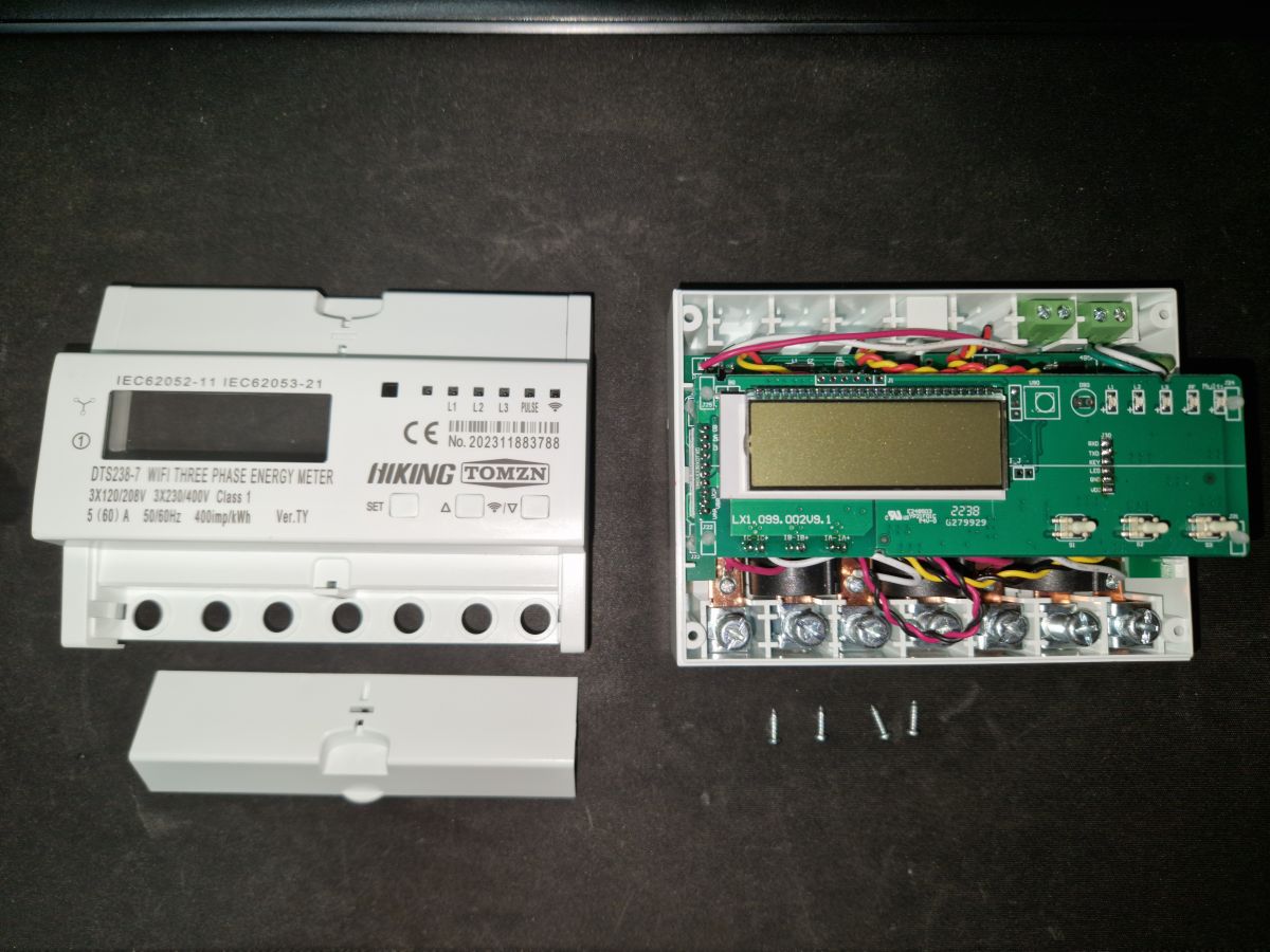

    But we're interested in the inside, so let's remove the case:
    Three-phase energy meter WIFI with the casing removed, revealing internal electronics.

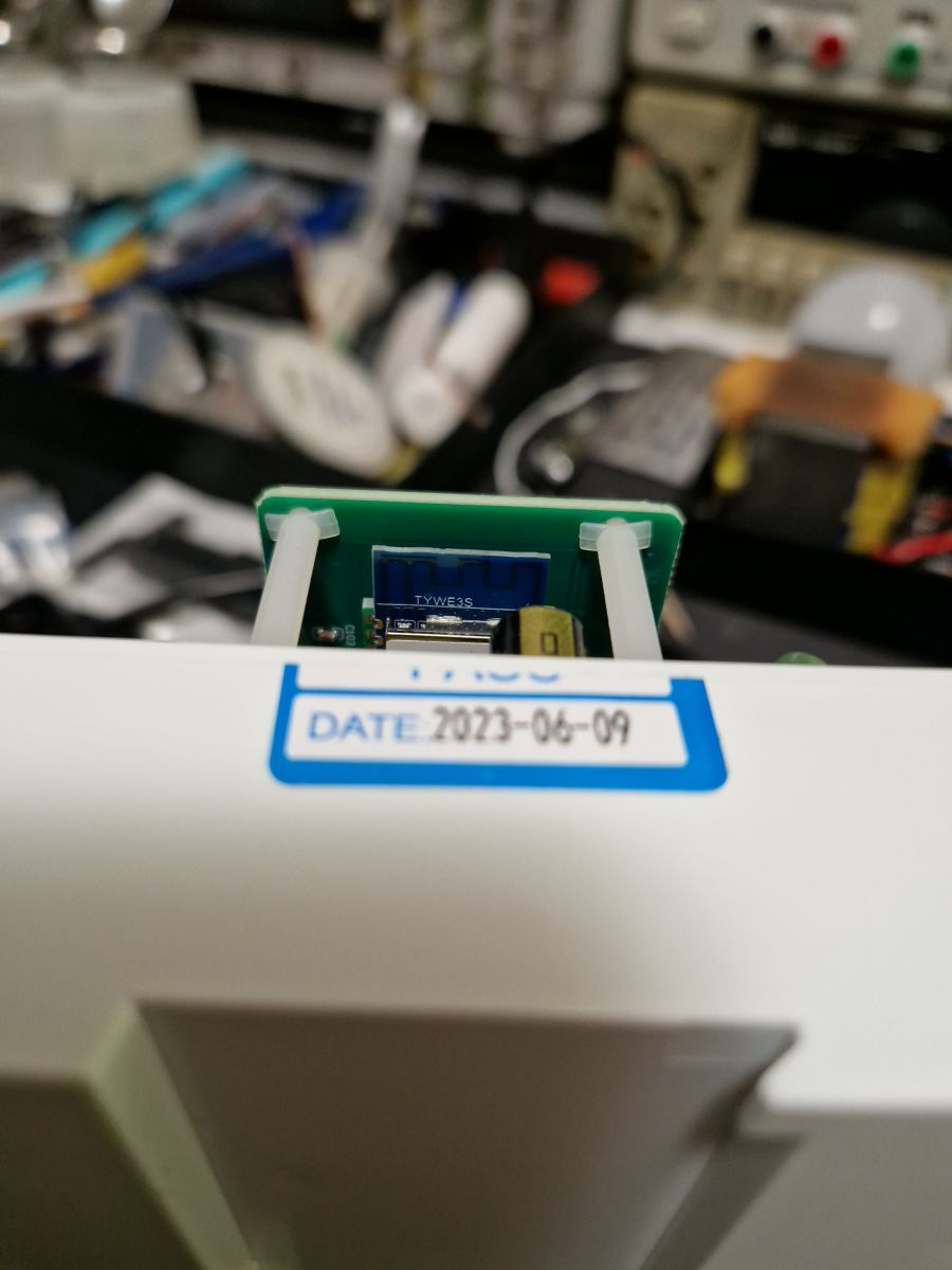

    We found a piece based on the TYWE3S WiFi module, the ESP8266. Tasmota could be uploaded. Admittedly, we were hoping for a version with BK7231 to test OpenBeken a bit, but this is not a problem. You can always replace the WiFi module.
    TYWE3S WiFi module mounted on a PCB inside a three-phase energy meter. Interior of a three-phase energy meter with production date.

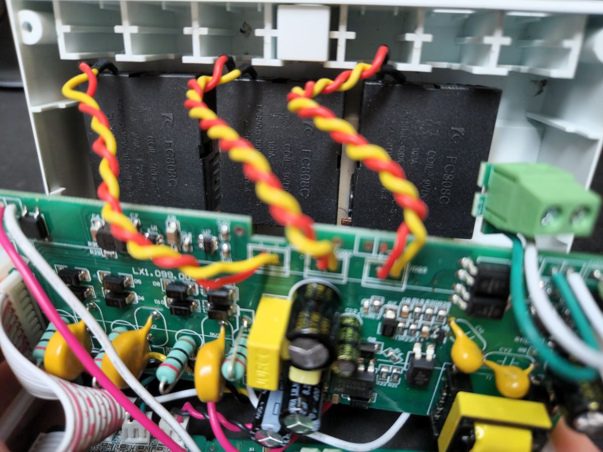

    Interior:
    Close-up of the interior of a three-phase energy meter with visible electronic components and colorful wires. Image of the interior of a three-phase energy meter, showing wires connected to terminals. Interior of a three-phase energy meter with electronic components on the board.

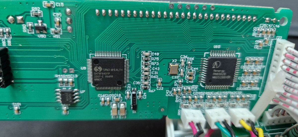

    On the other side of the display board you can also see an additional microcontroller, here the SH79F6431P. An 8051 core, this is the one that communicates with the WiFi module via the aforementioned TuyaMCU protocol.
    Close-up of a circuit board with visible microcontrollers.

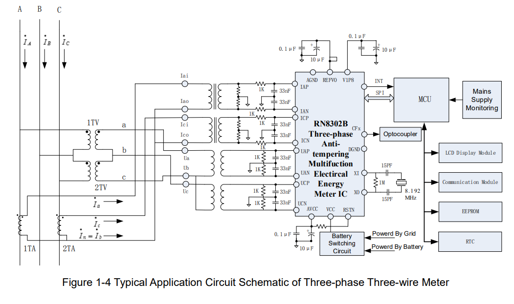

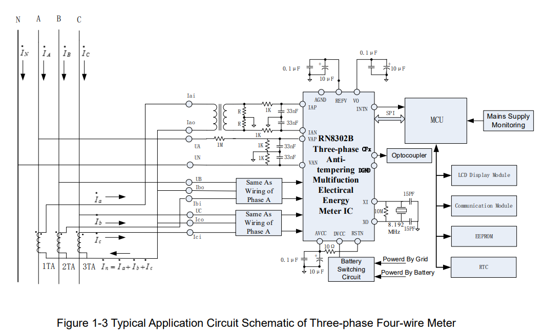

    RN8302B renergy in turn is responsible for the measurement, the coils of the transformers are connected to it:
    Interior of a three-phase energy meter with open casing
    Figure diagram of the part performing the measurement:
    Circuit diagram of a typical three-phase energy meter. Circuit diagram of the RN8302B three-phase energy meter.

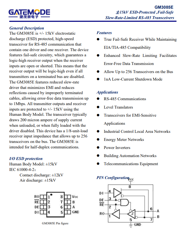

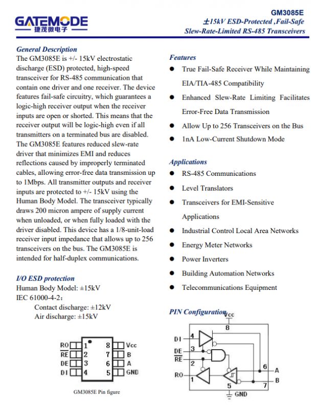

    On the board there is also a chip responsible for RS485 communication, which we haven't tested yet:
    Technical specification of GM3085E

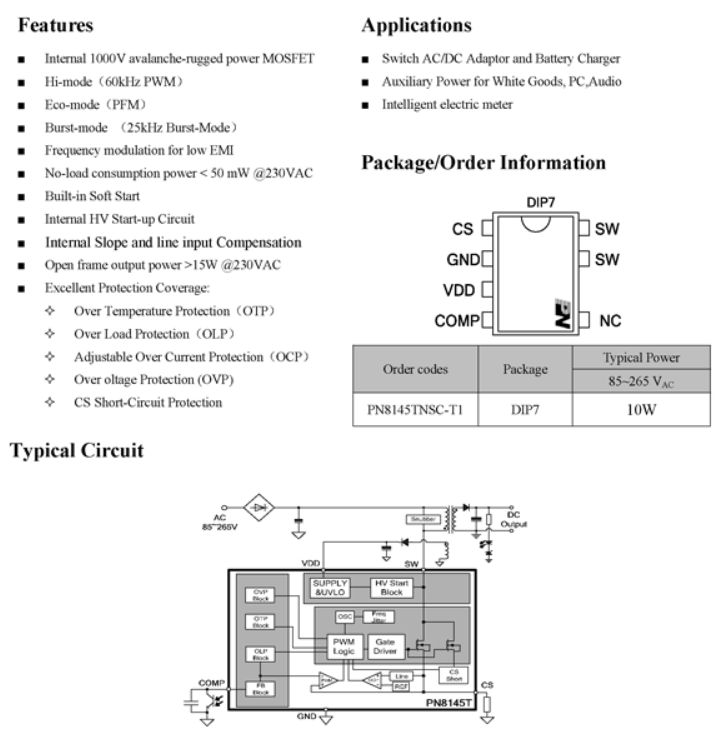

    There is still a power supply - inside is a PN8145T based, flyback power supply:
    Excerpt from the documentation of the PN8145T device by Chipown.
    Technical documentation of the PN8145T chip.

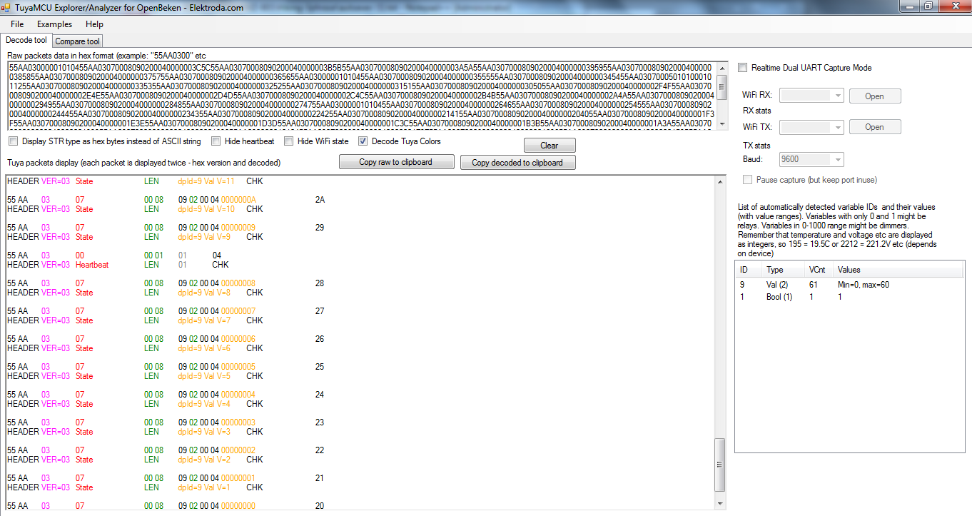

    Packet capture
    This device is based on the TuyaMCU, i.e. the WiFi module here only realises the communication with the outside world, and the rest (including the LCD) is handled by an additional microcontroller. There have already been several topics about the TuyaMCU:
    TuyaMCU protocol - communication between microcontroller and WiFi module
    Flashing guide, install and configure TuyaMCU - configure dpID for Home Assistant
    I recommend reading the above topics, otherwise this paragraph will be incomprehensible.

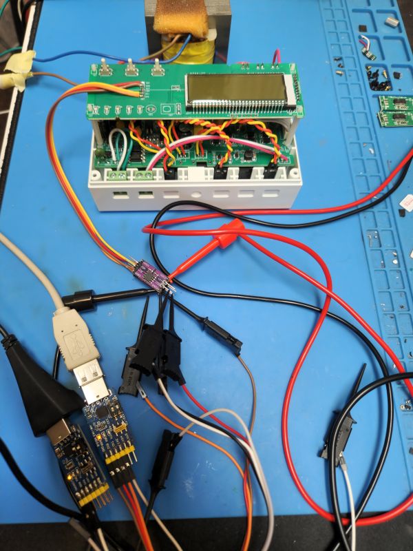

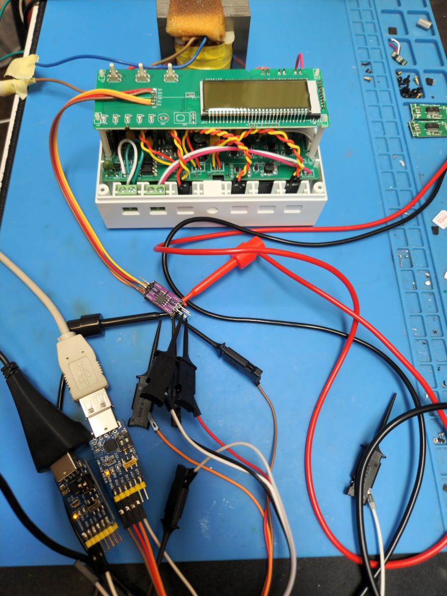

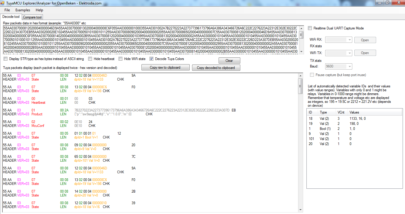

    Well, in accordance with the above topics we prepared to capture TuyaMCU packets. We used the ADUM1201 optoisolation modules for this.
    Here's what it looks like in practice:
    Three-phase energy meter with exposed casing and connected wires.
    Collected data in our analyser, usual work:
    Screenshot of TuyaMCU Explorer/Analyzer application showing packet data in hex formats.
    Test timer (you can see here the dpID of the countdown value and the state of the timer - boolean):
    Screenshot of TuyaMCU Explorer/Analyzer software showing packet data.
    For review:
    https://github.com/openshwprojects/TuyaMCUAnalyzer/tree/main/project/samples
    From more important dpIDs we will discover:
    //1 => on/off
    //18 => current in mA
    //19 => power in watts/10
    //20 => voltage

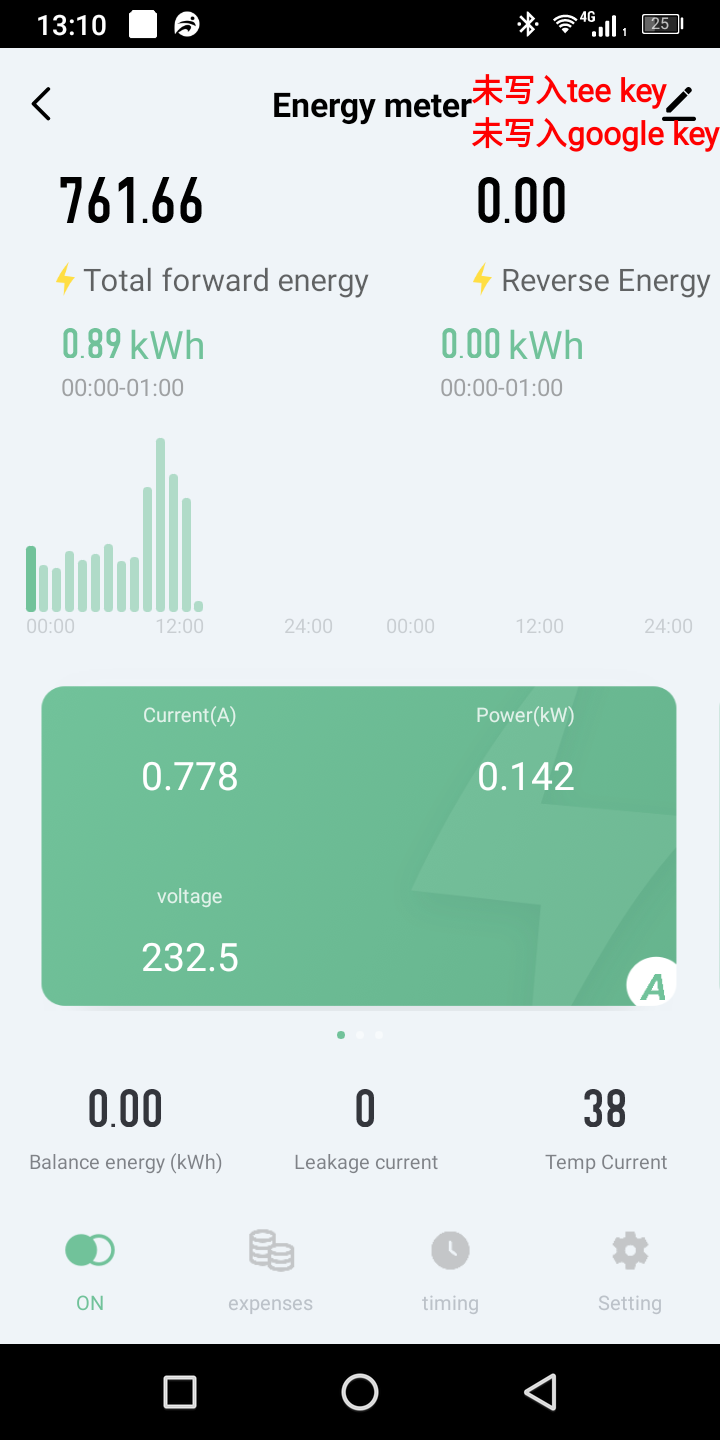

    EARU Electric three-phase energy meter with bi-directional measurement feature.
    In the application itself there is also an indicator of the power given off to the grid, but in my case, due to the lack of photovoltaics, it is not used.
    Screenshot of an energy meter app showing energy consumption and other parameters.

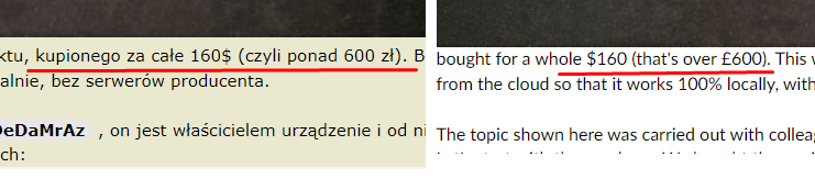

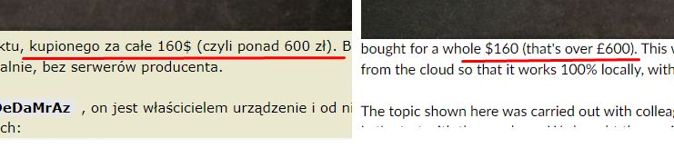

    bought for a whole $160 (that's over PLN600)
    USD?
  • Received ESP8266 version instead of BK7231
    #6 21100834
    Posts: 14791
    Rate: 12937
    USD?
    Sorry, translation error occured, somehow our machine learning translation system changed "zl" (polish zloty) to PLN...
    Comparison of currency translation error from $ to £.
    Still, it was some time ago, so the pricing on the offer may have changed. It's also important to note that we've got the more expensive, RS485 + WiFi version.

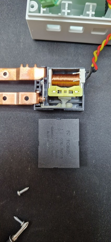

    @p.kaczmarek2 a minor error crept in in the first post. Under the description "RN8302B renergy in turn is responsible for measurement, the coils of the transformers are connected to it: " you have given a picture of the contactor, not the current transformer.
    Btw. I doubt that this contactor will take more than a couple of times on the cage to disconnect a circuit at full load.

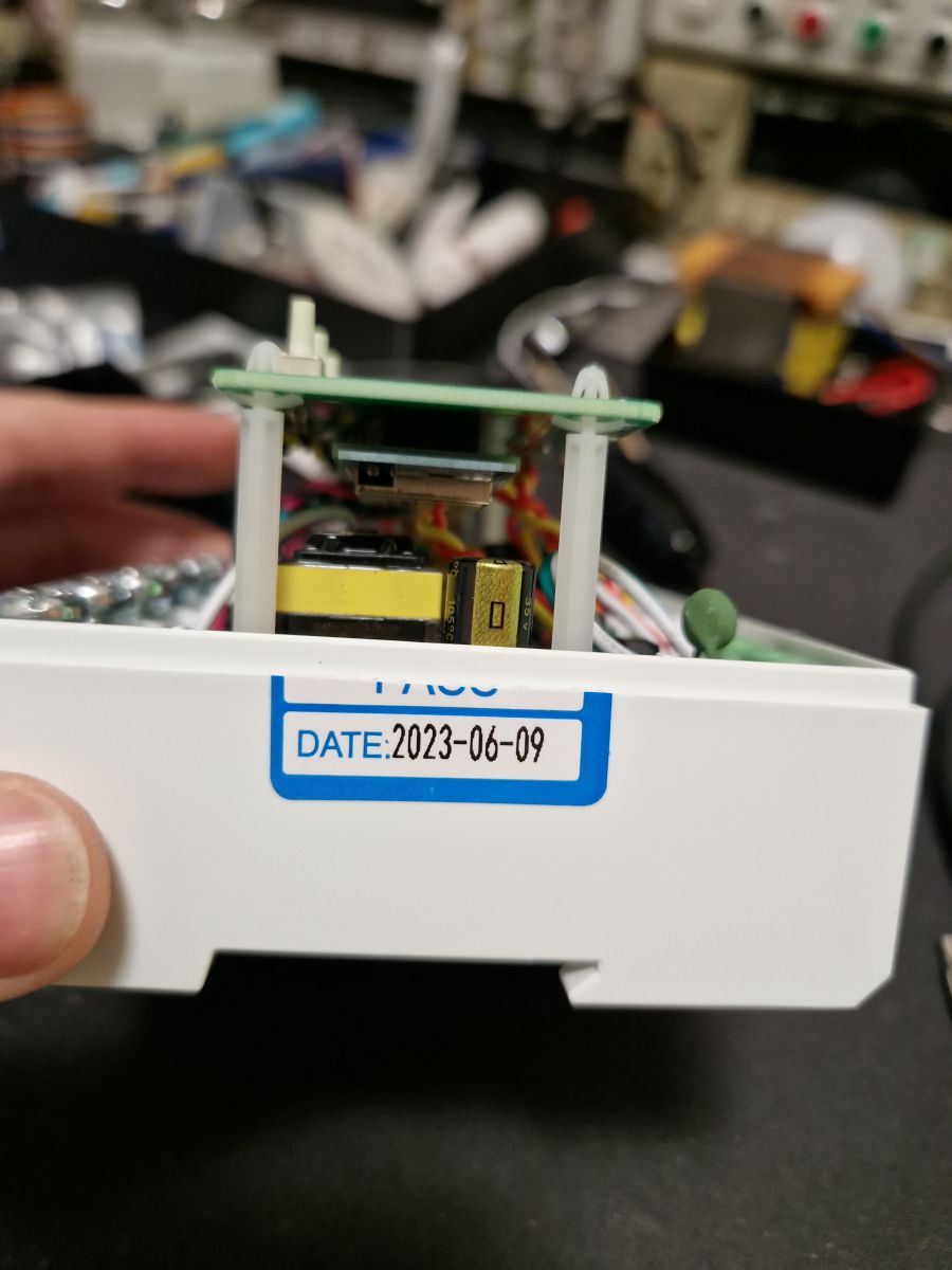

  • Tuya version identified by IVAP front label
    #17 21139847
    paoliniluis
    Level 4  
    Posts: 17
    Ok I found why you got a different version: you got the one that says TY on the front, which is https://www.aliexpress.com/item/4000925379665.html
    The Tuya version is the one that says IVAP: https://www.aliexpress.com/item/1005004987892397.html
