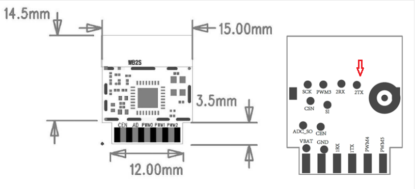

    Using the latest BK7231 Easy UART Flasher, I'm able to backup and flash the WB2S module out of the Martin Jerry US-SS01 single pole switches I have. However after it's done, I can't see any AP from the module, and it won't connect to my router. I've tried powering off/on 5 times, and I tried entering my SSIS/pass in the OBK settings for flash write. Realterm shows only zeros (hex) when I power on, though the USB UART adapter is only connected through tx1 and rx1 (I see mention of tx2, but my module doesn't have a terminal for that.) I wasn't able to get it to get bus by powering off/on or grounding cen, but it finally worked when I checked box 31 (Enable UART command line) in the OBK config before attempting backup/flash.
