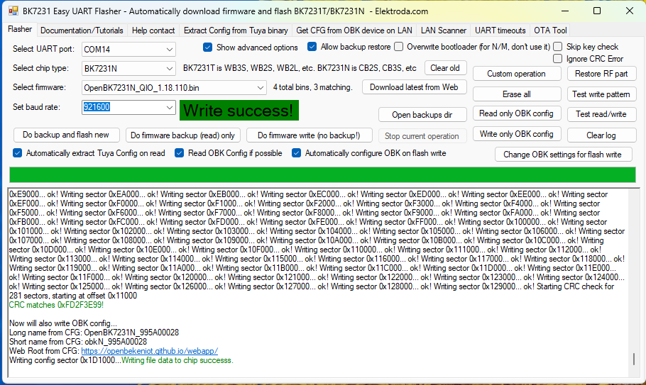

    Hi!
    I am new to OpenBeken.
    Tried to flash the newest version to a CB2S. It seems to be successful, but after reset I do not see the shared Wifi.
    Tried on two devices but the same result. :(
    What am I doing the wrong way?
    Thanks!
    Regards
    Daniel
    AI: Can you please describe how you flashed OpenBeken to your CB2S (for example, which software and hardware did you use, and what steps did you follow)?
    Serial flashing 3,3V USB Uart module with OpenBeken GUI Tool. With the config attached screenshot.
    AI: Which exact OpenBeken firmware file did you use, and where did you download it from?
    Latest current version, 110. GUI downloaded it automatically.

    how are you powering CB2S? If from USB-TTL adaptor alone it's probably browning out when the wifi initialises.
    Are you watching TX boot log? Does it boot loop?

    It's hard to say without TX2 log. Maybe not enough power and bootloop on AP creation, maybe totally wrong firmware (not booting at all), or maybe he configured it to join non-existent access point... also possible...

    >>21576624 Ahhh okay I did not know there are a TX log.... I will check and come back with the result. Thanks! Daniel
