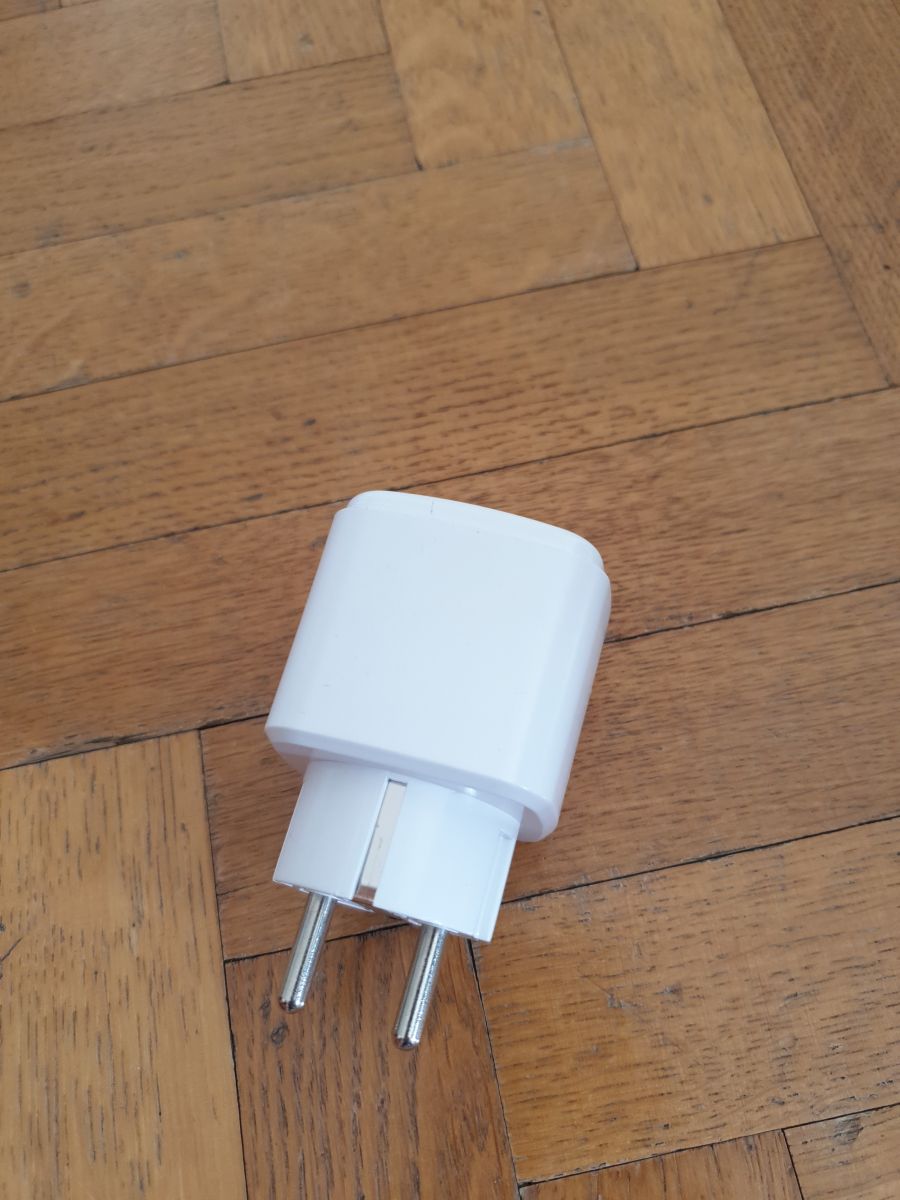

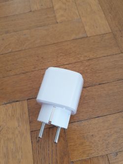

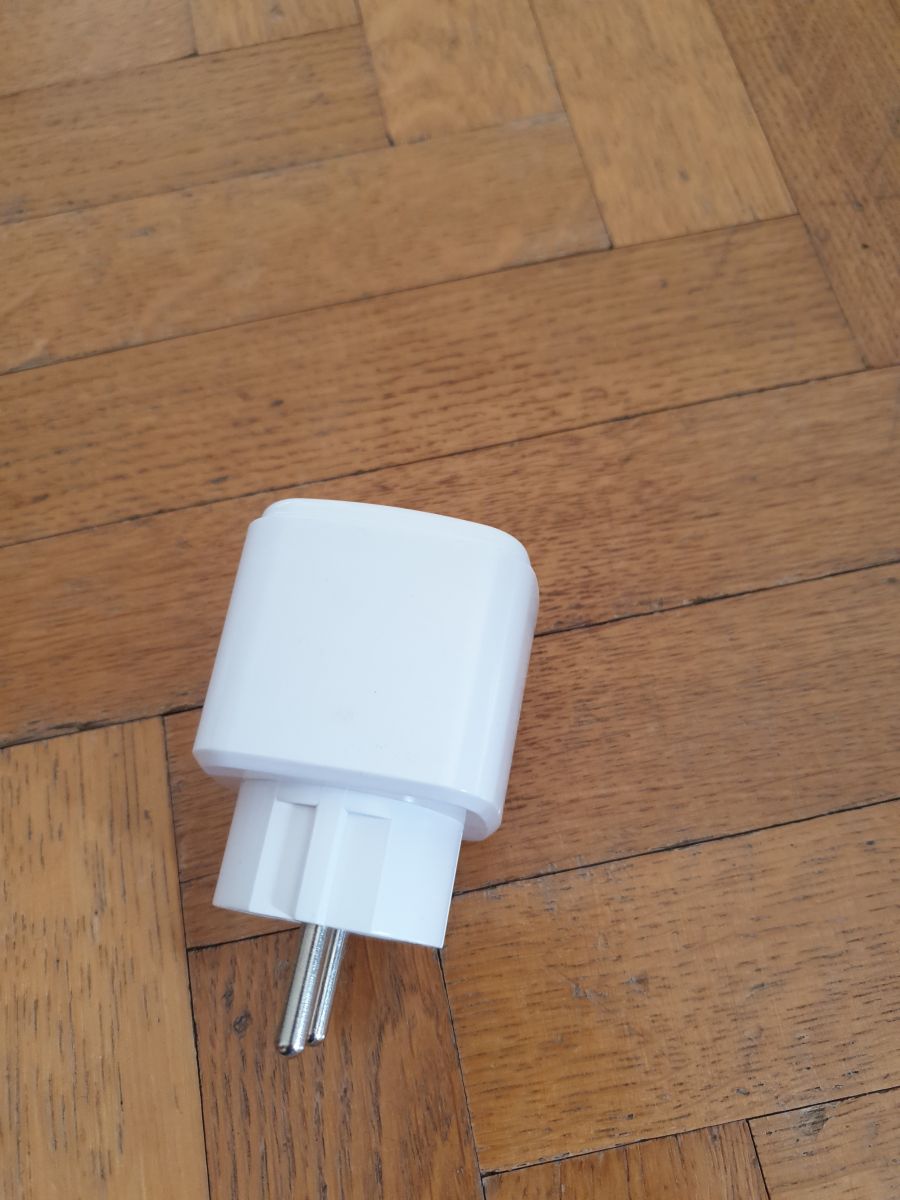

    I bought a cheap smart plug from Aliexpress.
    It's a Meetoo Smartplug 16A. Another Tuya smart plug with monitoring.
    I didn't find it on the forum.
    There is nothing written on the plug. Everything is on the package.
    A smart plug box with the label SMART PLUG and a simple drawing of the device. Label on the packaging of a Meetoo Smartplug 16A. Package of the Meetoo Smartplug 16A lying on a table, partially covered by a label. Image of a package section with a QR code and app compatibility information. White packaging with barcode stickers and Made in China text. White smart plug with a power button on a wooden floor. White smart plug lying on a wooden floor. White smart plug on a wooden floor. A white smart plug lying on a wooden floor. White smart plug held in hand against a wooden floor background

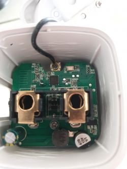

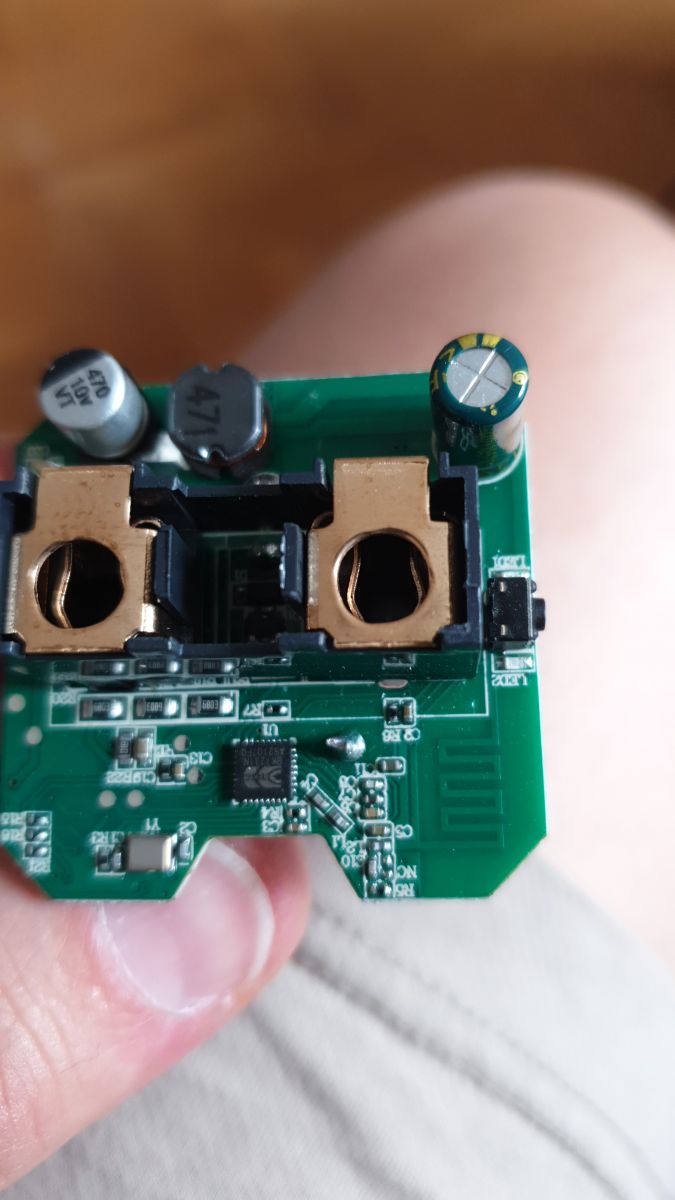

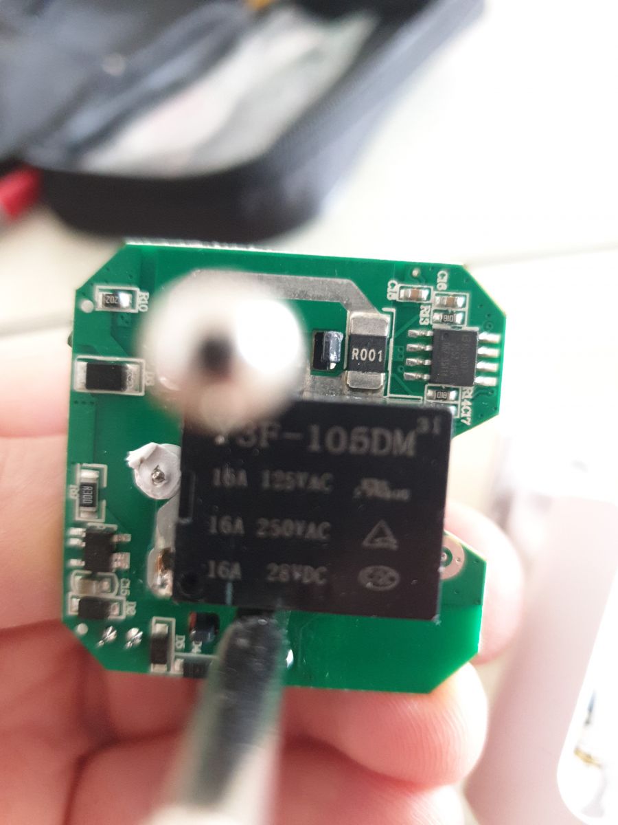

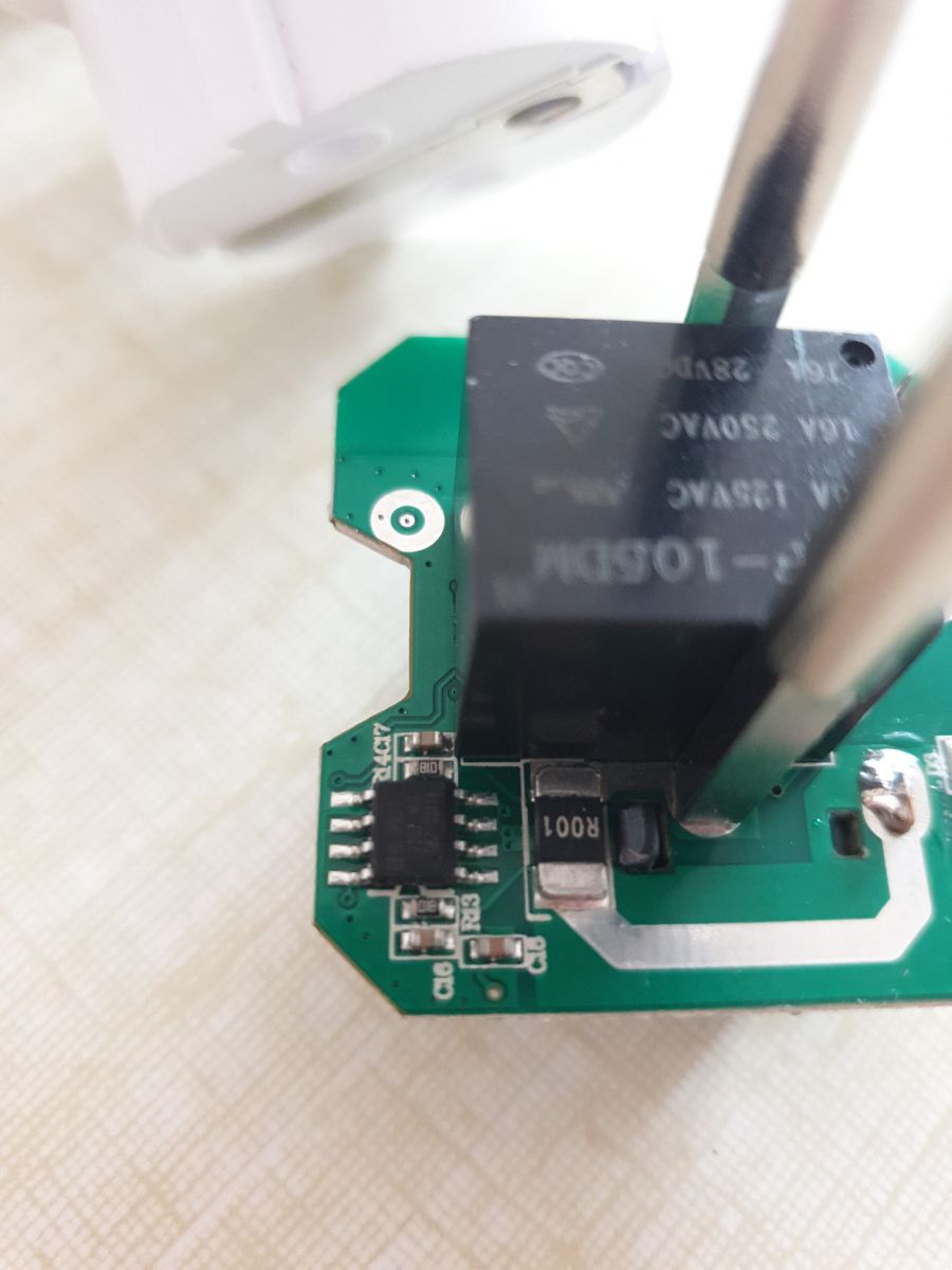

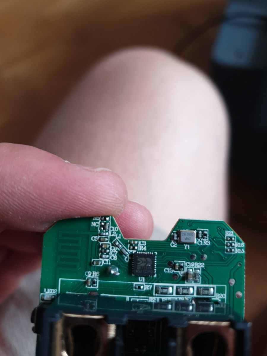

    I expected to find a CB2S inside but once opened I saw the BK7231N is on the main board. It includes a BL0937 for energy measurement on the back of the board near the relay.
    Close-up of a smart plug's mainboard with BK7231N chip and electronic components. Mainboard of a smart plug with visible components. Interior of a smart plug showing the circuit board and electronic components. Main board of a smart plug with visible 16A relay circuit. Close-up of a circuit board inside the Meetoo Smartplug 16A smart plug with BK7231N module and electronic components.

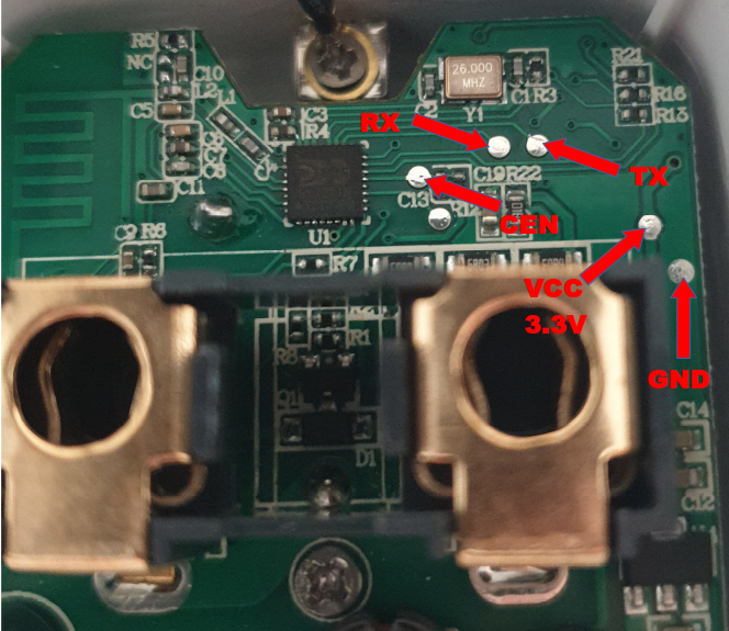

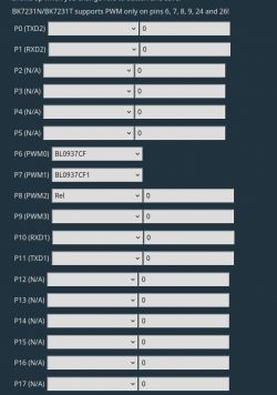

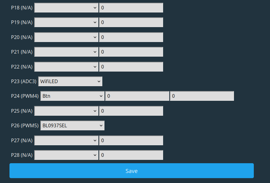

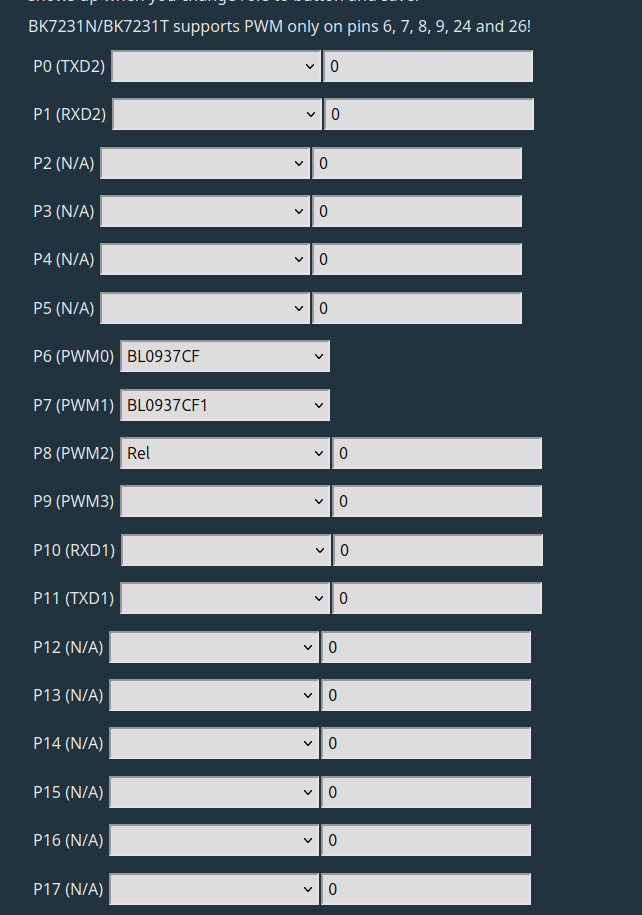

    I started to solder the wires. Here are the corresponding pins. And dump the openBK firmware
    Circuit board of a Meetoo smart plug with labeled pins.
    Here is the original firmware. readResult...-12-25.bin (2 MB)You must be logged in to download this attachment.
    Here is the json file from the webapp:
    This is the original information given by GUIflashTool

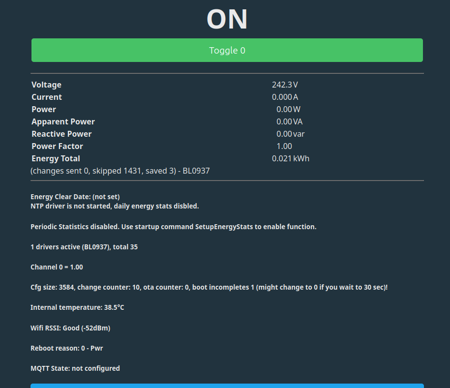

    Everything seems to work fine.
    Screenshot of pin configuration for Meetoo Smartplug with BK7231N module. Pin configuration for Meetoo smart plug in user interface. Screenshot of the user interface for the Meetoo Smartplug displaying monitoring data.

    It looks like another LSPA9 variation, but all LSPA9 I have seen so far were based on TYWE2S/WB2S/CB2S modules, but that one has BK7231 on board, interesting... at least there are still pads for TX/RX, thanks for sharing.
  • #3 21102261
    p11max
    You are welcome and thanks for your work.
    Yeah luckily the pin are easily accessible. It would have been a pain to solder directly on the chip.
