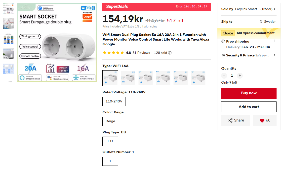

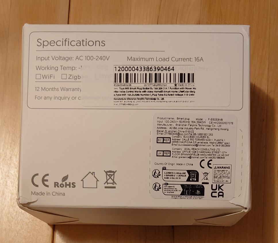

    I ordered a dual smart plug from AliExpress in January 2025 (seller: Fairylink Smart Home Life Store). The cost was around 14 Euros with VAT and shipping.
    Screenshot of an AliExpress listing for a dual smart plug.
    I expected something similar to the Kruidvat SMART Dual Plug. What arrived however was much different.

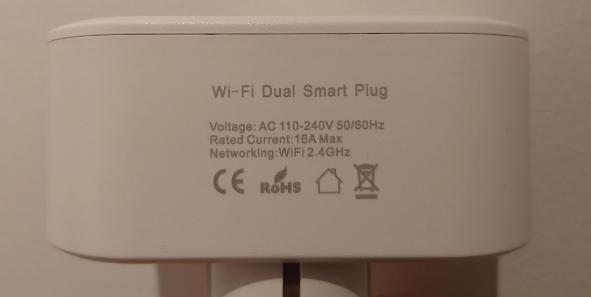

    Unboxing photos:
    Box of a double smart plug. Smart plug packaging with technical specifications. Packaging with QR code for Smart Life app Smart plug packaging with feature icons Label on the Wi-Fi dual smart plug with technical specifications.

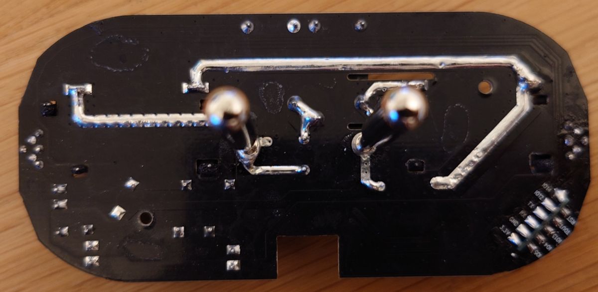

    Teardown photos:

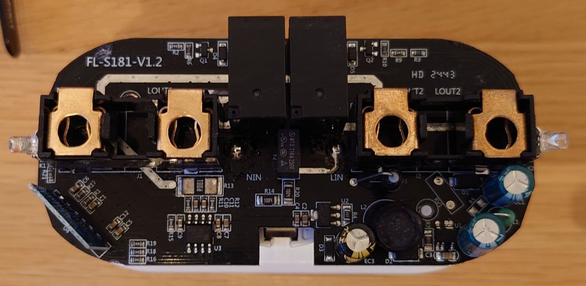

    Interior of a dual smart plug with exposed electronic components. Close-up view of a circuit board with soldered components and traces. Inverted CB2S module next to the plug's printed circuit board.
    The relays are much smaller than the Kruidvat. I am not sure I would trust this with 16A.

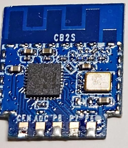

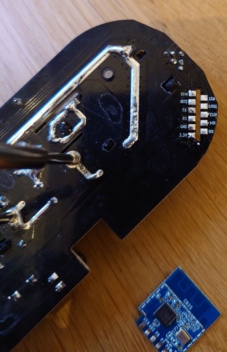

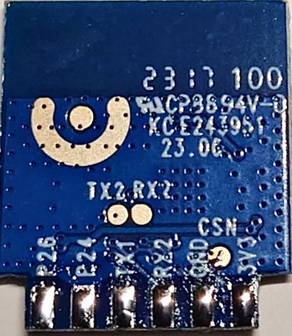

    The plug is using the CB2S module, however the silk screen is reversed on the back of the module. I desoldered the module to flash because it would not work in circuit, although to program it I had to go even farther and short CEN to GND before it would enter flashing mode. It's possible you do not need to desolder the module if you short CEN in circuit.
    Close-up of a CB2S electronic module with visible integrated circuit and electronic components. Rear view of the CB2S module with visible markings and pins.
    Since I could not find another thread for a similar plug, here is the configuration I found:
    The BL0937 requires calibration after flashing, similar to other plugs.

    Thank you for sharing. It's nice that the manufacturer kept the pad labels on the main board.
    I'll just write down the main board label: FL-S181-V1.2 , so others can find this topic more easily.
