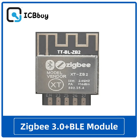

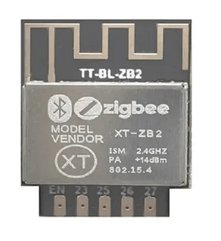

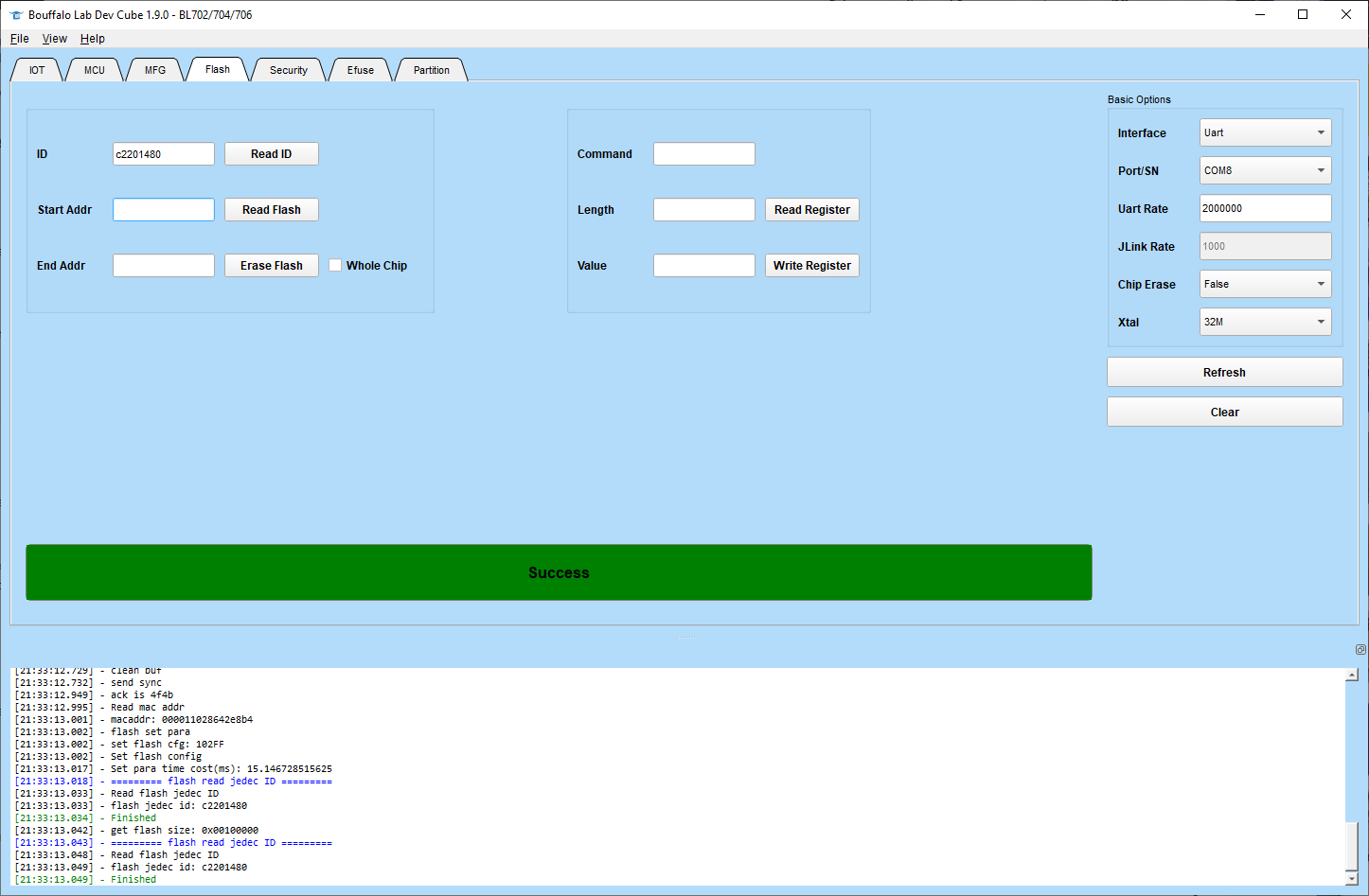

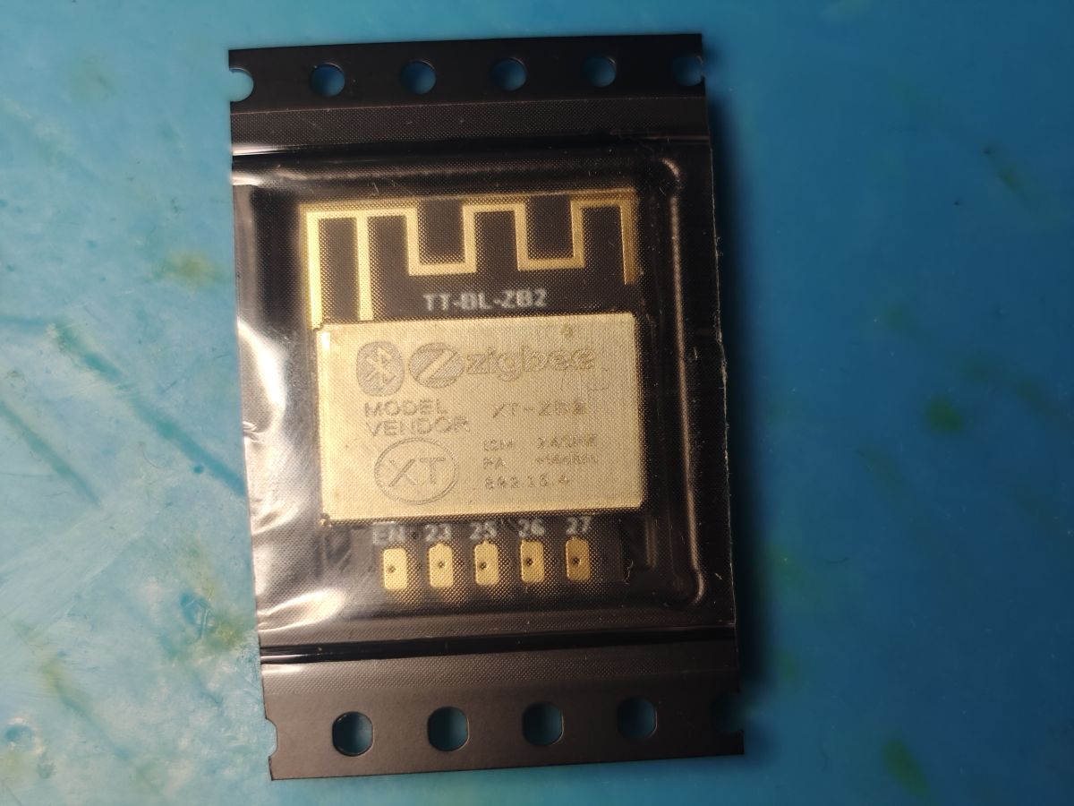

    I bought the XT-ZB2 BL702 Series module. It is based on the BL702 SoC and works with Zigbee2mqtt without modifications as I bought it. I use SLZB-06 + HA.
    I want to backup the flash module for testing purposes - "Way back" to the original state.
    I tried BLDevCube.exe but no luck. No GPIO8 is exposed.
    Does anyone have any experience with this module please?

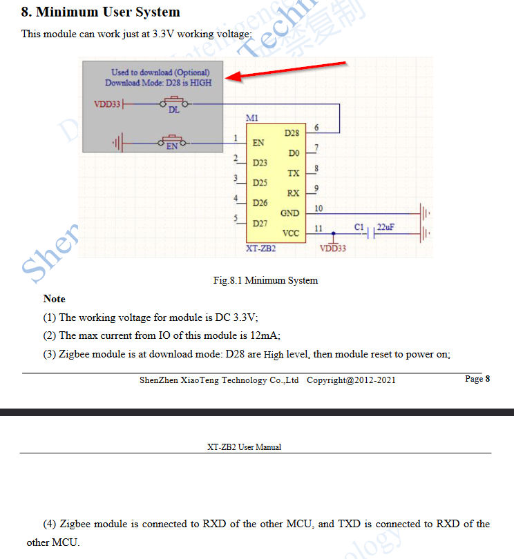

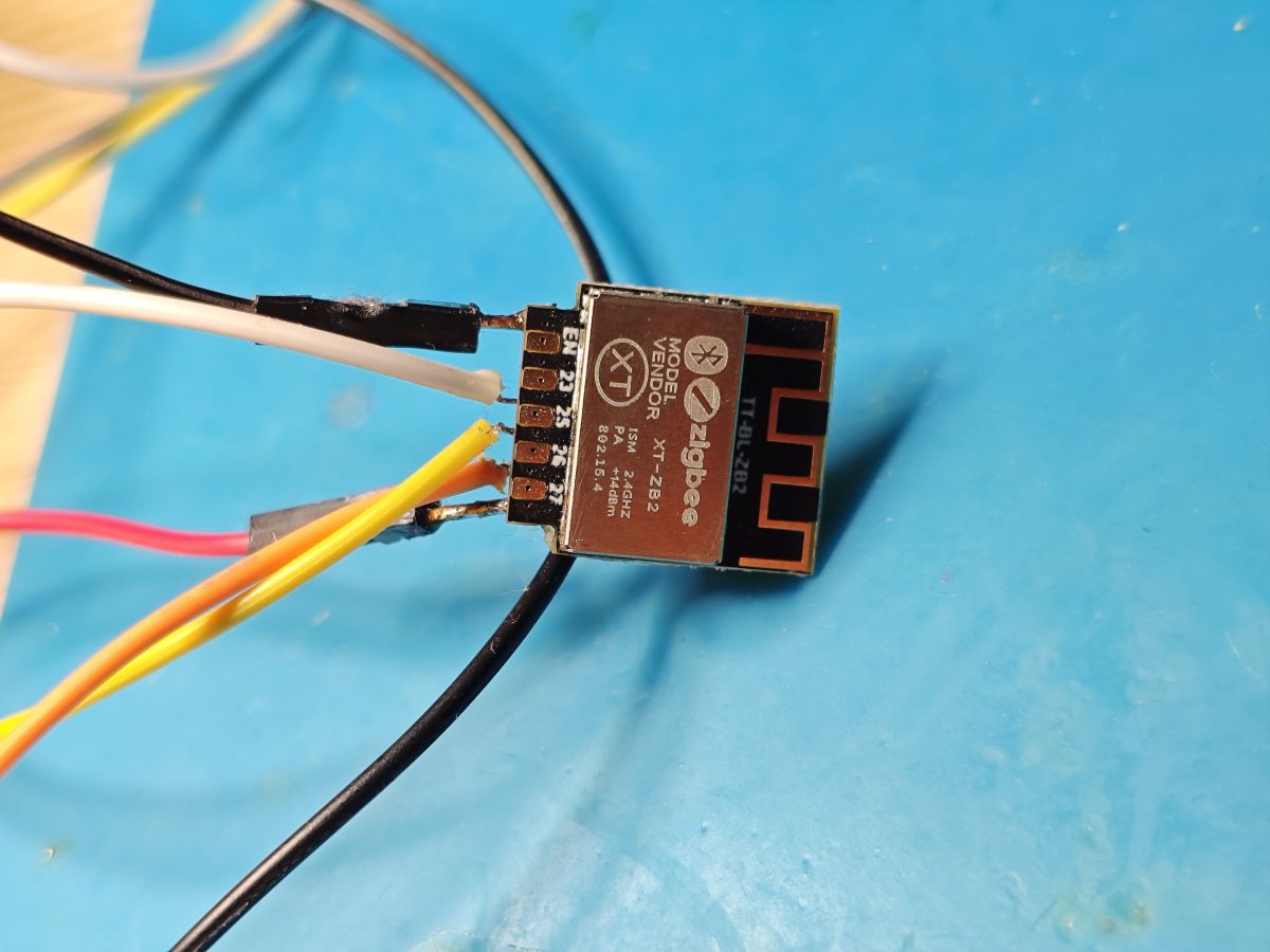

    Added after 29 [minutes]:

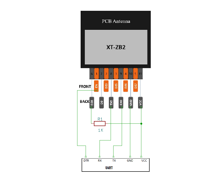

    New discovered - it is necessary to connect D28 to high - see the translated info from BlDevCube for BL702
    [09:45:40.602] - When the pin is pulled high, use Reset/Chip_En to reset the chip
    [09:45:40.602] - Is the COM port selected by the burning software the serial port connected to the chip?
    [09:45:40.602] - Is the baud rate selected on the burning software the baud rate supported by the USB to serial port?
    [09:45:40.603] - Is the 3.3V power supply normal?
    [09:45:40.603] - Is the board power supply current normal (in burning mode, the chip consumes 5-7mA)
    [09:45:40.604] - ## ...
    XT-ZB2 module schematic with download mode highlighted.
    (I didn't have to use Chip_En, it worked without it)

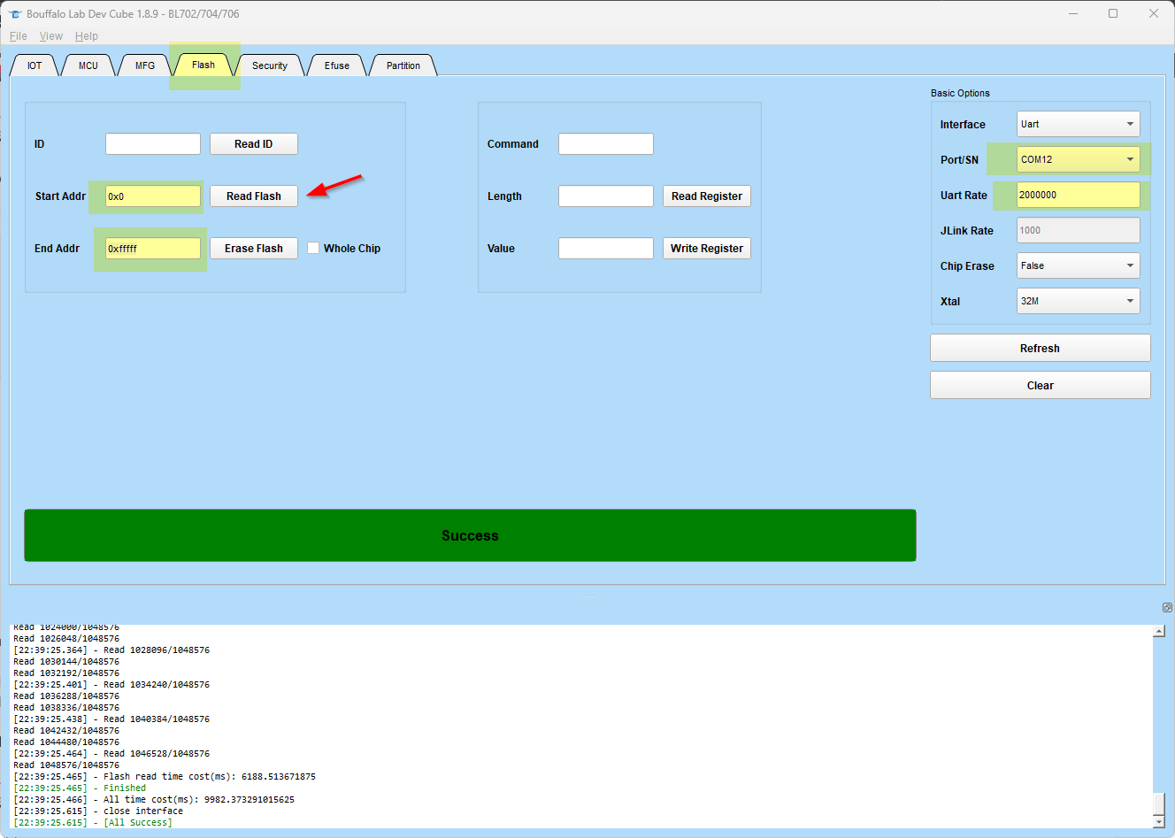

    Anyway, the chip seems to be locked or something like that FL0104(BFLB_CMD_SEQ_ERROR), FL0402(BFLB_EFUSE_WRITE_ADDR_ERROR) and FL0104(BFLB_CMD_SEQ_ERROR)
    Here the log of reading ID:

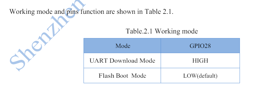

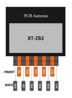

    According to the documentation I've found, it seems that D28 is used for UART bootloader mode.
    XT-ZB2 module diagram with pin definitions.
    Table showing working modes of GPIO28.
    Pin function table for an electronic circuit, detailing pin number, name, type, and function.
    Please make first a full flash backup. @divadiow may know more about BL602/702? flashing.

    >>21103954
    Yes, this doc I've found too, and with D28 it does something more, as I wrote before.
    Now I'm getting efuse error

  • #4 21104476
    XJ_
    Posts: 141
    Help: 13
    Rate: 39

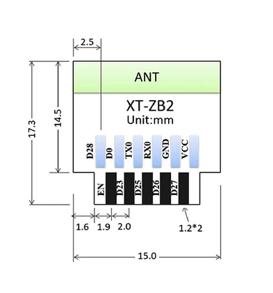

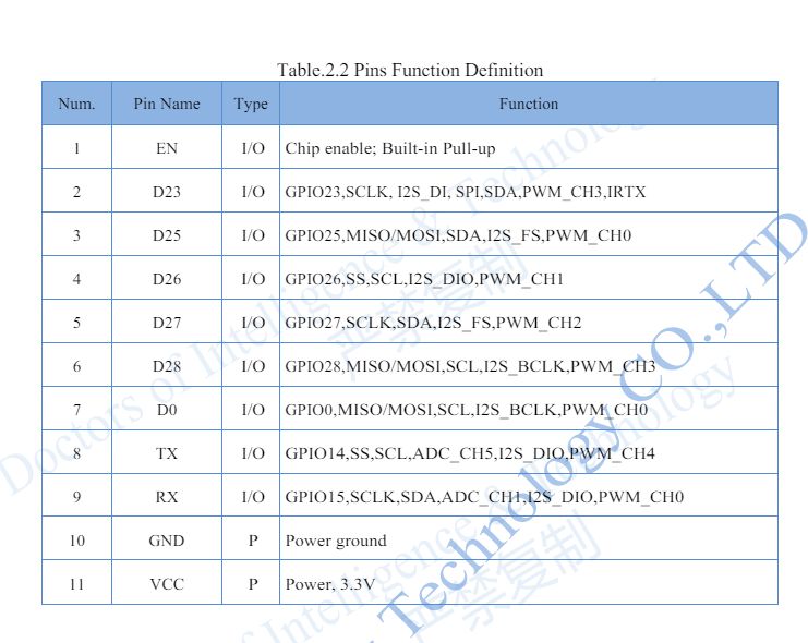

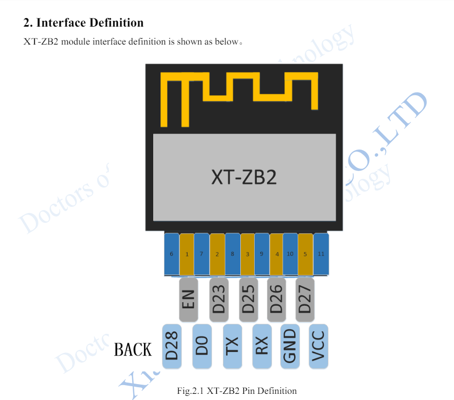

    XT-ZB2 / XT-B-ZB2 - discovery of Zigbee module pinout function:
     - 1  - EN  - when connected to GND, the module is deactivated, after release, the module is restarted
     - 2  - D23 -
     - 3  - D25 - push button switch - short for toggle, long for pair
     - 4  - D26 - led in pair mode blinking, in normal mode - short flash after start, inverted output after start
     - 5  - D27 -
     - 6  - D28 - pulldown internally to GND, use 10k to VCC for flash mode
     - 7  - D0  - relay output - state on=0, state off=1
     - 8  - TX  - 2000000 baud
     - 9  - RX  - 2000000 baud
     - 10 - GND
     - 11 - 3V3

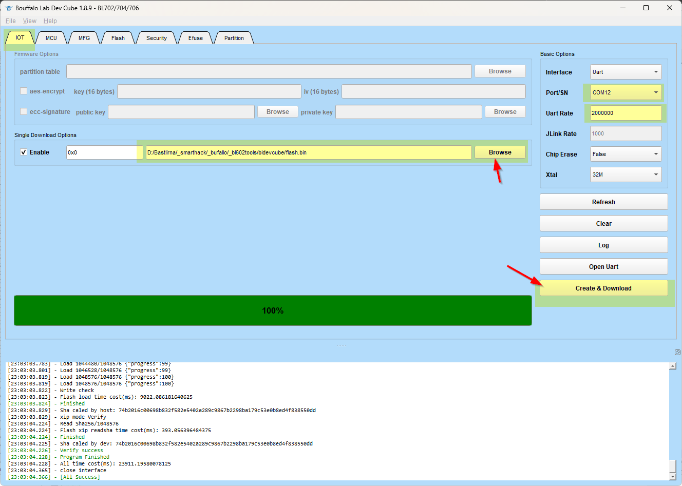

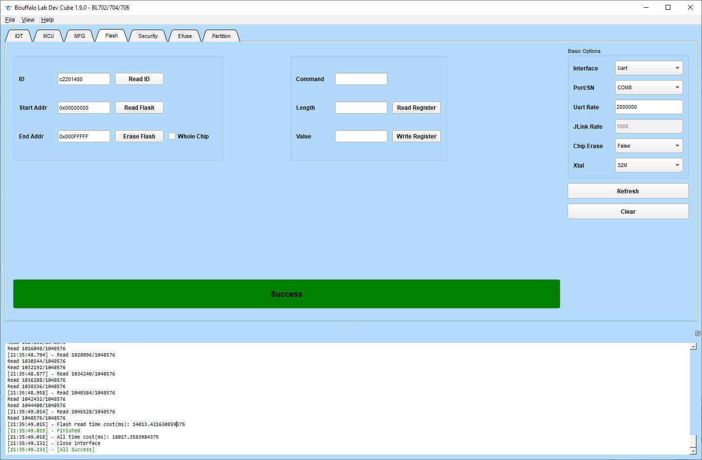

    Yes, I'm using Boufallo Lab Dev Cube 1.8.9 - BL702L/704LK
    Screenshot of Bouffalo Lab Dev Cube 1.8.9 interface showing tabs.

    I finally found a way to read / write flash from an XT-ZB2 module with BL702 without GPIO8 exposed.
    Software / Hardware Used:
    Software: Bouffalo Lab Dev Cube v1.8.9 (BL702 / BL704 / BL706)
    USB–UART: CH9102 (optional, any compatible USB–UART should work)
    This is the most important part: The resistor between 3V3 and D28 is mandatory, otherwise the read will fail after a short time. The D28 pull-up must be applied to SoC 3V3 (not to the 3V3 of Power supply).
    Variant 1 – EN Connected to DTR - recommended
    Wiring
    XT-ZB2 <--> USB–UART / Supply
    3V3 <--> 3V3
    GND <--> GND
    TX  <--> RX
    RX  <--> TX
    EN  <--> DTR
    D28 <--[R 1K]--> XT-ZB2 3V3 (via 1 kΩ resistor to 3V3 on SoC – must be powered together with the chip)
    Wiring diagram of XT-ZB2 module connected to UART interface
    Procedure
    - Power on the SoC
    - Bouffalo lab dev cube - readflash button (0x00000 0x0FFFFF)
    - Flash reading starts automatically.
    Note: The timing of power-on and read initiation is not important when using DTR.
    Screenshot of Bouffalo Lab Dev Cube software with Flash tab open and Success message.
    Variant 2 – Without DTR (Manual EN Control)
    Wiring
    3V3 <--> 3V3
    GND <--> GND
    TX  <--> RX
    RX  <--> TX
    EN  <--> GND (only during power-up)
    Procedure
    - Power off the SoC
    - Connect EN to GND
    - Power on the SoC

    read log (variant 1 DTR):
    [10:31:09.421] - Save as flash.bin
    [10:31:09.422] - Version: eflash_loader_v2.5.0
    [10:31:09.422] - Program Start
    [10:31:09.422] - ========= eflash loader cmd arguments =========
    [10:31:09.422] - Config file: D:\Bastlirna\_smarthack\_bufallo\_bl602tools\bldevcube\chips\bl702\eflash_loader\eflash_loader_cfg.ini
    [10:31:09.428] - serial port is COM12
    [10:31:09.429] - cpu_reset=False
    [10:31:09.429] - chiptype: bl702
    [10:31:09.429] - ========= Interface is uart =========
    [10:31:09.430] - com speed: 1000000
    [10:31:09.430] - Eflash load helper file: D:\Bastlirna\_smarthack\_bufallo\_bl602tools\bldevcube\chips\bl702\eflash_loader/eflash_loader_32m.bin
    [10:31:09.430] - ========= load eflash_loader.bin =========
    [10:31:09.430] - Load eflash_loader.bin via uart
    [10:31:09.431] - ========= image load =========
    [10:31:09.665] - Not ack OK
    [10:31:09.665] - FL
    [10:31:09.665] - result: FL
    [10:31:09.949] - tx rx and power off, press the machine!
    [10:31:09.951] - cutoff time is 0.05
    [10:31:10.011] - power on tx and rx
    [10:31:11.013] - reset cnt: 0, reset hold: 0.05, shake hand delay: 0.1
    [10:31:11.013] - clean buf
    [10:31:11.016] - send sync
    [10:31:11.123] - ack is
    [10:31:11.123] - retry
    [10:31:11.394] - tx rx and power off, press the machine!
    [10:31:11.394] - cutoff time is 0.05
    [10:31:11.454] - power on tx and rx
    [10:31:12.460] - reset cnt: 0, reset hold: 0.05, shake hand delay: 0.1
    [10:31:12.460] - clean buf
    [10:31:12.464] - send sync
    [10:31:12.696] - ack is 4f4b
    [10:31:12.743] - shake hand success
    [10:31:12.758] - get_boot_info
    [10:31:12.759] - data read is b'0100020700000000931d04002900000800003391614cb97c'
    [10:31:12.760] - ========= chipid: 00003391614cb97c =========
    [10:31:12.760] - last boot info: None
    [10:31:12.760] - sign is 0 encrypt is 0
    [10:31:12.761] - segcnt is 1
    [10:31:12.767] - segdata_len is 59200
    [10:31:12.851] - 4080/59200
    [10:31:12.935] - 8160/59200
    [10:31:13.018] - 12240/59200
    [10:31:13.102] - 16320/59200
    [10:31:13.185] - 20400/59200
    [10:31:13.269] - 24480[url=https://obrazki.elektroda.pl/4886629900_1766787616.png][img]https://obrazki.elektroda.pl/4886629900_1766787616_thumb.jpg[/img][/url]/59200
    [10:31:13.352] - 28560/59200
    [10:31:13.436] - 32640/59200
    [10:31:13.519] - 36720/59200
    [10:31:13.603] - 40800/59200
    [10:31:13.686] - 44880/59200
    [10:31:13.769] - 48960/59200
    [10:31:13.854] - 53040/59200
    [10:31:13.937] - 57120/59200
    [10:31:13.980] - 59200/59200
    [10:31:13.982] - Run img
    [10:31:14.090] - Load helper bin time cost(ms): 4658.194091796875
    [10:31:14.199] - Flash load shake hand
    [10:31:14.212] - default set DTR high
    [10:31:14.325] - clean buf
    [10:31:14.329] - send sync
    [10:31:14.558] - ack is 4f4b
    [10:31:14.604] - Read mac addr
    [10:31:14.605] - macaddr: 00003391614cb97c
    [10:31:14.605] - flash set para
    [10:31:14.605] - set flash cfg: 102FF
    [10:31:14.605] - Set flash config
    [10:31:14.606] - Set para time cost(ms): 0.99951171875
    [10:31:14.607] - ========= flash read jedec ID =========
    [10:31:14.609] - Read flash jedec ID
    [10:31:14.609] - flash jedec id: c2201480
    [10:31:14.609] - Finished
    [10:31:14.613] - get flash size: 0x00100000
    [10:31:14.613] - Read operation
    [10:31:14.613] - ========= flash read =========
    [10:31:14.679] - Read 2048/1048576
    [10:31:26.010] - Read 1040384/1048576
    Read 1042432/1048576
    Read 1044480/1048576
    [10:31:26.055] - Read 1046528/1048576
    Read 1048576/1048576
    [10:31:26.056] - Flash read time cost(ms): 11443.33740234375
    [10:31:26.056] - Finished
    [10:31:26.058] - All time cost(ms): 16635.582275390625
    [10:31:26.205] - close interface
    [10:31:26.206] - [All Success]
    Write the flash
    To write the flash, follow the same procedure as for reading, but use Create & Download on the IOT tab, as shown in the screenshot below.
    Bouffalo Lab Dev Cube interface with flash.bin selected and process completed
    write log (variant 1 DTR):
    [23:17:02.206] - ========= Interface is Uart =========
    [23:17:02.210] - eflash loader bin is eflash_loader_32m.bin
    [23:17:02.216] - Version: eflash_loader_v2.5.0
    [23:17:02.217] - Program Start
    [23:17:02.217] - ========= eflash loader cmd arguments =========
    [23:17:02.218] - Config file: D:\Bastlirna\_smarthack\_bufallo\_bl602tools\bldevcube\chips\bl702\eflash_loader/eflash_loader_cfg.ini
    [23:17:02.219] - serial port is COM12
    [23:17:02.219] - cpu_reset=False
    [23:17:02.220] - chiptype: bl702
    [23:17:02.220] - ========= Interface is uart =========
    [23:17:02.220] - com speed: 2000000
    [23:17:02.220] - Eflash load helper file: D:\Bastlirna\_smarthack\_bufallo\_bl602tools\bldevcube\chips\bl702\eflash_loader/eflash_loader_32m.bin
    [23:17:02.221] - ========= load eflash_loader.bin =========
    [23:17:02.221] - Load eflash_loader.bin via uart
    [23:17:02.222] - ========= image load =========
    [23:17:02.469] - Not ack OK
    [23:17:02.469] - FL
    [23:17:02.469] - result: FL
    [23:17:02.753] - tx rx and power off, press the machine!
    [23:17:02.754] - cutoff time is 0.05
    [23:17:02.815] - power on tx and rx
    [23:17:03.820] - reset cnt: 0, reset hold: 0.05, shake hand delay: 0.1
    [23:17:03.820] - clean buf
    [23:17:03.823] - send sync
    [23:17:04.055] - ack is 4f4b
    [23:17:04.103] - shake hand success
    [23:17:04.119] - get_boot_info
    [23:17:04.121] - data read is b'0100020700000000931d04002900000800003391614cb97c'
    [23:17:04.121] - ========= chipid: 00003391614cb97c =========
    [23:17:04.121] - last boot info: None
    [23:17:04.121] - sign is 0 encrypt is 0
    [23:17:04.122] - segcnt is 1
    [23:17:04.128] - segdata_len is 59200
    [23:17:04.211] - 4080/59200
    [23:17:04.294] - 8160/59200
    [23:17:04.377] - 12240/59200
    [23:17:04.460] - 16320/59200
    [23:17:04.544] - 20400/59200
    [23:17:04.627] - 24480/59200
    [23:17:04.710] - 28560/59200
    [23:17:04.794] - 32640/59200
    [23:17:04.877] - 36720/59200
    [23:17:04.960] - 40800/59200
    [23:17:05.044] - 44880/59200
    [23:17:05.127] - 48960/59200
    [23:17:05.211] - 53040/59200
    [23:17:05.294] - 57120/59200
    [23:17:05.337] - 59200/59200
    [23:17:05.339] - Run img
    [23:17:05.454] - Load helper bin time cost(ms): 3232.28369140625
    [23:17:05.566] - Flash load shake hand
    [23:17:05.579] - default set DTR high
    [23:17:05.691] - clean buf
    [23:17:05.694] - send sync
    [23:17:05.926] - ack is 4f4b
    [23:17:05.973] - Read mac addr
    [23:17:05.974] - macaddr: 00003391614cb97c
    [23:17:05.974] - flash set para
    [23:17:05.974] - set flash cfg: 102FF
    [23:17:05.975] - Set flash config
    [23:17:05.976] - Set para time cost(ms): 0.996337890625
    [23:17:05.976] - ========= flash read jedec ID =========
    [23:17:05.978] - Read flash jedec ID
    [23:17:05.978] - flash jedec id: c2201480
    [23:17:05.978] - Finished
    [23:17:05.982] - get flash size: 0x00100000
    [23:17:05.982] - Program operation
    [23:17:05.983] - Dealing Index 0
    [23:17:05.983] - ========= programming D:\Bastlirna\_smarthack\_bufallo\_bl602tools\bldevcube\chips\bl702\img_create_iot\img_single.bin to 0x00000000
    [23:17:05.987] - ========= flash load =========
    [23:17:05.988] - ========= flash erase =========
    [23:17:05.988] - Erase flash from 0x0 to 0xfffff
    [23:17:05.990] - erase pending
    [23:17:06.696] - erase pending
    [23:17:07.401] - erase pending
    [23:17:08.085] - erase pending
    [23:17:08.758] - erase pending
    [23:17:09.426] - erase pending
    [23:17:10.082] - erase pending
    [23:17:10.726] - erase pending
    [23:17:11.346] - erase pending
    [23:17:11.970] - erase pending
    [23:17:12.608] - erase pending
    [23:17:13.243] - erase pending
    [23:17:13.881] - erase pending
    [23:17:14.522] - erase pending
    [23:17:15.154] - erase pending
    [23:17:15.789] - erase pending
    [23:17:16.453] - Erase time cost(ms): 10464.7109375
    [23:17:16.472] - Load 2048/1048576 {"progress":0}
    [23:17:25.455] - Load 1048576/1048576 {"progress":100}
    [23:17:25.457] - Write check
    [23:17:25.459] - Flash load time cost(ms): 9004.6220703125
    [23:17:25.459] - Finished
    [23:17:25.464] - Sha caled by host: 74b2016c00698b832f582e5402a289c9867b2298ba179c53e0b8ed4f838550dd
    [23:17:25.465] - xip mode Verify
    [23:17:25.859] - Read Sha256/1048576
    [23:17:25.860] - Flash xip readsha time cost(ms): 393.4716796875
    [23:17:25.860] - Finished
    [23:17:25.861] - Sha caled by dev: 74b2016c00698b832f582e5402a289c9867b2298ba179c53e0b8ed4f838550dd
    [23:17:25.862] - Verify success
    [23:17:25.863] - Program Finished
    [23:17:25.864] - All time cost(ms): 23647.069580078125
    [23:17:25.998] - close interface
    [23:17:25.999] - [All Success]

    I got a free XT-ZB2 with a purchase on Ali Express
    Zigbee XT-ZB6 Bluetooth module in SMD carrier tape on a blue work mat

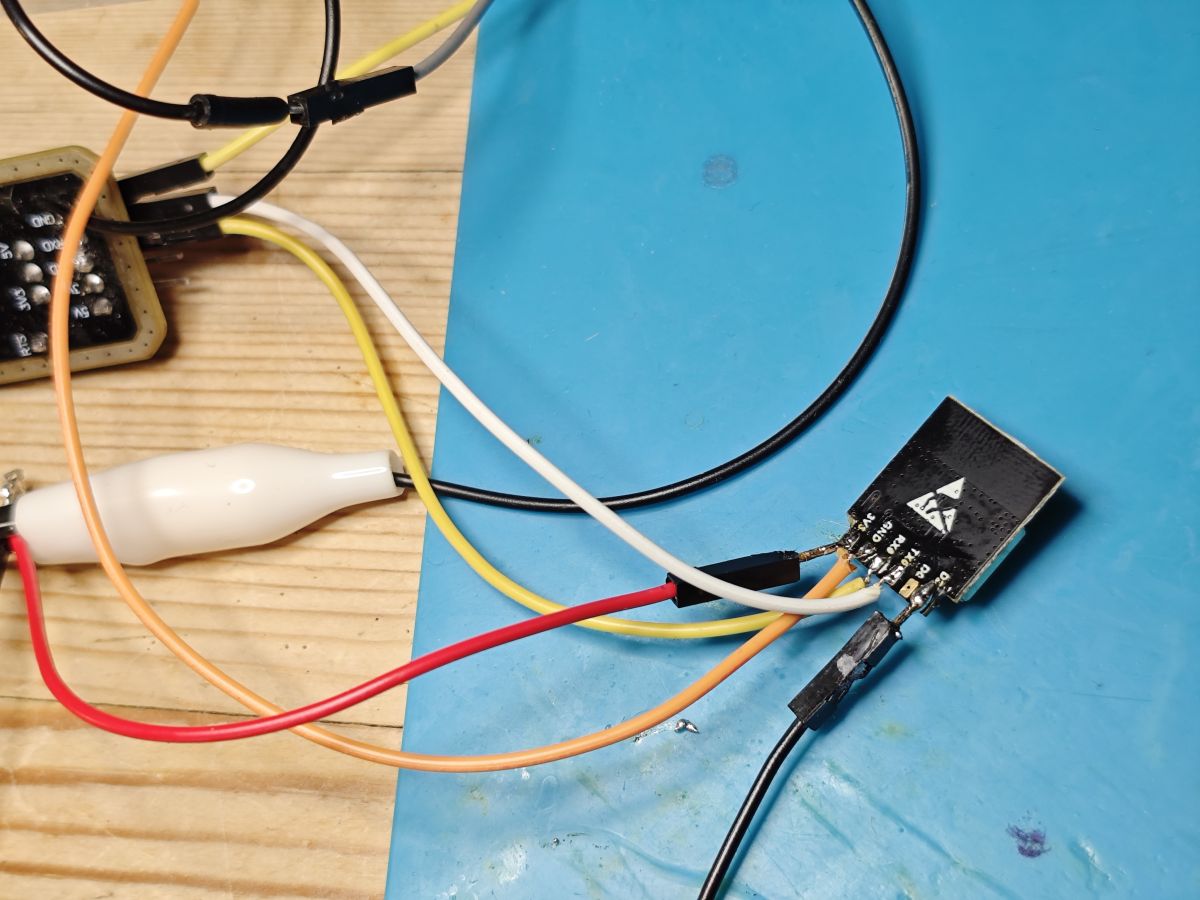

    I pulled IO28 high without resistor. Was ready for read at power-on, like BL602.
    Zigbee XT‑ZB2 module with soldered wires on a blue mat Small circuit board with connected wires on a blue work mat
    Read flash ID -
    c2201480
    Screenshot of Buffalo Lab Dev Cube with UART/COM8 settings and a green “Success” status bar.
    Read flash
    Screenshot of Buffalo Lab Dev Cube showing UART/COM8 settings and a green “Success” status bar.
    flash is empty :/
    didn't manage read in EF though at any baud

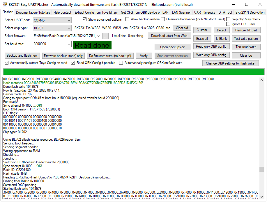

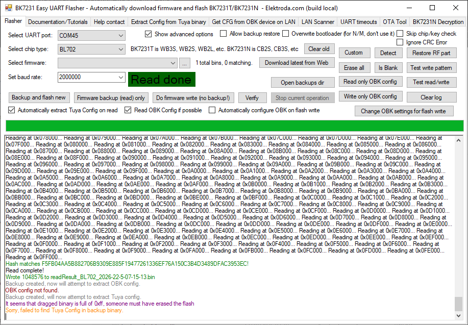

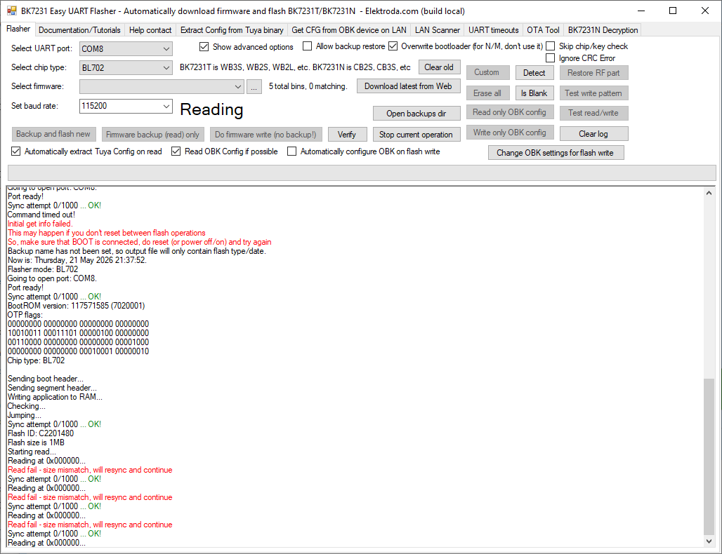

    Screenshot of BK7231 Easy UART Flasher showing flash reading log for BL702 on COM8

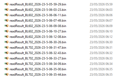

    Added after 9 [hours] 29 [minutes]:
    with some changes to align BL602/BL702 more closely with how BLDC handles these, I have been able to read from BL702. BL602 2M baud also now OK.
    Backup Flash on Zigbee XT-ZB2 BL702 Series Module Without Exposed GPIO8
    https://github.com/openshwprojects/BK7231GUIF...e/main...divadiow:BK7231GUIFlashTool:bl602702

    #25 21908273
    Posts: 5105
    Help: 441
    Rate: 902
    insmod wrote:
    What did you replace BL702 floader with? 32m?
    used:
    chips/bl702/eflash_loader/eflash_loader_32m.bin
    insmod wrote:
    Was it necessary to replace 602 rc32m floader with 40m?
    probably not. it was one of the things to align with BLDC default, like BL702. can change
    used:
    chips/bl602/eflash_loader/eflash_loader_40m.bin
    Added after 35 [seconds]:
    insmod wrote:
    P.S. do you think you can add BL616 support?
    It requires flash configuration in bootrom mode
    could try
    Added after 20 [minutes]:
    divadiow wrote:
    can change
    lmk which course of action
  • #26 21908297
    Keep both floaders, since BL602 firmware is build with 40m xtal in mind.

  • #28 21908471
    Posts: 5105
    Help: 441
    Rate: 902
    hmm. it's not good at low bauds now. I'm working on making it better
  • #29 21908496
    Posts: 14663
    Help: 656
    Rate: 12678
    But is it a regression on other BLs? If not, we can merge it anyway.
  • BL602 baud-rate regression fixed below 460800
    #30 21908513
    Posts: 5105
    Help: 441
    Rate: 902
    regression for BL602 baud below 460800. Timings. Testing fix now.
    Added after 46 [minutes]:
    OK. Current code is testing 100% success first-try at every baud in Easy Flasher read and write on BL602 and BL702 - dev board/module. backup files are identical. BL702 FlashDump example bin boots fine.
    floader file names are reflective of their type
    https://github.com/openshwprojects/BK7231GUIFlashTool/pull/124

How do I put an XT-ZB2 BL702 into UART bootloader mode without GPIO8?
Pull D28 up to 3.3 V through ~10 kΩ. D28 has an internal pulldown. Power-cycle or toggle EN low then release to reset. Connect to the module’s TX/RX header at 2,000,000 baud. This sequence enters the BL702 flashing mode on XT-ZB2. [Elektroda, XJ_, post #21104476]
What UART settings and pins should I use on the XT-ZB2 header?
Use UART0 at 2,000,000 baud, 8N1. Wire your USB‑UART adapter to the module’s TX and RX header pins. Provide 3.3 V to the 3V3 header pin and GND to the GND pin. Keep signal levels at 3.3 V. [Elektroda, XJ_, post #21104476]
Do I need to use Chip_EN/EN to flash the BL702?
Not strictly. The module entered flashing mode with D28 pulled high and worked without using ChipEn. EN held low disables the module, and releasing it restarts. Use EN only if you need a clean reset. [Elektroda, XJ, post #21103904]

What is the XT-ZB2 pinout and what do the pins do?
Highlights: EN (Pin 1) disables when low and restarts when released. D25 is the button (short=toggle, long=pair). D26 drives the LED (blinks in pairing). D0 controls the relay (active low). D28 is the boot pin; add ~10 kΩ to 3.3 V for flash mode. TX/RX are 2,000,000 baud. [Elektroda, XJ_, post #21104476]
