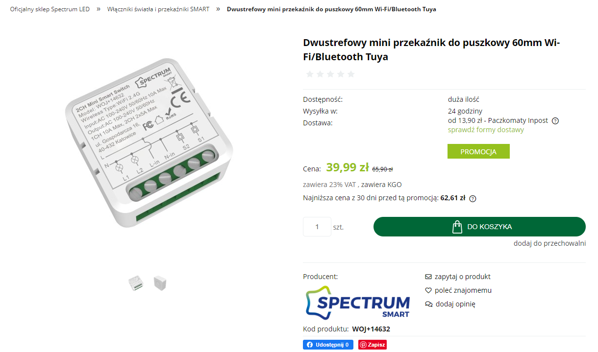

    2CH Mini Smart Switch Spectrum WOJ+14632
    Two-channel mini relay for boxing 60mm, shown on the Spectrum LED store page with a price of 39.99 zł.
    https://sklep.spectrumled.pl/pl/p/Dwustrefowy...znik-do-puszkowy-60mm-Wi-FiBluetooth-Tuya/320
    It is also available on allegro.com.

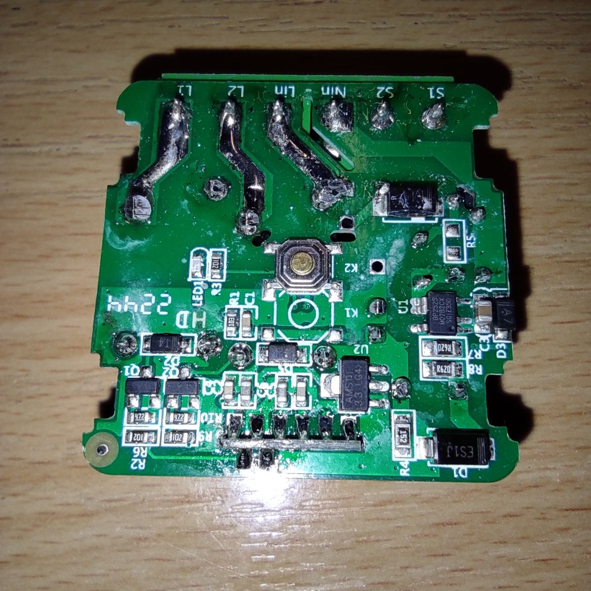

    Disassembly is very easy. You don't need any tools. Just use your nails.
    Close-up of a circuit board with electronic components.

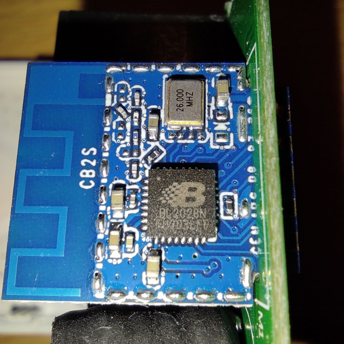

    Close-up of CB2S module with BK7231N chip.
    PCB of a 2CH mini relay with electronic components.
    As you can see the board and elements are identical as described in the another topic. However, I managed to flash it without disassembling and soldering so I decided to describe this process here.

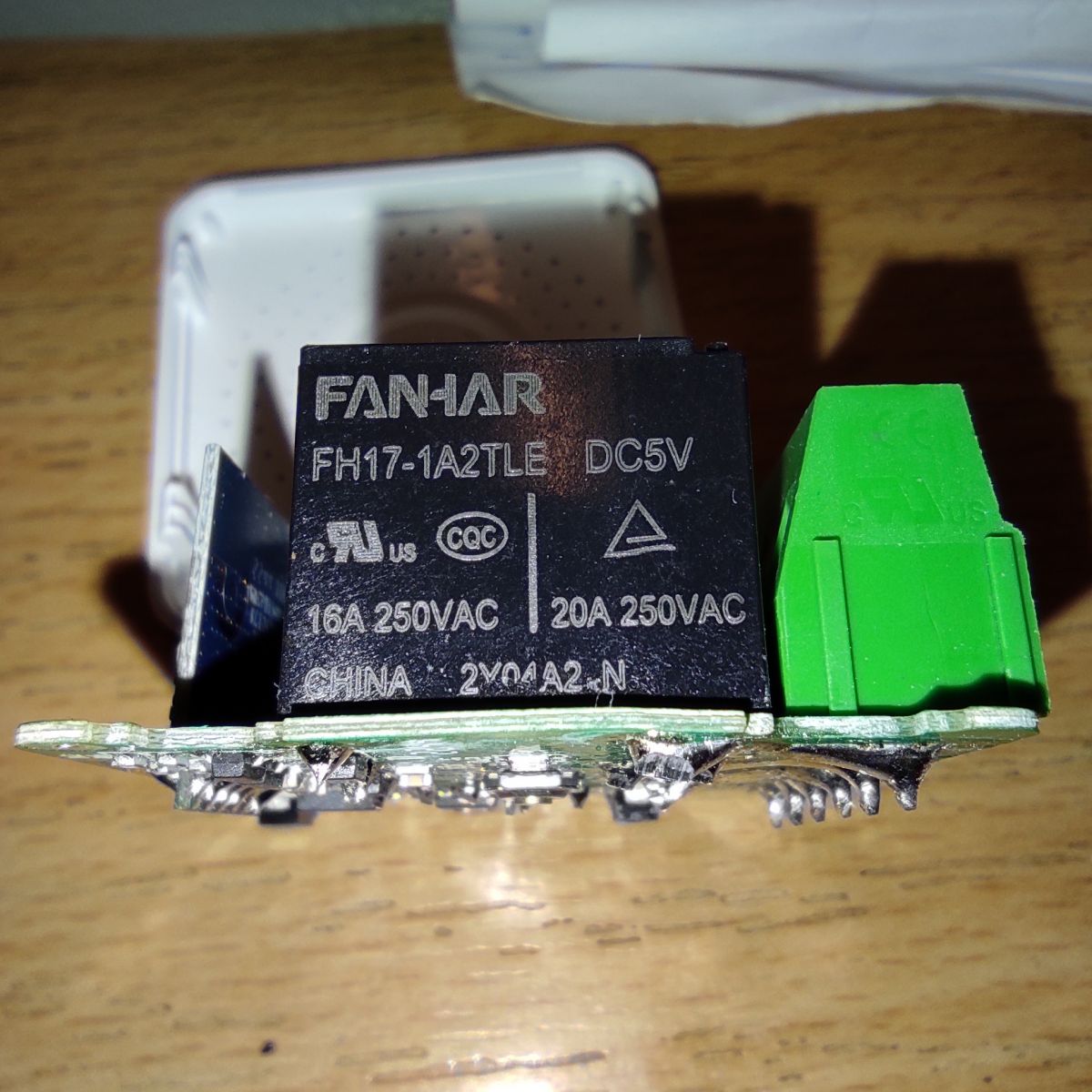

    Most of the sellers/distributors rate this device as 16 A. And it even agrees with what is printed on the relays:
    Close-up of a FANHAR FH17-1A2TLE DC5V relay module mounted on a circuit board.
    But this device is rated 2 x 5 A which is probably closer to reality.

    Device seems to be using CB2S module, which is using BK7231N.
    And the Tuya section starts at UNCOMMON POSITION 0

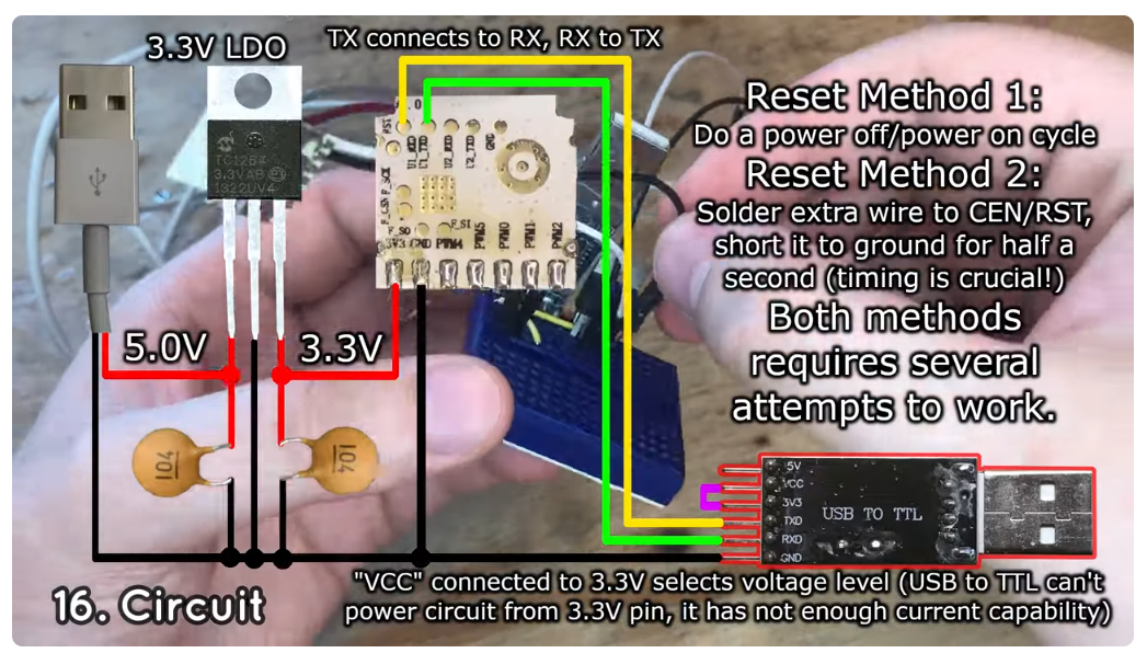

    Well, I don`t know if this is another error, but I don`t know this method very well....
    As for uploading via UART, I recommend using our new flasher:
    Here you can see from the hardware side how to do it:
    NOTE: The above videos may use hid_download_py or bkWriter 1.60, but these are outdated solutions. Now we upload via BK7231GUIFlashTool
    EDIT: If you don`t have time to watch the whole movie, here`s an important frame:
    Circuit diagram and photo of a setup for UART programming with reset instructions.
