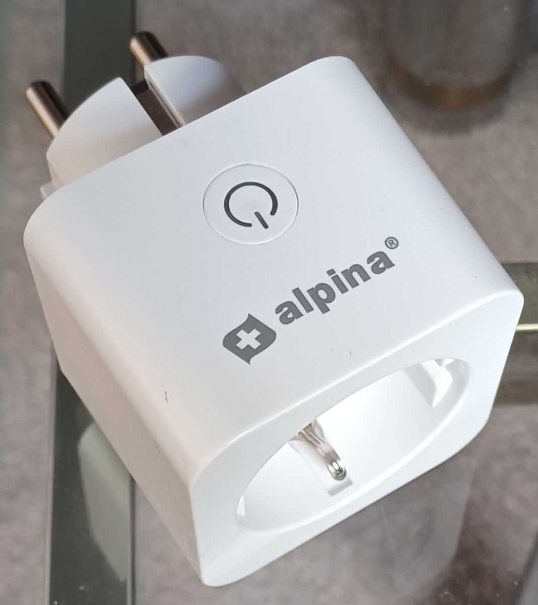

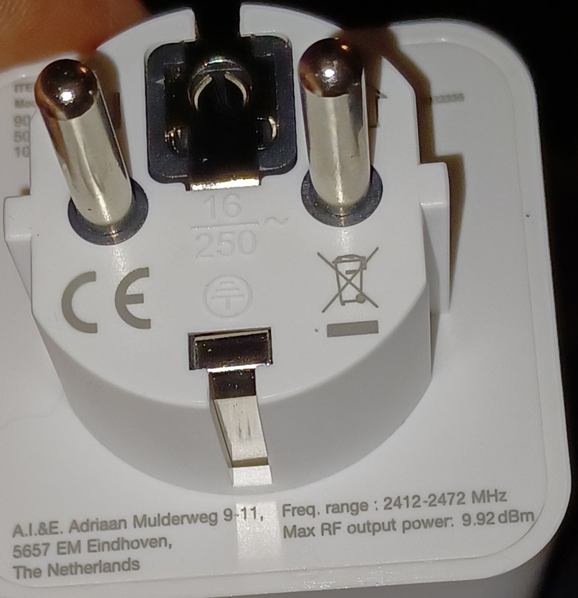

    I bought a 10Amp 240V smart connection plug/switch from Alpina in a French warehouse for 11€.
    It said it was remotely controllable with an app Alpina Smart.
    This is how it looks after unboxing :
    White Alpina smart plug with a button on top. Rear view of a white smart plug with visible metal prongs and manufacturer information. View of the back of a smart plug with technical information.

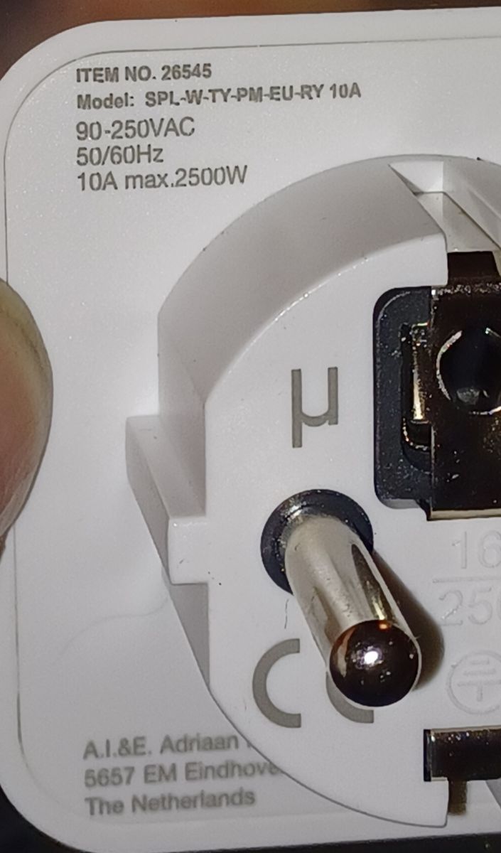

    I see a reference number 26545 and the model says SPL-W-TY-PM-EU-RY 10A.
    It's a product which is distributed by the Dutch company A.I.&E. I had never heard of it...

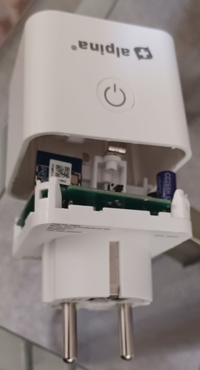

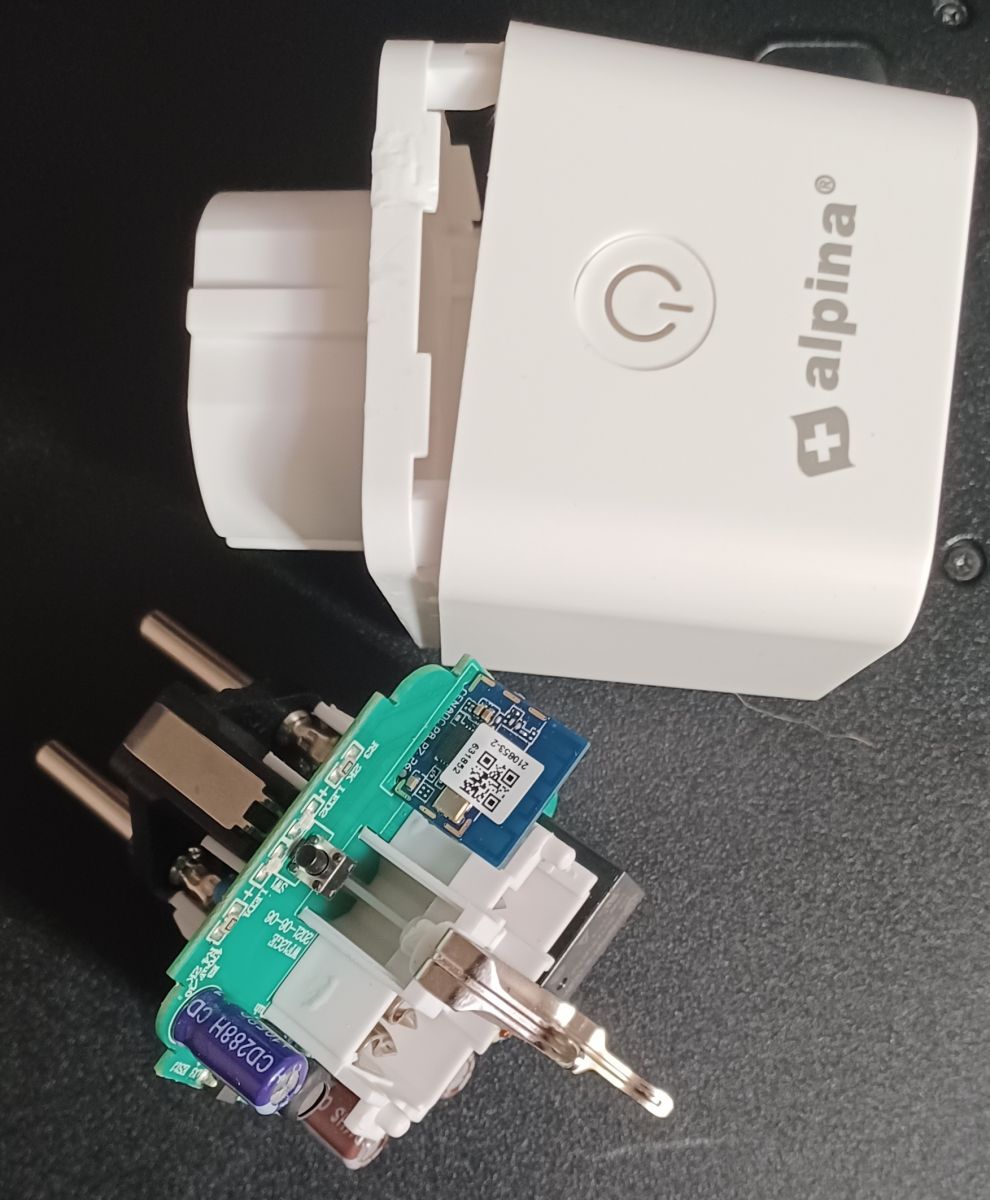

    Disassembling the plug wasn't too difficult.
    Wiggeling with a small screwdriver and pulling away the outer cap (which contains the button) was straight forward and not so difficult.

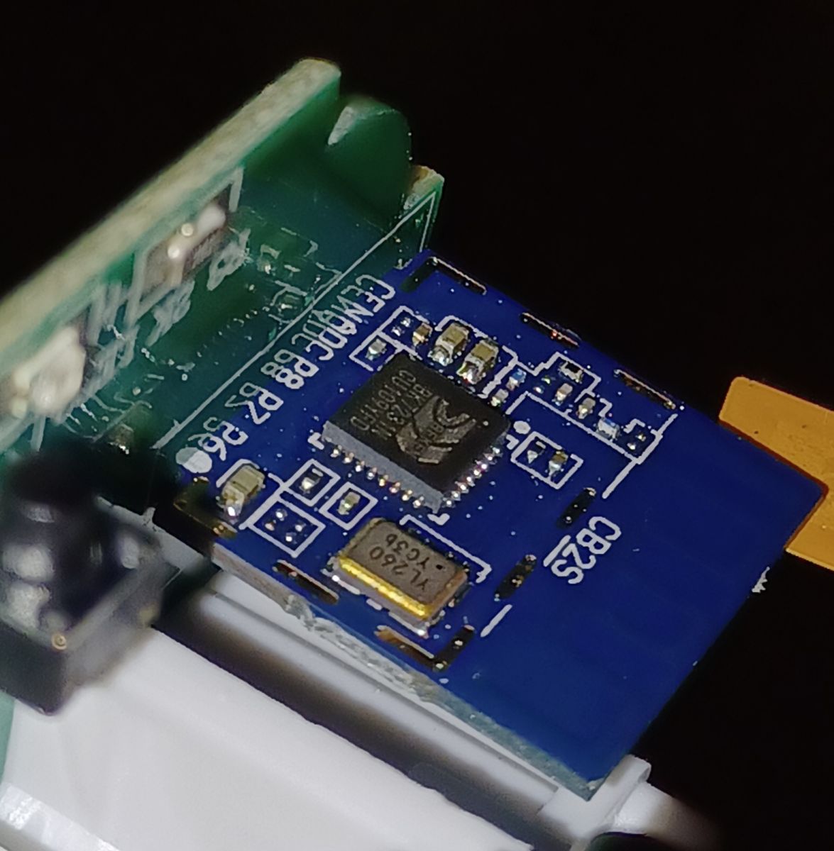

    Disassembled Alpina smart plug with visible internal electronic components. Dismantled Alpina smart plug with visible CB2S WiFi board.

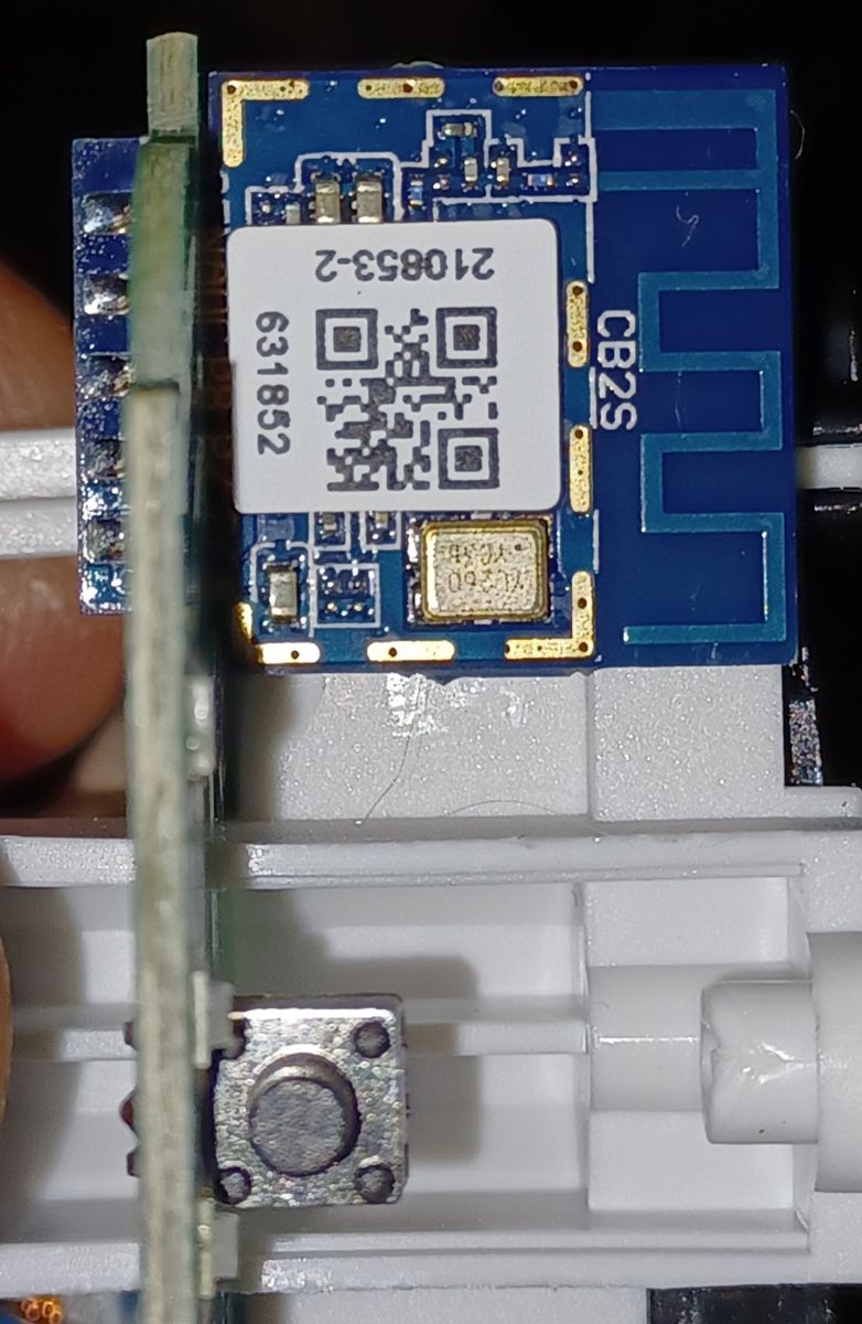

    On the inside there is immediately the blue CB2S WiFi PCB visible, which contains the BK7231N chip.

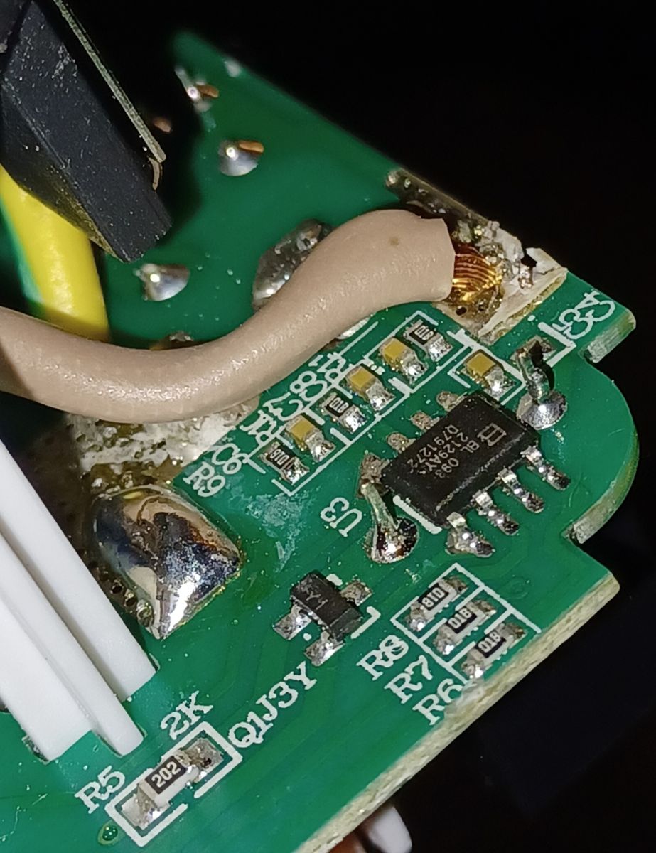

    There is also a measurement chip with the reference "BL 093", though I couldn't red the last digit of that reference.
    Close-up of a blue CB2S WiFi board with BK7231N chip.  Close-up of a smart plug circuit board. Close-up of the blue CB2S WiFi module in a smart plug.

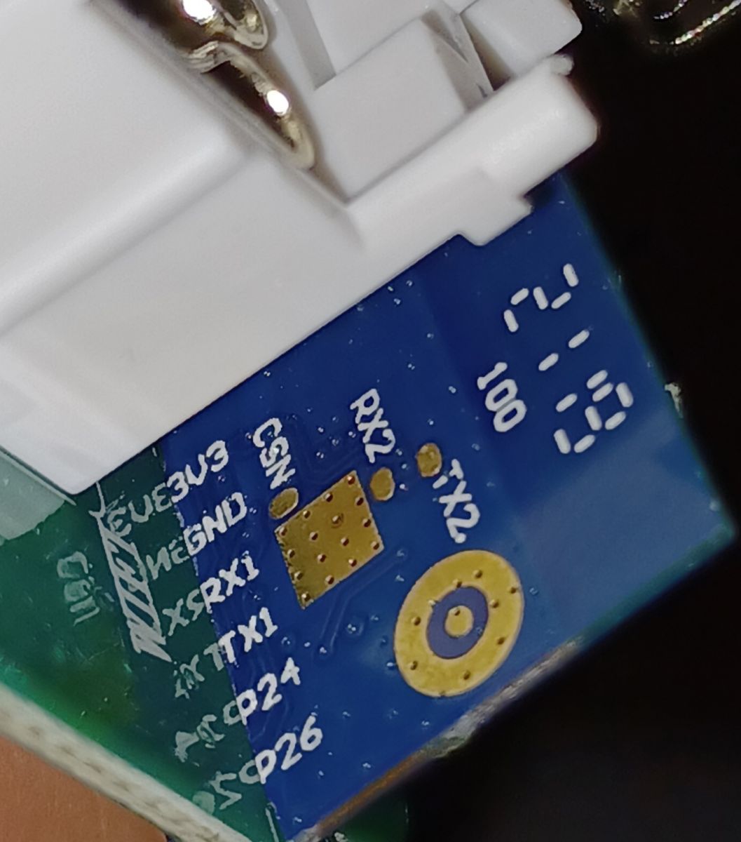

    I unsoldered and removed the blue CB2S PCB and flashed it with the flashing tool that I found on this github website : https://github.com/openshwprojects/BK7231GUIFlashTool
    For doing so, I connected 3V3, GND, RX1 and TX1 with an USB UART device, connected to com3. Then I downloaded the existing firmware and flashed the most recent open source firmware (OpenBK7231N_QIO_1.17.603) which can be downloaded directly via the flashing tool.
    Close-up of the blue CB2S WiFi PCB with pin labels

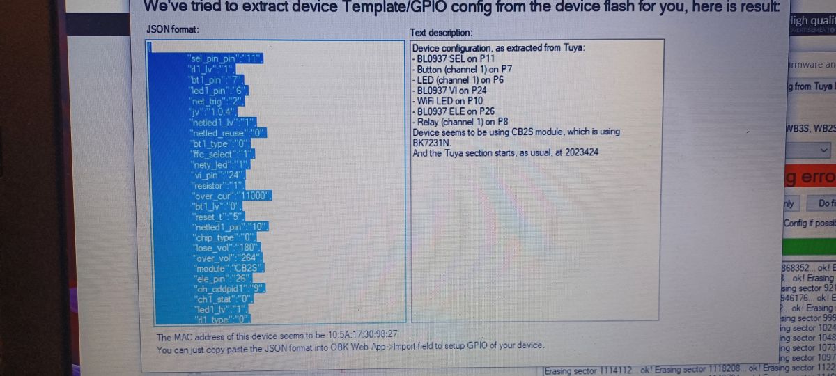

    During flashing this screen appeared with information about the pins assignment :
    Screen capture with extracted GPIO configuration results from the device.
