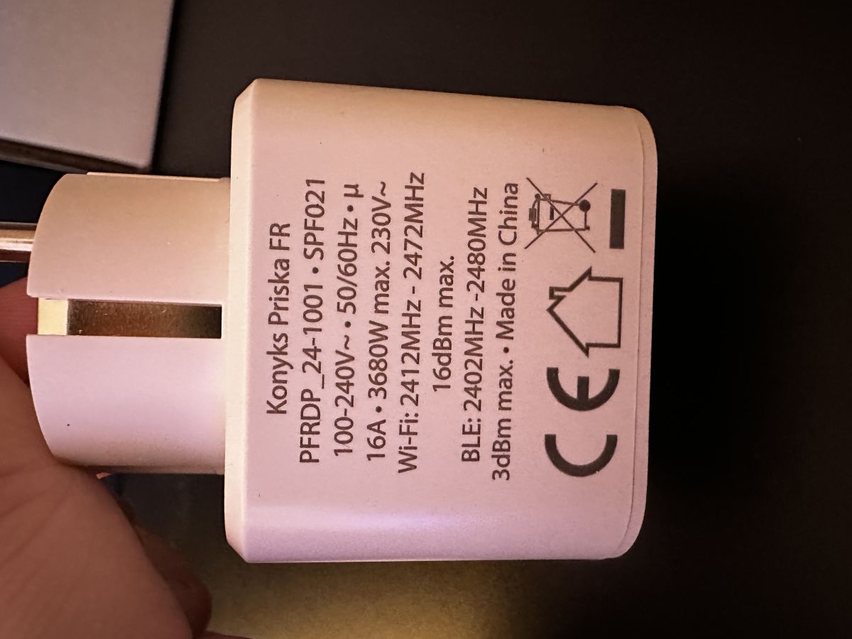

    I was given a pair of Konyks Priska FR, Smart Plug with integrated 16A energy meter (https://konyks.com/produit/priska-fr-dual-pack/).:
    Konyks Priska FR smart plug showing technical specifications on its casing.

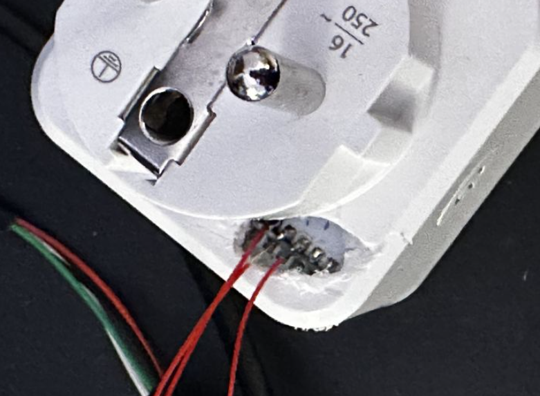

    For the first plug, I cut the "female" part (top) - but this is not necessary. So don't do that !

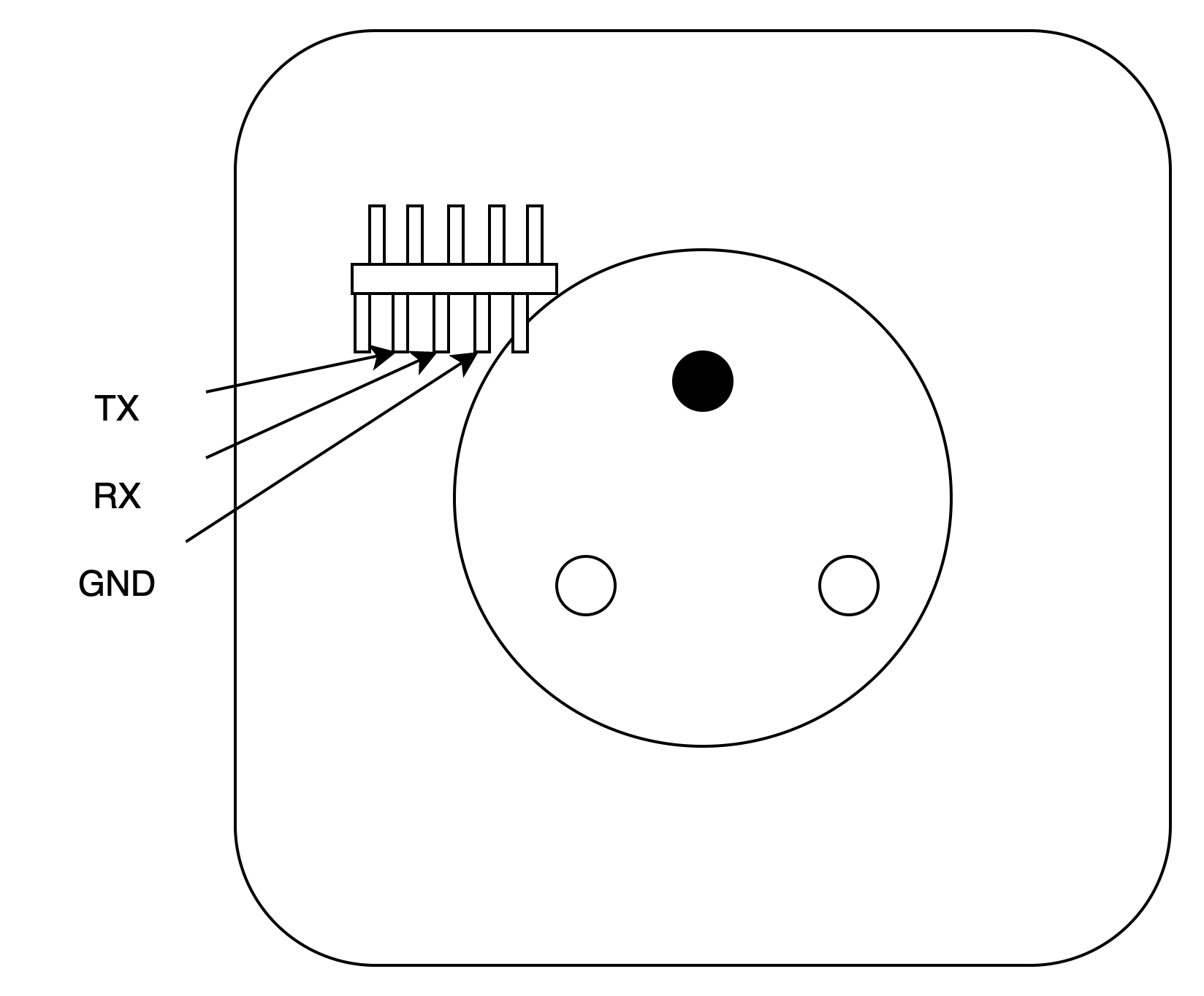

    What you just need is to access the 3 pins GND/RX/TX of the CB2S (BK7231N) board.
    This can be achieved by cutting a small plastic area - as per picture below:
    Close-up of a Konyks Priska FR smart plug with visible wires connected to its pins.
    Attaching a simple serial-TTL confirms the chip is well recognized, after keeping the button selected pushed twice, until the blue led blinks slowly.
    Pin connection diagram to an electrical socket showing pin view.

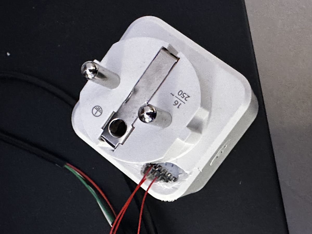

    PS: This is a creative method of flashing pins access:
    View of an electrical plug with exposed pin access and connected wires.
    I did the same for one batch of plugs that were very hard to open.
