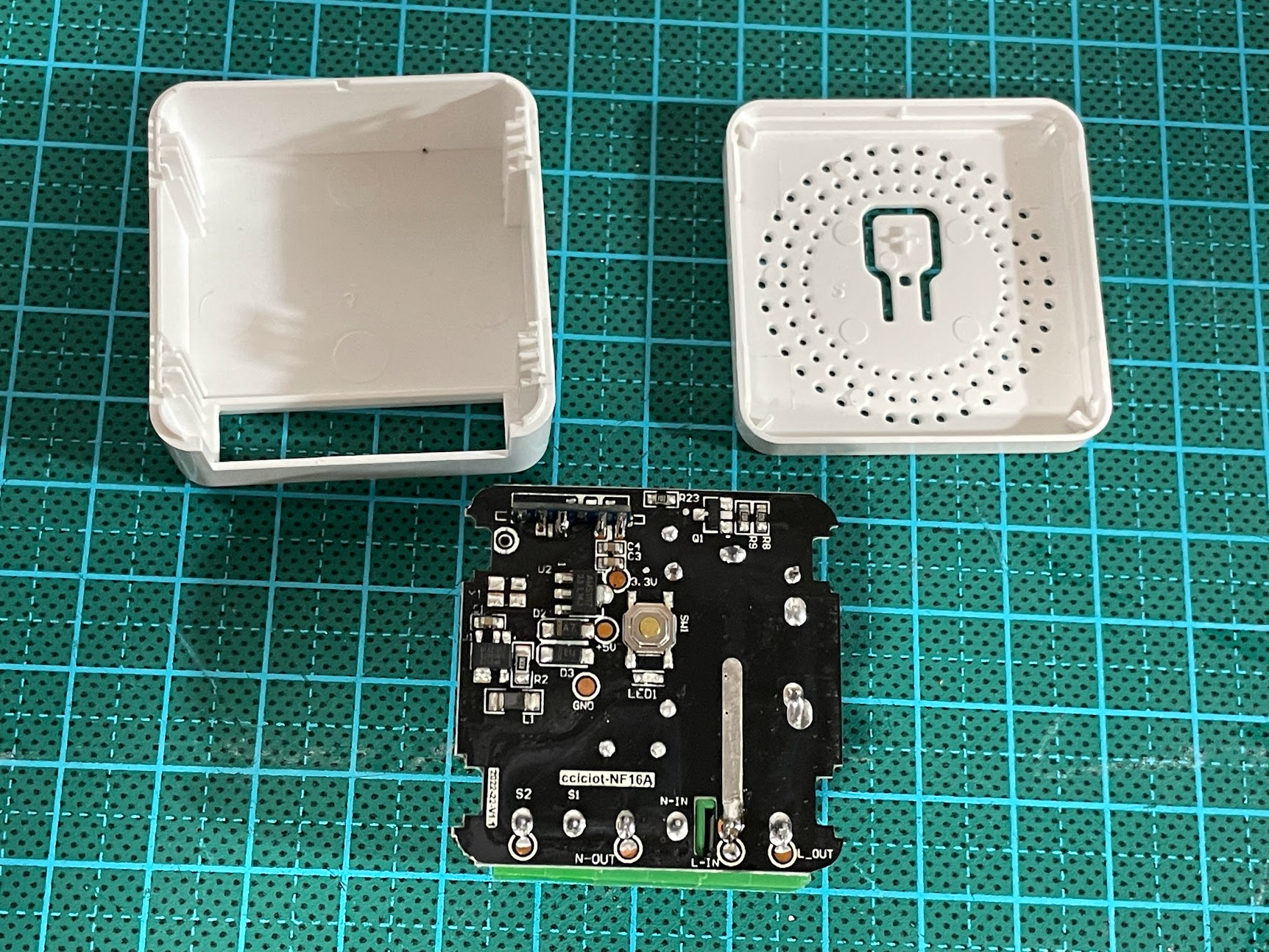

  • Hey all -
    Yet another small in-wall relay. Looks very similar on the outside to the Aubess model, but it seems with a different board (so I figured it was worth it's own thread.)
    Product URL: https://www.amazon.com/dp/B08RBNG2TX?psc=1&ref=ppx_yo2ov_dt_b_product_details
    [BK7231N] COLOROCK Mini Smart Relay WiFi Switch 16A [BK7231N] COLOROCK Mini Smart Relay WiFi Switch 16A
    Chip: CB2S (BK7231N) https://developer.tuya.com/en/docs/iot/cb2s-module-datasheet?id=Kafgfsa2aaypq

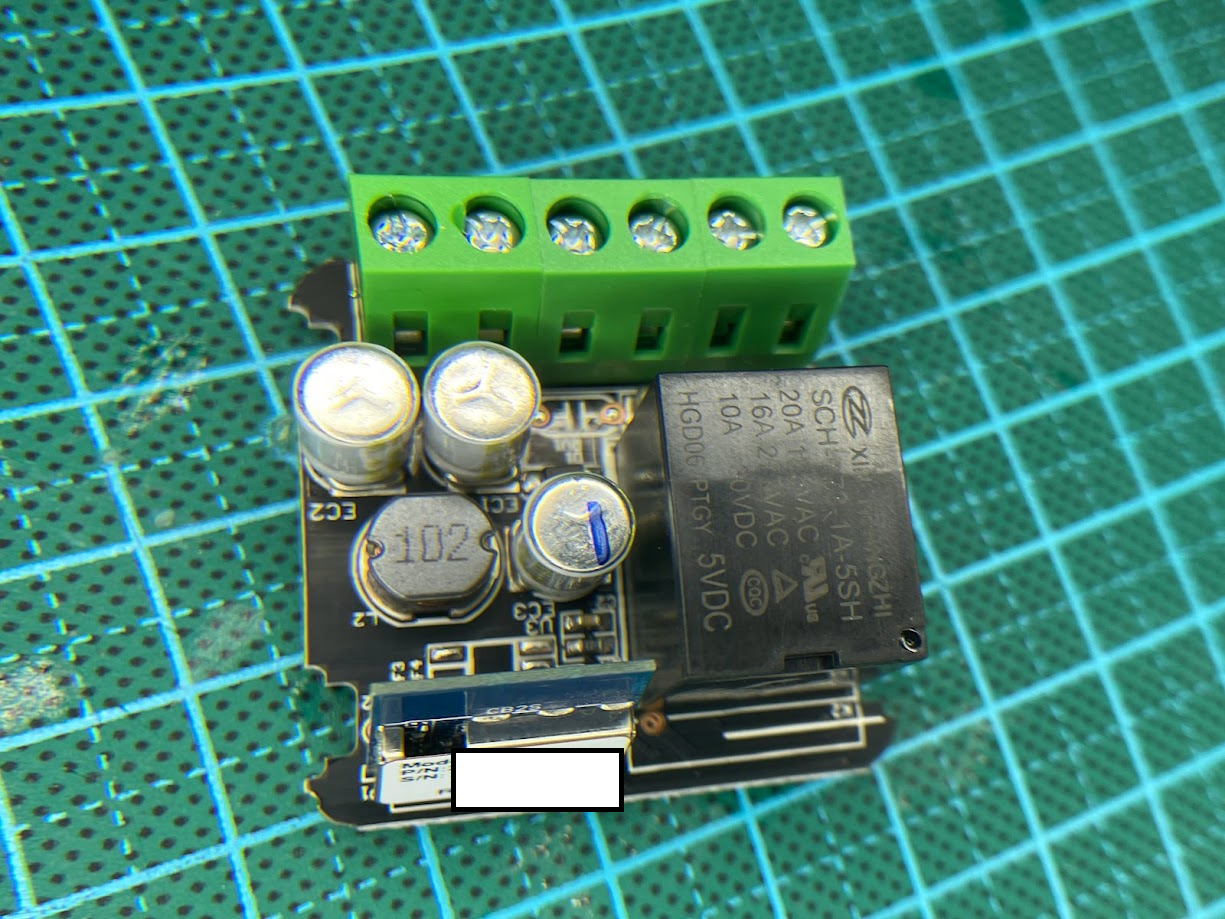

    Flashing:
    [BK7231N] COLOROCK Mini Smart Relay WiFi Switch 16A [BK7231N] COLOROCK Mini Smart Relay WiFi Switch 16A [BK7231N] COLOROCK Mini Smart Relay WiFi Switch 16A [BK7231N] COLOROCK Mini Smart Relay WiFi Switch 16A [BK7231N] COLOROCK Mini Smart Relay WiFi Switch 16A

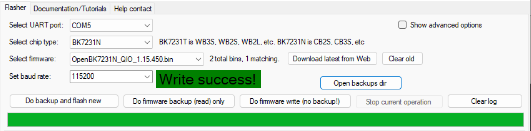

    Simple enough to flash, solder directly to the Tuya chip (no need to disconnect). Use BK7231Flasher at a 115200 Baud Rate.
    I have a copy of the original firmware backup, not sure if that would be helpful / where to upload.
    OpenBeken Config:
      "pins": {
        "8": "LED;0",
        "24": "Rel;0"

  • #2 20471358
    Posts: 14745
    Rate: 12840
    Thanks, it seems like a very simple device, but I think you are still missing at least one IO role. The button on the case is separate from the switch, I think.
    Btw, you can upload the binary 2MB here, as an attachment.
  • #3 20471512
    mattj
    Posts: 42
    Rate: 16
    Yes, you are correct about the button. I never bothered to test it (don't feel comfortable touching on the device while it's connected to the mains voltage), since I don't intend on using it.
    I've got a second one here (not yet flashed) and I'll see if I can trace the pin for the button.
    Edit: the button seems to go back to the TX1 pin (based on my multimeter) - haven't tested it though.

    Okay, so we know where is the button, then which pin is used for the switch? For the toggleChannelOnToggle role?
  • #7 20478741
    mattj
    Posts: 42
    Rate: 16
    Sorry not sure I follow the question? The config I found that works is to set P24 as a Relay.

    How is the power supply of this module? What system is responsible for the 230V / 5V converters?
  • Primary-side feedback used in small flyback supplies
    #9 20481110
    Posts: 14745
    Rate: 12840
    @szymon122 in the smallest IoT gadgets that have recently appeared on the forum, there is practically always such a layout:
    different bones are used but always something like this.
    Sometimes I still come across small flyback power supplies (in slightly larger e.g. "smart" sockets/light switches) with feedback taken from the primary side without an optocoupler.
