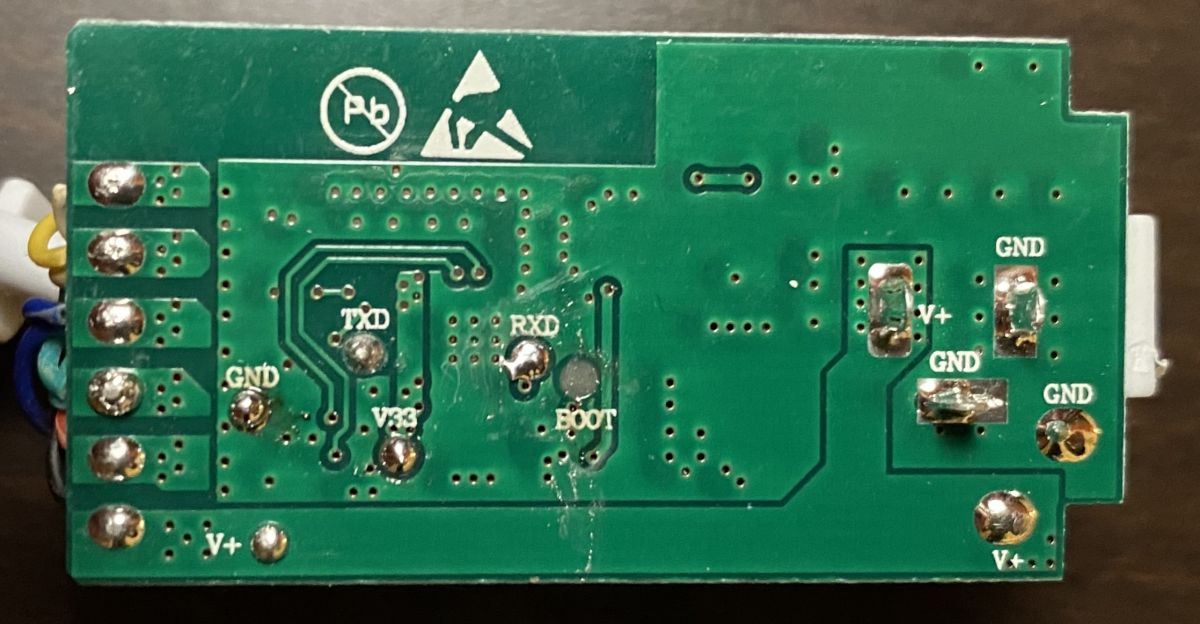

  • Hi,
    Like many perhaps I bought a Magic home controller expecting to flash Tasmota onto it and go from there...
    Turns out there is a different chip in side, and there you go down the rabbit hole. Thanks to someone with, I guess, a lot of perseverance and this beautiful community I could get this controller Magic home Wifi Led controller rgb + cct:
    New teardown of Magic home WIFI RGB CTT controller
    with what turned out to be a BL602 chip inside to work.
    The insides, front and back are show below:
    The PCB identification read ZJ-BWCG-VC-RGBWW V1.1
    Chip close-up attempt:
    It took some tracing and measuring but I found the correct pinout for all channels and though I give something back to the community.
    The configuration I entered worked for me:
    P3 PWM Channel 2 / Green
    P4 PWM Channel 0 / Red
    P17 PWM Channel 3 / Cool white
    P20 PWM Channel 4 / Warm white
    P21 PWM Channel 1 / Blue
    Many thanks!

    Thank you for your presentation. It's good to mention that our OpenBL602 firmware supports now OTA - updating firmware via WiFi. It was not possible in the past but now you can just flash once by wires and then update many times wirelessly.

    Yes I found the OTA option, and I was banking on it too, as the device is now boarded up and only accessible with a lot of effort. That was why I could not post a picture of the case after forgetting about it previously.
    Do you know if, and how, this template will be made available to others?
