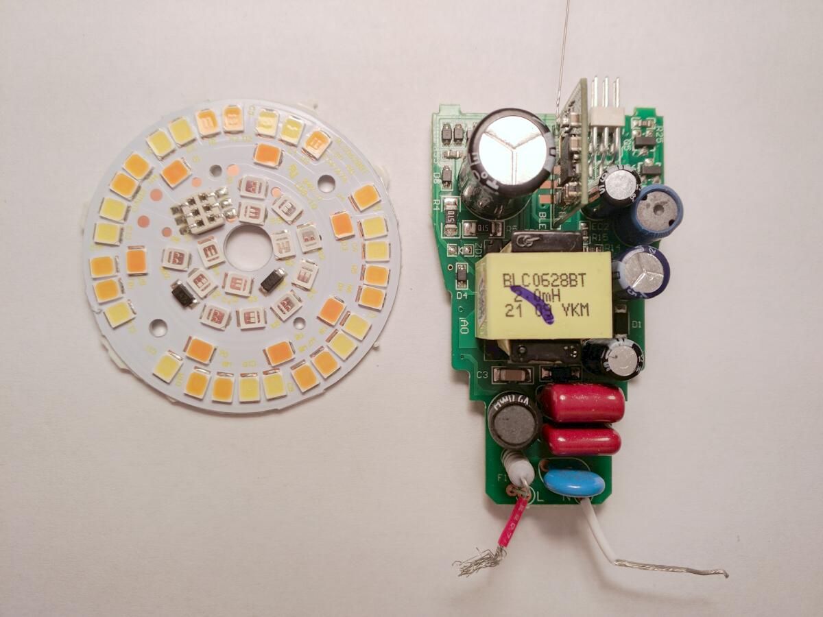

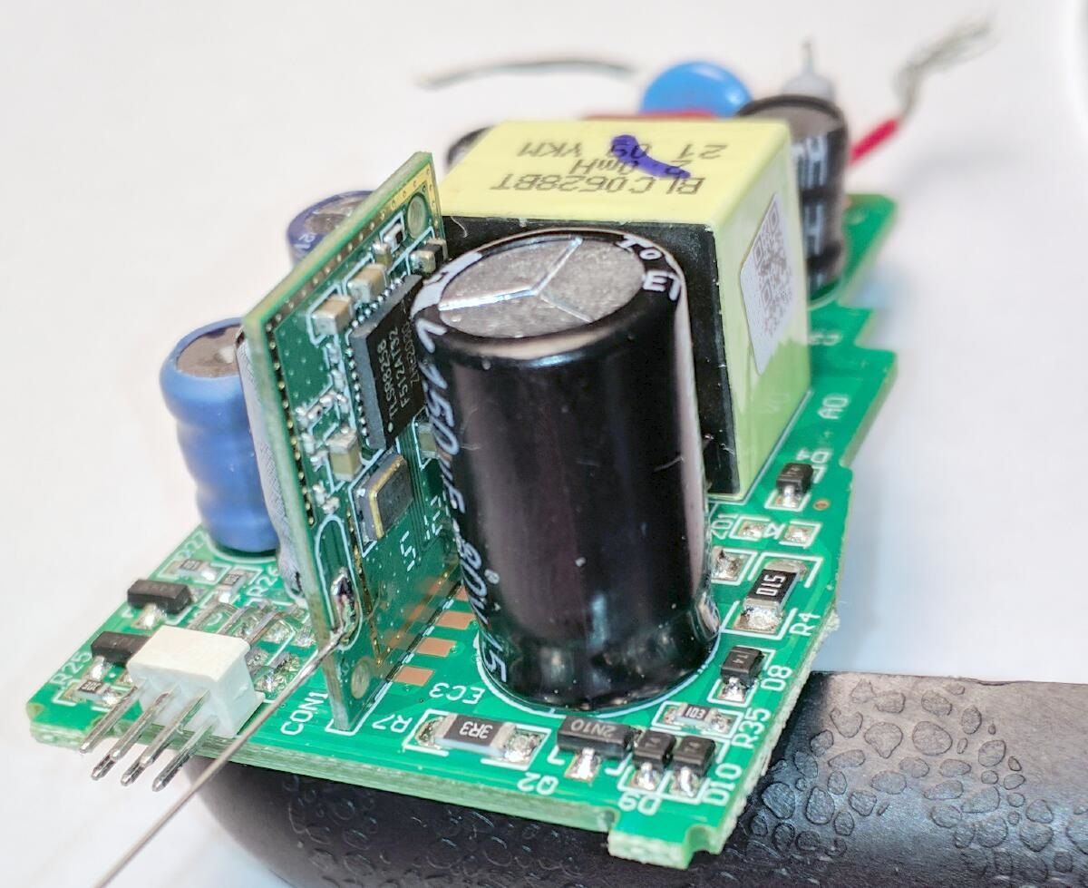

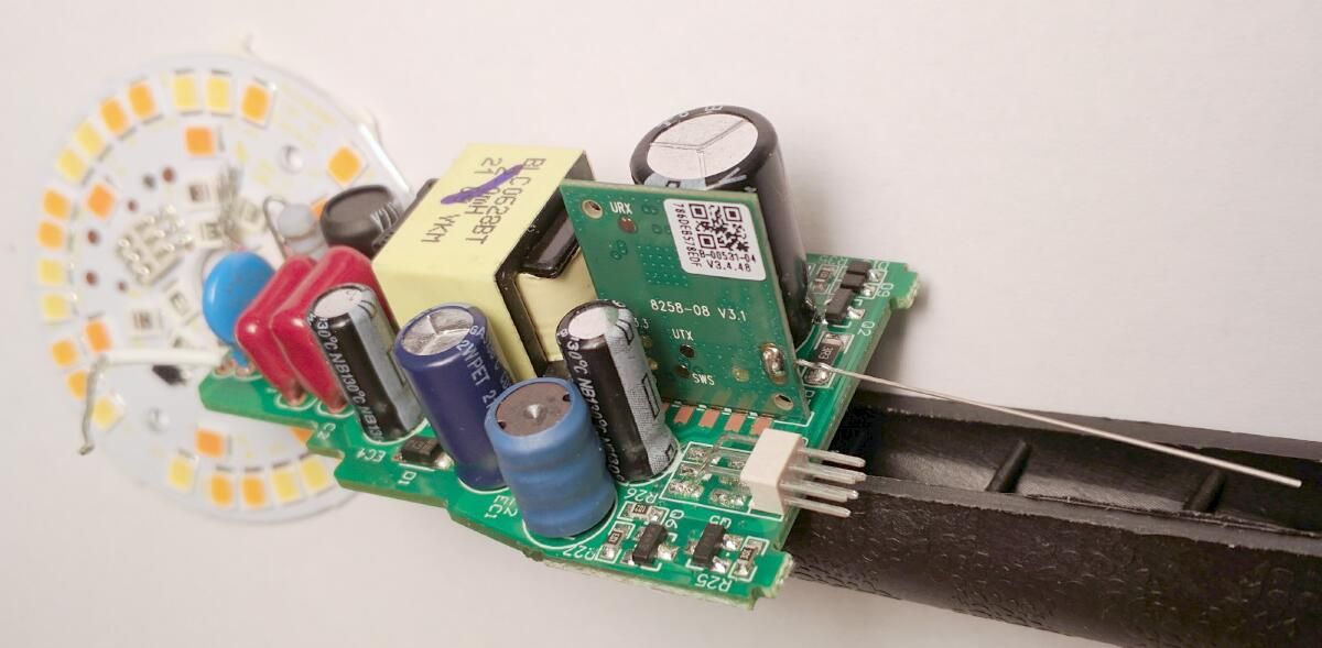

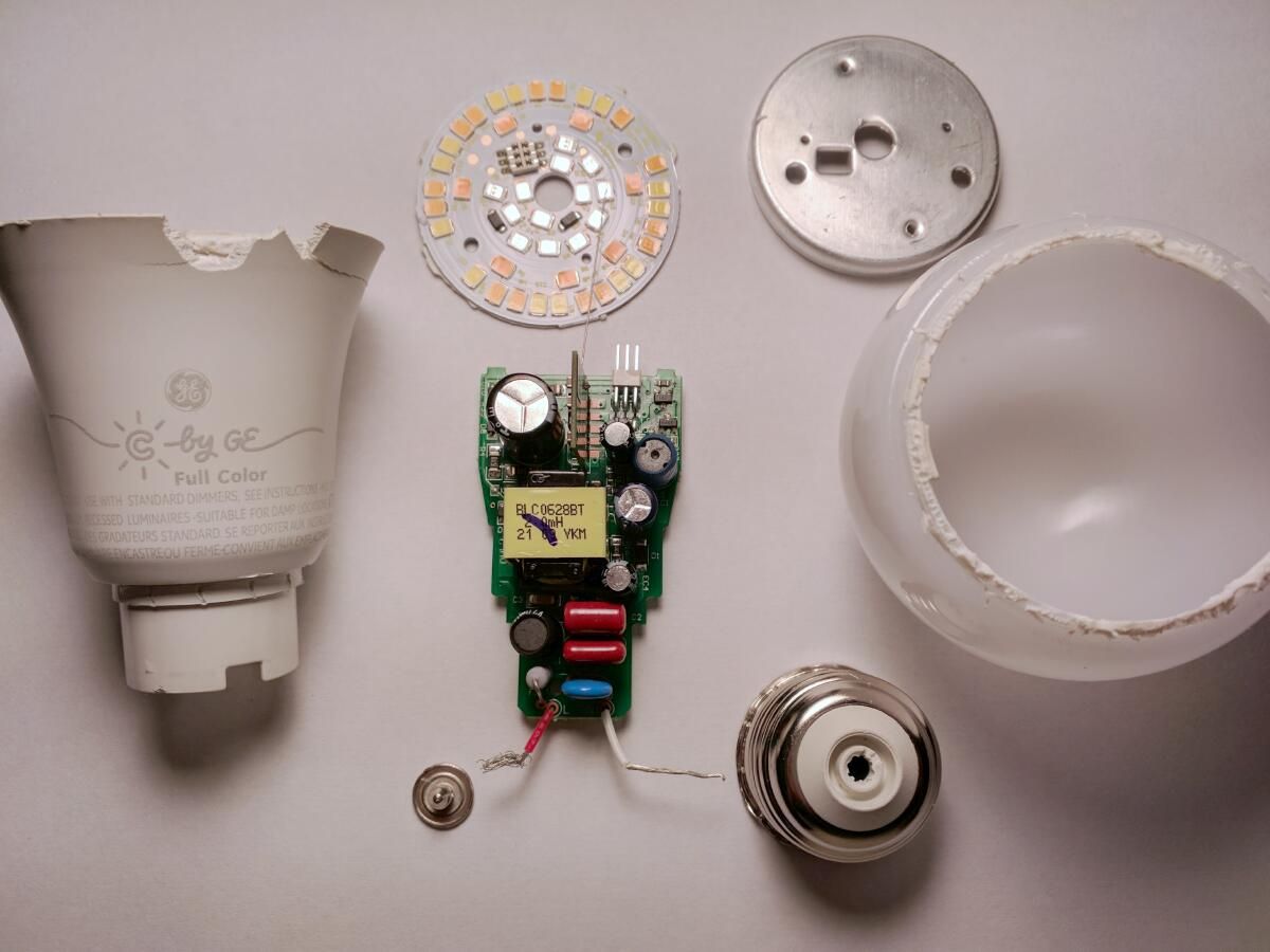

    GE Full Color Dimmable Smart Bulb with TLSR8258.
    These nice bright and light and quite efficient Smart Bulbs come with a horrible app.
    Must free the from GE's junk zombie control.

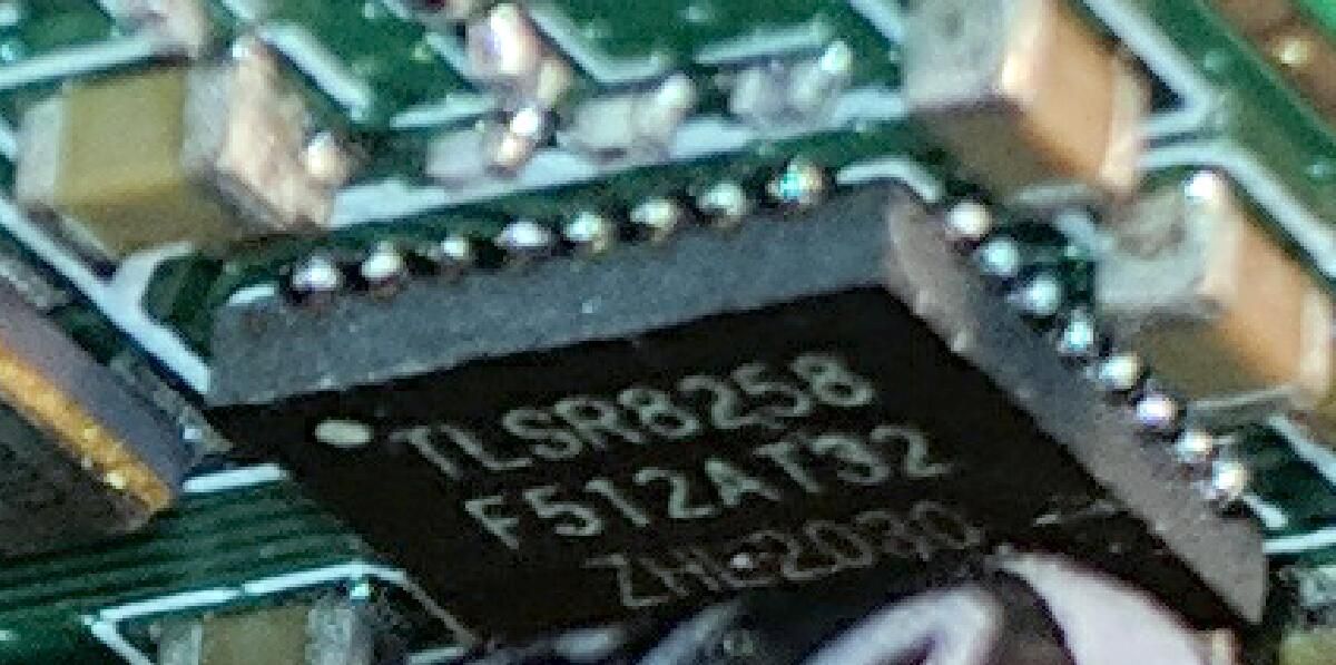

    Has anybody worked with TLSR8258?
    That's what's inside these really easy to open bulbs.
    I had watched a few smartbulb crackings, horrible I thought.
    I had prepared for a tough twist and crack and et rid of all that silicone junk session.
    But these have just a bit of silicone where the white plastic ball touches the base.
    The bottom center push-pin came out easily.
    It took maybe 2 minutes (mostly gathering the tools) to get them as you can see.
    But as easy as dissasembly was, freeing it softwarewise seems to be a problem.
    Unless somebody here succeeded already?

    @p.kaczmarek2 maybe they could extend OpenBeken to support this hardware :) Xiaomi also seems to do on TLSR8258.
  • #3 21115341
    insmod
    Posts: 1432
    Help: 168
    Rate: 455
    TLSR825x is a Zigbee/Bluetooth chip. If it has Zigbee firmware installed, then just connect it to the hub. If Bluetooth, then I don't know. I know that Home Assistant supports many Bluetooth LED types, so yours might be supported. As for custom ROM, I haven't seen one for LED. There are several for temp/humidity sensors, look for pvvx on GitHub.
