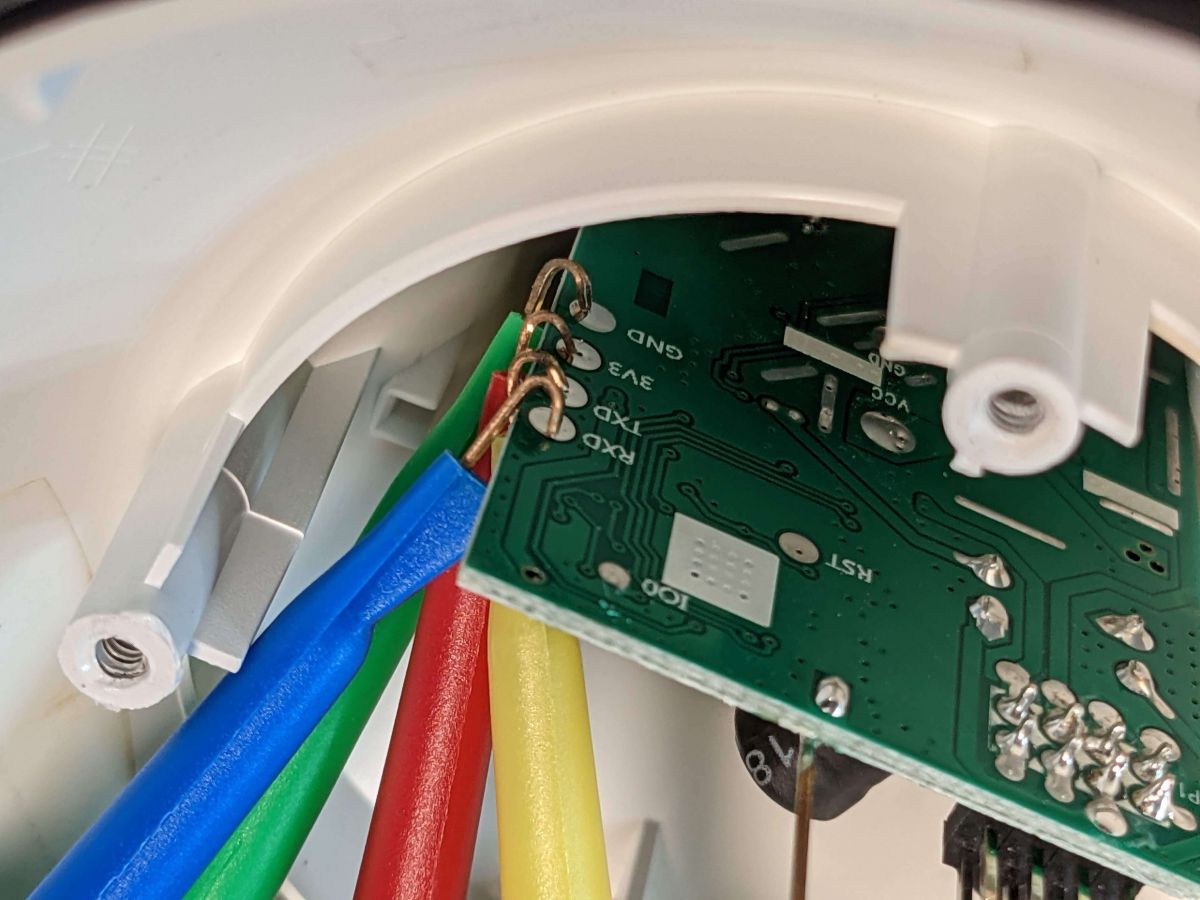

    @mike37
    No idea on the CRI/color accuracy but you’re welcome to try it out. 4 pack as low as $12 and cheaper if you buy more
    You don’t even need to solder it, you can just hook some probe clips to start flashing it
    Colored wires connected to a small green printed circuit board inside a plastic casing.

    I think I'm gonna buy a Teckin br30 to try it out. What's the procedure to put WLED on it?

    Thanks, this is all completely new to me. Would this require soldering then, I'm not quite clear how I would physically connect the bulb to the serial port?

    Tuya converts patched with the teckin bulbs so serial method is the only option

    So get one or few, and we will help you with flashing with serial method.
