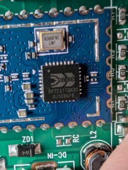

    Controller - BK7231T - WB3S
    Close-up of a BK7231T chip on a circuit board.

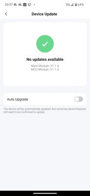

    Tuya version: 1.1.6
    Device update screen showing no updates available, with module version V1.1.6.

    Device seems to be using WB3S module, which is BK7231T chip.
    - LED Red (Channel 1) on P9
    - LED Green (Channel 2) on P24
    - LED Blue (Channel 3) on P26
    - LED Cool (Channel 4) on P8
    - LED Warm (Channel 5) on P6
    - Pair/Toggle All Pin on P1
