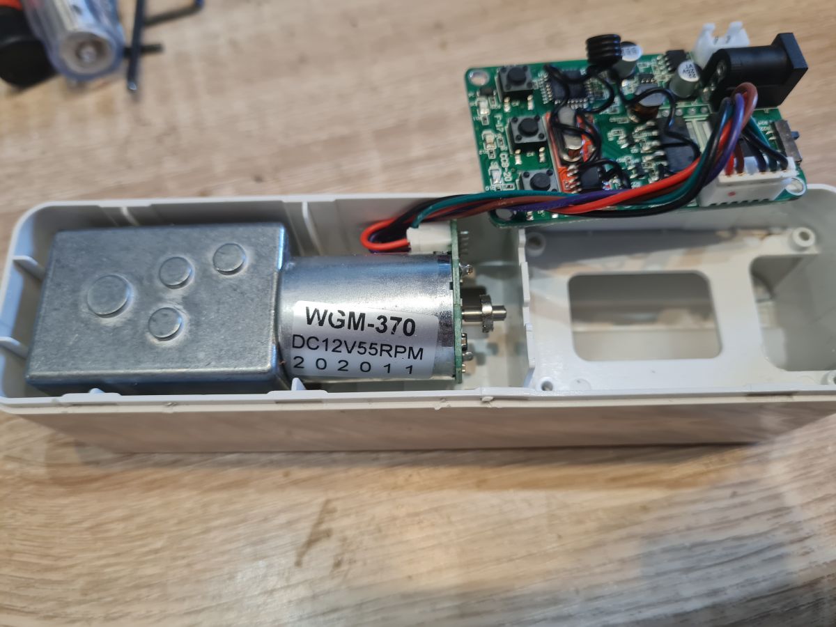

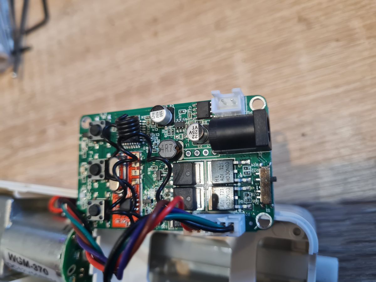

    Hi

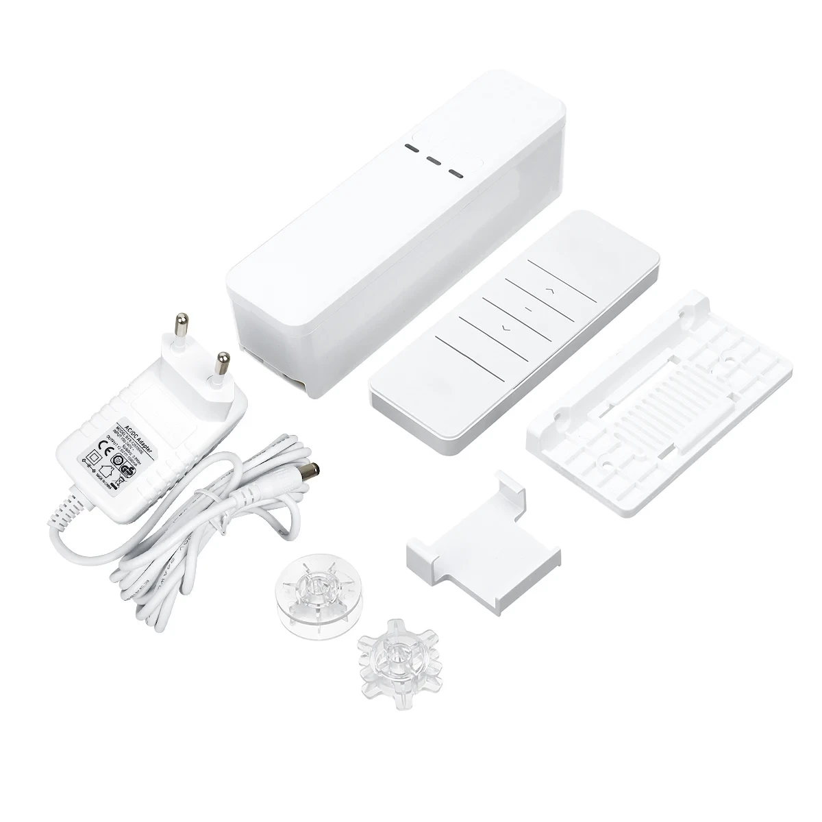

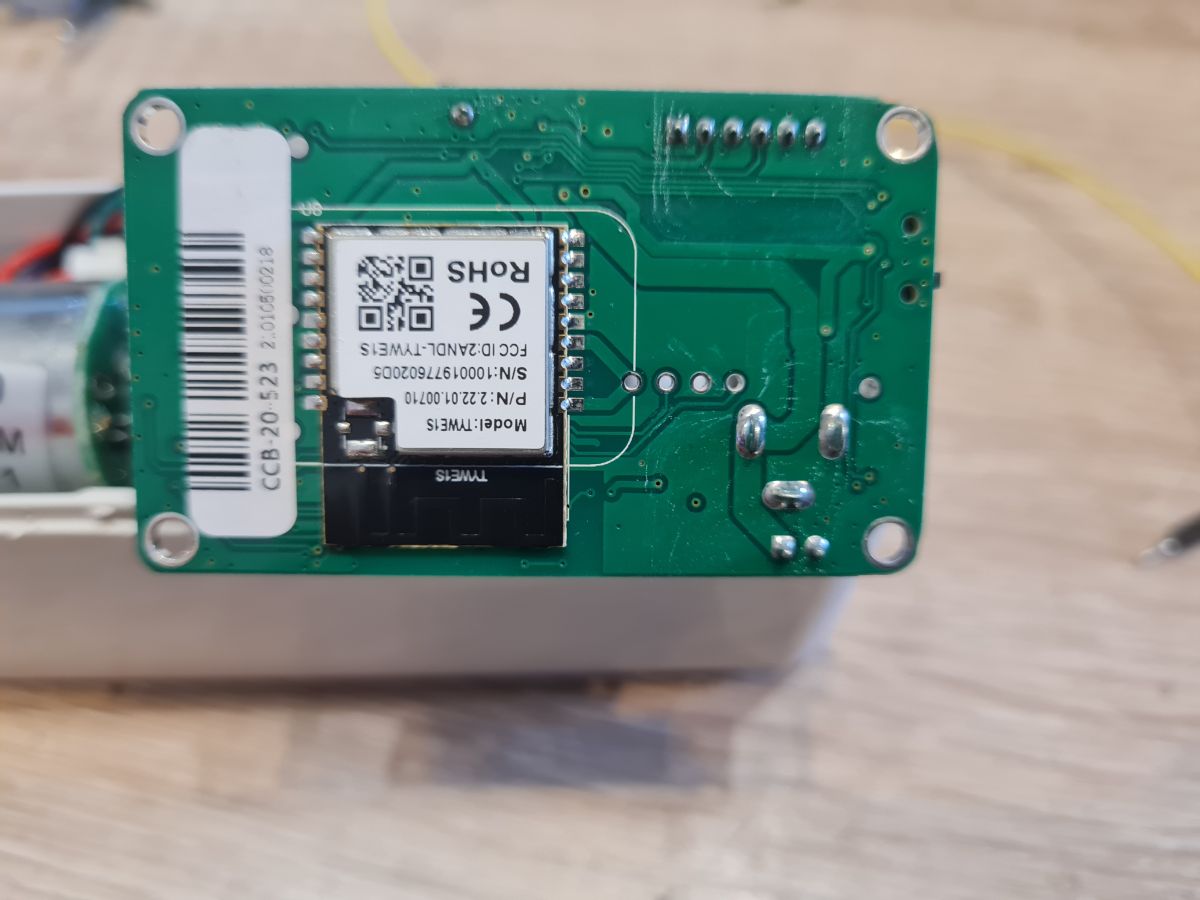

    Today I would like to flash a TYWE1S with this software instead of Tasmota
    company : AVATTO
    model number : CM01
    order provider url : https://de.aliexpress.com/item/4001045079168...._main.560.68325c5fNbeu6M&gatewayAdapt=glo2deu
    Chip : TYWE1S
    Flashing AVATTO CM01 with Custom Software on TYWE1S Chip Instead of Tasmota

    Blinds controller interface with control buttons. Screenshot of app settings with options for motor direction, countdown, and schedule. Time management app interface with add button Circuit board with TYWE1S module and CE, Rosh markings. Electronic circuit board with connected wires. Open casing with motor and circuit board inside.

    It actually works with BK7231Flasher
    because I get a connection via tasmotizer
    I can also create a backup with esptool
    I don't know now whether I should just use the OpenBK7231N_QIO_1.17.622.bin file instead of the tasmota bin

    TYWE1S is ESP8266, we don't have support for this platform yet. Let's make a Tasmota setup instead, ok? Do you have 2MB flash backup made? Then we can try flashing Tasmota.

    I can flash Tasmota myself
    I thought it would also work with your software because with Tasmota the motor turns itself on when it loses WiFi
