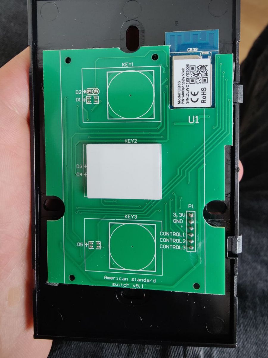

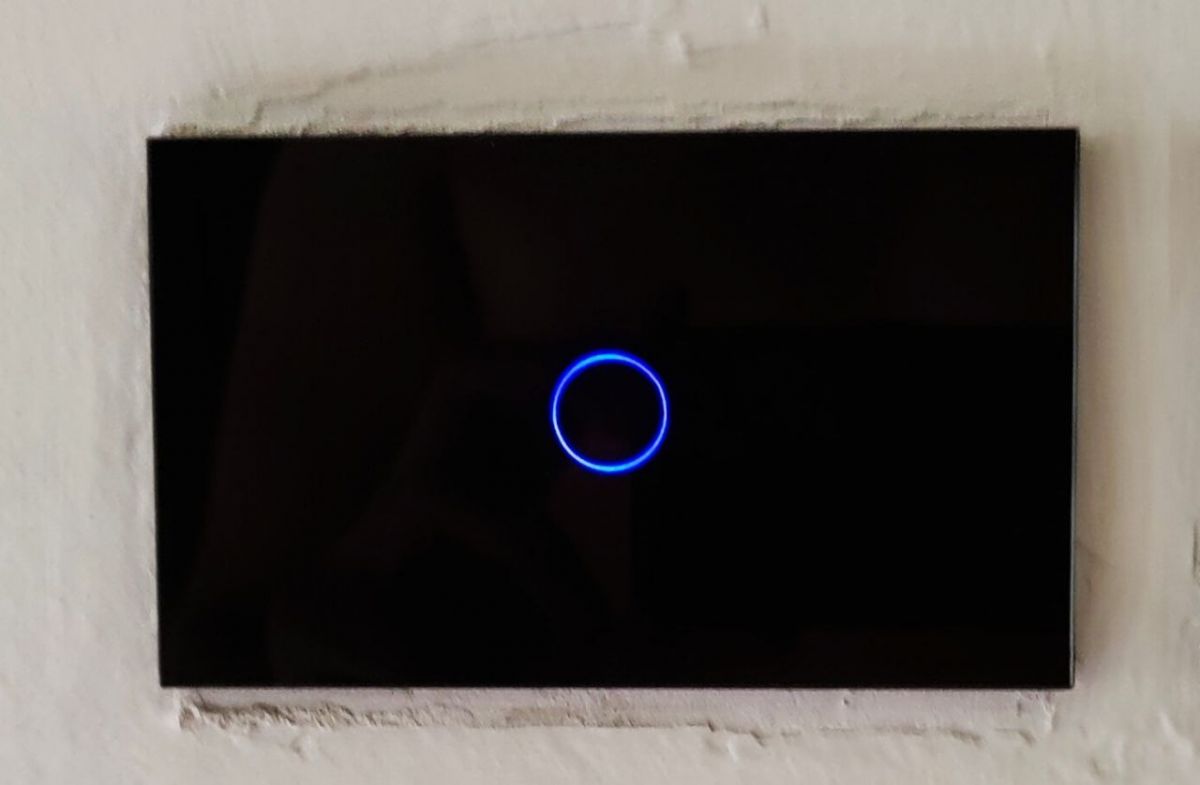

  • AVATTO US-TS02 1-gang Tuya Wi-Fi wall switch uses a BK7231N [CB3S] module and a local AliExpress vendor link is listed.

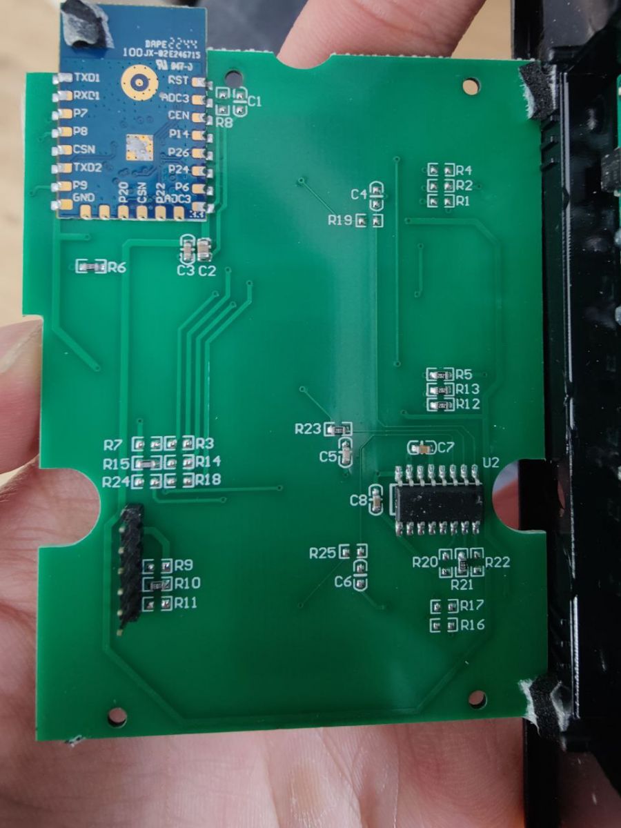

  • UART wiring maps TXD1 to UART RX, RXD1 to UART TX, 3.3 to UART 3.3V, and GND to UART GND.
  • GPIO mapping includes P7 for Btn 1, P9 for LED 1, P23 for WifiLED 0, and P26 for Rel 1.
  • To flash the BK7231N, either remove the 16-pin chip and solder it back, or cut and later repair the RXD1/TXD1 trace, then use BK7231GUIFlashTool.

    [BK7231N - CB3S] AVATTO Tuya US Wifi Wall Switch 1 Gang [BK7231N - CB3S] AVATTO Tuya US Wifi Wall Switch 1 Gang

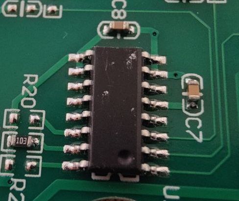

    You have to remove this 16-pin chip > Flash > Solder the chip back.
    -OR-
    Find the correct trace between the RXD1/TXD1 to the 16-pin chip and break it > Flash > Solder (repair) the trace.
    Finally use BK7231GUIFlashTool to flash the BK7231N chip.

    It looks like the issue that we had with a switch on our YouTube channel. We also had to break the RXD connection temporarily.
