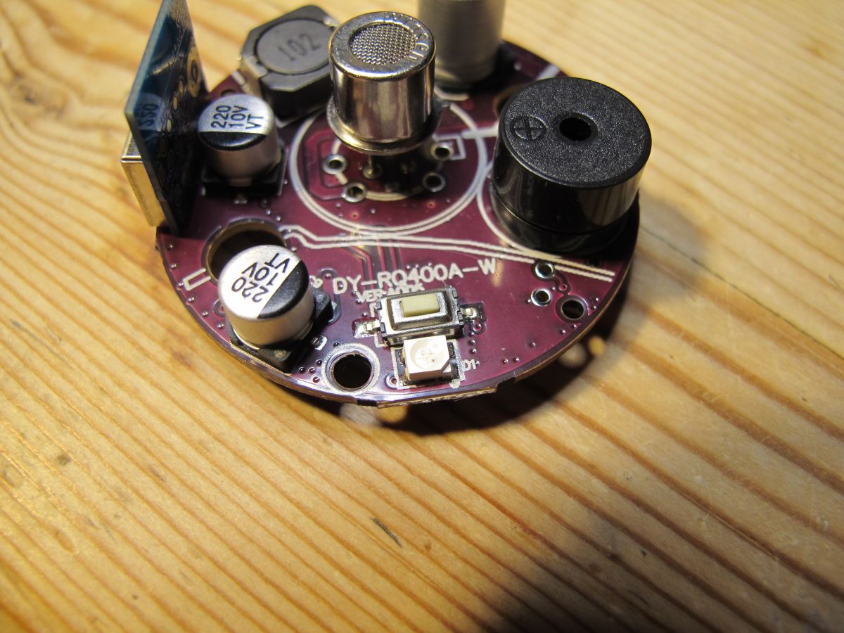

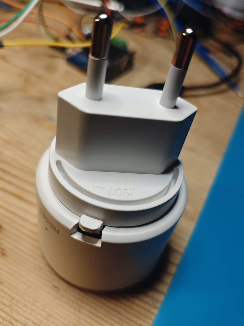

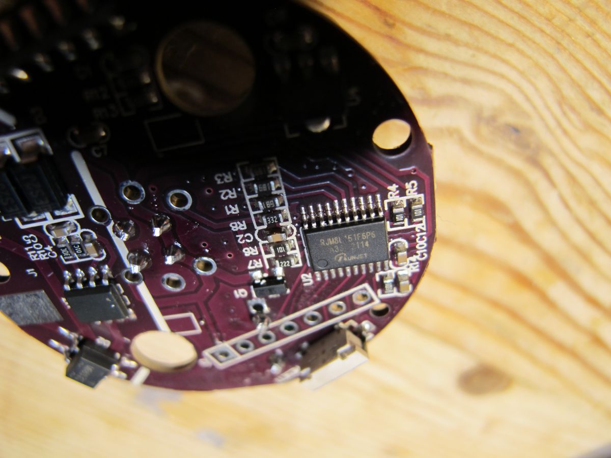

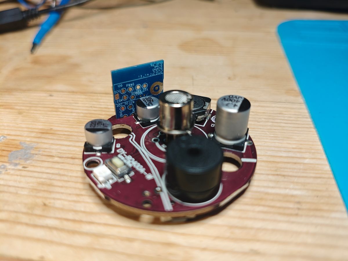

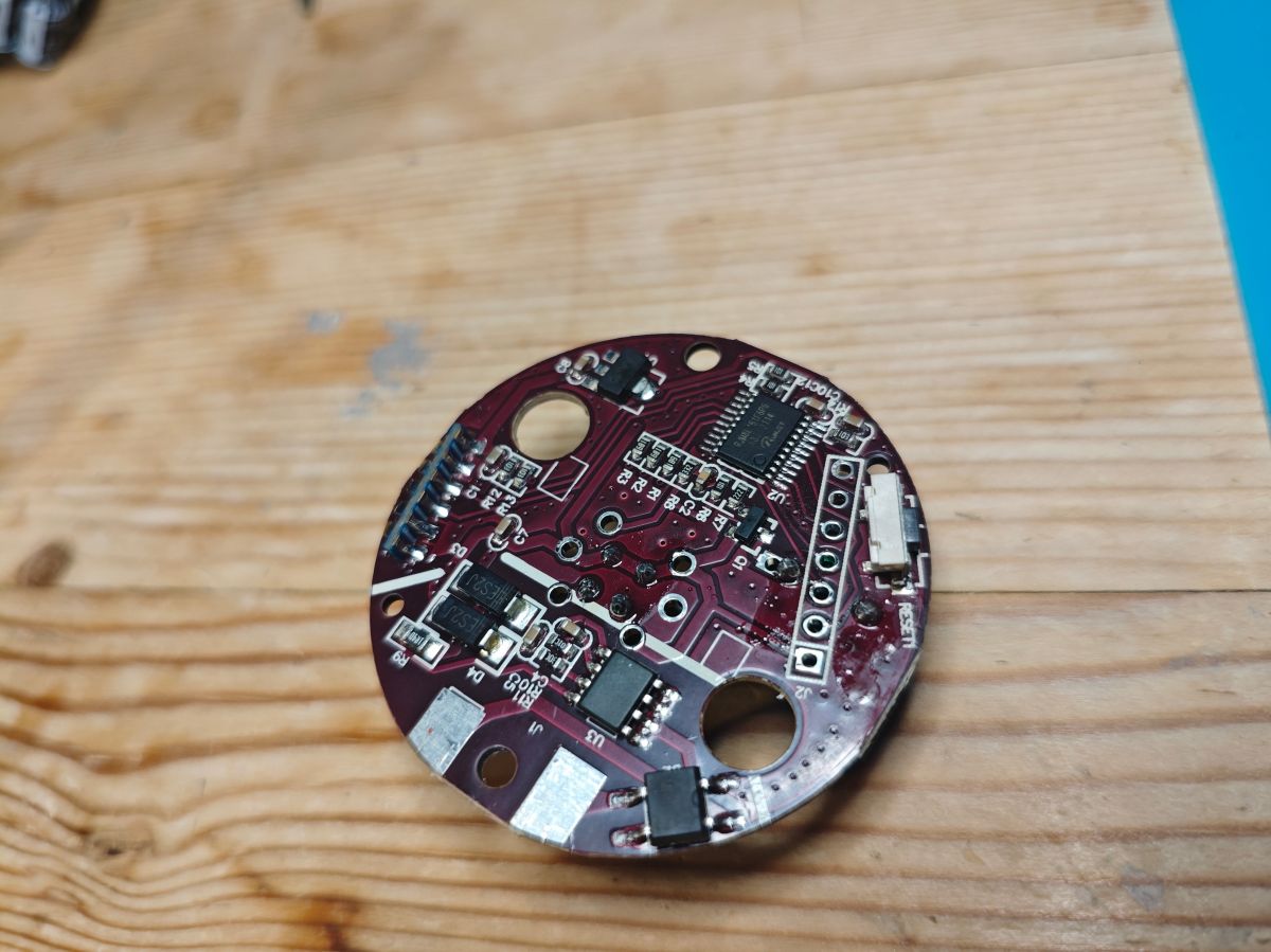

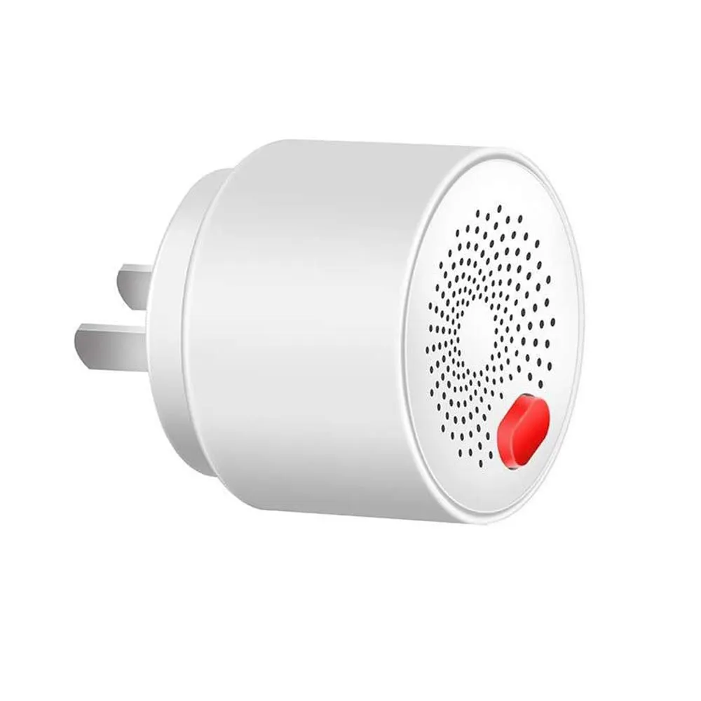

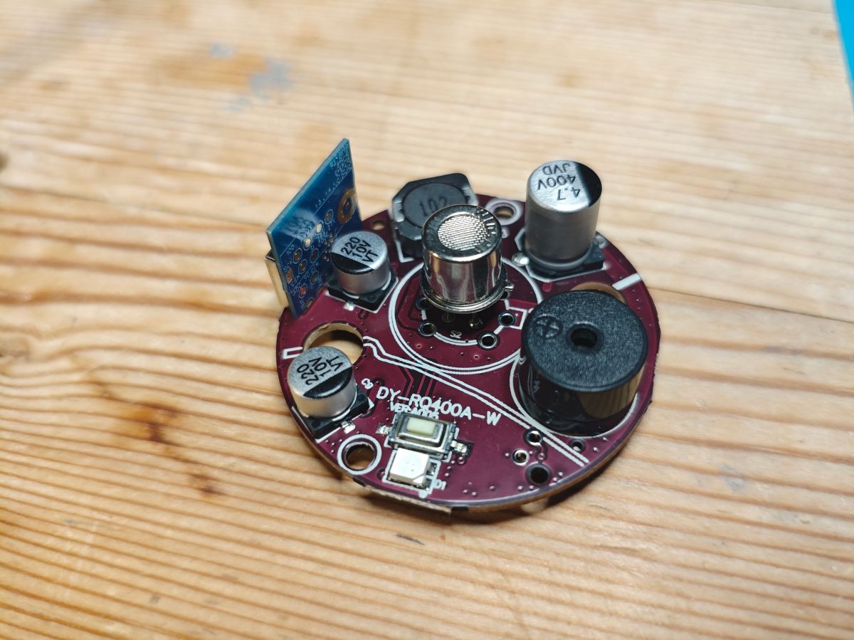

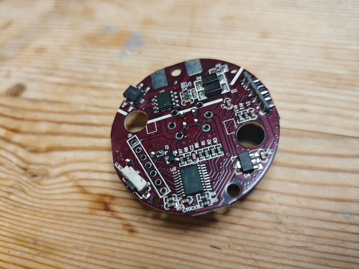

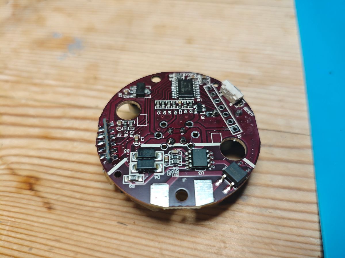

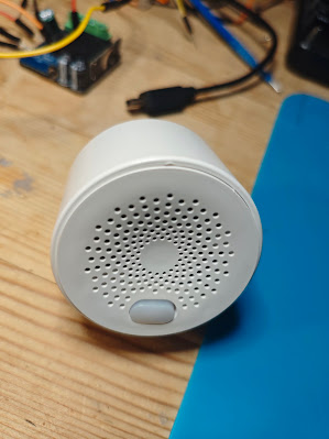

    Here I will document my journey, however long that might be, with a Tuya Combustible Gas Alarm model DY-RQ400A which employs a WB2S (BK7231T) module in tandem with a Runjet RJM8L151F6P6 MCU, (Chinese and machine-translated English datasheet attached).
    PCB with electronic components. Close-up of the internal circuitry of the Tuya gas alarm model DY-RQ400A. Tuya DY-RQ400A-W module on a wooden table. Printed circuit board of Tuya combustible gas alarm model DY-RQ400A. Close-up of a circuit board for the Tuya DY-RQ400A gas alarm with electronic components.
    Tuya DY-RQ400A gas sensor on a wooden table. Electrical plug with RESET label and locking mechanism on a wooden surface. A printed circuit board with electronics and wires on a wooden table. Close-up of the inside of a flammable gas alarm showing the Runjet RJM8L151F6P6 chip on a circuit board. Tuya DY-RQ400A gas alarm module on a wooden table.
    Plug-in combustible gas alarm with a red button.
    User manual for a gas alarm with configuration and diagnostics details. WiFi combustible gas alarm instruction manual with description, installation instructions, and specifications.

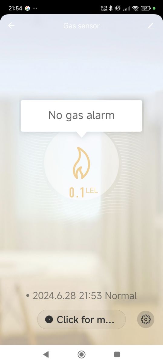

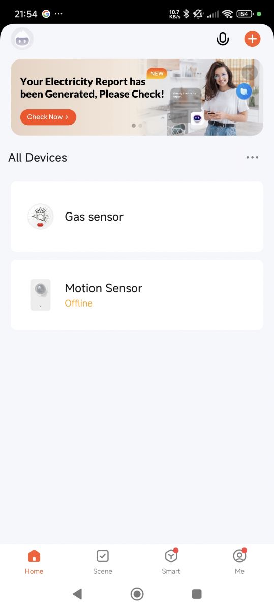

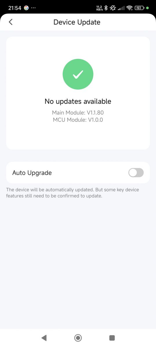

    And inside the Tuya app when paired
    Device update screen showing No updates available. Screenshot of an app displaying gas alarm settings with various configuration options. Tuya app interface showing a connected gas sensor and an offline motion sensor. Gas sensor app screen showing No gas alarm and a reading of 0.1 LEL.
    A quick Google for the model of this device shows that other teardowns, with nice pictures, are available elsewhere, so I feel the need to investigate everything as if it was a total unknown is somewhat reduced. The datapoint IDs are as follows:

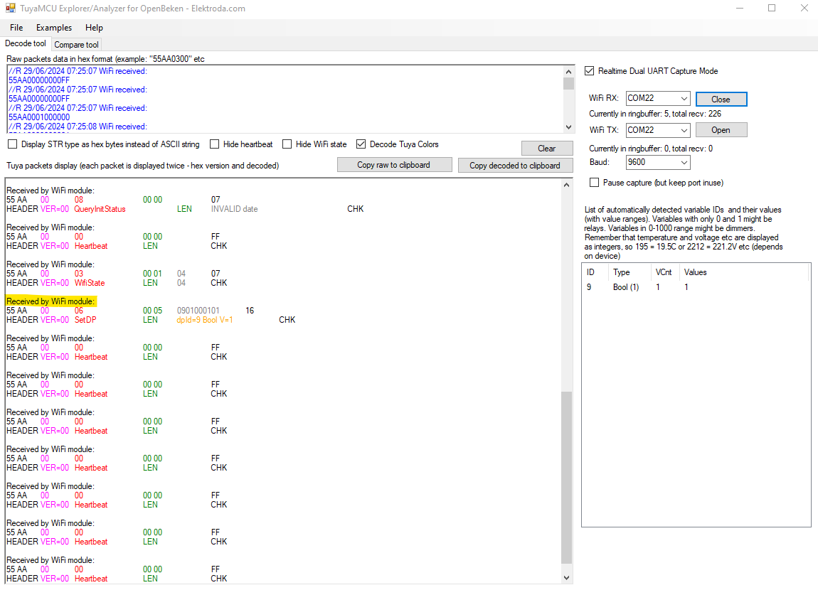

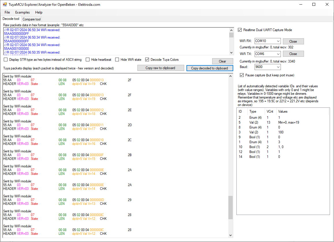

    One of the first things I did was connect up to 2TX to check the boot output:
    Unexpectedly, the MCU does not get in the way of firmware dump for me on this device, and so I attach the backup file.
    A quick gander at the MCU comms in one direction with TuyaMCU Explorer during boot, pairing and then a self-test - which I've highlighted in this pic - dpID9
    Screenshot of TuyaMCU Explorer/Analyzer with packet data.

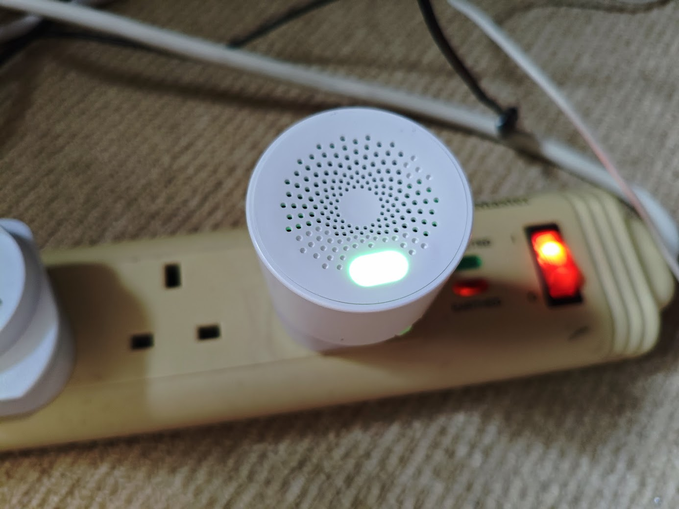

    So with Tuya firmware, when first plugged in it'll do a little test siren and flash its single tri-colour 5050 SMD LED red, green then blue. When it's in pairing mode it semi-fast flash green.
    once paired it'll be a static green if no elevated gas levels are detected
    Gas sensor connected to a power strip with a green LED indicator.
    then you can press the button at paired or unpaired state to start a self-test. this can also be done from the app.

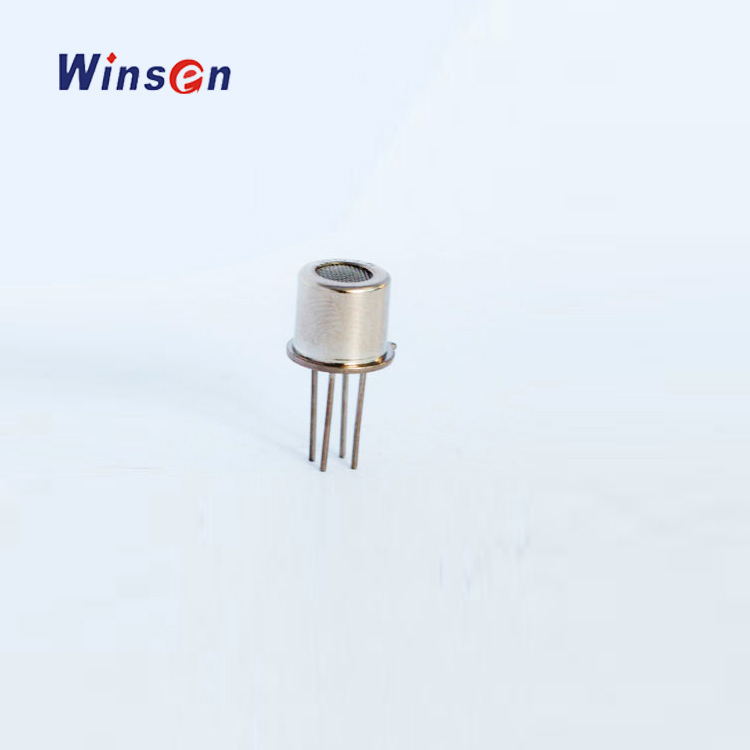

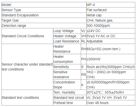

    I believe the combustible gas sensor to be a Winsen MP-4
    Combustible gas sensor Winsen MP-4 shown from the side with four pins.
    Winsen MP-4 gas sensor specifications table.
    • mp-4(v1_5)-manual.pdf (770.64 KB) You must be logged in to download this attachment.

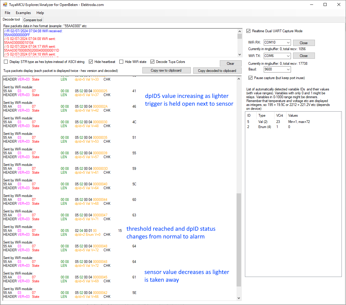

    regarding my earlier detection for isobutane, ChatGPT notes the following after analysing the Winsen datasheet
    Added after 8 [hours] 57 [minutes]:

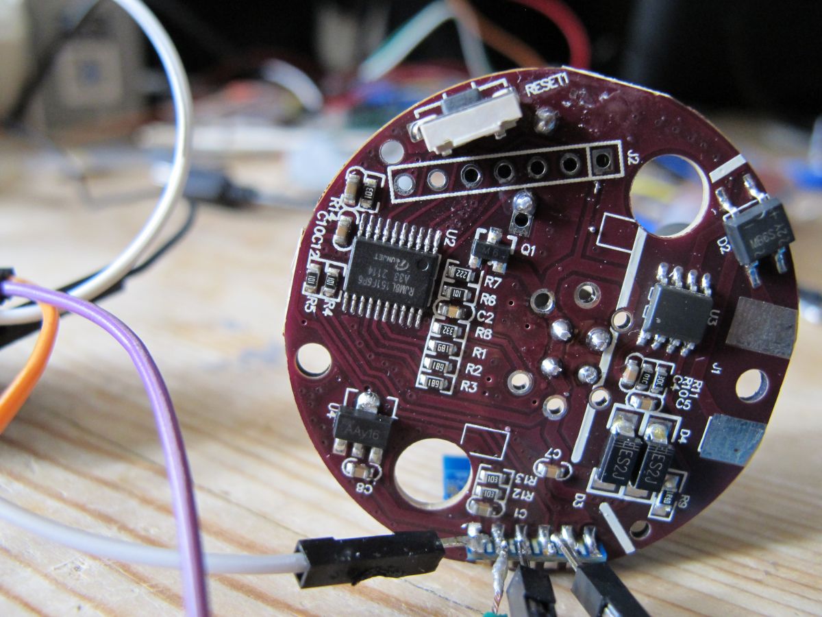

    I've soldered the device back up to two USB-TTL adaptors to look at the MCU behaviour.
    Here is power-up, pre-heating and finally short bursts of lighter fluid into the sensor.
    It's fascinating to see dpID5 (Range: 0 to 1000 (LEL - Lower Explosive Limit)) levels change as the gas is suddenly present and then the values drop as it dissipates:
    Screenshot of TuyaMCU Explorer/Analyzer program.
    Added after 26 [minutes]:

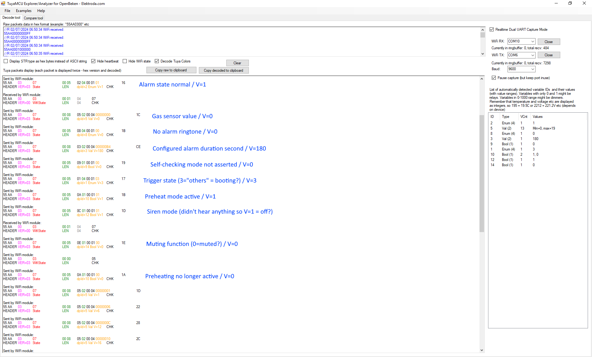

    boot with notes:
    Screenshot of the TuyaMCU Explorer application showing WiFi communication data and gas sensor status.
    lighter fluid emission with notes:
    Screenshot of the TuyaMCU Explorer/Analyzer software showing data from a WiFi module.

    Nice progress. By the way, this dpID:
    DP 12, BOOL(rw), alarm_switch (报警开关) (alarm switch)
    it's marked as RW (Read/Write) instead of RO (Read Only), does it mean that you can just enable the alarm at any moment from the OBK? So the alarm could be reused as alarm for, I don't know, other sensor?
  • RW alarm DP may be reusable for other sensors

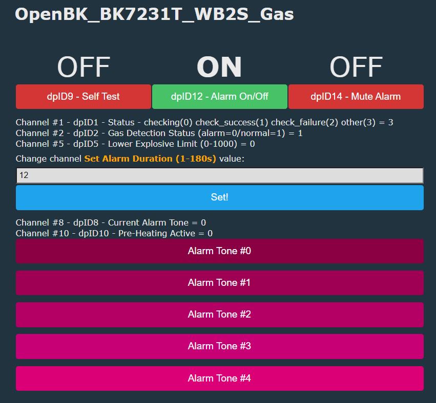

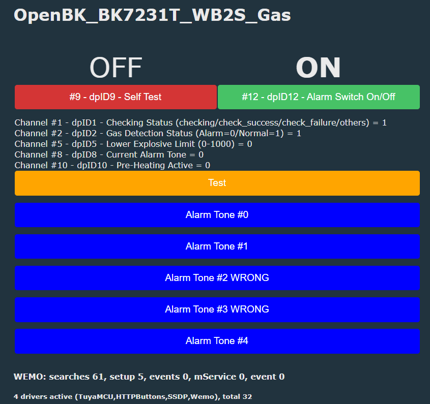

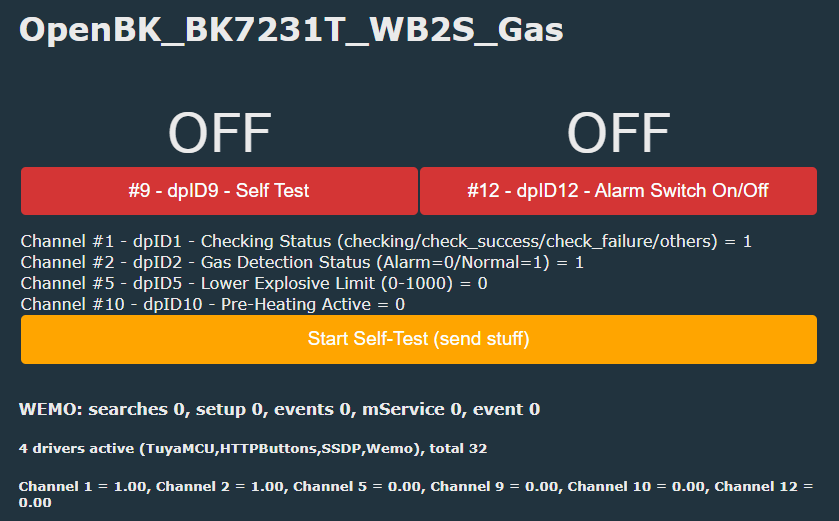

    I've done the basic ro enums and other bits
    OpenBK_BK7231T_WB2S_Gas interface screen with test buttons.
    dpID 12 button doesn't do anything. dpID 9 button makes the LED do a little colour sequence only

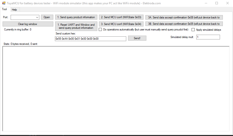

    I've actually made something opposite - faking a series of WiFi module responses:
    Screenshot of a WiFi module simulation app for battery device testers.
    It seems that you need an opposite thing. Or maybe you can just do that with Realterm?

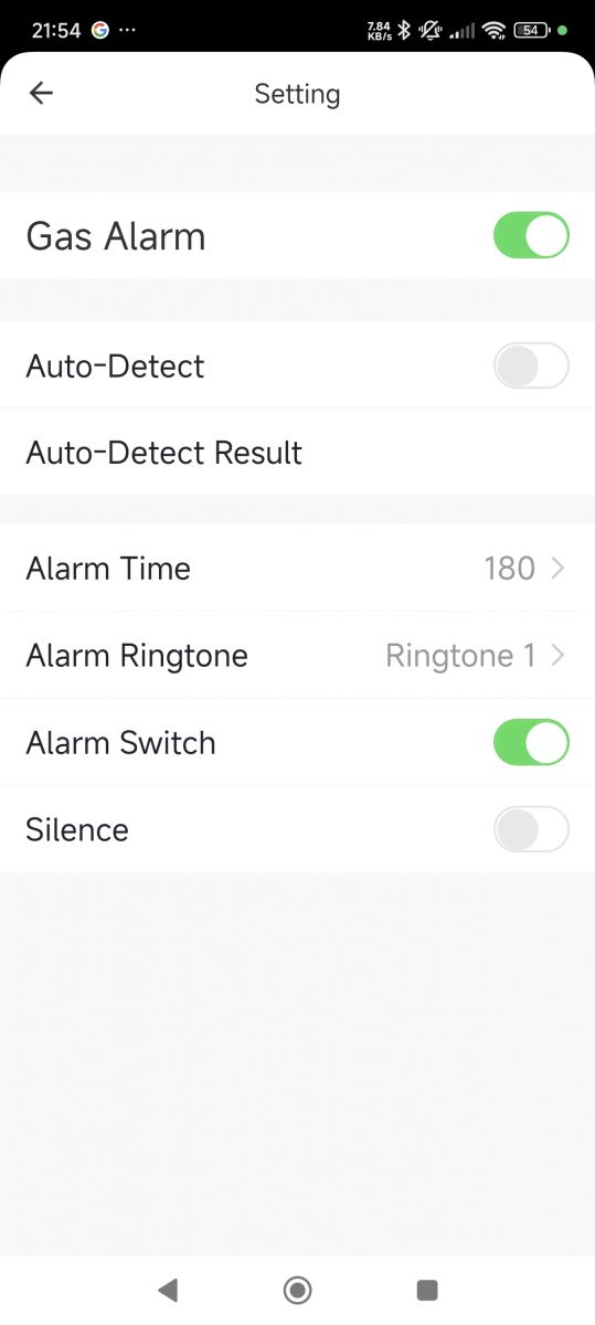

    on a different note, and to hit the 600 device milestone (oh, too late), this device could be added. The template won't change but the autoexec is obviously a work in progress.
    https://github.com/OpenBekenIOT/webapp/pull/129
    Added after 11 [hours] 16 [minutes]:

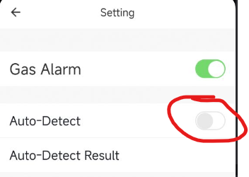

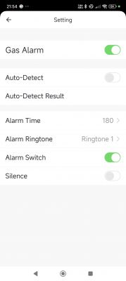

    so yes, you can initiate a self-test (auto-detect toggle) but it'll only sound for a fixed short period.
    Screenshot of gas alarm settings with Auto-Detect switch highlighted in red.
    so far:
    OpenBK_BK7231T_WB2S_Gas interface with various buttons and statuses
    Added after 4 [minutes]:

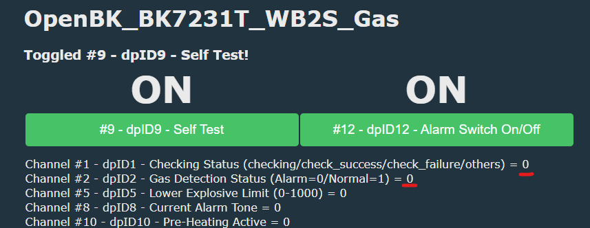

    and when you toggle dpID9 self-test, the button goes green while in test mode, the checking status value changes to 0 and the alarm state changes to 0. When complete dpID 9 button goes red again
    OpenBK interface panel with self-test and alarm mode enabled.
    Added after 57 [minutes]:
    most readings and functions are in place. the alarm duration (1-180s) selection is not yet sorted. I don't imagine 180 buttons with individual hex sends it the best way to make that available!
    So far
    User interface of OpenBK BK7231T WB2S for gas detector management.
    with

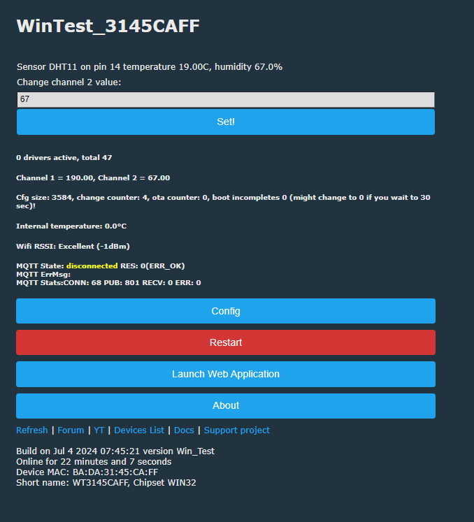

    #9 21142379
    Posts: 14795
    Rate: 12947

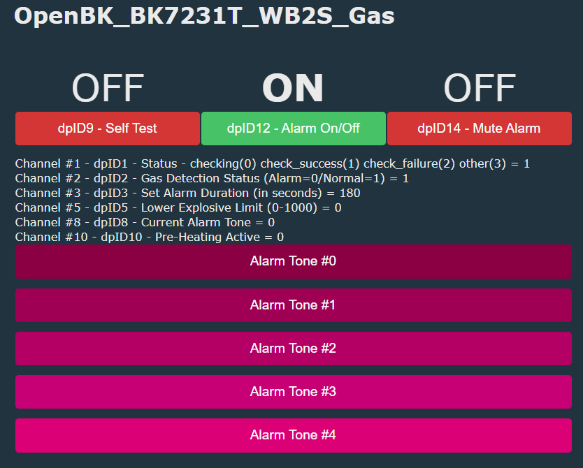

    Maybe TextField button can be used for alarm duration (1-180s)?
    I've used it in the past for the timer:
    This is how TextField looks like:
    Screenshot of the WinTest_3145CAFF application interface with a text field and buttons.
  • dpID 3 controls configurable alarm duration
    #10 21142412
    ah. specifically, dpID 12 just turns the function of the whole device on/off, not the alarm tone itself. there doesn't appear to be an alarm tone only ability - the closest being the self-test
    Added after 10 [hours] 24 [minutes]:
    OK
    OpenBK_BK7231T_WB2S_Gas user interface with alarm settings.
    and I can see from tuyaMcu_sendQueryState that the values I choose in the textfield are set in the MCU
    12 seconds:
    73 seconds:
    I've had to do away with this for now though in autoexec because it means trying to map the same dpID to different OBK channels. I'm looking around to see if there's a way to do write and separately read, so the currently-set value is displayable.
    Screenshot showing a setting for Channel #3 where dpID is 3 with alarm duration set to 180 seconds.

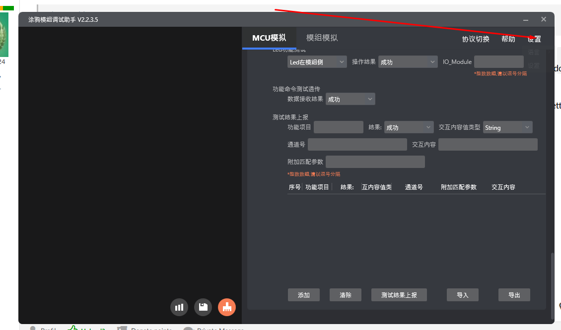

  • Tuya MCU debugging assistant for emulation
    #13 21277741
    Posts: 5236
    Help: 450
    Rate: 919

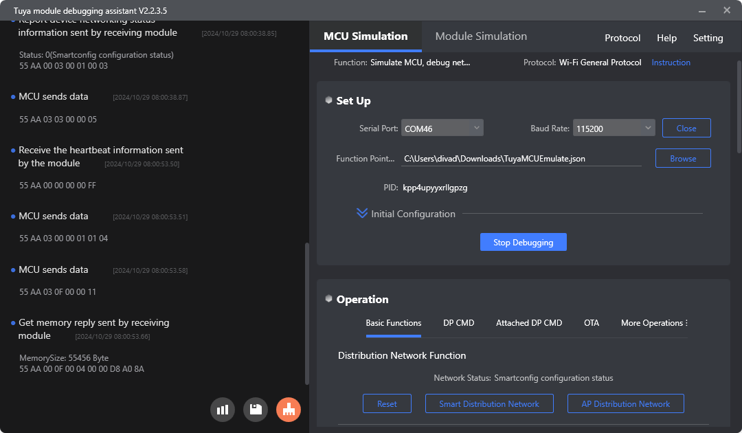

    I don't think I ever did try Realterm

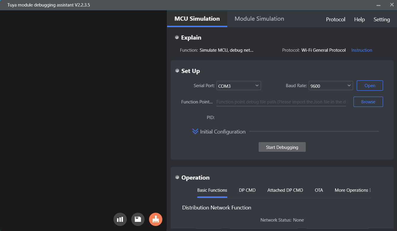

    BUT it looks like there's an official Tuya tool to emulate an MCU. I attach the TuyaMCU module debugging assistant version 2.2.3.5. This is download for v2.1.3 that updates to 2.2.3.5: https://images.tuyacn.com/smart/solution/deve...urce/aa68e8df-de83-5e2e-b8c1-d189b46168e9.zip
    I've not had a chance to try it out, but I've seen it used to respond to a flashed Beken dev board with missing TuyaMCU. This then meant getting the firmware fully booted and into AP/pairing mode.
    Screenshot of Tuya Module Debugging Assistant version 2.2.3.5.
    • updateSetup.exe (2.48 MB) You must be logged in to download this attachment.
  • #14 21280904
    Posts: 14795
    Rate: 12947
    So now we can flash OBK to converted NodeMCU with BK7231 and let PC simulate TuyaMCU?
    It's by default in Chinese, but here you can change language:
    User interface of an MCU simulation software, default in Chinese.
  • Example function point JSON for TuyaMCU decoding
    #15 21280950
    Posts: 5236
    Help: 450
    Rate: 919
    yes. Attached is an example function point json to use.
    Screenshot of the interface of Tuya module debugging assistant version 2.2.3.5.
    it decodes stuff like TuyaMCU Analyser, to a degree.
    I was playing with the Atorch S1 firmware with a view to eventually capturing the 1.0.7 TuyaMCU firmware upgrade that gets offered by the Tuya app once paired. I could not get the firmware to pair though. I guess there's a lot to understand about all the communications that need to occur to make such a thing happen.
    Nice and neat - all possible with just this and the PC:

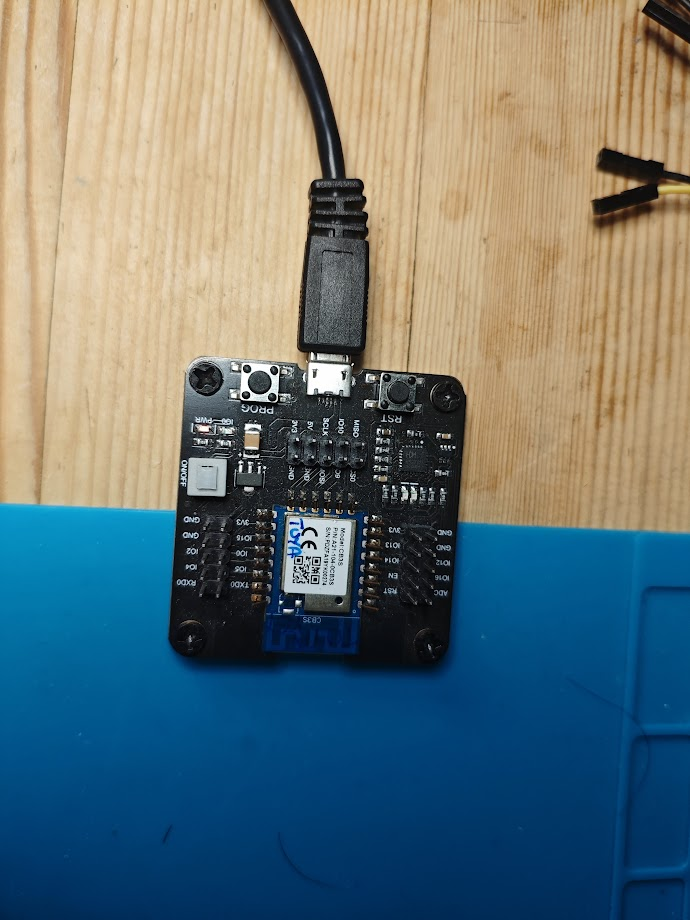

    Electronic board with a connected USB cable on a wooden table.
    • TuyaMCUEmulate.zip (1.02 KB) You must be logged in to download this attachment.

Which gas sensor is inside, and which gases does it detect?
The author identifies the sensor as a Winsen MP‑4, specified for methane/natural gas with a typical 300–10000 ppm range. In testing, short lighter‑fluid bursts failed to trigger, but an isobutane Campingaz shot did. A single press clears the alarm afterward. [Elektroda, divadiow, post #21139592]
How can I set the alarm duration (DP3) without tons of buttons in OBK?
Use a TextField control in OpenBeken to input seconds (1–180). The device applied values like 12 s and 73 s, confirmed by TuyaMCU logs (DP3 updates). How‑To: 1) Add a TextField UI. 2) Enter a value 1–180. 3) Send and verify DP3 in logs. [Elektroda, divadiow, post #21142412]
How do I change the alarm ringtone (DP8) from OpenBeken?
Create httpButtons and send TuyaMCU UART frames for DP8 enum values. The author used enum 0–4 to select the five tones, with each button sending a specific uartsendhex payload. If your app shows 1–5, note the device still accepted 0–4 over UART. [Elektroda, divadiow, post #21141213]

How can I emulate a TuyaMCU on a PC to unlock pairing for testing?
Use Tuya’s “TuyaMCU Module Debugging Assistant.” It can emulate the MCU protocol so a flashed Beken board reaches AP/pairing. The linked package updates to v2.2.3.5 and has been shown driving a dev board with missing TuyaMCU. [Elektroda, divadiow, post #21277741]
Can I simulate TuyaMCU to test OpenBeken mappings more easily?
Yes. Load a function‑point JSON in Tuya’s Debugging Assistant, set serial to your OBK device, and interactively send DP frames. The UI can decode frames similar to TuyaMCU Analyzer. You can switch the tool’s language in settings. [Elektroda, divadiow, post #21280950]
What UART frames should I expect during boot and gas events?
You’ll see 55 AA heartbeats, Wi‑Fi state, and State (0x07) frames carrying DP updates. Preheat toggles DP10, and gas exposure raises DP5 values in small steps (e.g., up to 19), then they decay as the gas dissipates. [Elektroda, divadiow, post #21139756]
