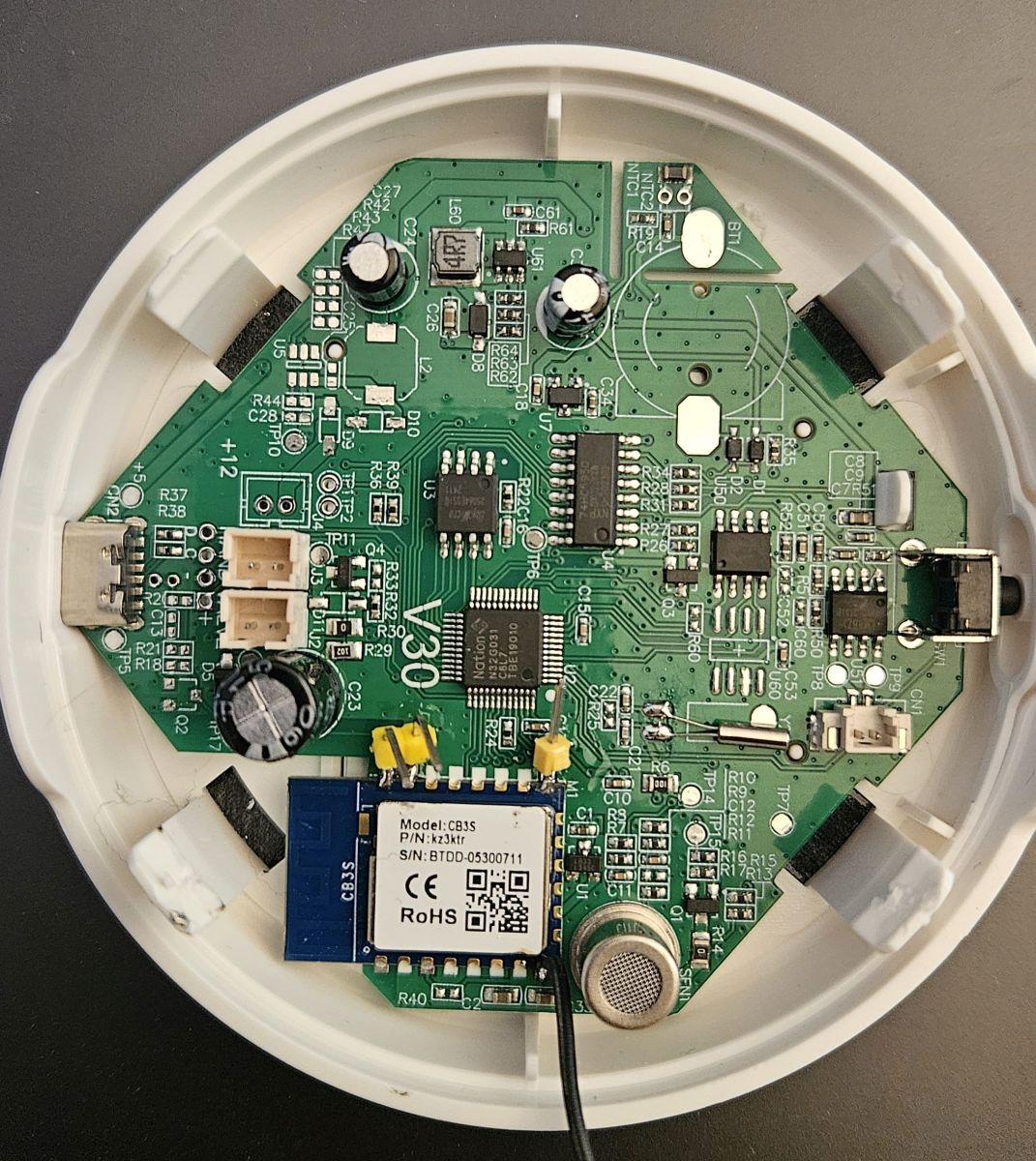

  • Inside the TX-E gas leak detector with gas shut-off valve control, the unit is opened to show its internal construction.
  • The CB3S module handles communication over UART only, with no peripheral support exposed through the module.
  • The highlighted used pins on the CB3S are the only soldered connections; the remaining pins are left unsoldered.
📢 Listen (AI voice):
  • TX-E gas detector with shut-off valve control function - interior of unit .

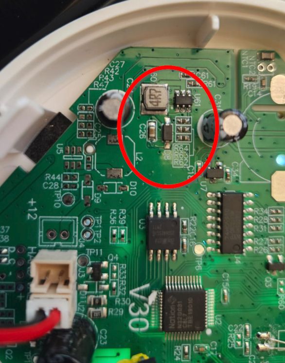

    I will show here the interior of the Gas Leak detector, model: TX-E
    Gas leak detector with gas shut-off valve control.
    edit:
    I have highlighted the used pins on the CB3S, you can see that all the communication goes through the UART, there is no peripheral support through the CB3S. The rest of the pins not soldered on.

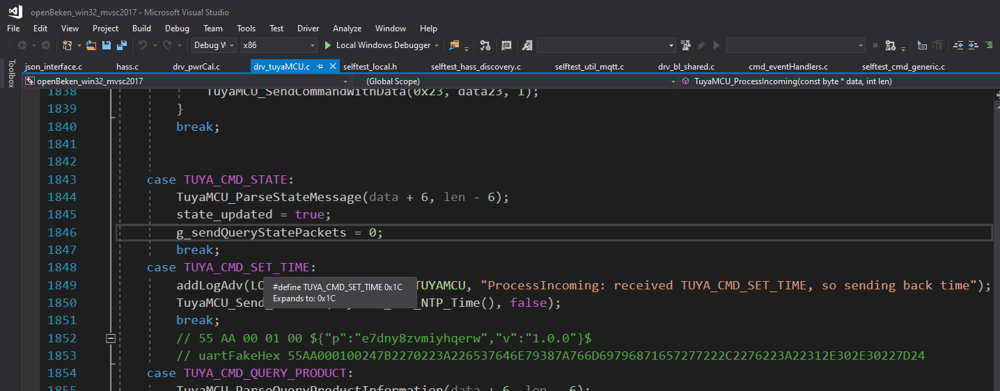

    So the device from TuyaMCU. Protocol description:
    TuyaMCU protocol - communication between microcontroller and WiFi module .
    A broad description of the how-to run approach:
    TuyaMCU flashing, installation and configuration guide - configure dpID for Home Assistant
    But summarising (TLDR):
    - try to retrieve dpID meanings from Tuya cloud .
    - also it is worth to do UART communication interception with analyzer TuyaMCU analyzer - UART packet decoder for Tuya devices - dpID detector , I do it with two USB to UART converters, but if you have one, it is supposedly enough to listen to what WiFi sends to MCU when you change something in the app and what MCU sends to WiFi periodically....
    - make a flash backup https://github.com/openshwprojects/BK7231GUIFlashTool , any flashing will probably require you to put the MCU into RESET mode or cut the UART lines or solder off the MCU or WiFi module....
    Additional question - is this a regular TuyaMCU, or battery-powered TuyaMCU where the MCU turns on the WiFi module just to report data to the cloud? Is 3.3V still on the VDD of the WiFi module? Or is the WiFi module connected to the power supply via the MOSFET transistor that the MCU controls? This is to be checked, battery devices require a driver in the OBK tmSensor enabled next to the main TuyaMCU .

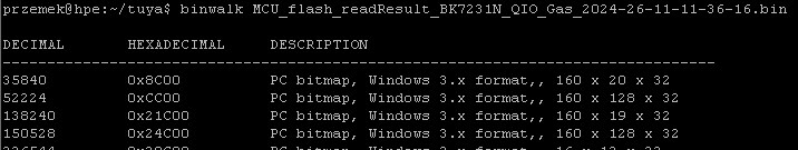

    - make a flash backup https://github.com/openshwprojects/BK7231GUIFlashTool , any flashing will probably require putting the MCU in RESET mode or cutting the UART line or soldering out the MCU or WiFi module....
    Done, attached. It went off without a problem. I did not try to flash.

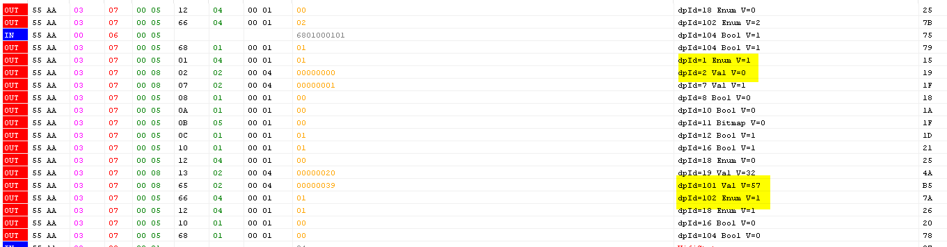

    And now the events extracted from TuyaMCUAnalyzer.exe.
    Here the triggering of the gas detection alarm:
    Dir.,Header,Vers.,Cmd,Length,DPid,Type,DataLen,Data,Decoded,Checksum
    IN,55 AA,03,00,00 01,,,,01,Heartbeat,04
    IN,55 AA,03,07,00 08,02,02,00 04,00000005,dpId=2 Val V=5,1E
    IN,55 AA,03,07,00 05,10,01,00 01,01,dpId=16 Bool V=1,21
    IN,55 AA,03,07,00 08,13,02,00 04,00000013,dpId=19 Val V=19,3D
    IN,55 AA,03,07,00 05,01,04,00 01,00,dpId=1 Enum V=0,14
    IN,55 AA,03,07,00 08,02,02,00 04,0000000D,dpId=2 Val V=13,26
    IN,55 AA,03,07,00 08,13,02,00 04,00000015,dpId=19 Val V=21,3F
    IN,55 AA,03,07,00 08,13,02,00 04,00000016,dpId=19 Val V=22,40
    IN,55 AA,03,07,00 08,02,02,00 04,0000000C,dpId=2 Val V=12,25
    IN,55 AA,03,07,00 08,02,02,00 04,0000000A,dpId=2 Val V=10,23
    IN,55 AA,03,07,00 08,02,02,00 04,00000008,dpId=2 Val V=8,21
    IN,55 AA,03,07,00 08,02,02,00 04,00000007,dpId=2 Val V=7,20
    IN,55 AA,03,07,00 08,02,02,00 04,00000006,dpId=2 Val V=6,1F
    IN,55 AA,03,07,00 08,13,02,00 04,00000017,dpId=19 Val V=23,41
    IN,55 AA,03,07,00 05,01,04,00 01,01,dpId=1 Enum V=1,15
    IN,55 AA,03,07,00 08,02,02,00 04,00000000,dpId=2 Val V=0,19
    IN,55 AA,03,07,00 05,10,01,00 01,00,dpId=16 Bool V=0,20
    IN,55 AA,03,07,00 08,13,02,00 04,00000018,dpId=19 Val V=24,42
    IN,55 AA,03,07,00 08,13,02,00 04,00000019,dpId=19 Val V=25,43
    IN,55 AA,03,07,00 08,13,02,00 04,0000001A,dpId=19 Val V=26,44
    IN,55 AA,03,07,00 08,13,02,00 04,0000001B,dpId=19 Val V=27,45

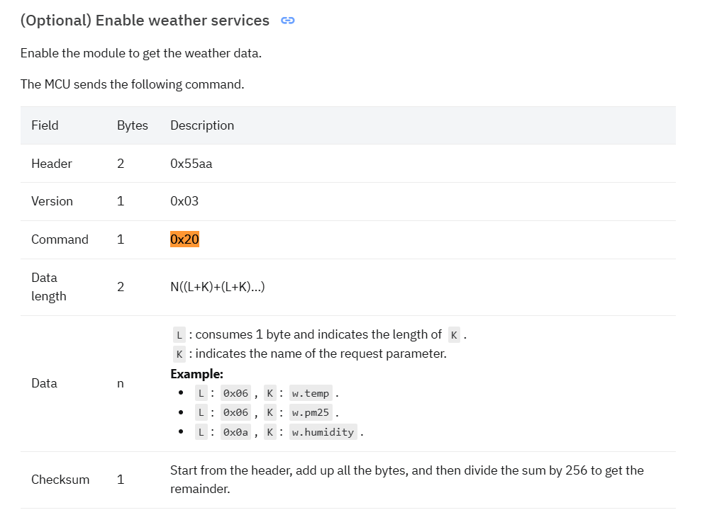

    when gas is detected, 12V appears on the valve control output, read U61 is responsible for boosting the voltage to 12V.

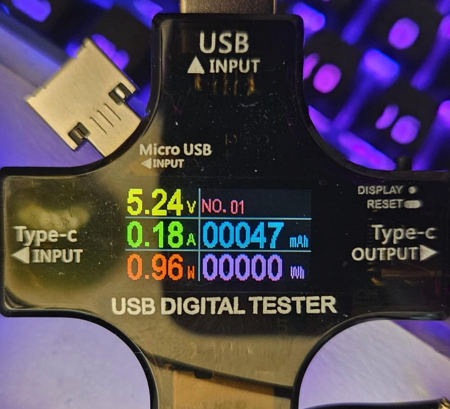

    The device consumes approx.180mA in the idle state.
    and here pressing the Test button:
    IN,55 AA,03,07,00 05,08,01,00 01,01,dpId=8 Bool V=1,19
    IN,55 AA,03,07,00 05,09,04,00 01,00,dpId=9 Enum V=0,1C
    IN,55 AA,03,07,00 05,09,04,00 01,01,dpId=9 Enum V=1,1D
    IN,55 AA,03,07,00 05,08,01,00 01,00,dpId=8 Bool V=0,18

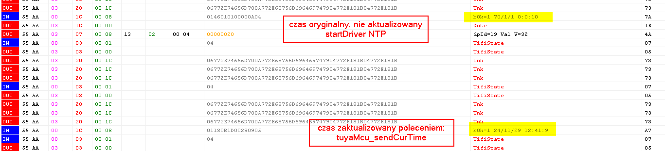

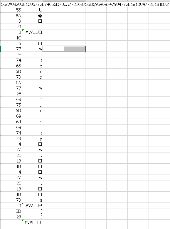

    system reboot:
    IN,55 AA,03,01,00 2A,,,,7B2270223A22366A7132307736776E6E346661773239222C2276223A22312E302E30222C226D223A327D,"{""p"":""6jq20w6wnn4faw29"",""v"":""1.0.0"",""m"":2}",41
    IN,55 AA,03,02,00 00,,,,,McuConf,04
    IN,55 AA,03,03,00 00,,,,,WifiState,05
    IN,55 AA,03,07,00 08,07,02,00 04,00000001,dpId=7 Val V=1,1F
    IN,55 AA,03,07,00 05,0A,01,00 01,01,dpId=10 Bool V=1,1B
    IN,55 AA,03,07,00 05,0B,05,00 01,00,dpId=11 Bitmap V=0,1F
    IN,55 AA,03,07,00 05,0C,01,00 01,01,dpId=12 Bool V=1,1D
    IN,55 AA,03,07,00 05,12,04,00 01,01,dpId=18 Enum V=1,26
    IN,55 AA,03,07,00 08,13,02,00 04,0000001C,dpId=19 Val V=28,46
    IN,55 AA,03,07,00 08,65,02,00 04,00000039,dpId=101 Val V=57,B5
    IN,55 AA,03,07,00 05,66,04,00 01,01,dpId=102 Enum V=1,7A
    IN,55 AA,03,20,00 1C,,,,06772E74656D700A772E68756D696469747904772E181B04772E181B,Unk,73
    IN,55 AA,03,1C,00 00,,,,,Date,1E
    IN,55 AA,00,21,00 00,,,,,Unk,20
    IN,55 AA,03,07,00 05,0A,01,00 01,00,dpId=10 Bool V=0,1A
    edit2
    The cd of the search, the polecernia issued from the app and what was sent to the device:
    turn on gas decode
    55AA00060005080100010115
    OUT,55 AA,00,06,00 05,,,,0801000101,dpId=8 Bool V=1,15
    turn OFF gas decode
    55AA00060005080100010014
    OUT,55 AA,00,06,00 05,,,,0801000100,dpId=8 Bool V=0,14
    set alarm time to 2 mins
    55AA0006000807020004000000021C
    OUT,55 AA,00,06,00 08,,,,0702000400000002,dpId=7 Val V=2,1C
    mute alarm
    55AA0006000510010001011D
    OUT,55 AA,00,06,00 05,,,,1001000101,dpId=16 Bool V=1,1D
    umute alarm
    55AA0006000510010001001C
    OUT,55 AA,00,06,00 05,,,,1001000100,dpId=16 Bool V=0,1C
    heat alarm value = 61
    55AA00060008650200040000003DB5
    OUT,55 AA,00,06,00 08,,,,650200040000003D,dpId=101 Val V=61,B5
    lang Chineese
    55AA00060005660400010075
    OUT,55 AA,00,06,00 05,,,,6604000100,dpId=102 Enum V=0,75
    lang English
    55AA00060005660400010176
    OUT,55 AA,00,06,00 05,,,,6604000101,dpId=102 Enum V=1,76
    start calibration
    55AA00060005680100010175
    OUT,55 AA,00,06,00 05,,,,6801000101,dpId=104 Bool V=1,75
    stop calibration
    55AA00060005680100010074
    OUT,55 AA,00,06,00 05,,,,6801000100,dpId=104 Bool V=0,74
    • readResult_BK7231N_QIO_Gas_leakage_sensor_TX-E_2024-26-11-11-42-25.zip (1.05 MB) You must be logged in to download this attachment.

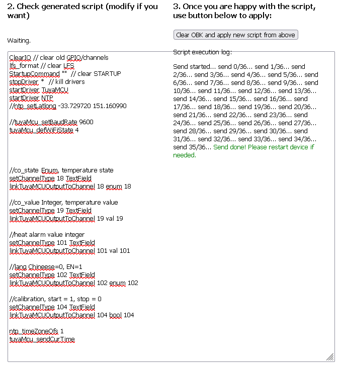

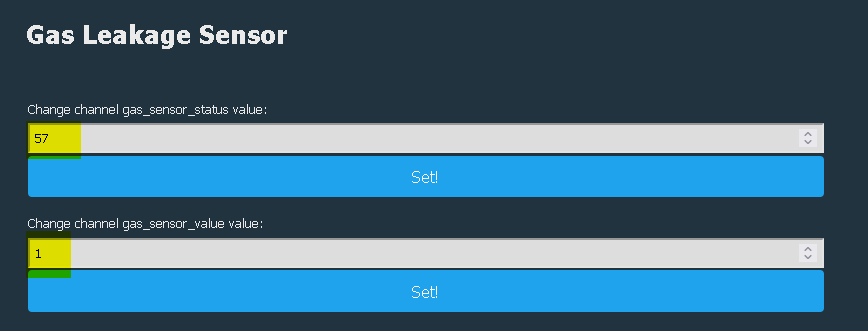

    OK, I'm ready to configure, I think I have everything I need. CB3S falsified, connects to WiFi. Soldered in and time to configure.
    I've read the guide , I'm on the Import page on the device and I've relented.

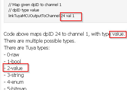

    I don't quite understand the connection between setChannelType and data type, the data type doesn't agree with my definition, e.g.
    Could you explain from the example below how to define for the following channel values?
    dpID 1, gas_sensor_status, sent by tuyaMCU, enum, takes the values 0 and 1
    dpID 2, gas_sensor_value, sent by tuyaMCU, val, accepts values 0..100
    dpID 8, gas_decode, received by tuyaMCU, bool, assumes values 0 and 1
    dpID 102, language, received by tuyaMCU, enum, shall have values 0 and 1
    How this relates to the definition:
    dpID 1 .
    gas_sensor_status Enum
    "range": [
    "alarm",
    "normal"
    dpID 2 .
    gas_sensor_value Integer
    "unit": "%LEL",
    "min": 0,
    "max": 100,
    "scale": 0,
    "step": 1

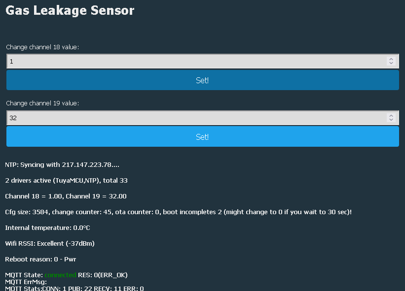

    The device sends data to the MQTT server:
    But it does this randomly, When I call the alarm, it does not send it.
    I also don't really know how to send data to it, e.g. force a calibration:

    And now again I ask for help, I don't know how to find this: how to send a command to Tuya?
    For example, I would like to send a command:
    55AA0021001F0106772E74656D700004000000060A772E68756D696469747900040000005D28
    Which sets the outside temperature and humidity.
    Unfortunately the result I get is:
    Error:CMD:cmd 55AA0021001F0106772E74656D700004000000060A772E68756D696469747900040000005D28 NOT found (args )
    Info:CMD:[WebApp Cmd '55AA0021001F0106772E74656D700004000000060A772E68756D696469747900040000005D28' Result] Unknown command
    As I will know how from the consoli, I should be able to manage with MQTT, unless there's some kind of a trick.

    And you didn't have it mentioned in the Web App Log:
    	case TUYA_CMD_SET_TIME:
    		addLogAdv(LOG_INFO, LOG_FEATURE_TUYAMCU, "ProcessIncoming: received TUYA_CMD_SET_TIME, so sending back time");
    		TuyaMCU_Send_SetTime(TuyaMCU_Get_NTP_Time(), false);
    		break;

    And you can send the following:
    turn on gas decoding
    turn OFF gas decoding
    mute alarm
    umute alarm
    lang Chineese
    lang English
    start calibration
    stop calibration

    I now have working fields on the panel, I can set their values, I can read them, the system sends the data, it seemed almost, almost, but....
    Two issues.
    First: .
    resolved, for some reason the time on the device set itself to 2070 and stayed that way, despite a reset. Obviously the 2000 was added by the device itself, because as you can see it's just a Unix Epoch start time, the Chinese assumed you had to add 2000 to the date.
    The solution is to force the time to be sent from the TuyaMCU to the MCU (from CB3S to the device MCU), with the command:
    tuyaMcu_sendCurTime
    Second: .
    Channels with dpID pow 100 do not appear on my panel, read: 101, 102 and 104.
    On configuration:
    edit: .
    It looks like there is a dpID counter up to 100, it bugs me that I read that up to 100 are Tuya ID and above user, you can see that those pow 100 overwrite the values from zero:
    these values according to the screenshot above should be 1 and 0 respectively:
    edit2: .
    I changed the configuration of the channels, I started from 1 to 14, and according to this below already looks like everything is ok :) .
    Now just testing and changing the read-only value (e.g. temp sent by MCU) to ReadOnly:
    //co_value	Integer, temperature value
    setChannelType 11 TextField
    setChannelLabel 11 co_value_(dpId=19)
    linkTuyaMCUOutputToChannel 19 val 11
    //heat_alarm_value integer
    setChannelType 12 TextField
    setChannelLabel 12 heat_alarm_value_(dpId=101)
    linkTuyaMCUOutputToChannel 101 val 12
    //lang Chineese=0, EN=1
    setChannelType 13 TextField
    setChannelLabel 13 Lang_(0=CN,1=EN)(dpId=102)
    linkTuyaMCUOutputToChannel 102 enum 13
    //calibration, start = 1, stop = 0
    setChannelType 14 TextField
    setChannelLabel 14 calibration_start=1,stop=0 (dpId=104)
    linkTuyaMCUOutputToChannel 104 bool 14
    tuyaMcu_sendCurTime
    Possibly, supposedly in theory the MCU should ask itself, but it varies:

  • Read-only channel mapping and custom flag options
    #12 21325415
    Samezrp1
    Posts: 90
    Rate: 7
    It seems to me that the ReadOnly field would be read-only and also visible on the panel. Default is the default mode, if Default was visible on the panel, then 64 channels would be visible on the panel after uploading the firmware....
    So it's all clear.

    If you want a particular type of channel then I can add on request, although ultimately I intend to add their customisation.
    I was thinking of a toggle type channel, but only for reading, ew options for each RO channel.
    This is useful for flagging out. E.g. here you turn on an internal test and the device puts a separate FAIL flag high as long as the test passes. After a positive test it changes to low.

    Samezrp1 wrote:
    I will be observing, as I have the impression that it has lost time after some time, but this I need to confirm.
    You can send time at regular intervals using addRepeatingEvent . It is worth including TuyaMCU queue in the flags for stability.

    Presumably this command is used to do this:
    55AA0320001C06772E74656D700A772E68756D696469747904772E181B04772E181B73
    But I can't send it without soldering it to the MCU. I couldn't find the dpId to it. BTW it also sends humidity but doesn't display anywhere.
    That's what I'm thinking anyway, I don't know if there's any point in connecting a physical sensor. I would sooner make it so that from the outside (MQTT, HA, whatever) it sends this value to some channel, the problem I see is that there is no dpId that can be connected to this channel. I have attached the logs, as for me the unknown long ones are responsible for this, but without checking i.e. sending a pure message to the MCU for the moment I am not able to confirm.
    PS: probably in the wrong place you paste autoexec.bat;
    And I put autoexec.bat in FS, in the import tab I just put its contents, because there it tells me immediately if there are errors. Then I put it into the file system.
    But I can't send it without soldering it to the MCU. I have not found the dpId to it.
    If you're stubborn, you can use UartSendHex, but then you have to count the checksum yourself as you change the contents of the packet. tuyaMcu_sendState you won't use, because it's not a dpID, it's a 0x20 type command:
    It is best to use tuyaMcu_sendCmd here:
    https://www.elektroda.com/rtvforum/find.php?q=tuyaMcu_sendCmd
  • Temperature byte mapping and checksum calculator for UART commands
    #16 21327165
    Samezrp1
    Posts: 90
    Rate: 7
    >>21326734 .
    UartSendHex works , I made myself a checksum calculator:
    UartSendHex 55AA0021001F0106772E74656D700004000000160A772E68756D696469747900040000005B36
    The temperature value in hex is on 20 byte, higher = 16 i.e. 22 dec.

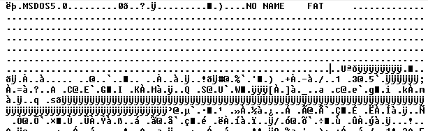

    BTW I extracted the flash and got dumbfounded.... I was expecting some kind of uboot, and there.... looks like the MSDOS 5.0 partition is sitting, although binwalk doesn't recognise it :/.
    I have sub-mapped it with losetup on Ubuntu, but it shows some of the contents (system.zip). I need to poke around more.
    It looks like only the media is in the eeprom.

    So a function that sends data in a packet of type 0x20 with ASCII names and with number conversion according to your function is useful?

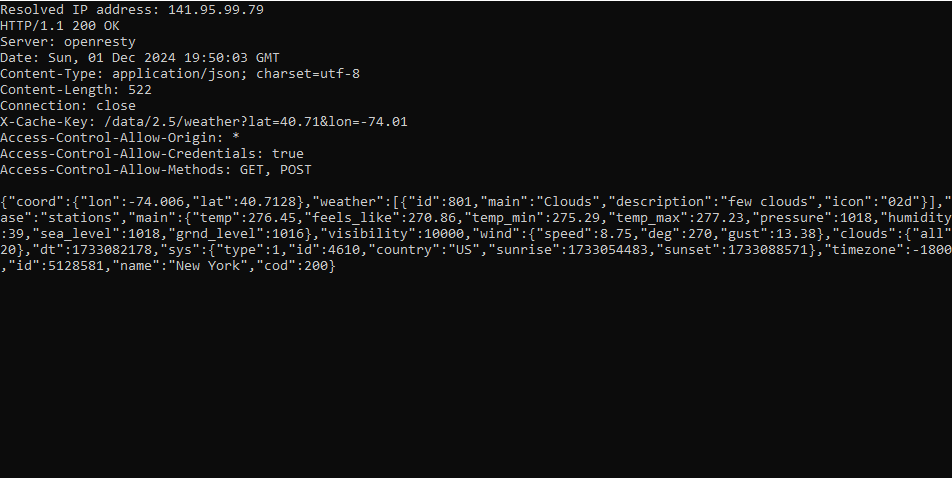

    I was interested in the topic of "weather" for a given position on the map, no problem with that, I will add a driver of that to OBK:

  • Adding OBK drivers for weather and more detectors

    I have taken an interest in the subject of "weather" for a given position on the map, no problem with that, I will add a driver for that to OBK:
    Then the temperature could be taken either from your thermometer, or as in the original based on downloaded data.

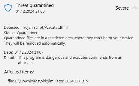

    Yes, I hit it, but I couldn't find CB3S in the library and gave up. Too soon?
    Hm... falsepositive?

    You don't need to download the old zip from the forum, there is the latest zip with the simulator on the repository:
    In Releases.
    The simulator "doesn't know" about WiFi modules, there is one module there rigidly, everything works (almost) the same between different BK7231. So more precisely it is a Windows OBK port, so it does not simulate BK registers, but it is suitable anyway for testing drivers, scripts, MQTT, page.
    As the OpenWeatherMap support I will give to the driver which will write the results to the channels, the whole thing can be modularly incorporated and also replaced e.g. via DHT11, both versions will work.
    I am happy to help with further devices, if you want, please create a topic in the appropriate forum.

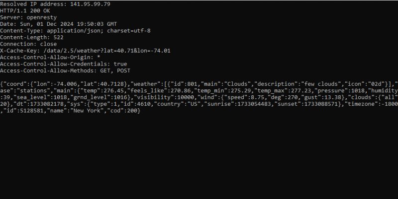

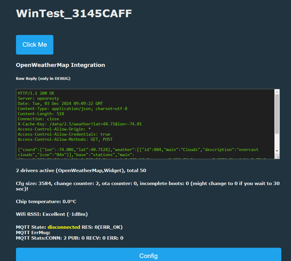

    Progress with OpenWeatherMap integration:

Time shows 2070—how do I correct the clock?
Run tuyaMcu_sendCurTime after NTP sync. It pushes the current UNIX epoch to the local MCU, clearing the 2000-year offset bug [Elektroda, Samezrp1, post #21325118]

Quick 3-step guide to flash and configure OpenBeken on TX-E
  1. Backup flash via BK7231GUIFlashTool (RESET mode, 3 V3).
  2. Flash OpenBeken, solder CB3S back, boot.
  3. Import autoexec: start drivers, map dpIDs, enable NTP. Device reconnects and publishes MQTT in under five minutes [Elektroda, Thread].
