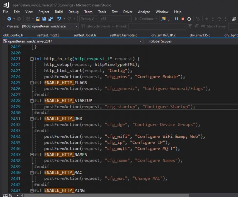

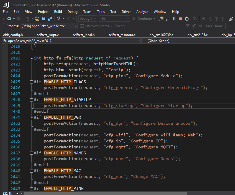

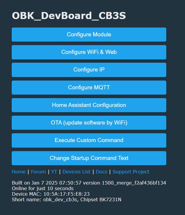

    I'm adding extra defines to obk_config.h so we can get a reduced size build. New changes include:
    - ability to turn off some of HTML pages, like flags, etc, as they are possible to set via console command
    - ability to turn off LED driver (the classic RGBCW PWM one)
    - ability to turn off the BL0942/BL0937 shared code
    - ability to turn off some drivers that were included by default in the past
    Currently, a reduced size build resides in:
    https://github.com/openshwprojects/OpenBK7231T_App/pull/1500
    OpenBK7231N_1500_merge_f2af436bf134.rbl is 405 200 bytes, while last public release, 1.18.12, is 500 800 bytes
    Can anyone try to run https://github.com/openshwprojects/OpenBK7231T_App/pull/1500 on BK7231 via wires and give me some feedback, is it working at all, etc?
    Also, do we have all required commands in order to remove WiFi, IP, etc, config pages from HTML? Everything would have to be done via text commands.
    @divadiow @insmod @DeDaMrAz @max4elektroda
    PS: On my side on BK721N:
    OBK_DevBoard_CB3S user interface with configuration menu.
    Defines:
    Screenshot of a code editor showing a fragment of the openBeken_win32_msvc2017 file.

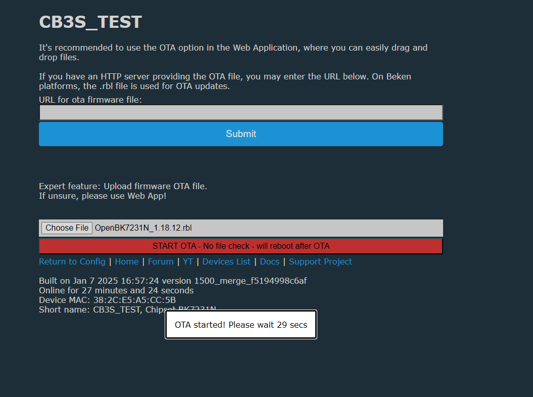

    Working from PR 1500
    IoT controller software interface screen with configuration options.
    OTA from file select works
    Web page with OTA update form for CB3S_TEST.
    Caution to users who would like to try - very WIP!!

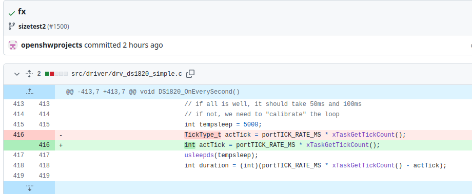

    This may be taking space:
    https://github.com/openshwprojects/OpenBK7231...1t/bk7231t_os/beken378/driver/common/dd.c#L82

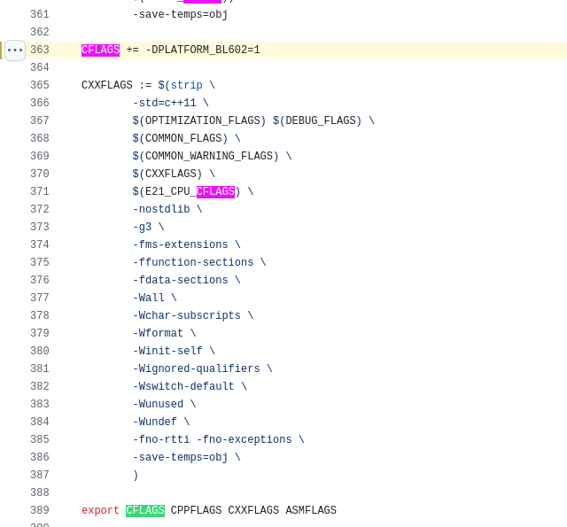

    Btw, very strange. I added this to drv_ir.cpp:
    Code: C / C++
    Why in BL602 build do I get:
    In file included from /home/runner/work/OpenBK7231T_App/OpenBK7231T_App/sdk/OpenBL602/customer_app/bl602_sharedApp/bl602_sharedApp/shared/src/driver/drv_ir.cpp:2:
    /home/runner/work/OpenBK7231T_App/OpenBK7231T_App/sdk/OpenBL602/customer_app/bl602_sharedApp/bl602_sharedApp/shared/src/driver/../obk_config.h:20:5: warning: "PLATFORM_XR809" is not defined, evaluates to 0 [-Wundef]
     #if PLATFORM_XR809
    /home/runner/work/OpenBK7231T_App/OpenBK7231T_App/sdk/OpenBL602/customer_app/bl602_sharedApp/bl602_sharedApp/shared/src/driver/../obk_config.h:25:7: warning: "PLATFORM_W600" is not defined, evaluates to 0 [-Wundef]
     #elif PLATFORM_W600
    /home/runner/work/OpenBK7231T_App/OpenBK7231T_App/sdk/OpenBL602/customer_app/bl602_sharedApp/bl602_sharedApp/shared/src/driver/../obk_config.h:36:7: warning: "PLATFORM_W800" is not defined, evaluates to 0 [-Wundef]
     #elif PLATFORM_W800
    /home/runner/work/OpenBK7231T_App/OpenBK7231T_App/sdk/OpenBL602/customer_app/bl602_sharedApp/bl602_sharedApp/shared/src/driver/../obk_config.h:45:7: warning: "WINDOWS" is not defined, evaluates to 0 [-Wundef]
     #elif WINDOWS
    /home/runner/work/OpenBK7231T_App/OpenBK7231T_App/sdk/OpenBL602/customer_app/bl602_sharedApp/bl602_sharedApp/shared/src/driver/../obk_config.h:98:7: warning: "PLATFORM_BL602" is not defined, evaluates to 0 [-Wundef]
     #elif PLATFORM_BL602
    /home/runner/work/OpenBK7231T_App/OpenBK7231T_App/sdk/OpenBL602/customer_app/bl602_sharedApp/bl602_sharedApp/shared/src/driver/../obk_config.h:124:7: warning: "PLATFORM_BEKEN" is not defined, evaluates to 0 [-Wundef]
     #elif PLATFORM_BEKEN
    /home/runner/work/OpenBK7231T_App/OpenBK7231T_App/sdk/OpenBL602/customer_app/bl602_sharedApp/bl602_sharedApp/shared/src/driver/../obk_config.h:130:7: warning: "PLATFORM_LN882H" is not defined, evaluates to 0 [-Wundef]
     #elif PLATFORM_LN882H
    /home/runner/work/OpenBK7231T_App/OpenBK7231T_App/sdk/OpenBL602/customer_app/bl602_sharedApp/bl602_sharedApp/shared/src/driver/../obk_config.h:150:7: warning: "PLATFORM_ESPIDF" is not defined, evaluates to 0 [-Wundef]
     #elif PLATFORM_ESPIDF
    /home/runner/work/OpenBK7231T_App/OpenBK7231T_App/sdk/OpenBL602/customer_app/bl602_sharedApp/bl602_sharedApp/shared/src/driver/../obk_config.h:176:7: warning: "PLATFORM_TR6260" is not defined, evaluates to 0 [-Wundef]
     #elif PLATFORM_TR6260
    /home/runner/work/OpenBK7231T_App/OpenBK7231T_App/sdk/OpenBL602/customer_app/bl602_sharedApp/bl602_sharedApp/shared/src/driver/../obk_config.h:190:7: warning: "PLATFORM_RTL87X0C" is not defined, evaluates to 0 [-Wundef]
     #elif PLATFORM_RTL87X0C
    /home/runner/work/OpenBK7231T_App/OpenBK7231T_App/sdk/OpenBL602/customer_app/bl602_sharedApp/bl602_sharedApp/shared/src/driver/../obk_config.h:215:2: error: #error "Platform not defined"
    /home/runner/work/OpenBK7231T_App/OpenBK7231T_App/sdk/OpenBL602/customer_app/bl602_sharedApp/bl602_sharedApp/shared/src/driver/../obk_config.h:220:5: warning: "ENABLE_DRIVER_BL0937" is not defined, evaluates to 0 [-Wundef]
    Global platform PLATFORM_BL602 define is not defined in BL602 in cpp files?

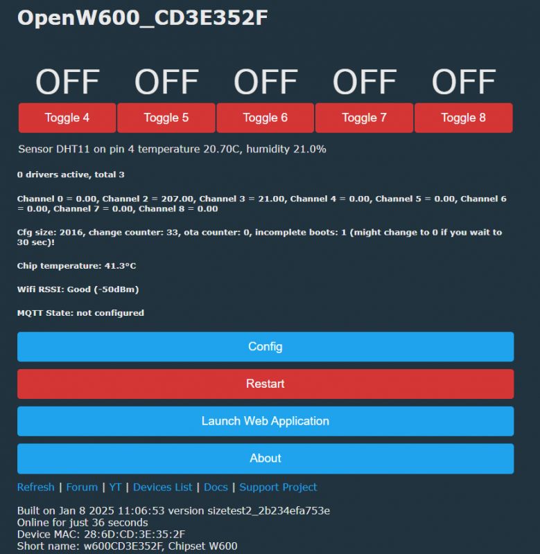

  • January 8 build works on WBR3, N, and T modules

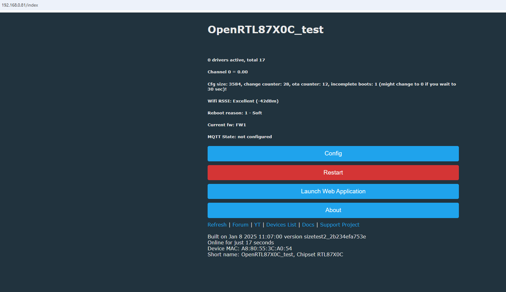

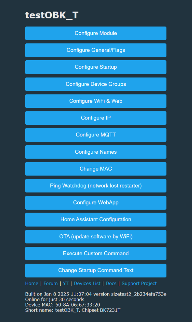

    #11 21384037
    DeDaMrAz
    Posts: 620
    Help: 34
    Rate: 130

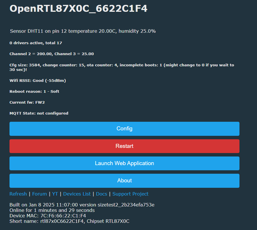

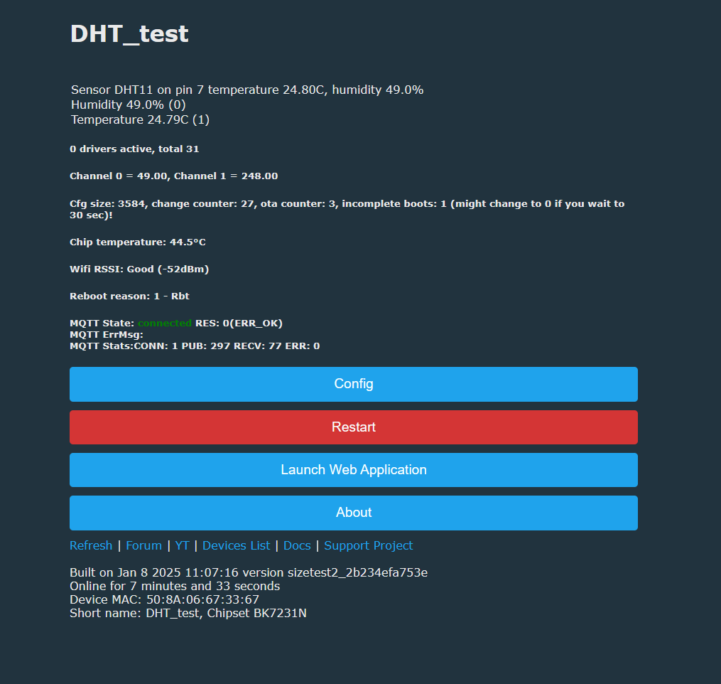

    Latest build from 8th January is working on WBR3 module
    A screenshot of the OpenRTL87X0C test interface showing system information.
    It is working on N module with DHT test
    Screenshot of DHT_test interface with DHT11 sensor data.
    DHT sensor is working but it will need more attention at some point as well.
    T module is working as well
    Configuration screen of the testOBK_T interface with various configuration options.
    Note, all of these are test boards with very limited or none of drivers running or devices attached. I did try to run some of the drivers (without problems) but without external devices I can't provide more relevant data at this point.

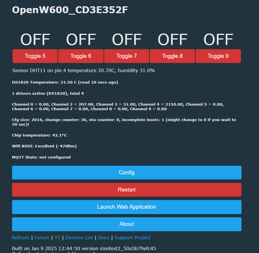

  • Driver availability tested on W600, WBR3, and CB3S
    #12 21384088
    Posts: 14743
    Rate: 12839

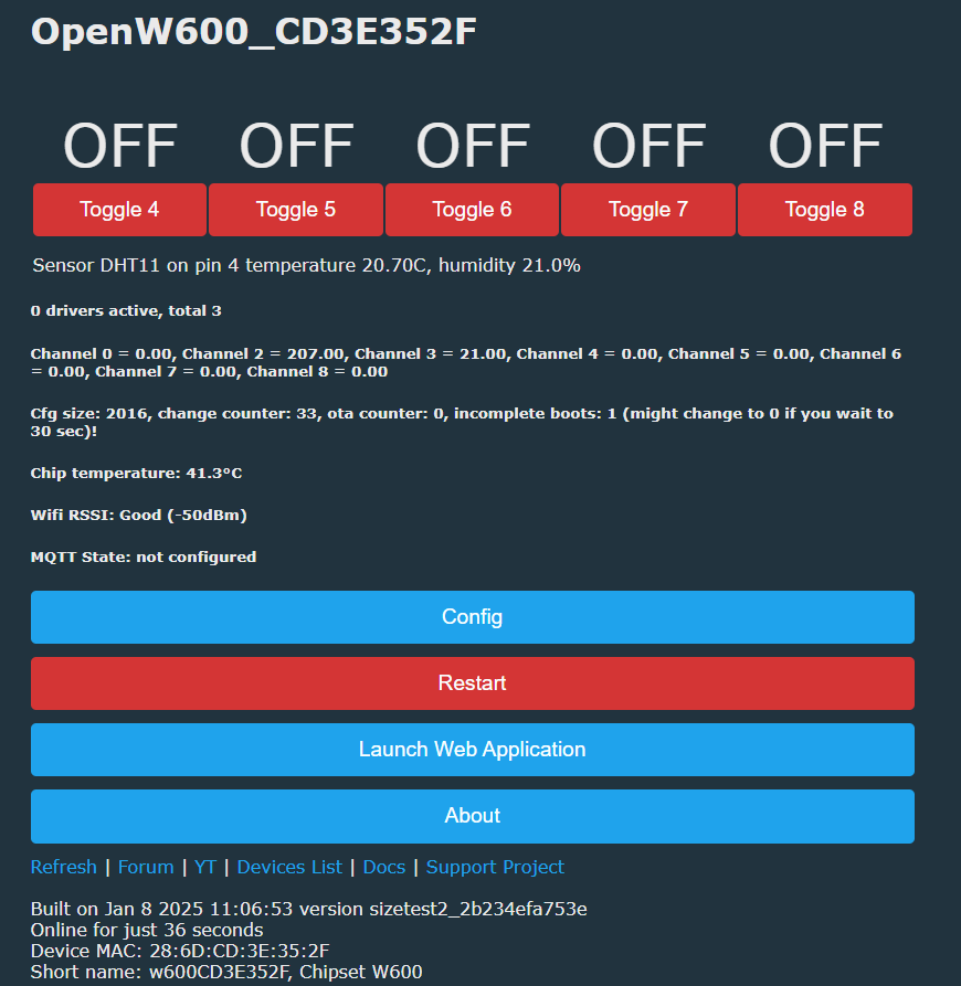

    W600 DHT works:
    OpenW600 user interface with temperature and humidity data
    Drivers in W600 (DHT is not listed as driver, sorry):
    Available drivers:
    - NTP
    - BL0937
    - DGR
    Test in WBR3:

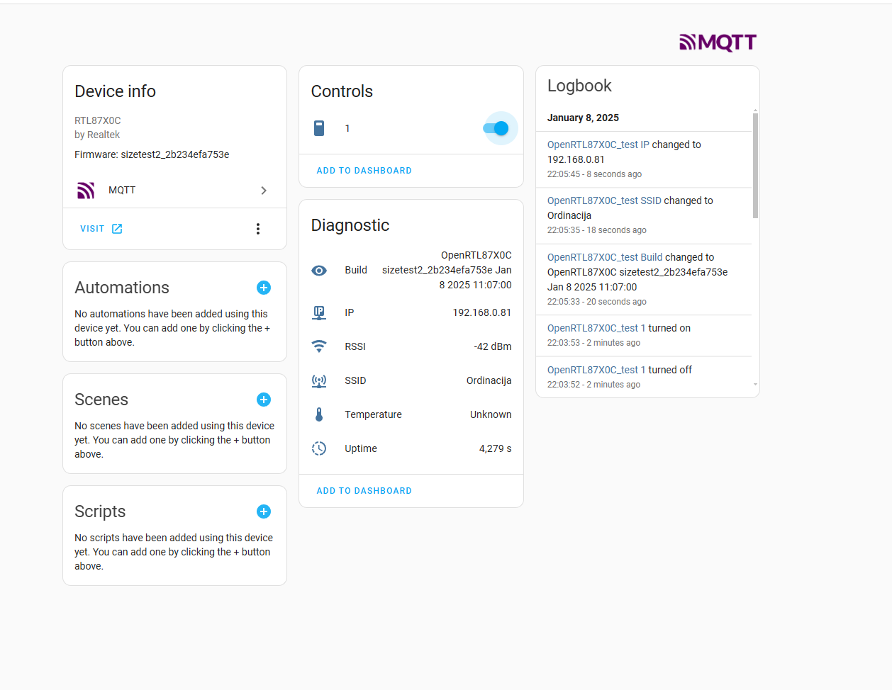

  • #13 21384099
    DeDaMrAz
    Posts: 620
    Help: 34
    Rate: 130
    HA Discovery and LFS on RTL87X0C works.
    User interface of RTL87X0C device management system displaying diagnostic information and logbook.
    I only got powersave 1 in lfs but it is working on every startup and lfs is there after the reboot.

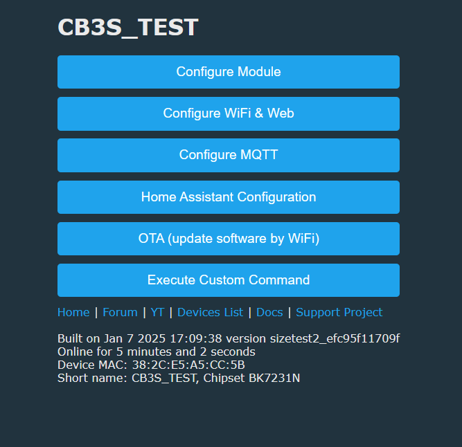

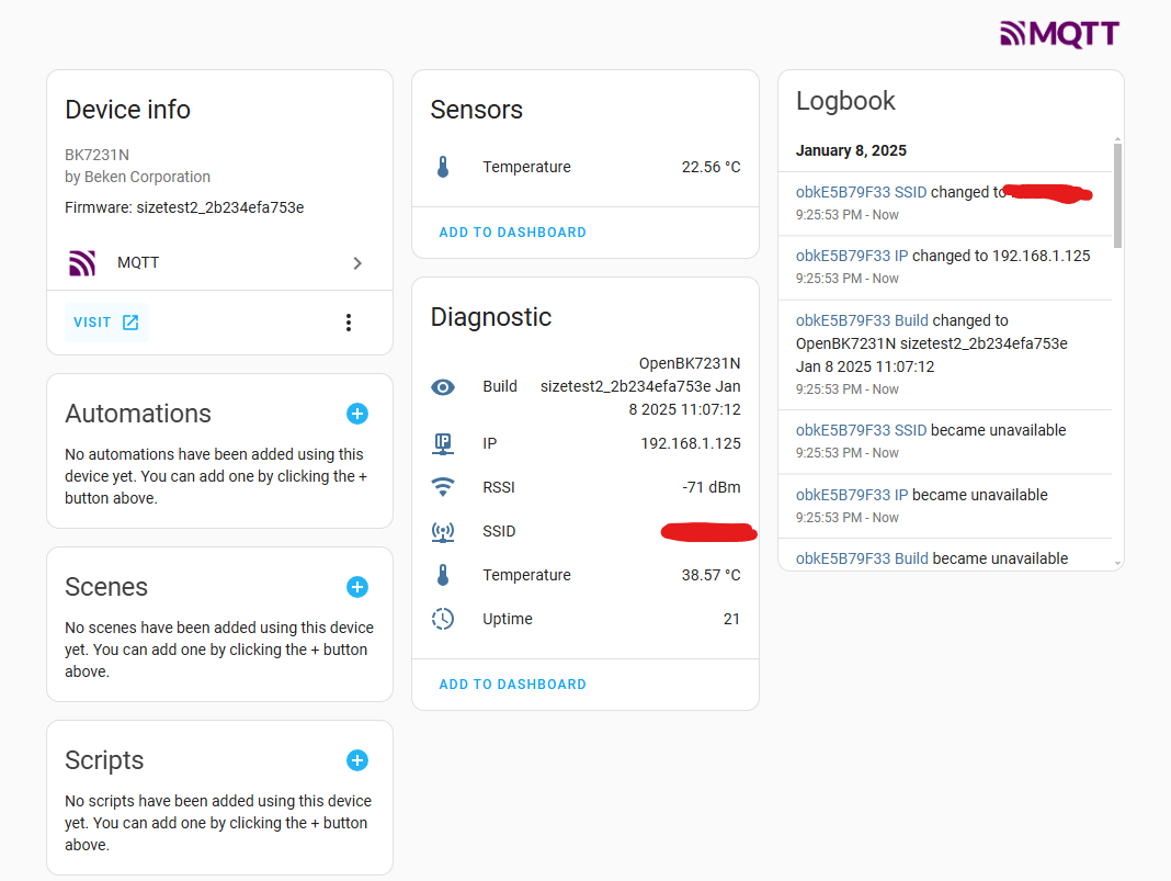

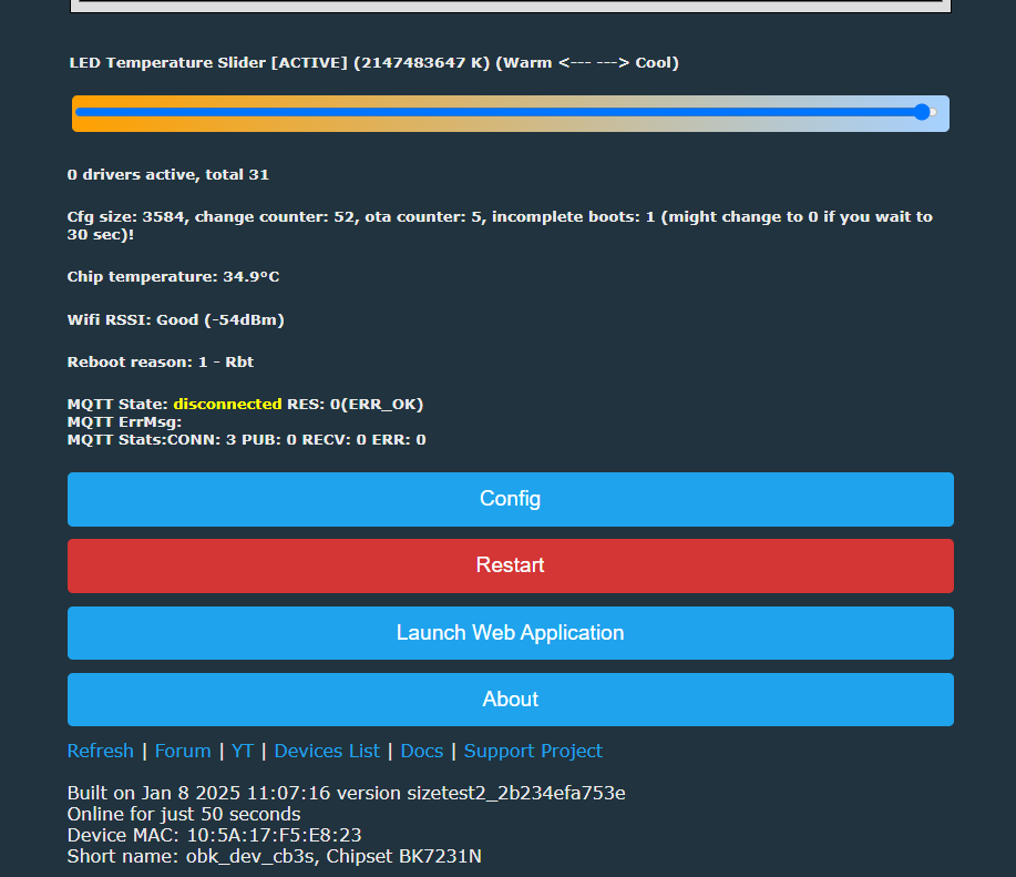

  • OTA and MQTT work on CB3S sizetest build
    #14 21384150
    Posts: 5195
    Help: 446
    Rate: 913

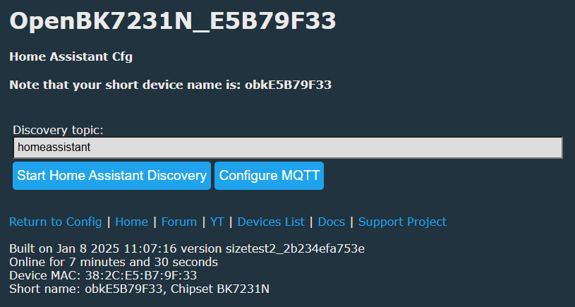

    This is potentially a lot to test...

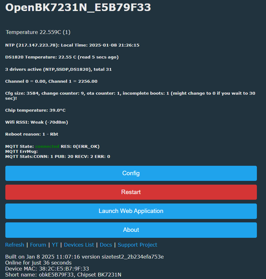

    OTA on CB3S from 1.18.13 to sizetest2_2b234efa753e. DS1820 already configured. still works. so does SSDP
    Screenshot of OpenBK7231N user interface with temperature information, MQTT connection status, and configuration buttons.
    MQTT connected OK (I manually returned to home - are we to wait for some confirmation of something?)
    OpenBK7231N interface displaying version and device connection information.
    Screenshot of the OpenBK7231N interface with Home Assistant and MQTT configuration options. User interface of a device control panel displaying firmware information and logs. Screenshot of a text editor with the /autoexec.bat file open containing a script.

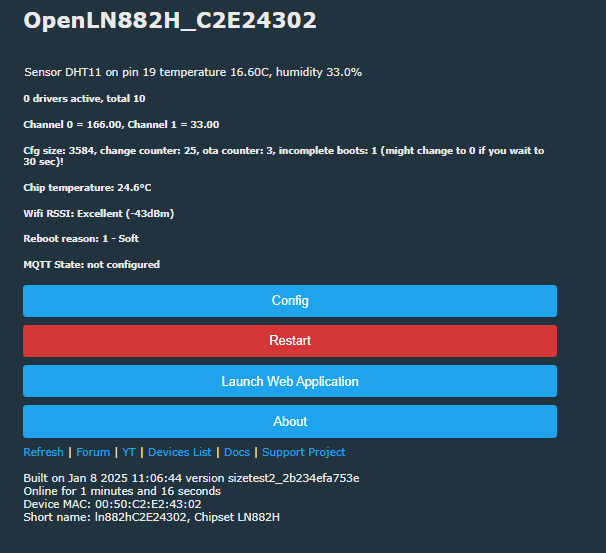

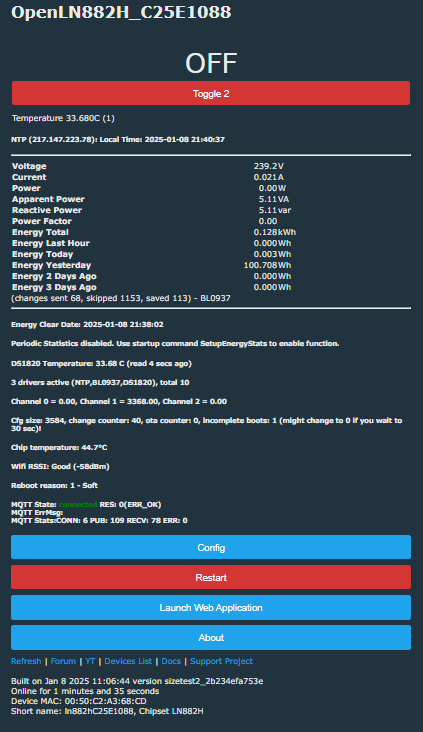

    LN882H DHT works:
    Screenshot of the OpenLN882H interface with temperature and humidity data.
    Drivers:
    Available drivers:
    - NTP
    - BL0937
    - DGR
    - Wemo
    - Hue
    - SM2135
    - BP5758D
    - BP1658CJ
    - SM2235
    - DS1820
    Added after 38 [seconds]:

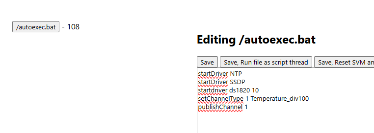

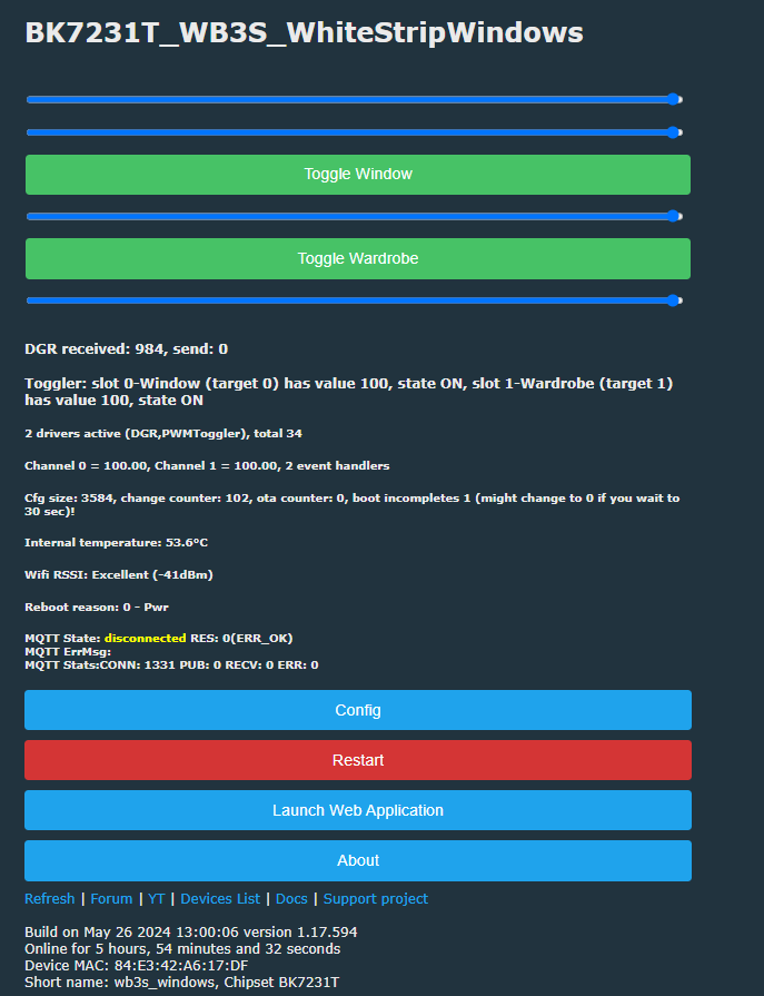

    Let's do something more exciting, I will test this build on my room lights. If I break them, I will have to sit in the dark.
    User interface for a lighting control system based on the BK7231T chip with two adjustment sliders.
    Autoexec copy:
    startDriver PWMToggler
    toggler_channel0 0
    toggler_name0 Window
    toggler_channel1 1
    toggler_name1 Wardrobe
    alias on backlog toggler_enable0 1; toggler_enable1 1;
    alias up backlog on; toggler_set0 +10; toggler_set1 +10;
    alias down backlog on; toggler_set0 -10; toggler_set1 -10;
    addEventHandler OnClick 0 up
    addEventHandler OnClick 1 down
    Template:
    Testing my lights in 3, 2, 1...
    Ok, I lost my autoexec.bat, but rest is still working. We really need to add warning for that autoexec.bat or shrink default LFS size AGAIN.
    The lights are still working.

    Help: 446
    Rate: 913

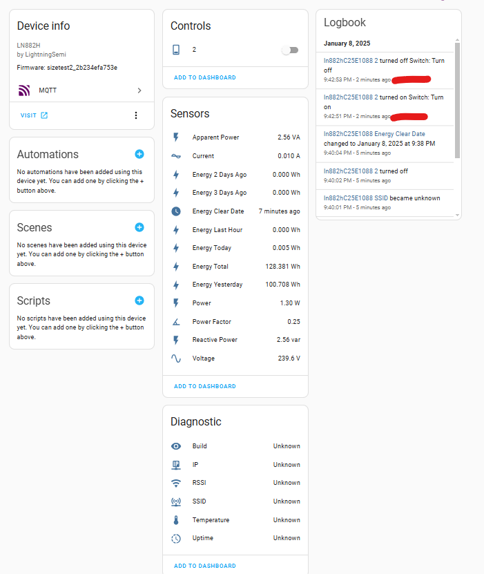

    LN OTA from 1.17.765 to sizetest2_2b234efa753e
    BL0937 and DS1820, LFS, NTP, MQTT = ok
    Screenshot of OpenLN882H interface displaying temperature and energy data. Screenshot of a device interface displaying device info, sensors, and event log.
    Added after 21 [minutes]:
    what to test next...? what do you want to see? everything...?

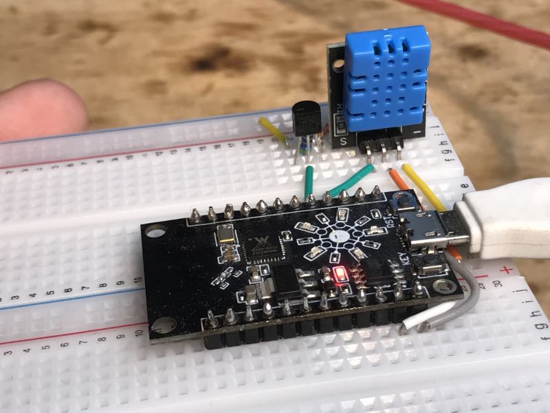

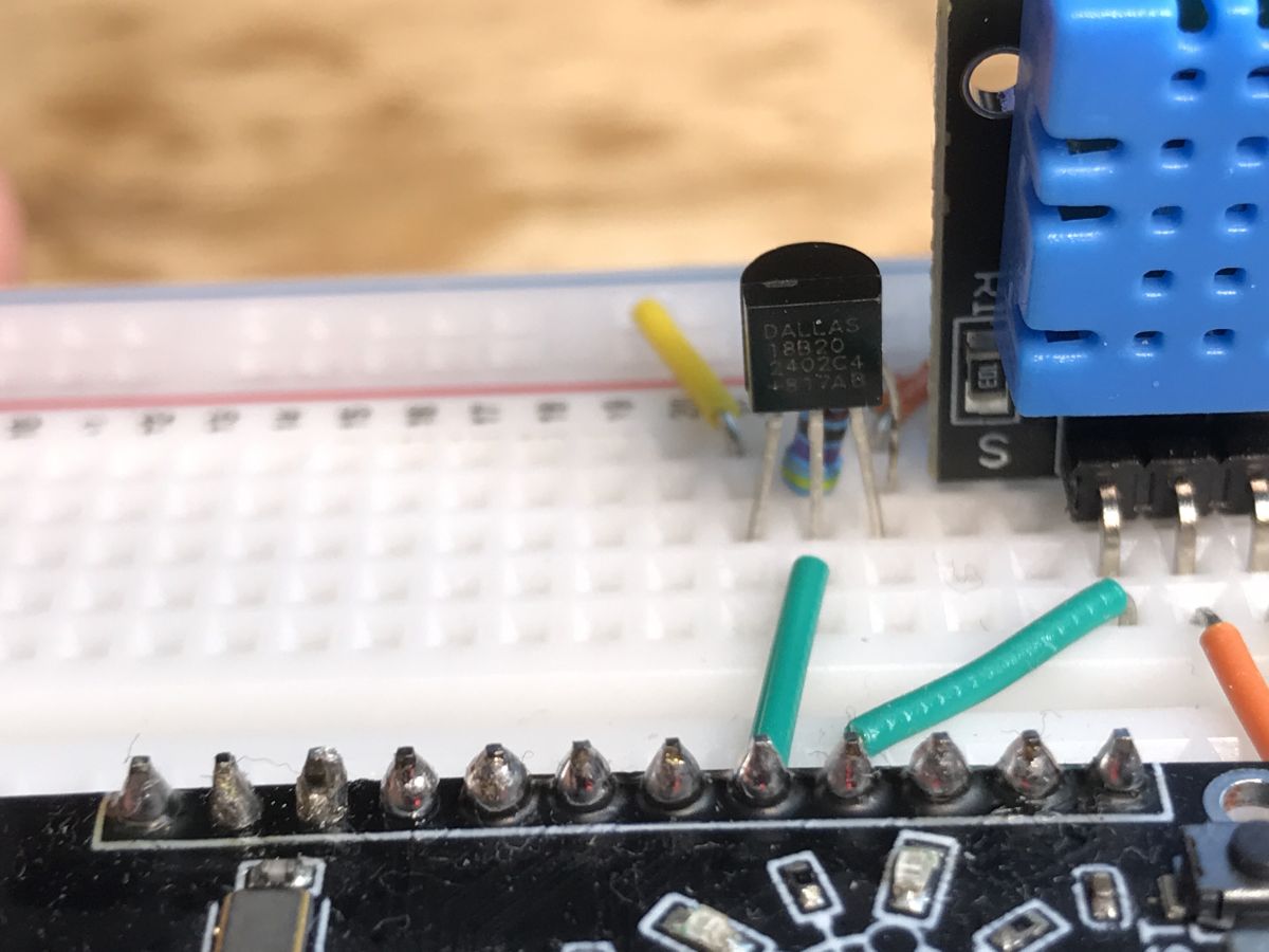

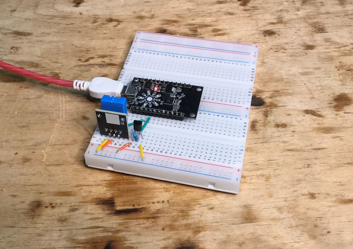

  • DS18B20 enabled on W600 after type fix
    #25 21384891

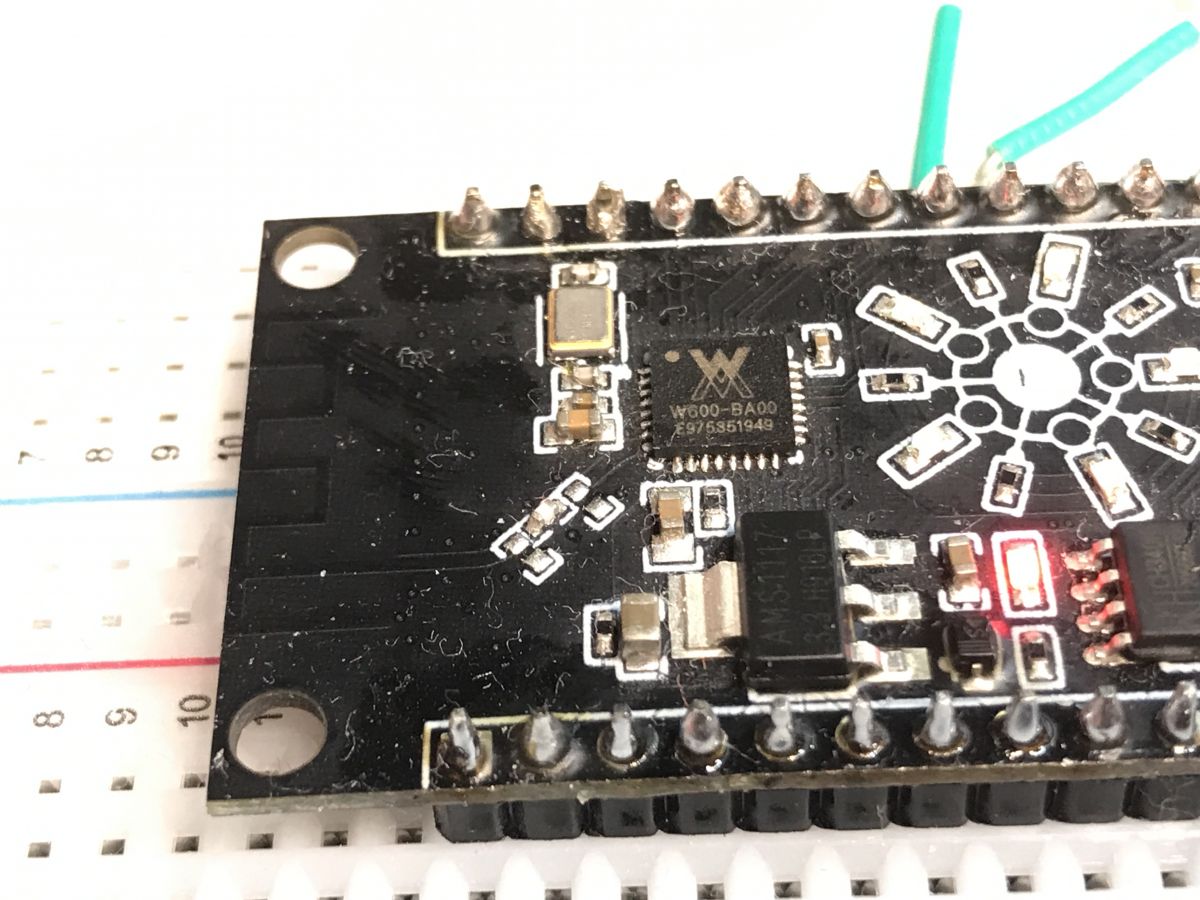

    Posts: 14743
    Rate: 12839
    I've enabled DS18B20 on W600, most likely for the first time ever. I had to fix one small type error:
    User interface on the OpenW600 configuration page with temperature and humidity information.
    This makefiles in App change by Max (if I remember correctly) is very useful.
    W600 microcontroller on a breadboard with a connected DS18B20 sensor.
    W600 microcontroller connected to a DS18B20 temperature sensor on a breadboard.
    Close-up of a PCB with a W600-BA00 chip and an LED diode.
    Close-up of a DS18B20 chip on a breadboard with colored wires.
  • Add PLATFORM_BL602 to CXXFLAGS for cpp files
    #26 21385028
    max4elektroda
    Posts: 758
    Help: 49
    Rate: 189
    The define is only set in "CFLAGS" in https://github.com/openshwprojects/OpenBL602/blob/master/make_scripts_riscv/project.mk#L363
    Screenshot showing a fragment of a makefile used in the OpenBL602 project. In line 363, CFLAGS is set to -DPLATFORM_BL6021.
    and since this is a .cpp file, I would expect it should be also in CXXFLAGS or in CPPFLAGS like
    CXXFLAGS += -DPLATFORM_BL602=1
    Sorry, can't do a PR atm...
    Added after 19 [minutes]:
    Just made
    https://github.com/openshwprojects/OpenBL602/pull/6

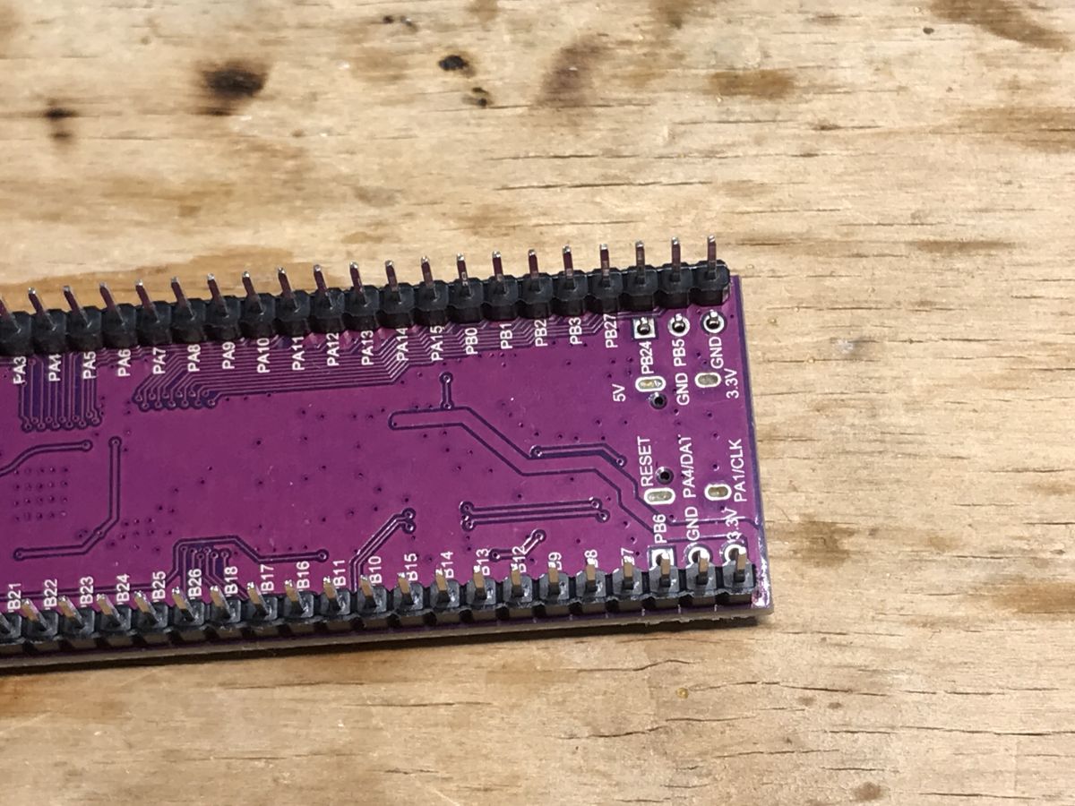

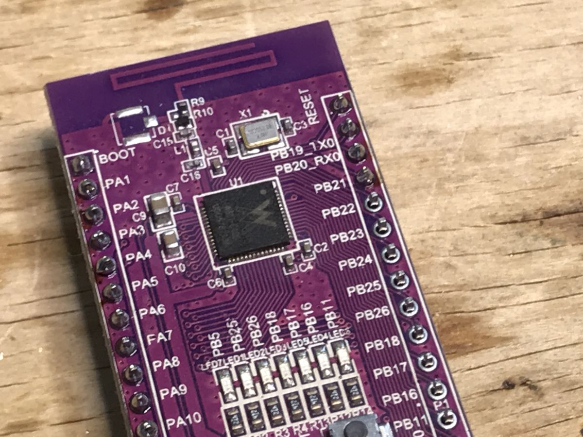

  • W801 flashes but stays silent over UART

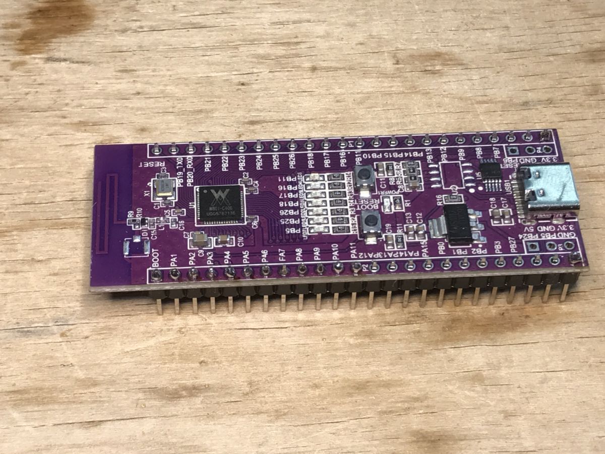

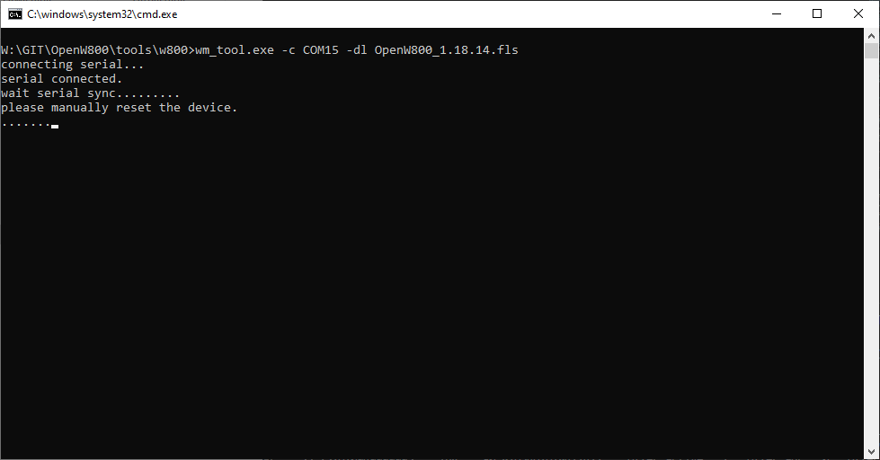

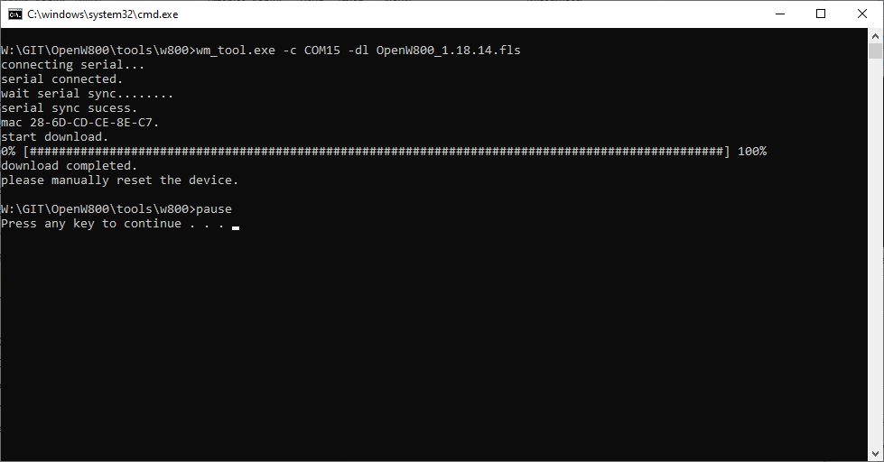

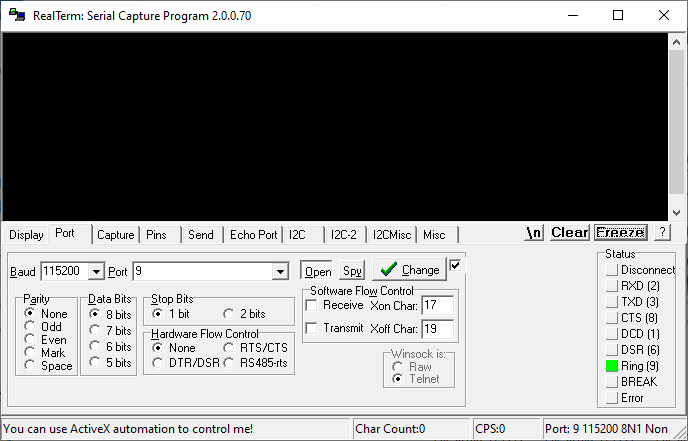

    #29 21385177
    Posts: 14743
    Rate: 12839
    I will merge that PR and I'll let you do adjustments.
    First, I have another problem.
    Did W801 require anything else besides power off/on after flashing?
    The W801 board I received can be flashed, but is silent over UART and creates no APP:
    Screenshot of CMD console showing a device flashing process for W801.
    Terminal window showing the flashing process of the W801 device.
    W801 microcontroller board placed on a wooden table.
    PCB with W801 microcontroller, showing pin labels.
    PCB board with pin layout and labels on a wooden background.
    It's 100% silent over UART:
    Screenshot of RealTerm serial capture program showing no data on a black background.
    Tested with:
    - OpenW800_1.17.215.fls
    - OpenW800_1.18.14.fls
    The same happens. And it is my first time flashing this W801, I remember other W80X worked for me well.
    Do anyone also have W80X and can check whether those releases work there? Do they print over UART?
