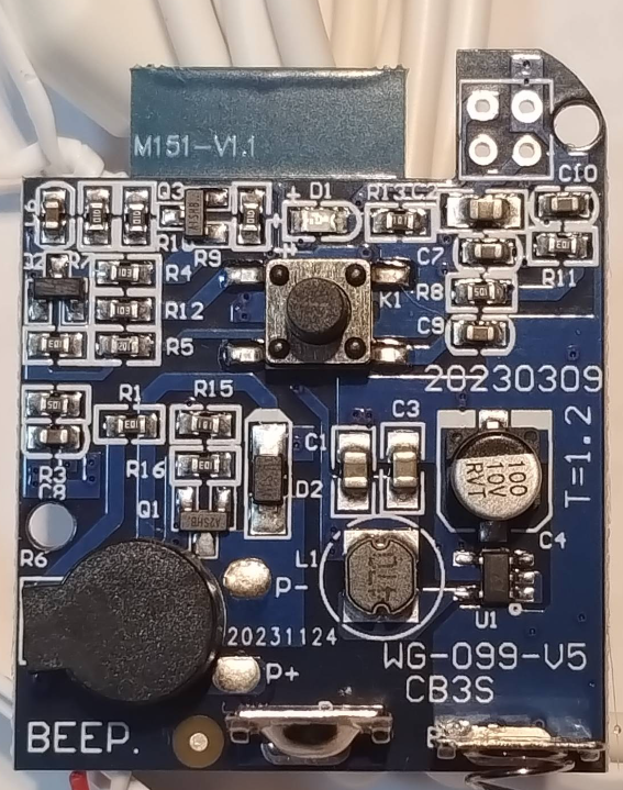

    WiFi water leakage detector with a cable Tuya 898FT. Text on a product label for the Tuya water leak sensor model 898FT. A circuit board labeled WG-099-v5 with electronic components and markings. Close-up view of an electronic module on a blue printed circuit board.
    Tuya Water Leak Sensor 898FT
    Board: WG-099-v5
    Dates: 20230309 20231124
    Other text: T=1.2 (?)
    No further work done yet.

    cool. Interesting to see another CB3S with M151-V1.1 on the back. I got a new device yesterday with the same but haven't found any record about what it means.

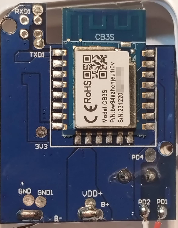

    after hours of struggles I decided to nuke the device (erasing flash) so I did not have a backup. I have however made some photos of the inside of the device:
    ![image](https://github.com/user-attachments/assets/fe956653-da19-41e9-b393-f9d26c2520d3)
    Another thing to note is that the CEN pins (multiple?) CEN (chip enable) on pin 1 does not reset the MCU when pulled down, CEN on pin 3 works.
    ![image](https://github.com/user-attachments/assets/7395acee-00db-4b2f-a340-ccbe2bde440e)
    ![image](https://github.com/user-attachments/assets/6ff15b1e-4746-4850-a004-e180d658794f)
