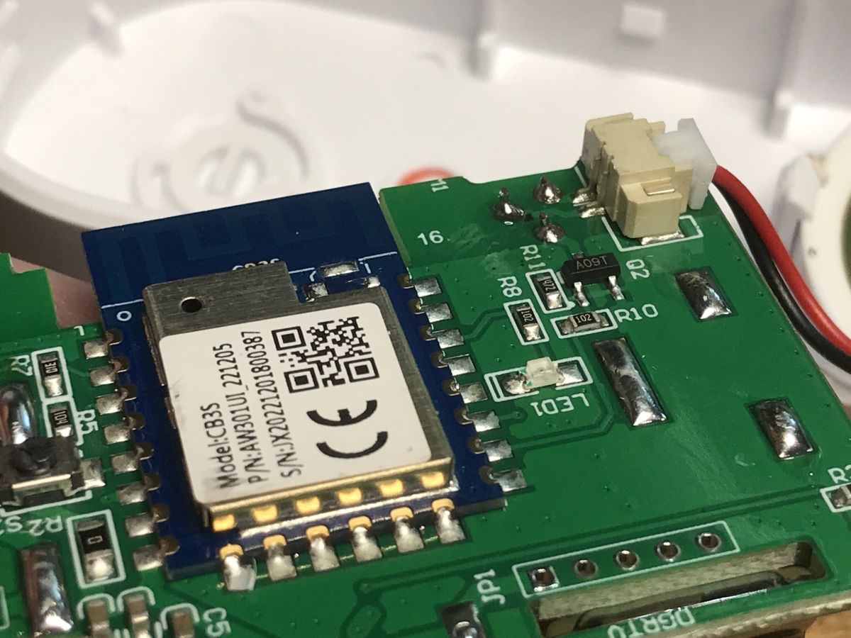

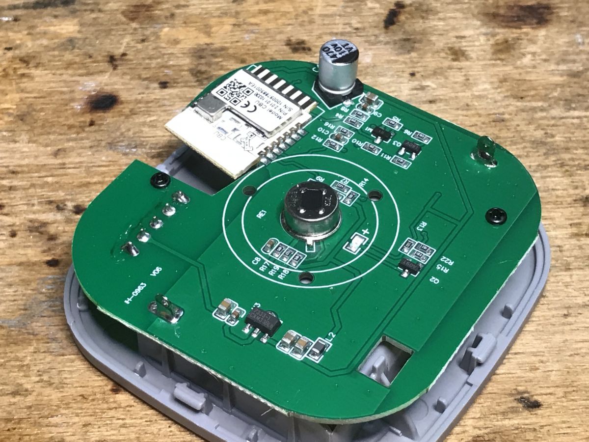

    The inside of the sensor
    We look inside. What do we see first?
    [CB3S/BK7231N] Temperature/Humidity Sensor with TuyaMCU - Diagram, Reverse Engin [CB3S/BK7231N] Temperature/Humidity Sensor with TuyaMCU - Diagram, Reverse Engin
    This is a device based on TuyaMCU. We have a separate WiFi module (CB3S, i.e. BK7231N) and a microcontroller.
    TuyaMCU is a UART based protocol through which this MCU communicates with the WiFi module.
    CB3S pinouts are known:

    The MCU has not been identified, but this is how they are connected in general:
    Block diagram of MCU and Wi-Fi module cooperation.
    It's just that in the case of TuyaMCU in battery devices, the MCU additionally controls the power supply of the WiFi module.
    Here is the diagram (drawn by a friend):
    ESP12 in the diagram is illustrative, in fact it is CB3S. The CB3S power supply is controlled by the MCU via a MOSFET. The WiFi module communicates with the MCU via UART, through the TuyaMCU protocol. The MCU itself reads the measurements from the SHT30 via I2C (you can even see the pull up resistors).
    So what will have to be done to change the firmware of the WiFi module, i.e. to free the device from the manufacturer's cloud?
    - you need to properly handle communication with the MCU (TuyaMCU protocol)
    - you have to deal with the fact that the MCU will turn off the WiFi module during operation ...

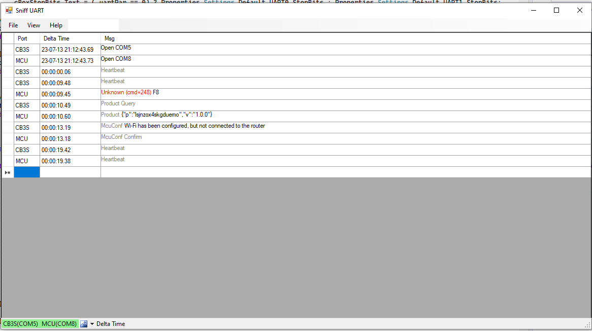

    You can use my analyzer to analyze TuyaMCU:
    https://www.elektroda.com/rtvforum/topic3970199.html#20528459
    Here is a pre-processed UART dump from my program:

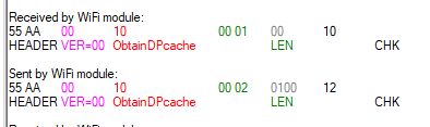

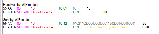

    Received by WiFi module:
    55 AA	00	10		00 01	00	10
    HEADER	VER=00	ObtainDPcache		LEN		CHK
    Sent by WiFi module:
    55 AA	00	10		00 02	0100	12

    1. The MCU turns on the power to the WiFi module. The WiFi module sends a request for identification to the MCU (package 0x01 - Query product information), and it responds and gives {"p":"byusvumeme5iicad","v":"1.0.0"} :
    2. Now WiFi successively reports the connection status (type 0x02 - Report the network status of the device), first status 0x03 (WiFi connected), MCU confirms receipt, and then status 0x04 (cloud connected - in our OBK as MQTT):

    3. Then there is the ObtainDPCache data exchange, which exists only in devices with configuration remembered on the MCU, e.g. the door opening / closing sensor does not have it:
    Nothing has been sent in the screenshot above, but if we changed the reporting frequency in the settings, for example, this packet would contain information about it.
    ObtainDPCache works in such a way that when we want to, for example, set the time between measurements, the WiFi module downloads it from the cloud when the MCU turns it on and then waits for the MCU to ask it about these ObtainDPCache. The MCU first asks for ObtainDPCache and the WiFi module replies with a list of dpID/type/value variables. The MCU picks it up and saves it. Thus, the MCU knows how often to wake up and pass the measurement on.

  • Empty 0x10 packet means no data to report

    If you want to capture some 0x10 data along with dpIDs, you must take following steps:
    1. setup capture
    2. then in Tuya app, change some kind of parameter, maybe "report period"
    3. then check capture for 0x10 packet and it should contain report period dpID, value and type.
    It will be like:
    55AA0010001201021102000400000001120200040000000155

    low level callback in C#
    @p.kaczmarek2 As I wrote in another thread, I wanted to develop a bidirectional Port sniffer in C#.
    In the past I'd used this approach to access serial USB ports and to be close to 'real time'. My gaol was to record 2 ports in parallel - you have been quicker than me ;-)
    Also in your Analyzer ther is a build-in decoding of the Tuya MCU messages, which is not in my code :-(
    The port functions in your code are the same. I figured out, that the time-outs must be configured to get 'real time'. You might have a look at the source code https://github.com/MkMunich/SniffUART/tree/master/SniffUART
    Best regards mkMunich

  • ReadLoop and ReadBytes handle serial timeouts
    #19 20645901
    mkmunichmk
    Posts: 32
    Your link is giving me 404 error:
    Sorry, forgot to make the project public.
    Class PortHandler is handling the stuff. The timeouts are set in c'tor.
    Reading is split up to the inner function to ReadBytes() which is either timing out or delivering received bytes and ReadLoop() which is looping until a chunk of bytes had been received and providing the bytes with a time stamp to the form to get displayed.
    Sounds a bit strange, but is needed, as the Form is a seperate thread...

  • SniffUART suggested for TuyaMCU message decoding
    #23 20653382
    mkmunichmk
    Posts: 32
    I do not have the hardware at hand to check it now
    Thought you had at least 2 USB adapters? Anyway, they are cheap :-)
    If you have time, you might have a look to https://github.com/MkMunich/SniffUART
    I started Msg decoding. Luckily I can use the Tuya documentation of the MCU protocol - so I started from scratch as this is more maintainable...

What does the TuyaMCU ObtainDPCache command 0x10 do, and how is it used to change the reporting interval?
Command 0x10 lets the MCU ask the WiFi module for cached settings, such as reporting intervals. The WiFi module replies with dpID, type, and value records. In OpenBeken, the extra 1 in linkTuyaMCUOutputToChannel 17 val 5 1 marks that channel as dpCache data. The MCU can then store values like 1 minute or 60 minutes and use them for future wake cycles. [#20584330]

Which chip on the TH01 temperature and humidity sensor PCB actually measures temperature and humidity, such as SHT30, CHT8310, or U4?
The temperature and humidity sensor is the small sensor IC marked as U4 on the PCB photo, and the original analysis identifies the measured device as SHT30 over I2C. Later variants may use a CHT8310 T/H sensor. The MCU, not the CB3S, reads this sensor and then sends values through TuyaMCU dpIDs. [#21330698]
