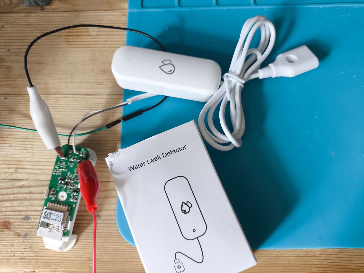

  • TY-SJ-01 leak detector uses CBU/BK7231N module
    #1 21097283
    Posts: 5216
    Help: 448
    Rate: 917
    Just wanted to add another device to the device list and have a thread to link it to. I won't go into too much detail about the flashing and config as there are many other threads for very similar devices.
    This is from Ali https://www.aliexpress.com/item/1005006024045641.html
    Screenshot of a product page for a Tuya water sensor on AliExpress.

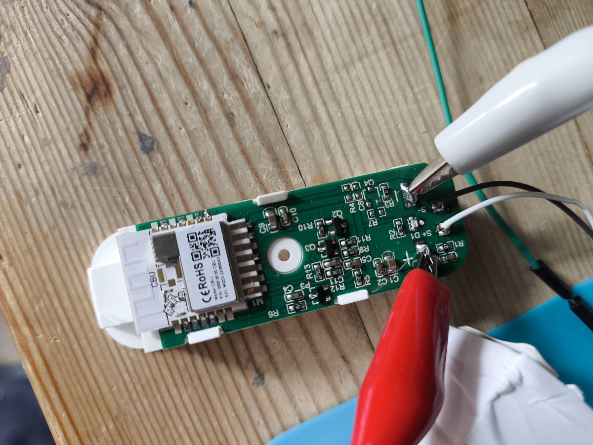

    CBU/BK7231N module.

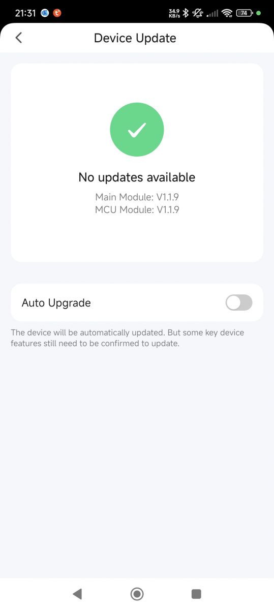

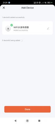

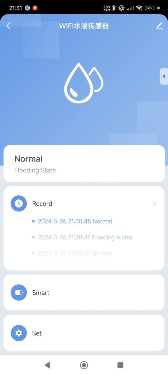

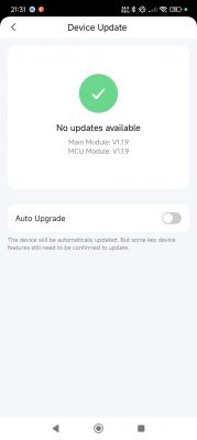

    Device update screen indicating no updates available. Screenshot of a mobile app showing the state of a water sensor. App screen for adding a device with a successfully added water sensor. Image of a water leak detector box with technical specifications displayed. CBU/BK7231N module on a table with connecting wires. Water leak detector module with electronic components.
    boot log

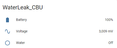

    autoexec to publish and label water sensor state and put into deep sleep, configure battery.
    Screenshot displaying WaterLeak_CBU sensor status information.
    Could probably get fancier with dry/wet sensor state, instead of on/off, in HA. And a nice automation to raise an email or other kind of alarm when water is detected. Device won't currently stay awake if water is detected.
    Device does wake from deep sleep on button push and on sensor state change. Successful MQTT connection required.
