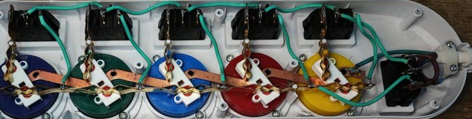

  • The Interlook BA-3505-WHITE power strip has five coloured sockets, separate switches for each outlet, a main switch, and advertised anti-surge and USB-device protection.
  • Opening it reveals a simple internal build: the grounding is connected, but the socket switches appear to cut only one conductor.
  • The supposed protection circuitry is just a single 14D471K varistor soldered loosely at the strip switch.
  • The solder joints look poor and some seem close to failure, so the strip hardly inspires confidence for a 10A rating.

    I have a similar skirting board, only that the phase is common and the neutrals to the individual sockets are disconnected.
    Is it possible to reverse the cables in this case so that the common is the neutral line?
    Interior of a power strip with visible colorful sockets and wiring. .

    Daroken wrote:
    I have a similar strip, only that the phase is common and the neutrals to the individual sockets are disconnected.
    Is it possible in this case to reverse the cables so that the common is the neutral line?
    Why the assumption that the phase is common?
  • #67 21224386
    Daroken
    Posts: 86
    Because I checked with a tester and the bottom one (the common line in the photo) has phase.

  • #70 21224471
    acctr
    Posts: 4554
    Help: 389
    Rate: 2021
    Daroken wrote:
    Because I see different statements and images on the internet.
    Well that's just it - different. You plug into one socket you will have phase, on another it will be zero.
    The solution is a two-pole switch, but there are costs involved.

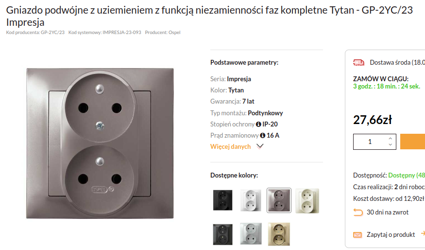

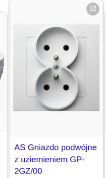

    Daroken wrote:
    Either way, what should "legitimate" sockets look like?
    In appearance almost the same as all double sockets.
    The construction of normal double sockets does not allow for the right-hand phase principle but it does allow for two earthed plugs to be plugged in correctly and the phase will be 'right-handed' on the appliance.
    White, double power outlet with grounding in a vertical arrangement. .
    There are double sockets which supposedly provide this but are more expensive and handicapped.
    Double socket with grounding in titanium color by Ospel, displayed on a sales platform. .
    You can plug a grounded plug into one such socket and a radio or shaver into the other.
    Two 90 °
    Two angled grounded plugs, one white and one black
    grounded plugs are not possible.
    Both plugs or at least one must be like that:
    url=https://obrazki.elektroda.pl/1943314100_1726211025.png]Black grounded plug on a white-gray background. [/url]
    In such a situation, a practical solution is to purchase a Czech socket.
    Double electrical socket with grounding on a beige frame. .
    All in all, the Czechs are right.
    Who knows what idea a profit-minded person ordering some equipment from a manufacturer in Asia will come up with?
    Here:
    https://www.elektroda.pl/rtvforum/topic3834251.html
    some more information.
