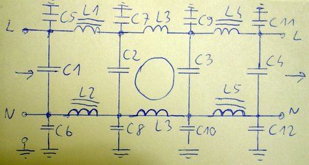

    I don't know if you have heard of conditioners from the Voodo audio world.
    They are LC filters and surge protectors. Apparently you can make your own and it can work.
    Appropriate varistors, filter circuits that limit everything but 50Hz.
    Here something from the web"
    Hand-drawn schematic of LC filter with a varistor

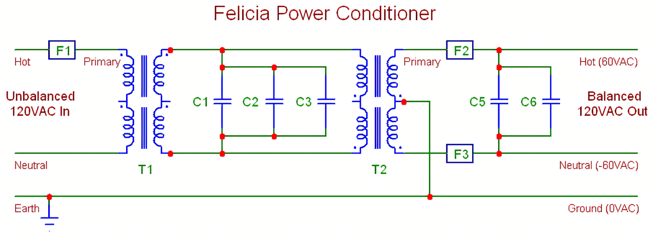

    Herea something from the US (for 120 VAC, but could probably be converted):
    Electrical schematic of the Felicia Power Conditioner with input and output parameters. .
    Is it with a varistor:
    Circuit diagram with LC filter and surge protection. .
    Over time this will probably become a necessity - more and more devices with switching power supplies will interfere. Who knows whether energy suppliers will not measure the harmonic content on the consumer side and thus impose the necessity of fitting filters in the form of surge strips with filters or something like audio conditioners.
