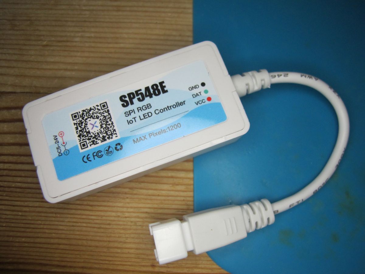

    Hi. I've just taken delivery of ANOTHER LED/SPI IoT controller. This is the SP548E from Ali Express https://fr.aliexpress.com/item/1005007039123431.html
    LED/SPI IoT Controller SP548E with remote control.
    Not knowing what it would come with, I was surprised to see it has a Beken BK7238, my first, at its core.

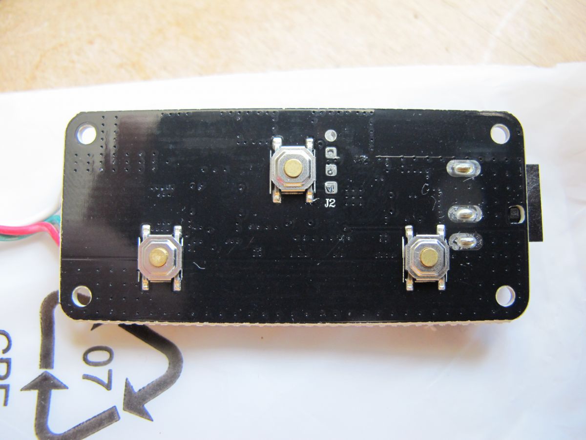

    LED/SPI IoT controller SP548E circuit board with Beken BK7238 chip. Black LED/SPI IoT controller SP548E with three buttons on top.
    I'll post as I discover more.

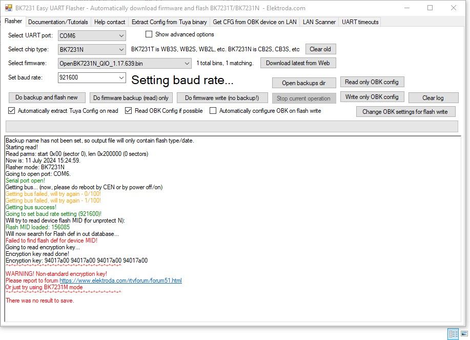

    reminded me of this https://github.com/openshwprojects/BK7231GUIFlashTool/issues/30
    Added after 2 [hours] 8 [minutes]:

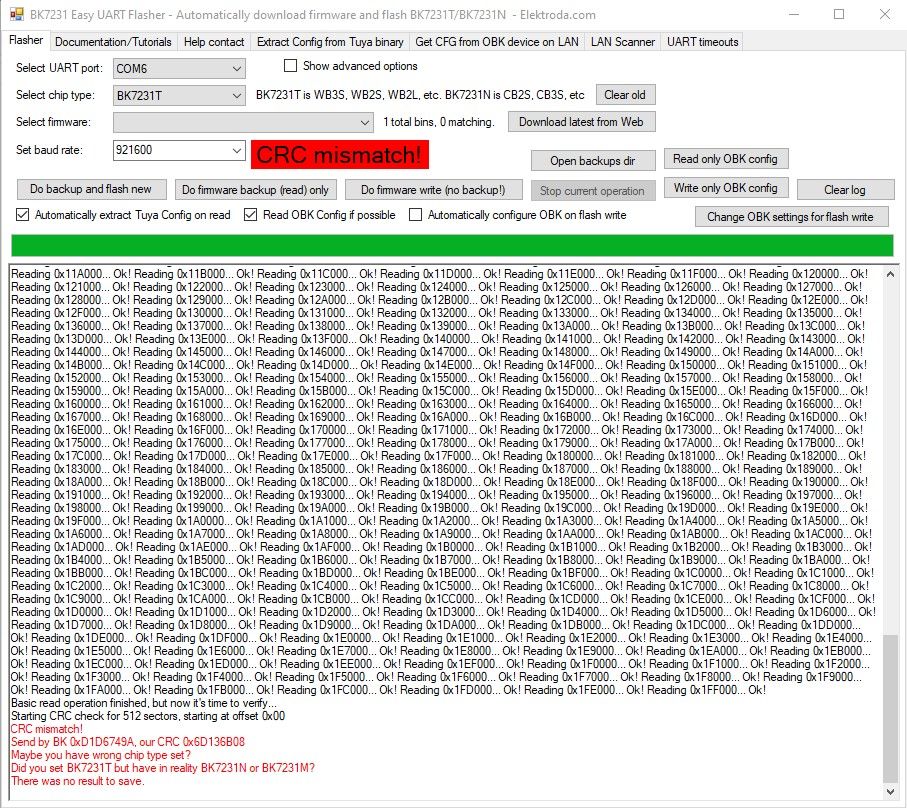

    RT-Threads bootloader
    Easy UART Flasher successfully reads the coeff key in BK-N mode but fails to backup firmware.
    Screenshot of BK7231 Easy UART Flasher software showing configuration and results of flashing operation with settings for COM6 port for BK7231N chip.
    BK-T mode reads the flash but fails CRC at the end, so no file saved.
    Screenshot of Easy UART Flasher software with a CRC error message.
    Attempt with BKFIL bk_loader.exe was successful

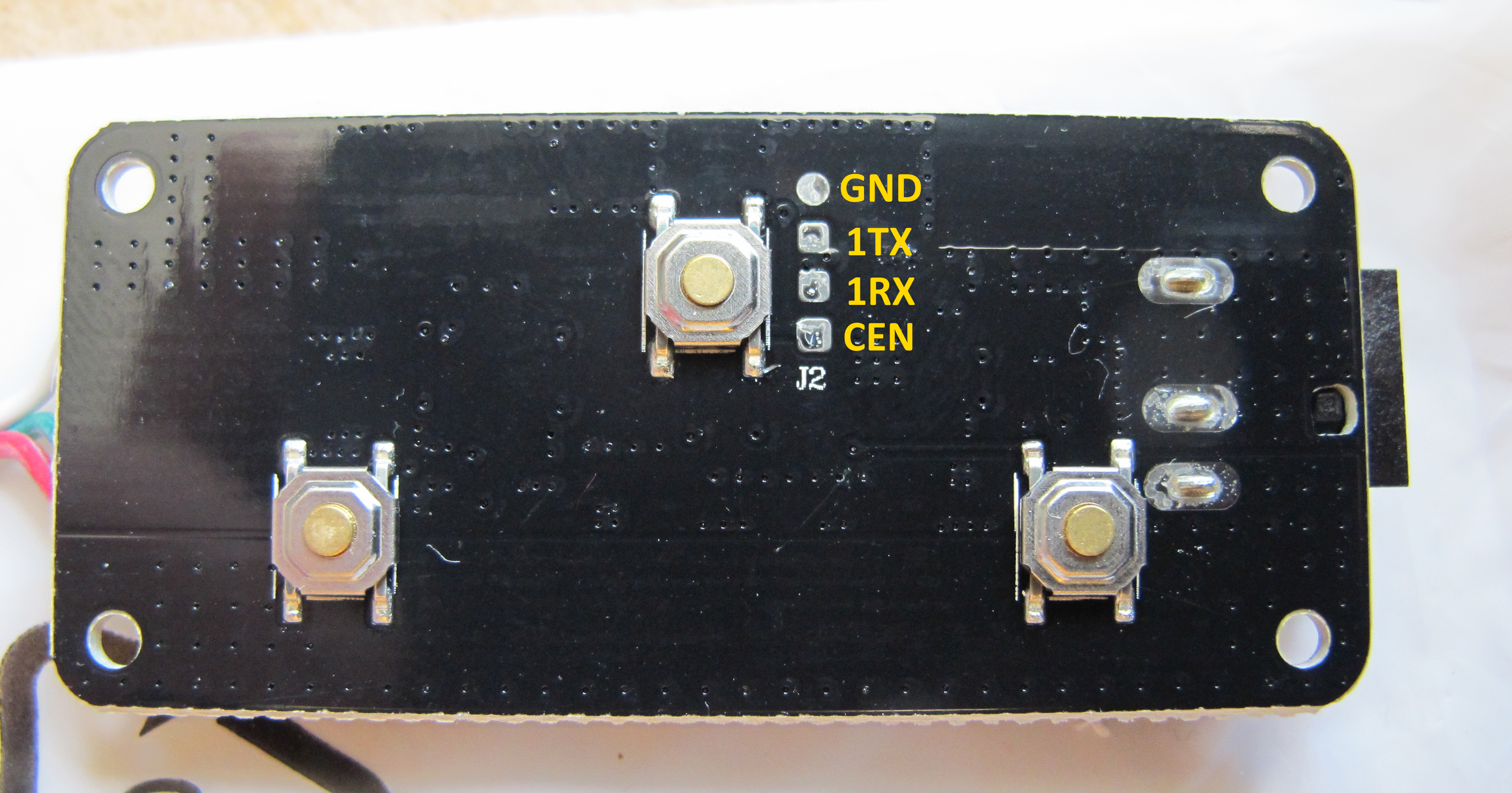

    Circuit board panel with three buttons and labels: GND, 1TX, 1RX, and CEN.
    log out and flash download was both on 1RX/1TX
    • BKFIL_x1_dump_20240711_154437_0x0_0x200000.bin (2 MB) You must be logged in to download this attachment.

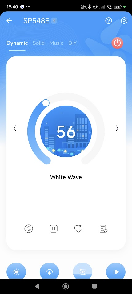

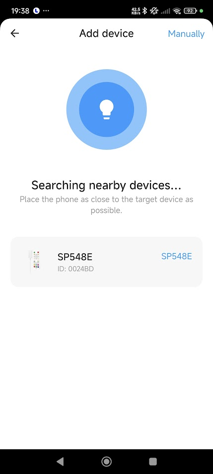

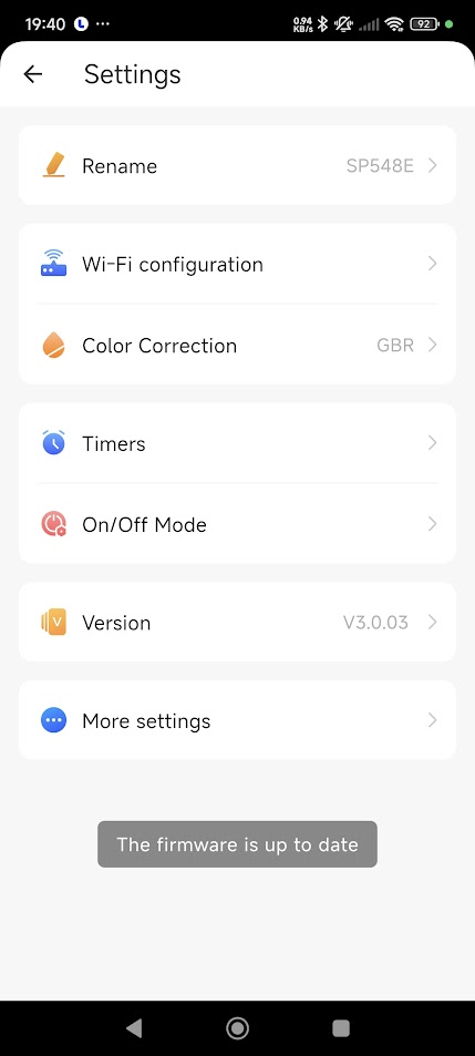

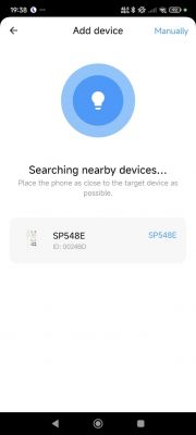

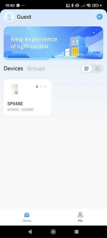

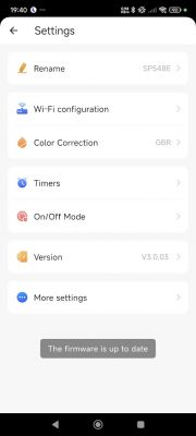

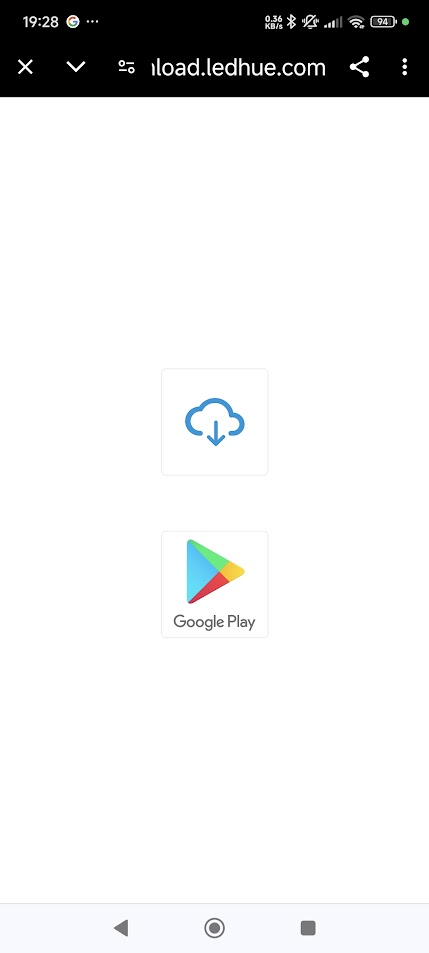

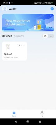

    The QR code in the manual links you to some weird non-store APK download from https://download.ledhue.com/page/scenex/
    www.ledhue.com just redirects to https://github.com/Spled/spled.github.io
    The app is called BanlanX and is also available in the Play Store https://play.google.com/store/apps/details?id=com.spled.scenex&hl=en_GB
    App screen displaying the process of adding a device named SP548E. Mobile app settings screen with options like Wi-Fi, color correction, and more. BanlanX app screen with main view showing available SP548E device. App interface for controlling SP548E device with options for dynamic, solid, music, and DIY modes. Smartphone screen with two app download icons.
    Added after 43 [minutes]:
    OTA is 0x132000 and if you flash OBK rbl:
    doesn't boot of course

    Nice finding, have you tried to check "Skip key check" in Advanced so this operation can continue:
    WARNING! Non-standard encryption key!
    Please report to forum https://www.elektroda.com/rtvforum/forum51.html
    Or just try using BK7231M mode
    There was no result to save.
    I'm sure I covered all the bases by trying all options but will do it again

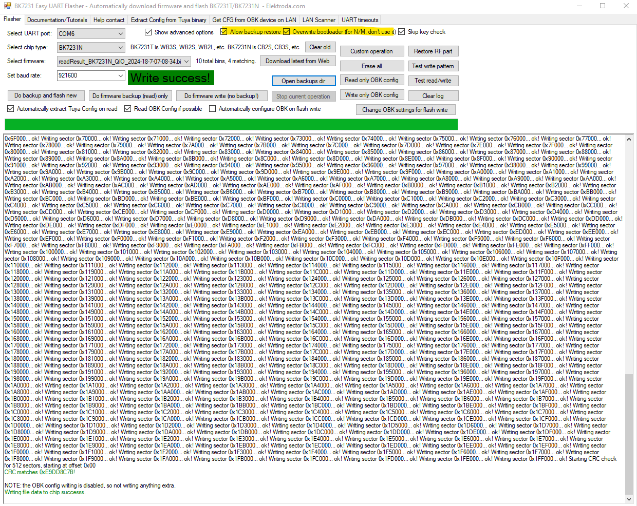

  • Easy Flasher restores erased BK7238 flash backups
    #6 21158802
    Posts: 5221
    Help: 449
    Rate: 918

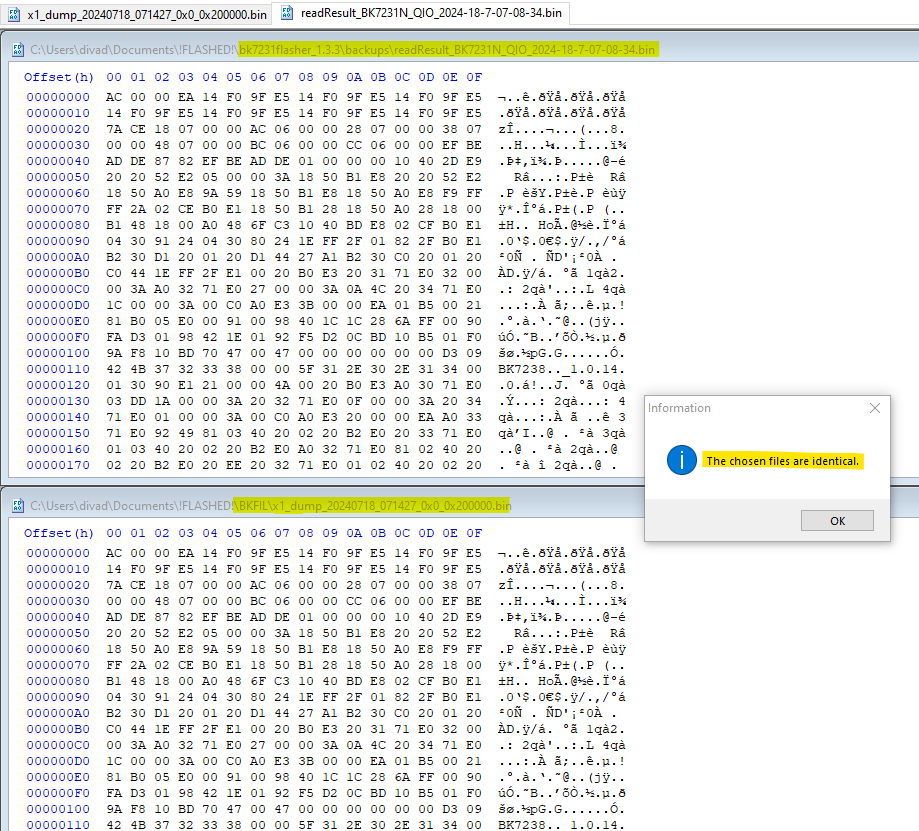

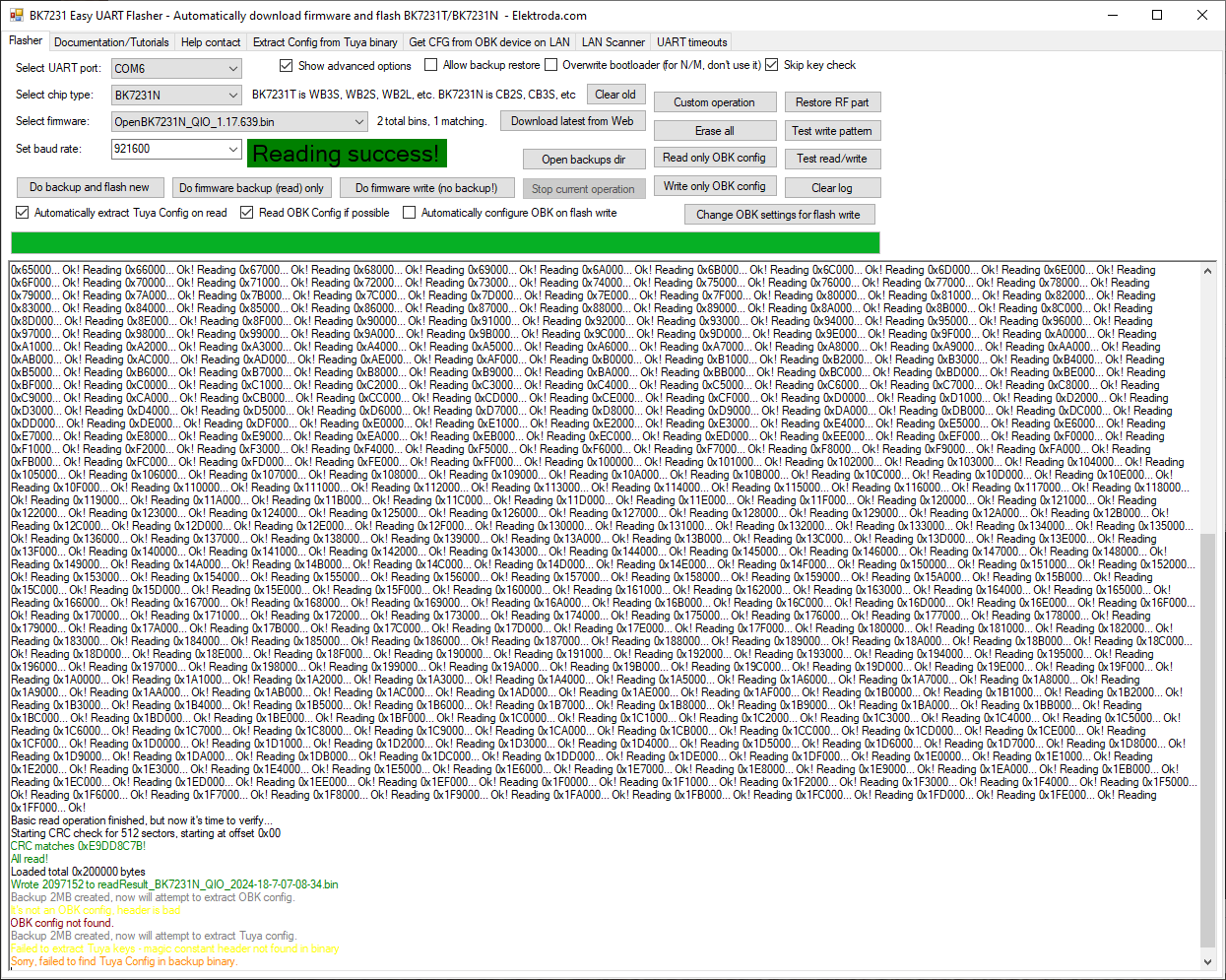

    argh. clouded by the excitement I guess. yes, it dumps with skip key check in N and M mode. that's embarrassing. I know the skip check is there
    Screenshot of BK7231 Easy UART Flasher program with a green success reading message.
    Comparison of two binary files in a hex editor with a message indicating the files are identical.
    Added after 56 [minutes]:

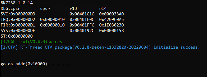

    and from a totally erased flash, not even bootloader, you can restore backup using Easy Flasher too
    Screenshot of Easy UART Flasher program with a successfully completed writing process.
    boots again
    Console screen showing logs related to the BK7238 processor.
    so I guess you could say EF supports BK7238. Maybe just needs a new select chip type menu option so saved backups have the right filename? any other tests I should perform?

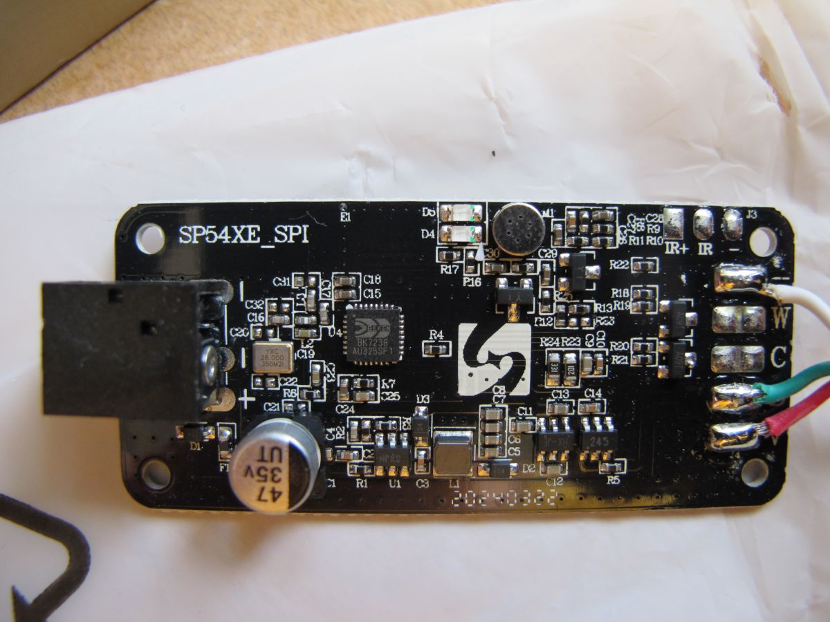

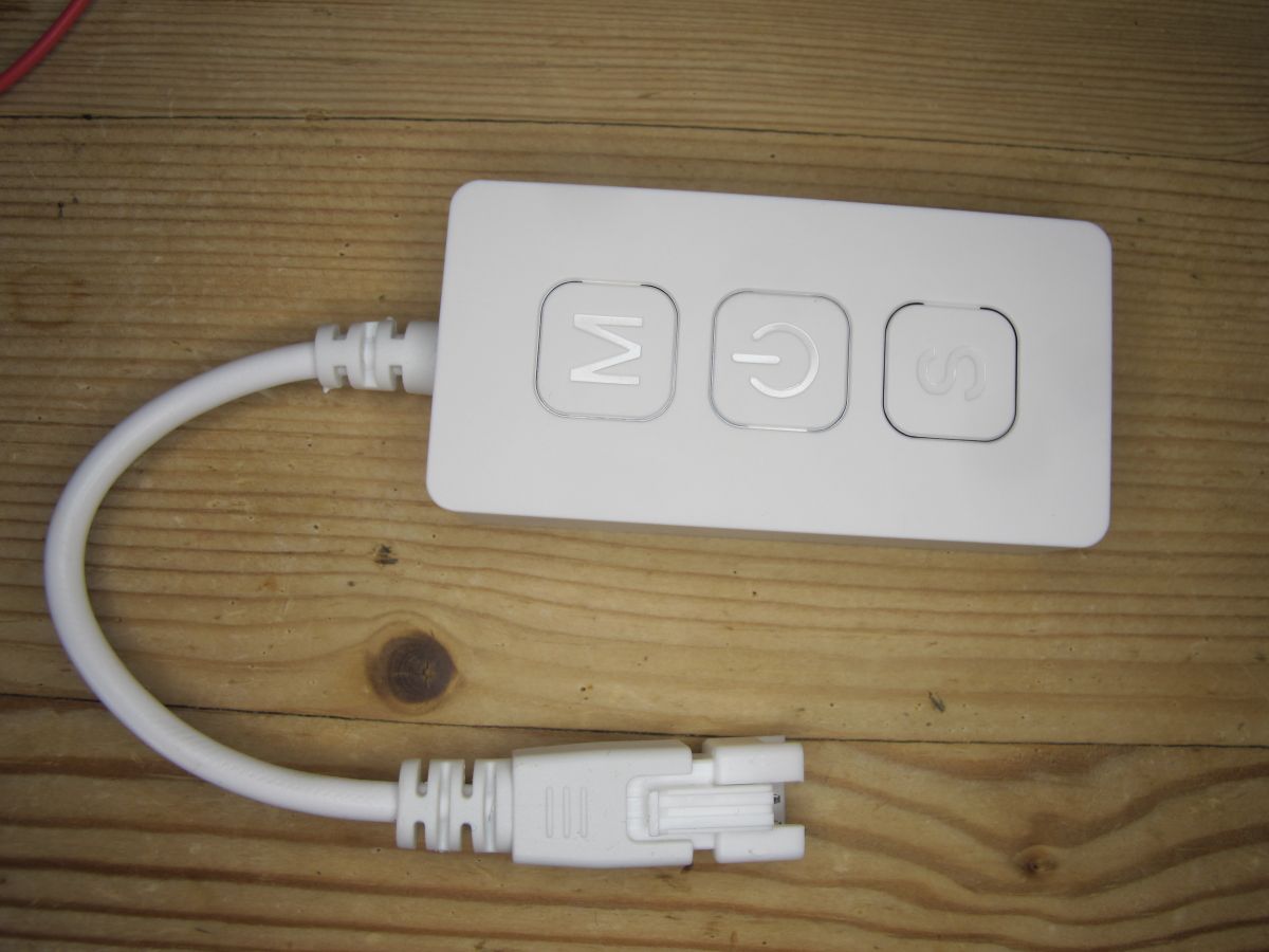

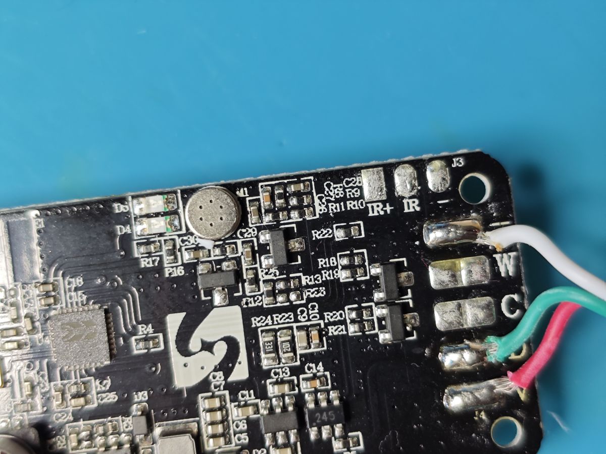

    Giving this another look now that BK7238 and SPI is supported.
    SP548E SPI RGB LED controller with label and cable connector White LED controller with three buttons labeled M, power, and S
    P28 S button
    P22 M button
    P21 Power button
    P0 PCB blue led (D5)
    P1 PCB green led (D4)
    P16 MOSI/SPI
    P9 IR pad (no IR on my device) is connected. 100ohm resistor in path (R22).
    Close-up of a PCB with IR+, IR-, W, C labels and several resistors, capacitors, and LEDs.
    Didn't have to overwrite bootloader on this device for OTA to work as original is already set for 0x132000
    is my autoexec.bat. WS2811 strip behaves a little odd - speed and colour doesn't match how it behaves on BK7231N/CBU. No switching of RGB/BRG etc corrects it. Pure green/red/blue are not correct prime colours. Power on/off is either ineffective or pauses colours instead of turning off.
    WS2812B behaves as expected.
