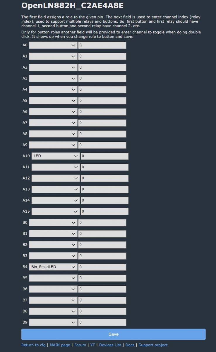

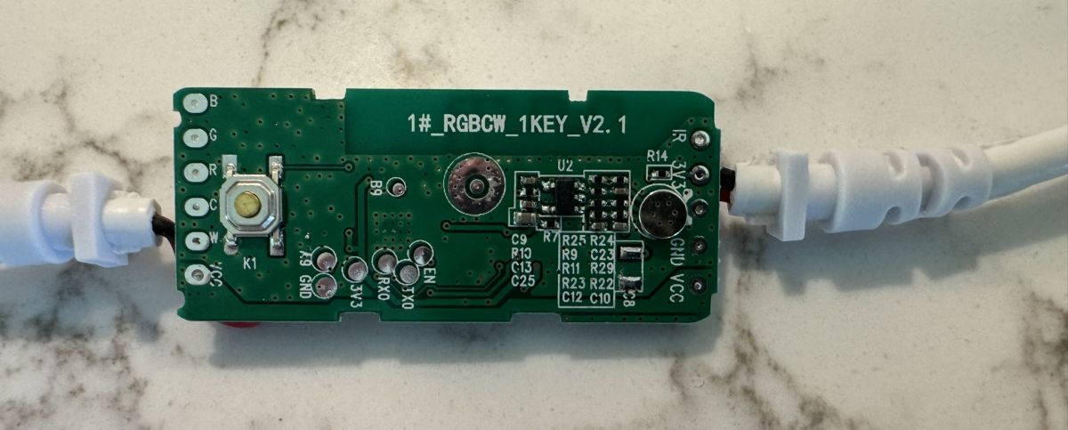

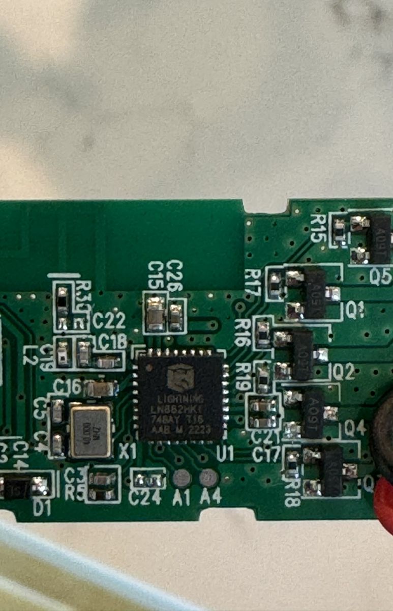

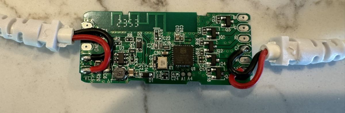

    I successfully flashed OpenBeken to a LN882HKI device in the pictures. The device is a led panel for indoor plants: https://www.mother.life/BE/shop/linear
    Close-up of a circuit board showing the LN882HKI chip and electronic components. Printed circuit board with connected cables, viewed from above. Image of a circuit board labeled 1#_RGBCW_1KEY_V2.1, connected with cables, placed on a white marble surface.
    I can control on/off with LED or relay on A10 but it will not work with PWM. The local button works properly on B4 as seen in the config:
    Screenshot of the OpenLN882HKI device configuration with pin settings.
    I cannot get the device to dim, however, which I'm guessing stems from PWM not working. Anyone have any ideas? I can provide more info from the Web App if needed.

    From a brief glance, it seems that PWM is not yet implemented on LN882HKI:
    https://github.com/openshwprojects/OpenBK7231T_App/blob/main/src/hal/ln882h/hal_pins_ln882h.c
    Code: C / C++
    We need to check their SDK and add missing PWM calls. Would you like to help?

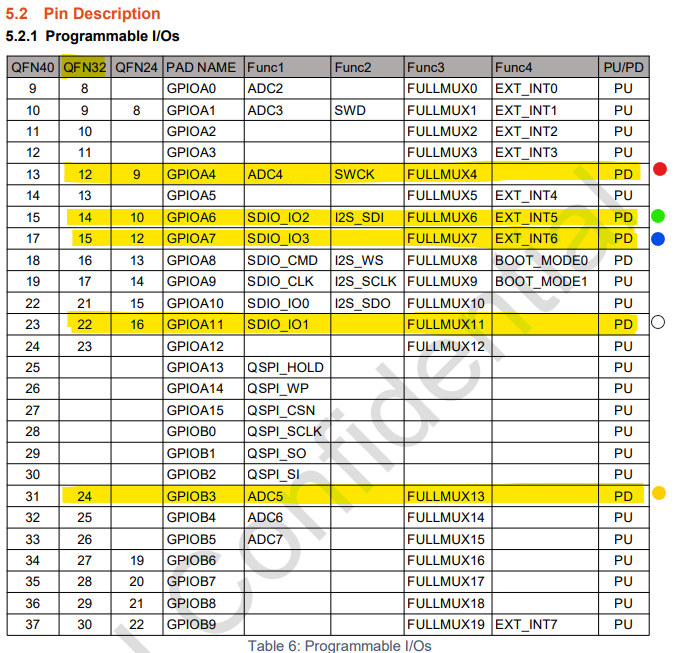

    Well, here is a full PWM sample:
    Code: C / C++
    We just need to find which port/pin combination is using which PWM channel. Maybe in some datasheet?
  • #11 21181676
    Posts: 5236
    Help: 450
    Rate: 920

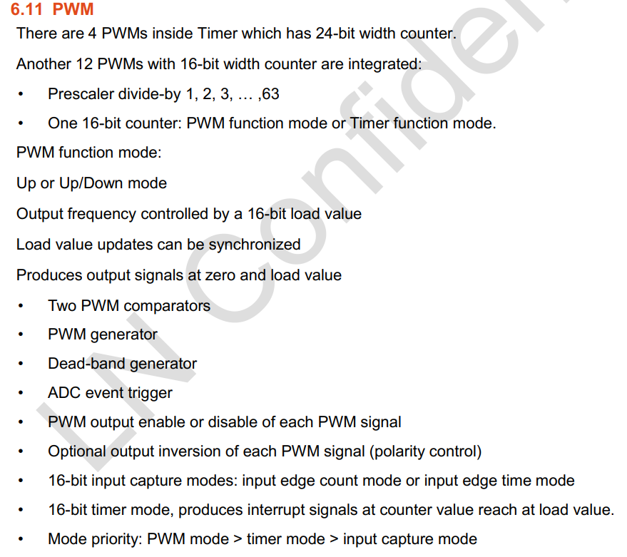

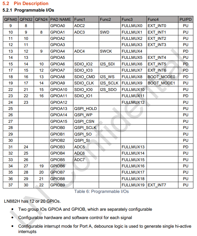

    all of the FULLMUX pins?

    >>21181676 does this datasheet help us with understanding which pins are used together for PWM?
    I don't really know how to read this sheet and what to take from it...
  • LN882HKI QFN32 fullmux GPIO pin map
    #13 21190197
    Posts: 5236
    Help: 450
    Rate: 920
    all I can add really is that our LN882HKI chips are QFN32 packages so the GPIOs that are FULLMUX, which I think includes PWM support, are
    GPIOA0: Pin 8
    GPIOA1: Pin 9
    GPIOA2: Pin 10
    GPIOA3: Pin 11
    GPIOA4: Pin 12
    GPIOA5: Pin 13
    GPIOA6: Pin 14
    GPIOA7: Pin 15
    GPIOA8: Pin 16
    GPIOA9: Pin 17
    GPIOA10: Pin 21
    GPIOA11: Pin 22
    GPIOA12: Pin 23
    GPIOB3: Pin 24
    GPIOB4: Pin 25
    GPIOB5: Pin 26
    GPIOB6: Pin 27
    GPIOB7: Pin 28
    GPIOB8: Pin 29
    GPIOB9: Pin 30

  • Question about identifying PWM dimming pins
    #16 21199706
    parlaystaller_0d
    Posts: 9
    >>21195618 thanks for providing an example.
    I guess the next info I need is, how to find and configure PWM pins.
    How do I know which of them is/are responsible for dimming the light?
    Next, did I understand correctly, that I have to configure a PWM pin that controls channel 4?
    When you look at the PCB, there are wires to C and V.
    The current configuration has a pin configured as LED controlling channel 0.
    And a button_SmartLED controlling channel 0.

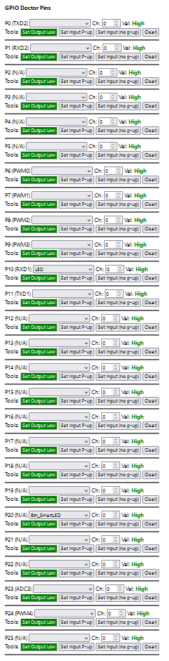

    Screenshot of the GPIO Doctor Pins interface with a list of pins and their configuration.
  • #17 21199714
    insmod
    Posts: 1432
    Help: 168
    Rate: 455
    >>21199706 If you are able to turn on/off light with LED on P10 pin, then just change LED to PWM. While your board has full rgbcw pins, only c is wired, so channels don't matter.

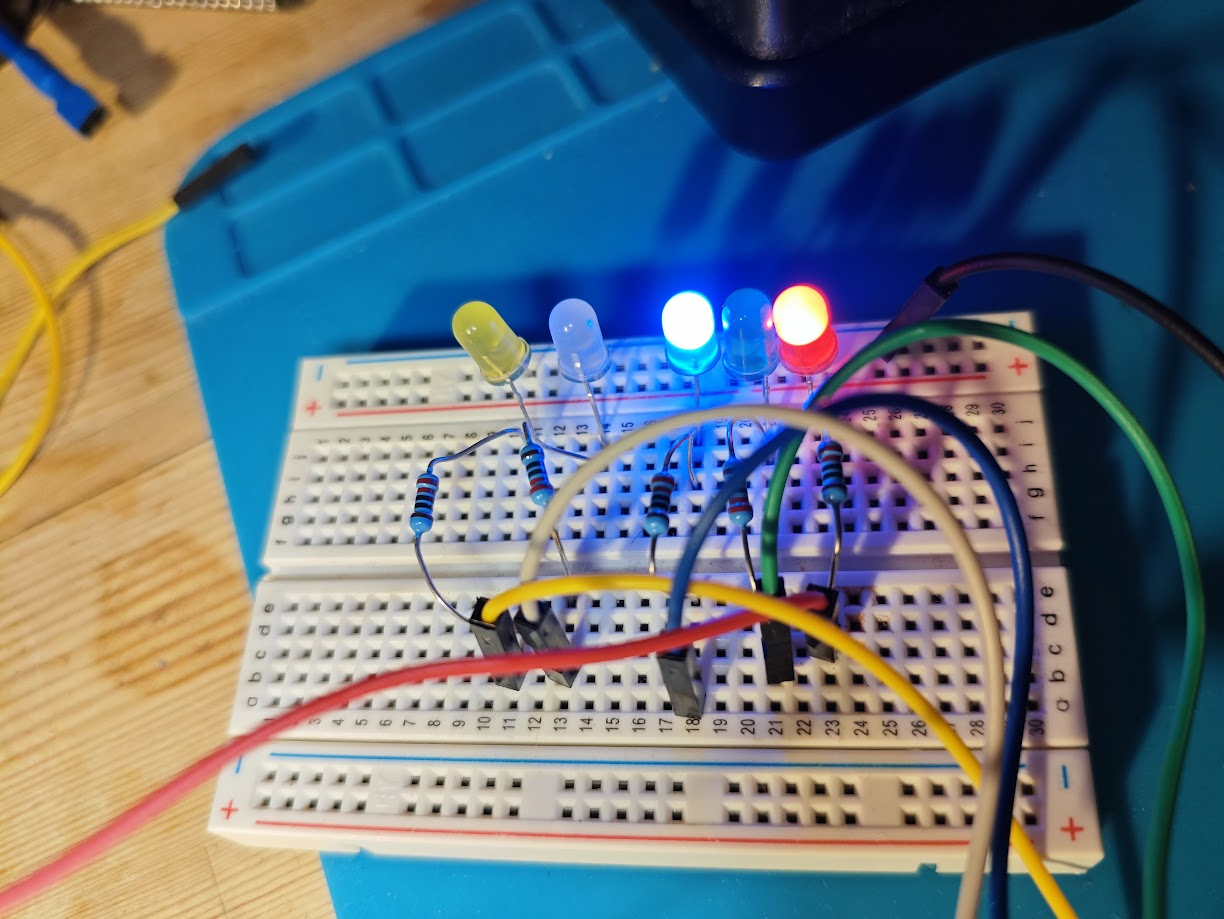

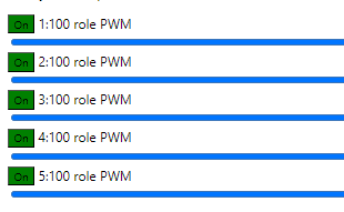

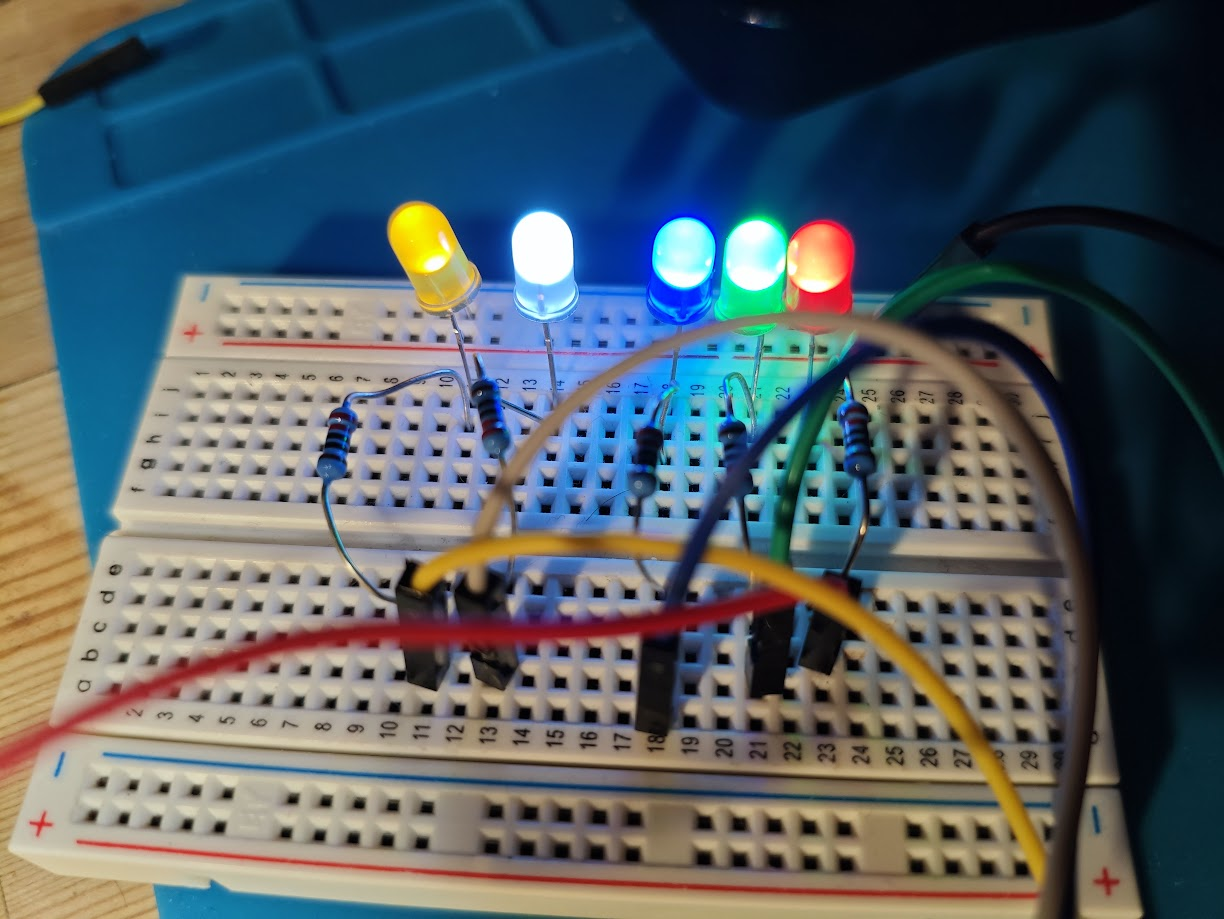

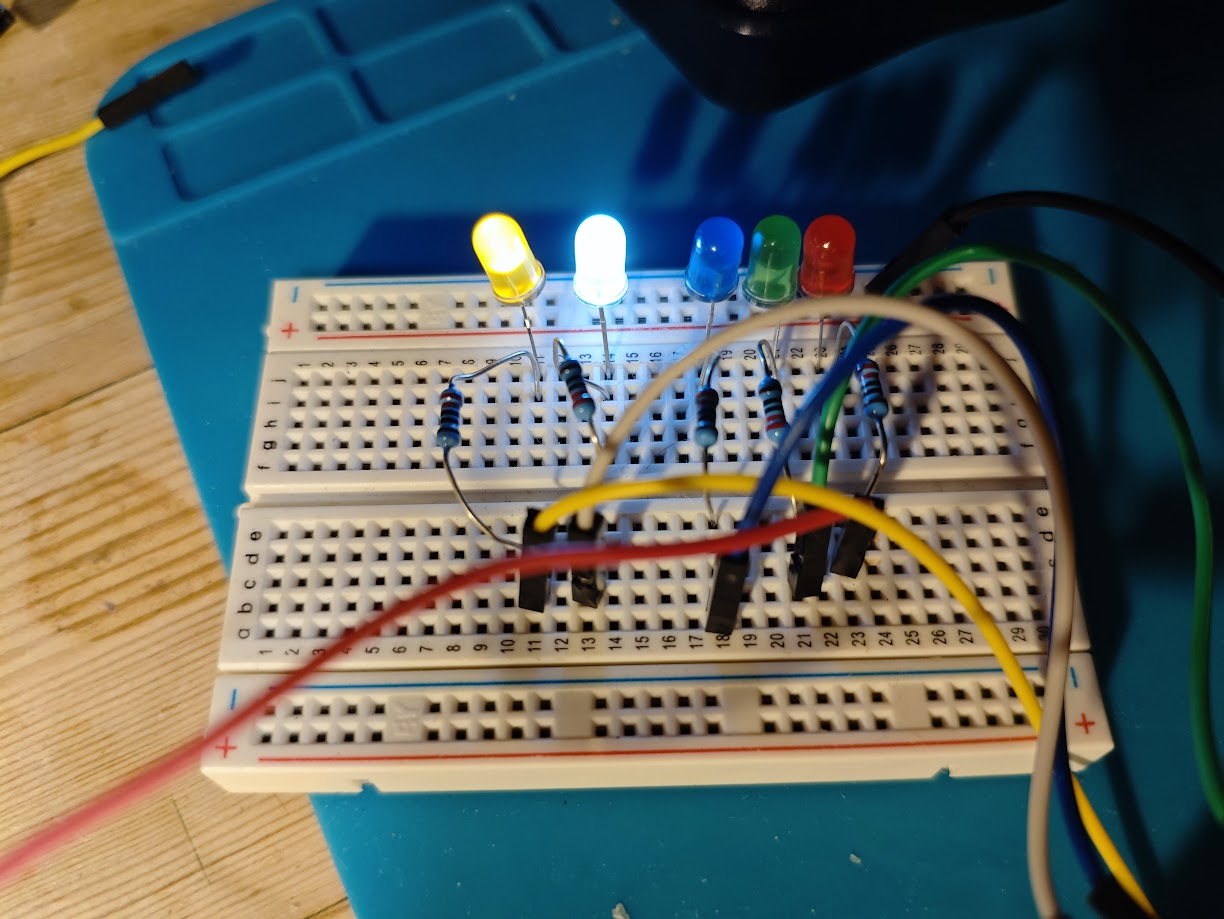

  • OpenBeken PWM pin assignments for five LEDs
    #30 21224383
    Posts: 5236
    Help: 450
    Rate: 920

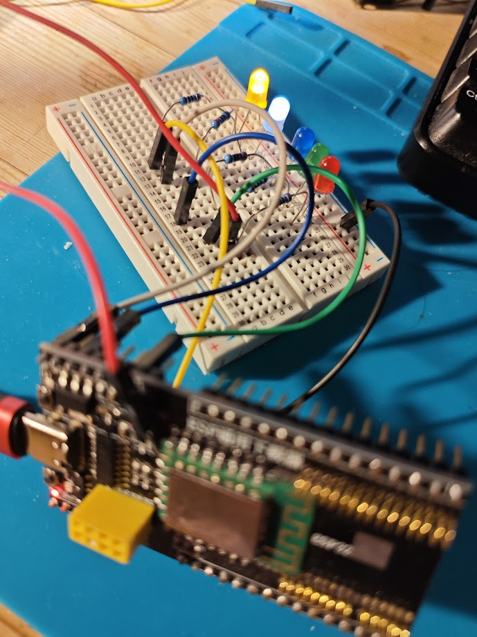

    on 1331_merge_fe57bd70ce5e with these assignments
    which translates to:
    Table of programmable I/O ports description for a microcontroller.

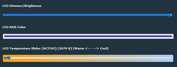

    I have 5 working LEDs, controllable as one would expect. Dimmable, colour picker, warm/cold
    LED control interface with sliders for adjusting brightness, color, and temperature. Close-up of a breadboard prototype with five functioning LEDs in different colors connected to a microcontroller.
    Screenshot showing device status with five PWM channels. Channels 1 and 3 are on, and channels 2, 4, and 5 are off. Circuit on a breadboard with five lit LEDs.
    Five rows showing the operation of LEDs controlled by PWM. Five lit LEDs on a breadboard, displaying different colors.
    LED control list with PWM labels, showing On/Off status for each. Five LEDs on a breadboard with multicolored lighting
    so all looks good.
