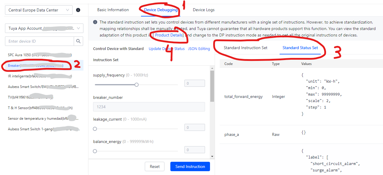

    Tuya IoT platform interface screen with device information.
    After selecting the device, you can copy the information under "Standard Instruction Set" and "Standard Status Set" to your favorite JSON editor (I use Notepad++), or hit "Product details" (number 4 above) to get a listing of the DpIDs that you can relate with the numbers you got before, as I did here and in the following posts. The following code shows the "Standard Status Set" for our example:
    As you can see, there we have more detailed information about the contents of the different DpIDs, and how to interpret them. If you have the patience to follow the device's thread from the point I linked before, you can see how I tried to correlate the information and summarize it in tables, but that's not really necessary as, as I also explain there, there's another place in Tuya developer's website where you can find most of the info in just one step.

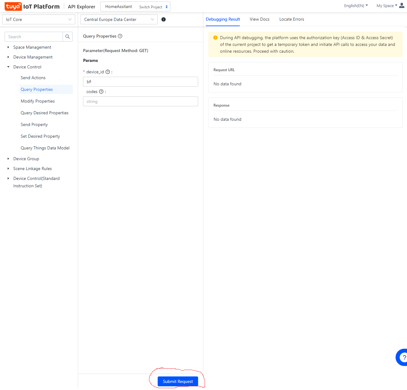

    Normally I get my DPIDs by going to (Tuya IoT):
    Cloud >> API Explorer >> Device Control >> Query Properties
    In there enter the device_id of the the device you want to see the dp_ids for and press submit request:
    Tuya IoT platform interface with Submit Request button highlighted.
    These are the device_ids I get for this particular device:

    It's another possibility; I see that in that report, you can also see DpIDs labels together with their number and it's more compact, but to me the advantage of Cloud >> API Explorer >> Device Control >> Query Properties is that, apart from labels related to numbers, you get the type (raw, boolean, value...) and a detailed description of the contents. The disadvantage is that you have to work more to elaborate on the information and put it in a legible format

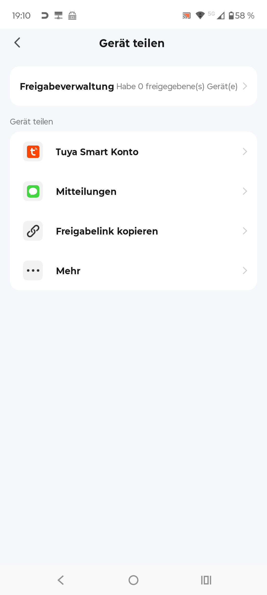

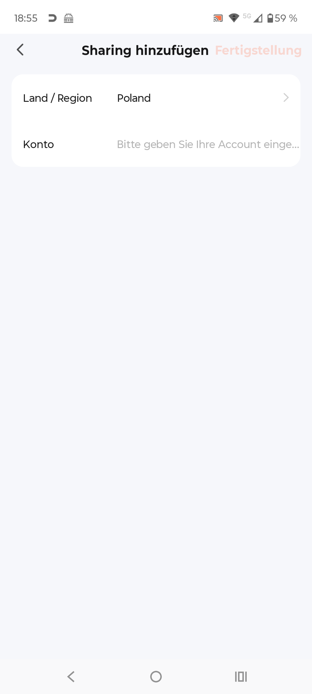

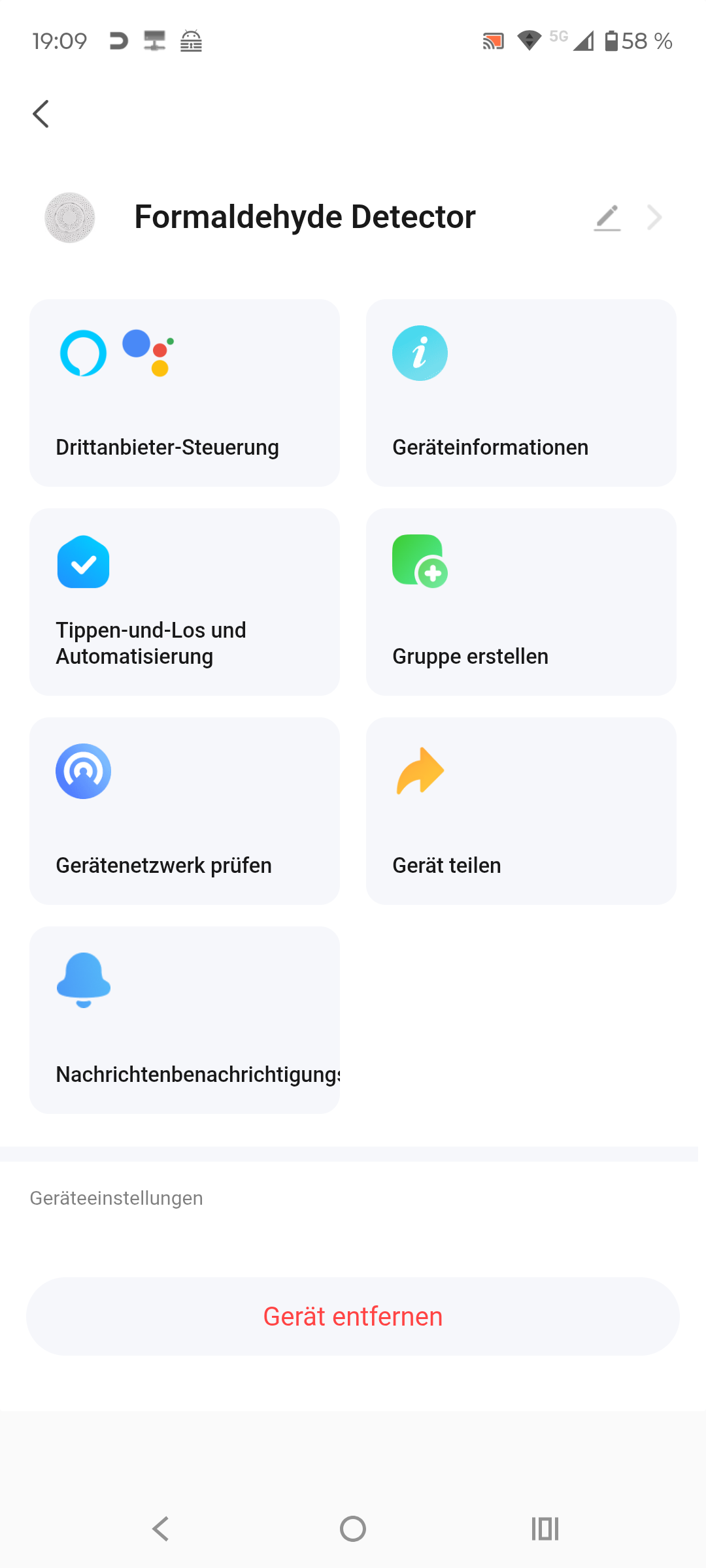

  • Tuya app device sharing via country and username
    #10 21604881
    blacksun2
    Posts: 59
    How does one "add device"? Do I have to physically own the device to be able to access the API? Do I need Tuya keys?
    You can share a device in the Tuya app under the properties of the respective device.
    You just need to enter the country and the username (I think the email address).
    Extracting DpIDs for TUYA MCU devicesExtracting DpIDs for TUYA MCU devicesExtracting DpIDs for TUYA MCU devices

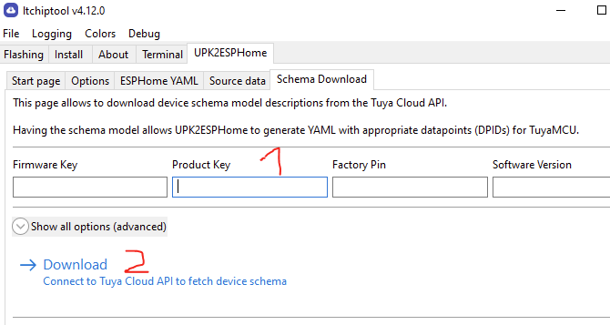

    Tinytuya wizard and ltchiptool for DPID extraction
    #11 21605092
    piotrszulc1
    Posts: 37
    Rate: 8
    There are much easier ways of obtaining dpids from tuya.dev side.
    1) Tinytuya (https://github.com/jasonacox/tinytuya) can do it automatically for all your devices. Use the "wizard" option. This requires to have an active tuya.dev account and link it with your tuya app (see the detailed description in Readme)
    2) if you know the product id you can use ltchiptool (https://github.com/libretiny-eu/ltchiptool/releases) to download schema (see the picture below). It is in a form of json with detailed description (usually in chinese) of each dpid. It often even describes the format of "raw" dpids. It does not require to have a tuya.dev account.

  • Tinytuya wizard can auto-extract DpIDs
    #14 21605816
    Posts: 5232
    Help: 449
    Rate: 918

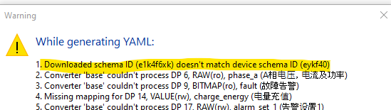

    it should be noted though that ltchiptool will try to match with its cached store of ~700 schemas and only reach out to its Tuya dev account if there are no matches. This does mean that sometimes it can return the wrong match for eg if your firmware uses the same fw key as another product but has different product key/factory pin.
    Look out for this

Why does the JSON returned by Tuya Cloud Explorer look unreadable on one line, and what tools can format it properly?
It looks unreadable because the model payload is returned as escaped JSON inside one quoted string. The thread shows that pasting it directly leaves it on one long line with embedded escapes and \n markers. Two formatting fixes were tested: Notepad++ and jsoneditoronline, where Auto repair and then format produced a readable structure. Chat tools partly helped too, but they sometimes stopped mid-output or mishandled line breaks in long descriptions. [#20859564]
Which method is better for extracting Tuya dpIDs: TuyaMCUAnalyzer, TinyTuya wizard, ltchiptool schema download, or the Tuya IoT web portal?
The best method depends on what you already have. The thread positions the Tuya IoT web portal as the richest manual method, because it shows dpID numbers, labels, types, ranges, and descriptions in one workflow. TinyTuya’s wizard can fetch data automatically for linked devices, and ltchiptool can download a schema by product ID without a tuya.dev account. TuyaMCUAnalyzer still works, but one expert explicitly called it the "longer and harder method" compared with newer options. [#20859983]

What should I check when ltchiptool returns the wrong Tuya schema because of a cached match or shared firmware key?
Check whether ltchiptool matched a cached schema instead of the exact product. The thread warns that its cache holds roughly 700 schemas, and a shared firmware key can cause a false match when the real product key or factory pin differs. In that failure case, compare the returned schema against the device’s actual functions and look for a warning indicator in the tool. If the dpIDs or features do not line up, treat that schema as suspect. [#21605816]

How can someone share access to a Tuya device in the app so another person can inspect its dpIDs without physically owning it?
Share the device from the Tuya app to another account. The thread states you can open the device properties, choose sharing, and enter the recipient’s country plus username or email address. Once shared, that second person can access the device through their own Tuya account and inspect its dpIDs through the developer workflow. That is the cleanest workaround when the other person does not physically own the hardware. [#21604881]
Why do some Tuya devices show app pages for features they don't actually support, and how does that affect dpID discovery?
Some Tuya apps reuse a generic panel, so the UI can show controls that the hardware does not implement. In the breaker example, the app displayed a temperature page, but the author states the device clearly did not support temperature and the manufacturer was "recycling" the interface. That can mislead dpID discovery, because a visible screen does not guarantee a real dpID exists behind it. Use the app only to estimate possible functions, then verify them in the schema or properties. [#20859564]
For ltchiptool, is the "product id" the same thing as the "Product" field shown on the Tuya Dev Page, such as "001TH0202_CB3S" for the TH03 Pro?
The thread does not confirm that they are identical. One user asked whether ltchiptool’s product ID matches the Tuya Dev Page Product field, giving 001TH0202_CB3S as an example, but no direct answer followed in the quoted discussion. What the thread does confirm is that ltchiptool needs a product ID, and that Tuya Cloud device details can expose one, while custom firmware may read it from the MCU. Treat the two labels as unverified equivalents until you cross-check the returned schema. [#21832787]
