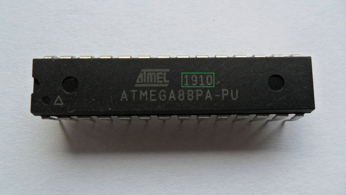

  • Counterfeit ATmega88PA-PU microcontrollers in DIP28 housings from AliExpress were examined after delivery, with one chip damaged and the other showing suspicious markings.
  • The fake parts had sanded tops and reapplied lettering; acetone removed the top print, while the original laser-engraved markings on genuine parts would not dissolve.
  • One working chip returned signature 0x1E930A, and both samples carried the same top date code “1910,” suggesting a single production batch.
  • Testing pointed to an ATmega88A-D variant: it flashed an LED at 4 MHz/1.8V, and a refund dispute succeeded without returning the chips.

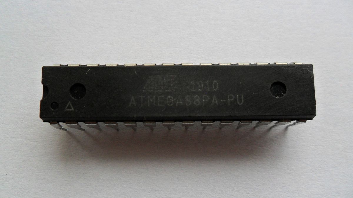

  • Counterfeit ATmega88PA-PU microcontroller with sanded and reapplied labels.
    While shopping on AliExpress, I noticed that a certain shop also has ATmega88PA-PU microcontrollers in DIP28 cases, so I ordered 2 pieces (price under 6 zł. per piece). After 8 days of dispatch, the package arrived. The writing on the microcontrollers looked quite good, but the signature read in the programmer no longer. One piece had two pins internally damaged and the signature could not be read at all - to be thrown away. The other one was used - it had the signature 0x1E930A correct for ATmega88(A/V), some program was uploaded and the fuse bits changed. Evidently a fake with the top of the case sanded down and new lettering applied, which had worn off when exposed to acetone. The original lettering is laser-engraved, so it is impossible to remove with acetone or any other solvent. Both pieces had identical dates ("1910" = week 10 of 2019) suggesting they came from a single production batch. .
    ATmega88PA-PU microcontroller with visible markings on the casing.
    Counterfeit top lettering with false
    model and date of manufacture of the system.

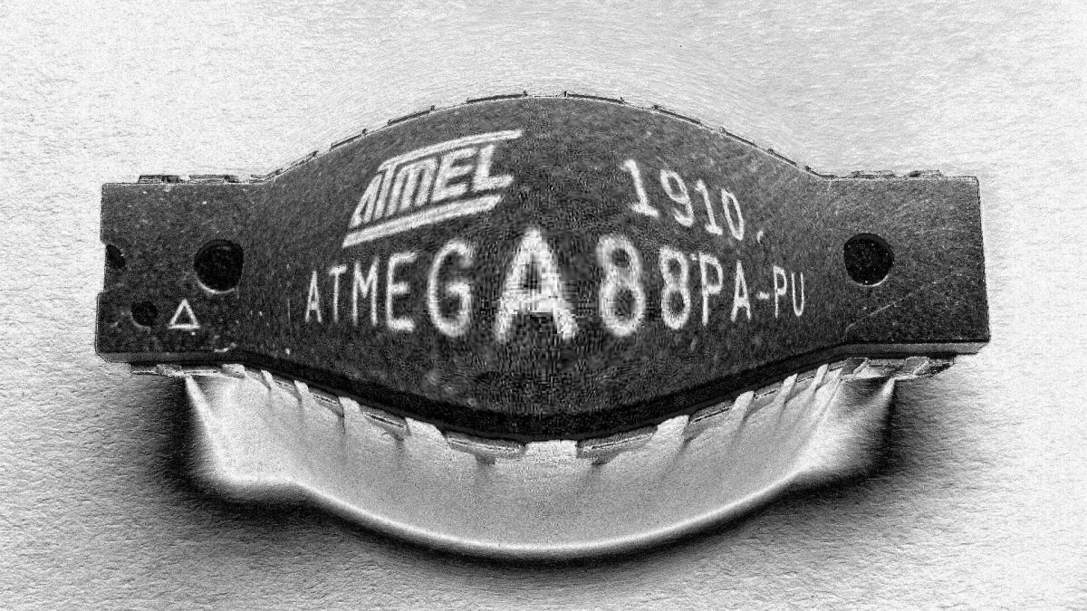

    Photo of ATmega88PA-PU microcontroller in DIP28 package with fake markings.
    Upper inscriptions rubbed off under the influence of
    acetone (grinding marks visible).
    ATmega microcontroller with visible markings.

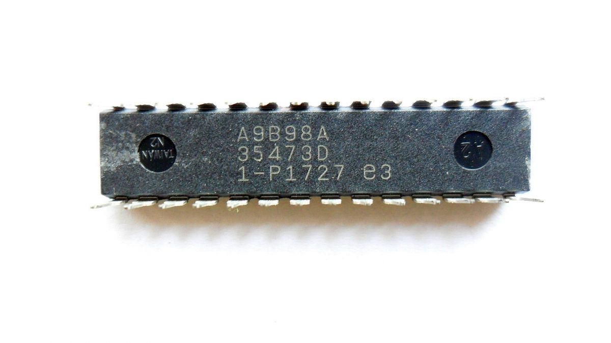

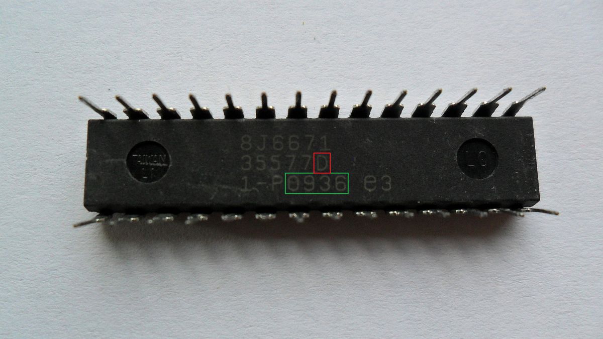

    Non-counterfeit lower-case lettering with a true-
    version/revision lettering and date of manufacture of the
    layout.
    This also turned out to be a hoax after looking at the lettering on the bottom of the case, which was not forged (perhaps it needs too much work). The ATtiny/ATmega microcontrollers in the DIP cases, have a second production date (green box) and a letter on there to indicate the version/revision of the chip (red box). In the pieces ordered, these dates were different: "0936" (36th week of 2009) and "0808" (8th week of 2008).
    At this point I knew that I had 1 working piece of the ATmega88/88A/88V. Now I wanted to find out which specific model I had. The ATmega88V model can be identified by the fact that it should not operate at clock frequencies above 10 MHz (e.g. with a 20 MHz quartz at supply voltage Vcc = 4.5-5.5V). If the microcontroller is operating at this frequency, two possibilities remain: ATmega88 or ATmega88A. The ATmega88A model can be recognised by the fact that it should operate at a clock frequency of 4 MHz and a supply voltage of Vcc = 1.8V (a normal ATmega88 should only operate from 2.7V). The second feature of the ATmega88A model is its lower current consumption, which, at 8 MHz and Vcc = 5.0V, is: about 5mA for the ATmega88 and about 4mA for the ATmega88A (the measurement conditions are described in the datasheet note, but in practice they are difficult to obtain and measure the current with such accuracy).
    In summary, after testing, all indications are that I have the "D" version of the ATmega88A (it works at 4 MHz/1.8V - it flashes the LED, while, for example, the ATmega48-20PU does not work under such conditions). I have set up a dispute for a refund (I have attached pictures of the microcontroller, screenshots of the programmer and a description of the inconsistencies in the markings), which were received several hours later. I did not have to return the received chips. Despite the scam, I am still ahead by one "paint job", although it is not entirely clear whether it is fully operational.

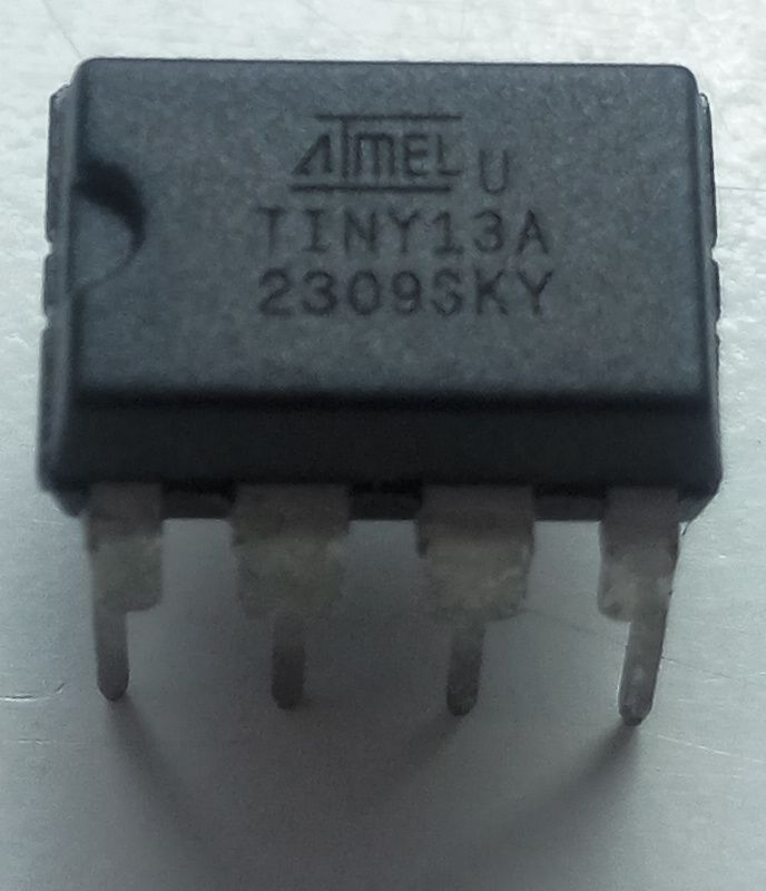

    Well, interesting. And can anything be said about my ATtiny13A for less than a dollar?

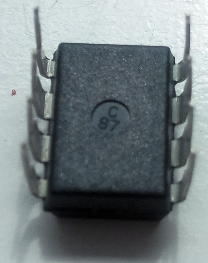

    ATtiny13A microcontroller with marking 2309SKY Image of an ATtiny13A microcontroller with markings on the top surface.
    Inscription from above: ATTINY13A 2309SKY
    Inscription from below: C 87
    The signature agrees with the catalogue note (1E,90,07).
    Another issue:
    2 bits of address are defined for the Read Signature Byte command, and 1 bit of address is defined for the Read Calibration Byte command. However, reading a further area returns some data. They are repeated every 16 bytes. Is it perhaps known what these further bytes mean? What is mapped there?
    Signature: 1E 90 07 FF FF FF FF 55 30 48 30 08 8E 16 1E (from 8-11 in ASCII: "U0H0")
    Calibration: 5E 65 FF FF FF FF FF FF 34 39 2E 30 85 A2 06 15 (from 8-11 in ASCII: "49.0")

    The signature for the ATtiny13/13V/13A microcontrollers is identical, so no specific model can be determined from it. A test with acetone would clarify whether the inscriptions are original, as they look suspicious: production date "2309" = week 9 of 2023 with Atmel's logo when it was acquired by Microchip in 2016 and on such new chips, rather the latter's logo should be placed. You would need to do a performance test at 20 MHz/5V to rule out the ATtiny13V version. Then a performance test at 4 MHz/1.8V to confirm the ATtiny13A version (ATtiny13 only works from 2.7V).
    As for reading data outside the described area, I haven't researched the subject, but there is unlikely to be anything useful there (random bytes).

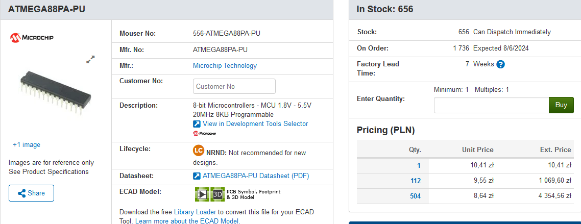

    But here I don't understand the point of this business. We're dealing with an original ATmega, the model seems to match too, just the date repainted.... WTF?
    If they sold for the price they are selling for (half the price from Mouser), with the original markings, adding the annotation "programmed" in the description, customers would probably not be lost.
    It is well known - they will prepare a million watch or RLC component tester kits, and 800,000 will be sold. A heap of components remains, which also need to be liquidated. If they did it honestly, maybe they would have a better turnover than on these scams. Because now they only prey on the thrifty, who would rather buy for 6 PLN from a Chinese than for 12 PLN at Mouser.... And it's a one-off until the guy gets burnt, like Roman. If they approached the matter honestly, various less-affluent hobbyists and small-batch tinkerers might even arrive as regular customers...?

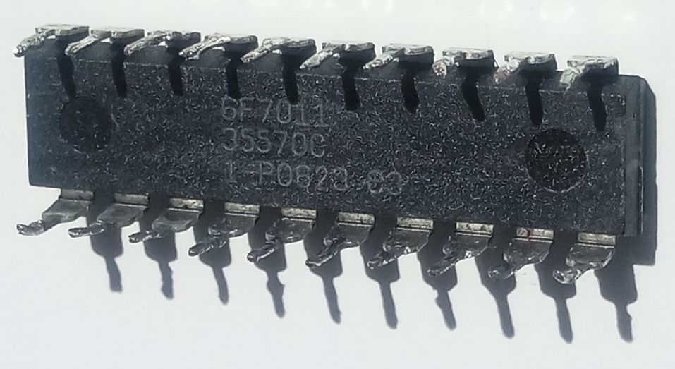

    If I rearrange the bytes read from the ATtiny2313 as signature and calibration (given in the previous post), it comes out
    5B 1E 57 91 FF 0A FF FF ED FF FF FF 36 46 37 30 31 31 02 FF 3D 17 FF 17 FF 12 FF 13 FF FF FF
    The bytes underneath offsets 14-19 give in ASCII the string 6F7011 , which is written on the underside of the microcontroller on the first line:

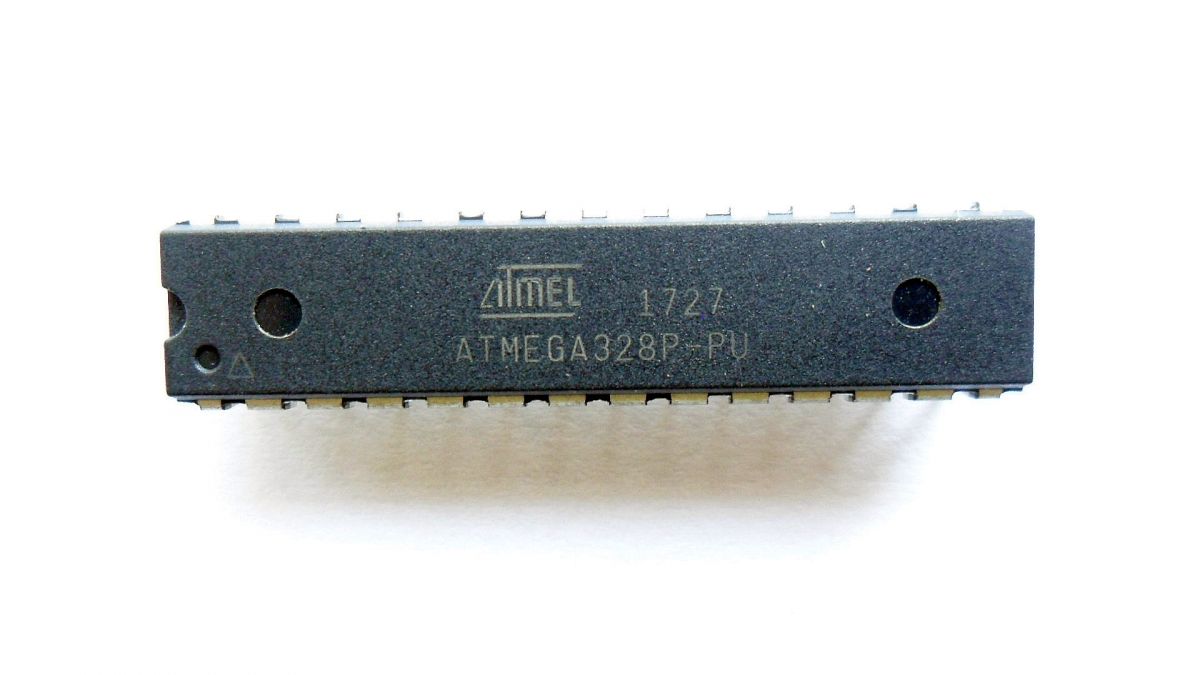

    I have checked new chips bought directly from Microchip and signed Atmel, there is no printing on the bottom on any of the last years I have.

    The information about the additional data in the "hidden" FLASH memory, has been completely concealed by the manufacturer. I suppose that the serial number from the case is also stored in the memory of every newer model (e.g. ATtiny13, ATmega8). This can be checked, but to a rather limited extent (it is hard to get the first copies of a given microcontroller).
    gregor124 wrote:
    I have checked new chips purchased directly from Microchip and signed Atmel, there is no printing on the bottom on any of the last years I own.
    I have one copy from 2020 and it too has no markings on the bottom of the case (it just has a 5-digit number with the version letter at the top). Apparently they have stopped putting these markings on for some year now (maybe due to cost saving).

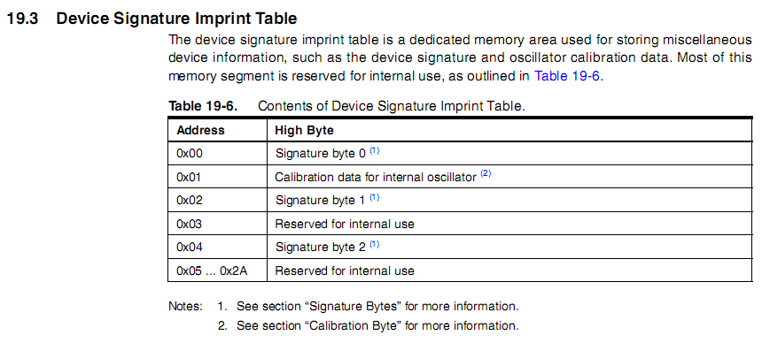

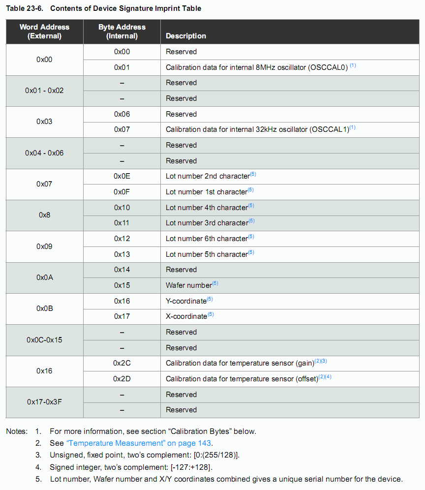

    I have looked through the AVR microcontroller catalogue notes I have and find that the manufacturer has not always completely suppressed information about the 'hidden' side in FLASH memory, which contains, among other things, the signature and calibration bytes. In most notices the only mention of this area of memory is:
    "The three bytes reside in a separate address space." - this refers to the 3 signature bytes residing in a separate address space.
    "This byte resides in the high byte of address 0x000 in the signature address space." or "These bytes resides in the signature row high byte...". - refers to the calibration byte(s), located in the signature address space.
    Much more information can be found in the ATtiny24/44/84, 25/45/85, 441/841, 828, 1634, 2313A/4313 microcontroller notes under "Device Signature Imprint Table". There, a table is shown which contains the addresses and descriptions of the various parts of the "hidden" memory area. Apart from the signature and calibration bytes, the remaining data in this area is described as "Reserved for internal use" - reserved for internal use.
    Table from the ATtiny24/44/84 microcontroller note:
    Device Signature Imprint Table showing addresses and data for microcontroller memory. .
    Only in the ATtiny441/841 microcontroller note, the table contains additional descriptions: The 6-digit production lot number ("Lot number xxx character"), the silicon wafer number ("Wafer number") and the XY-coordinate on the wafer ("X/Y-coordinate") from which the microcontroller core is derived:
    Device Signature Imprint Table showing memory addresses and descriptions for a microcontroller, including calibration data and serial numbers. .
    The 6-digit serial/production lot number, probably found at the same address in all microcontrollers that have it stored in "hidden" memory (e.g. ATtiny85, ATtiny441/841, ATtiny2313, ATmega328).

    RomanWorkshop wrote:
    I read the "hidden" memory of the fake microcontroller from the first post and found that the serial number from the bottom of the case ("8J6671") matches the one stored in its memory
    Could it be, however, that this is no "fake" atmega, but a full-fledged prcesor from which the factory markings have been removed for some reason?
    For example, it was prepared to be sold in some device or kit, and, as you know, manufacturers of such toys like to grind down/flame the names of ICs. But the product didn't sell, and to sell the processors in bulk, you have to print the inscriptions again.
    And I still stand by the opinion from my previous post, that they would win more by writing honestly what and how, but this is just my opinion.
  • Removed markings indicate a relabeled ATmega88A, not a fake
    #21 21171602
    RomanWorkshop
    Posts: 221
    Rate: 423
    zgierzman wrote:
    Is this, however, not a "fake" atmega, but a fully-fledged prcesor from which for some reason the factory markings have been removed?
    Counterfeit due to the fact that the markings on the microcontroller's casing do not match, either with its signature or with the production date on the bottom of the casing (I bought a 2019 ATmega88PA model from appearance, while inside it is probably a 2009 ATmega88A). The reason for removing its markings, on the other hand, is another matter - it was certainly done on purpose.
  • Possible relabeled ATmega88A stock or counterfeit
    #22 21174495
    gregor124
    Posts: 1695
    Help: 101
    Rate: 880
    @RomanWorkshop
    The idea is probably to sell unmarketable chips. Nowadays it would be hard to sell an ATmega88A, so someone e.g. bought a big batch from a distributor for nothing, polished it up and is trying to upsell it. And because it has an 'attractive' price, the dealers got tempted and now there is a lot of it. But it could also be that they have actually counterfeited the ATmega88A and, in addition, not enough that it is counterfeit.
    This one has the TAIWAN stamp and the others?
    Some chips have altered structures and it is possible, for example, to write a procedure to check exactly which version of silicon you are dealing with. But I see that only two versions of the 88A were sold and both with the same errors. Apparently they could not be easily eliminated or were not cost-effective. The situation is different with the 328P, for example.
    Perhaps the bugs were only noticed when the 328P was on the top and corrected in the last version.

    >>21169245 .
    There are even official articles on serial numbers, stored in microcontrollers: Link , Link .
    Question
    What are the MCUs with non-erasable unique ID in AVR 8 bit family?
    Answer
    Most classic AVR mega and Tiny devices do not have unique serial number except ATmega328PB/48PB/88PB/168PB. And all Xmega, megaAVR0 and ATtiny0/1 families have unique serial number which can be used to identify a specific device in the field.
    Question
    How to read serial number in AVR - Mega/Tiny devices and what are the details of the serial number?
    Answer
    For the Mega and Tiny devices that provides Serial number, they have similar signature addresses for Lot Number, Wafer Number and X, Y coordinates. So, the following format may be used to read the Serial number for the Mega and Tiny devices. The details of the serial number are:
    Byte Address --------- Description
    0x0E --------- Lot Number 2nd Char
    0x0F --------- Lot Number 1st Char
    0x10 --------- Lot Number 4th Char
    0x11 --------- Lot Number 3rd Char
    0x12 --------- Lot Number 6th Char
    0x13 --------- Lot Number 5th Char
    0x14 --------- Reserved
    0x15 --------- Wafer Number
    0x16 --------- Y-coordinate
    0x17 --------- X-coordinate
    Counterfeit due to the fact that the markings on the microcontroller case do not match, nor its signature
    Buy from official distributors and they will be good. You'll even know from which roll + all its information (this is by request, as it's more likely to be for production only, and there if any quality standards are applied then you don't often buy cut)
