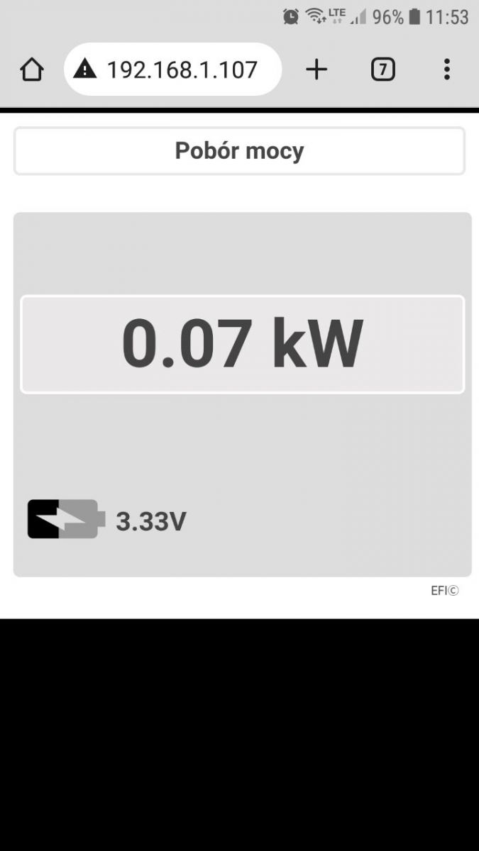

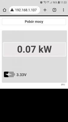

    Discussion by discussion... And with me it now displays:
    Device screen showing power consumption. .
    And let it stay that way :D .
    The consumption of the last hour could still be added to the code.
