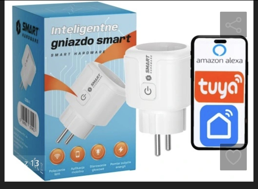

I am looking for a smart socket or strip that cuts off both poles when switched off
DamianM2007 873 6
  • #1 21169917
    DamianM2007
    Posts: 42
    I have this socket https://allegro.pl/oferta/inteligentne-smart-...o-wifi-watomierz-programator-tuya-12619206396
    It works even well, but it has one minus.
    It doesn't cut off the minus when you click OFF.
    It only cuts off the plus.
    Does anyone have a proven smart socket or strip that cuts everything off when you click off?
    I am looking for a smart socket or strip that cuts off both poles when switched offScreenshot...Chrome.jpg (129.11 kB)You must be logged in to download this attachment. .

    Hym, I don't know if you'll find such a small one with a relay that disconnects phase and zero because there's not enough room in these sockets for something like that.

    Elements (switches, connectors) that cut off the power on all poles simultaneously are commonly called mains switches .
    Maybe if you type such a phrase into a search engine you will find what you are interested in.

    In the mains, i.e. also in the sockets, we don't have a "minus" ;-) .

    Hi, I would like to reheat the topic, I am also looking for such a socket or strip. The socket would cut off an emergency UPS with a 100ah battery to simulate a lack of mains power.... I have a similar socket to the one in the first post, but after switching it off, the UPS continues to see some power fluctuation and cannot switch fully to the battery.
