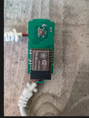

    I've found this site quite useful for putting all reviewer-posted Ali Express product pictures in one easy to browse location: https://alitools.io/en/showcase
    Sometimes rare modules like XR1 and TW-03 can be spotted.
    Photos of buyers of the Tuya LED controller.
    For example, this LED controller looks like it might have (or once came with) a TW-03 module.
    https://alitools.io/en/showcase/tuya-smart-li...-work-with-alexa-echo-google-1005001402683965
    LED controller circuit board with visible Wi-Fi module labeled TW-03.

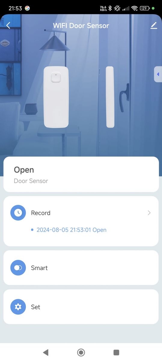

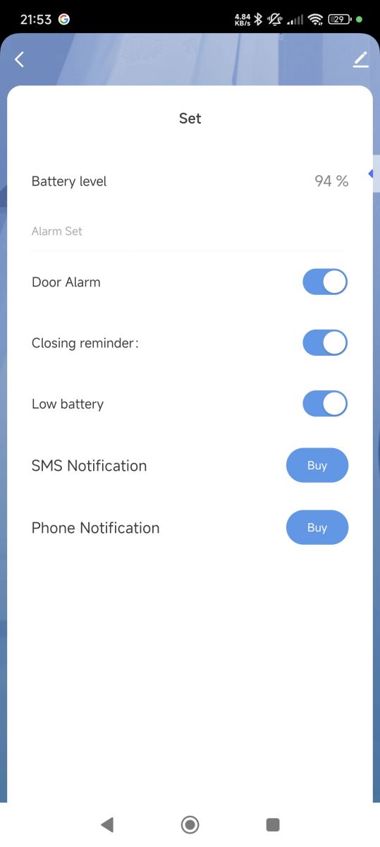

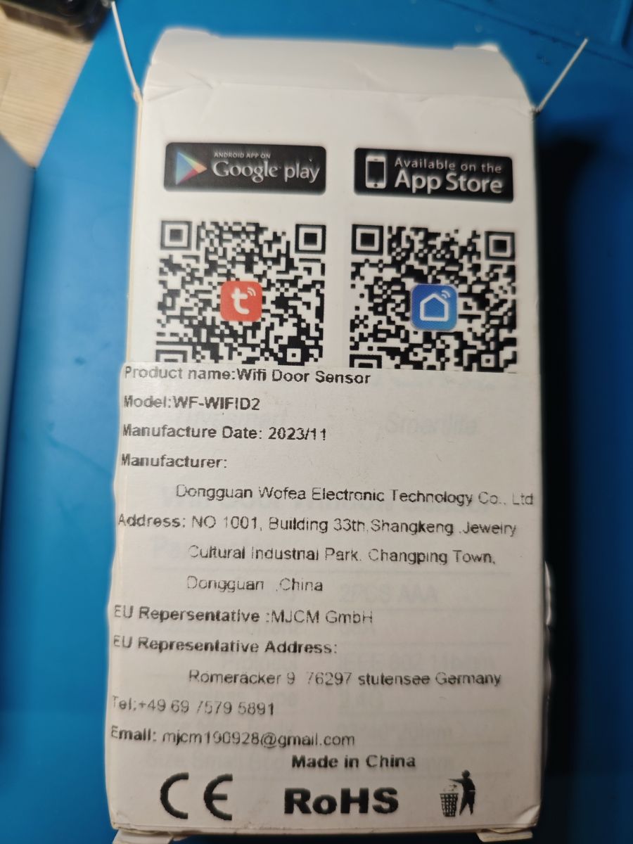

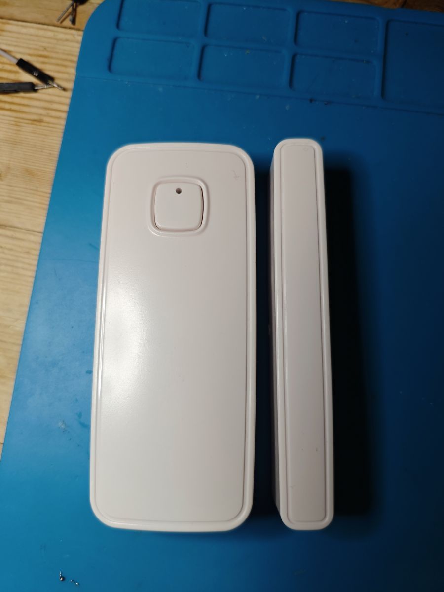

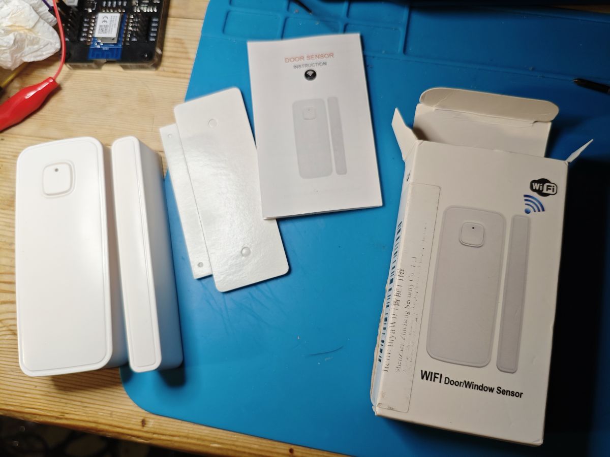

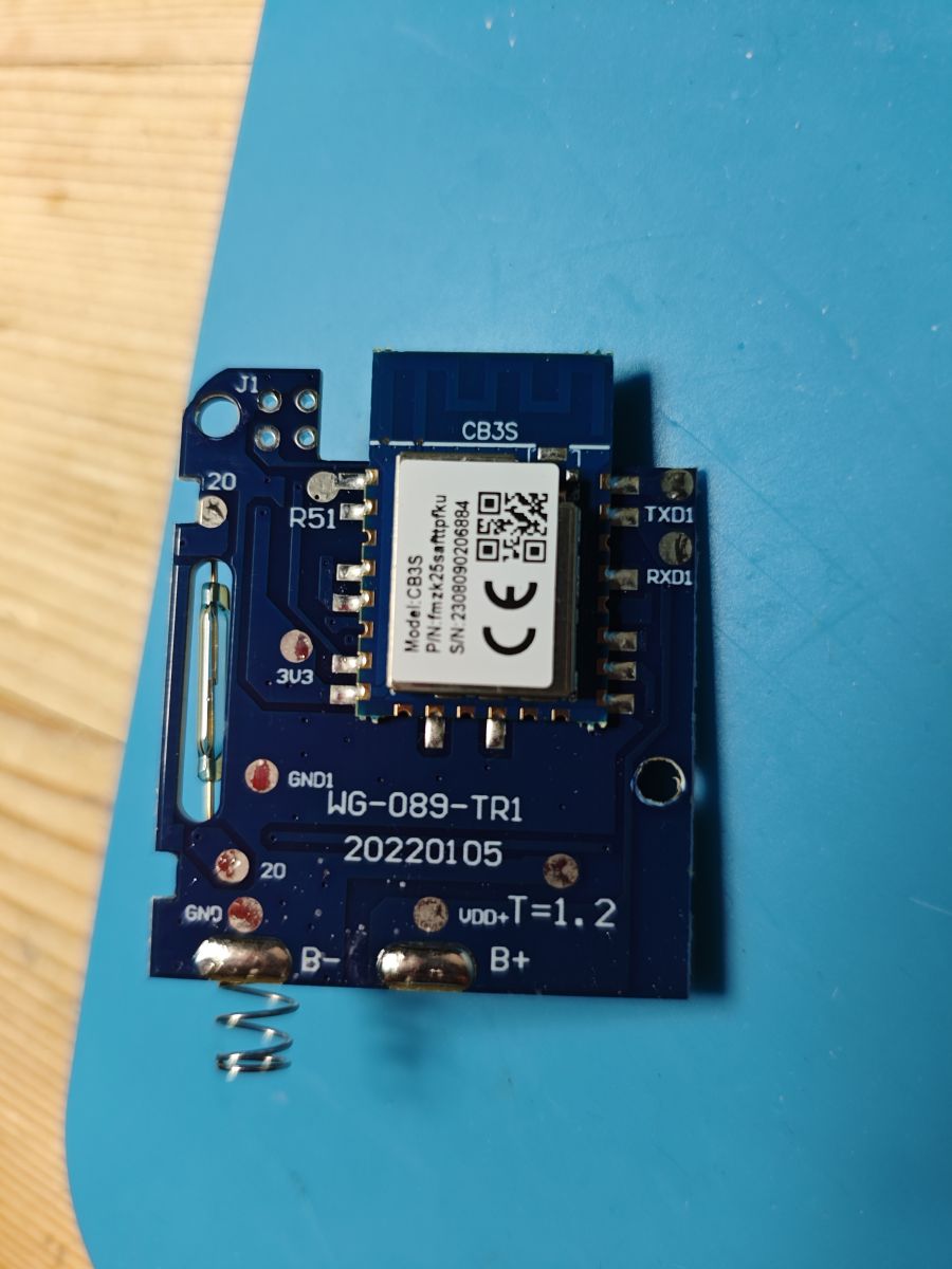

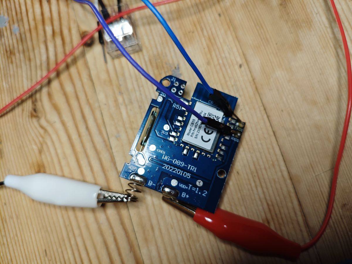

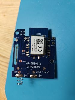

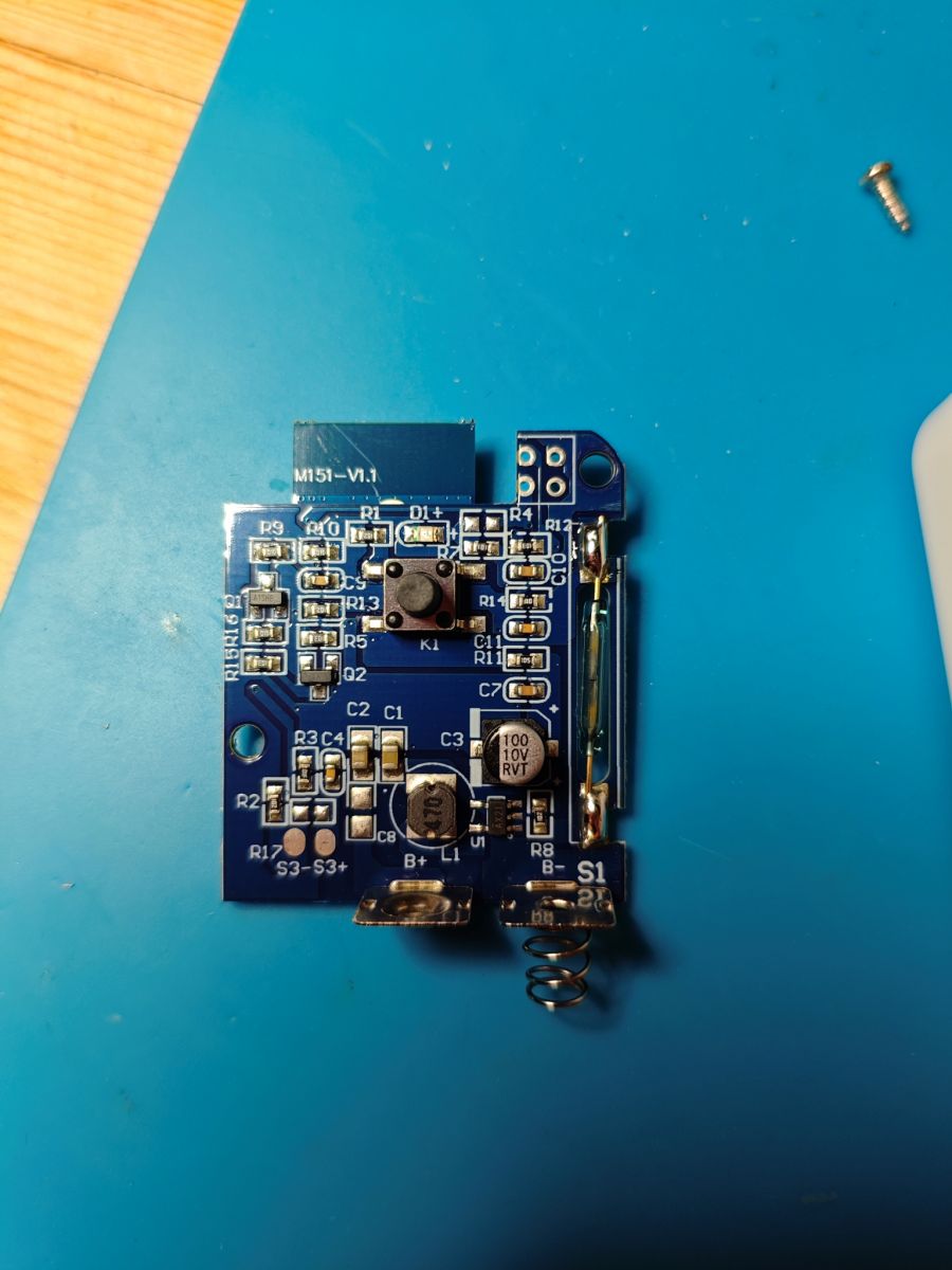

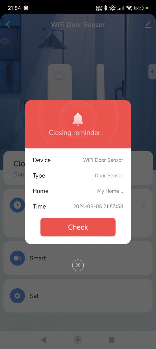

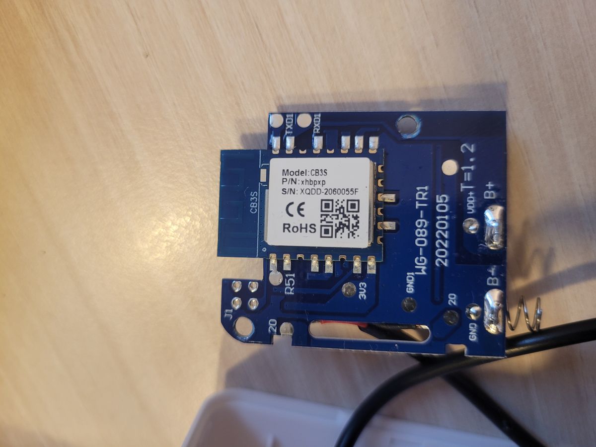

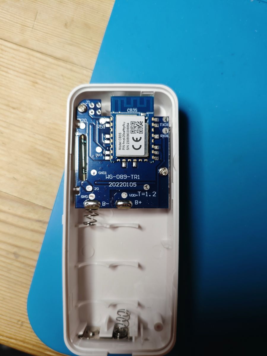

    The subject of this post is a generic Tuya battery-powered magnetic window/door sensor that I saw with an XR1 (XR809) module in one picture. Mine came with a CB3S however.
    No matter, it can still be opened, analysed and flashed to OpenBeken.
    Tuya window-door sensor with CB3S module in a plastic housing without batteries Tuya magnetic window and door sensor with white casing. Tuya sensor PCB with visible electronic components. Image of the interior of a plastic sensor casing, with a visible battery compartment. Image of a printed circuit board with a Tuya CB3S module. CB3S module mounted on a blue PCB with connected wires on a wooden surface.

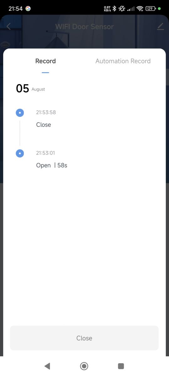

    App screen displaying an open WiFi door sensor. App settings screen showing battery level and alarm options. Device update screen showing no updates available. Main module and MCU module versions are V1.0.10. Closing reminder from the WiFi door sensor. Record history of WiFi door sensor opening and closing.
    Tuya door-window magnetic sensor with packaging and manual on a table. Wi-Fi door sensor packaging with text and QR codes.
    The age of the build date and fw version means it is cloudcutterable https://github.com/tuya-cloudcutter/tuya-clou...es/tuya-generic-cb3s-door-sensor-v1.0.10.json
    though the pin assignments differ for this variant.
    UART boot log out
    OBK template
    and what seems to be a reasonable autoexec:
    DSEdge 0 is tested to wake the device if magnet pulls away (door/window opens) from the sensor when it is in deepsleep. Conversely if the sensor is in deepsleep when the magnet returns to the sensor (door/window closes), the device also wakes from deepsleep.
    OpenBK software interface for a Tuya sensor.
    https://github.com/OpenBekenIOT/webapp/pull/140
    • readResult_BK7231N_QIO_2024-05-8-21-41-14.bin (2 MB) You must be logged in to download this attachment.

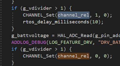

    By the way, this device seems to be using the battery driver. Are you aware about this problem where Bat_Relay channel can't be used for other purposes? Maybe we could try to fix it? Just ... detach battery driver from channels?
  • Clarifying how to detach battery driver from channels
    Well, I knew/assumed the BAT_Relay channel needed to not be used by any other assignment, but my BAT_Relay channel 3 is not assigned anything else...
    What does deatching the battery driver from channels entail?
  • #4 21182794
    Posts: 14756
    Rate: 12883
    I will try to change drv_battery.c code so it just sets a pin, not a whole channel:
    Screenshot of C code with a snippet about setting a channel for drv_battery.
    Would you be able to test that?

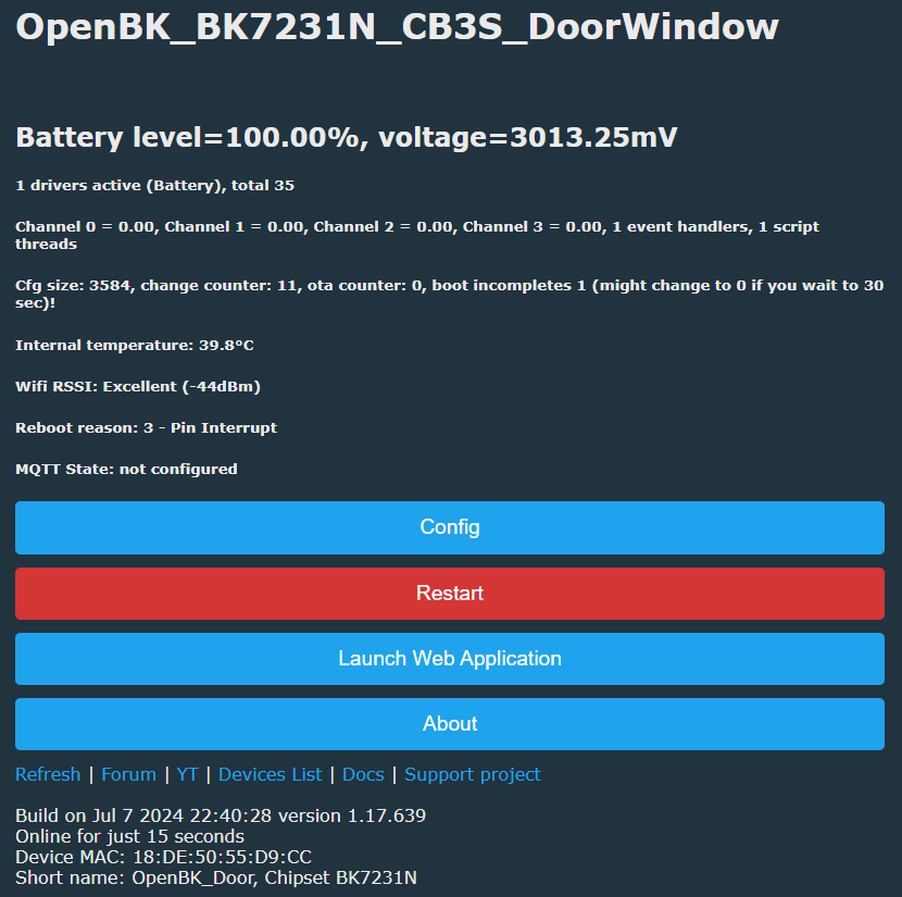

    Screenshot of the OpenBK_BK7231N_CB3S_DoorWindow user interface displaying device status information.
    Screenshot showing an interface with a dropdown menu and a text box with the value 3 entered.

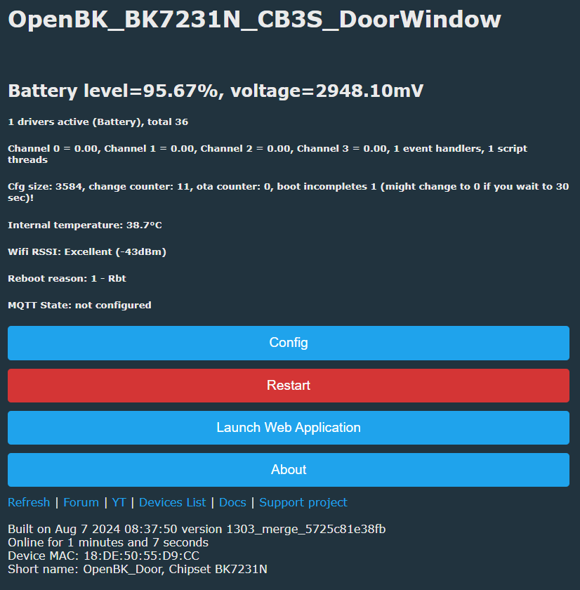

    So battery driver still works good after my PR?
    Yes. Seems to be

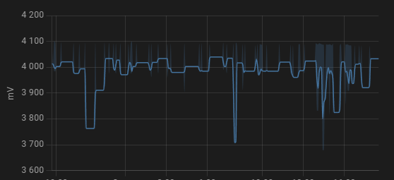

    One of my devices (CBU+CHT8310) have, what i believe, is a bad adc.
    I power it with a single 18650 battery.
    Graph of battery voltage changes in mV showing fluctuations.
    So i tailored myself a patch, which takes multiple measures, and then publishes a median one.
    Though it is not enough, it still is better than what was before.
    So with this patch, adc takes, in my case, 20 measurements with 25ms delay between them. So for half a second bat_relay is on.
    If i update the main page during the measurements, the bug happens.
    I occasionally ran into this even without the patch, and didn't understand what is the reason.

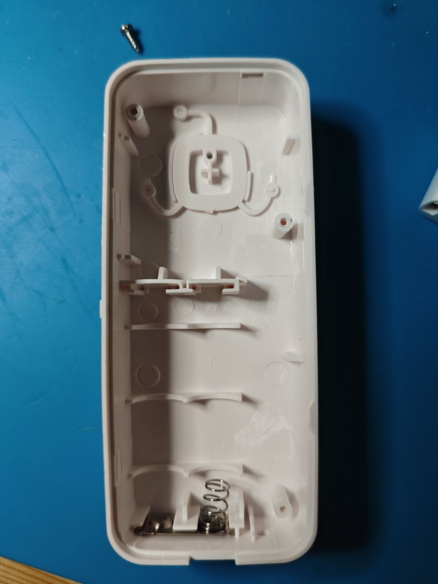

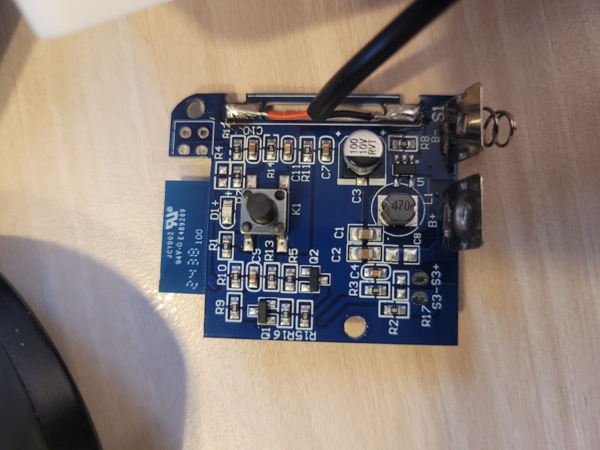

    Thanks for sharing. Do you have flash backup?
    This long part is not a fuse, it's a sensor.
    You have slightly different device type, you have external one.
    White Tuya WiFi door/window sensor with magnet and status light
  • Tuya pinout and battery thresholds extracted

What’s the benefit of the battery‑driver PR mentioned here?
It changes the driver to write directly to the first Bat_Relay/Bat_Relay_n pin, avoiding channel conflicts. “This should write directly to first found Bat_Relay...” is how the author described it. [Elektroda, p.kaczmarek2, post #21182887]
Did someone test the new battery‑driver behavior?
Yes. A tester replied that the battery driver still worked after the PR. That confirms functional parity while enabling freer channel use. [Elektroda, divadiow, post #21184571]
I saw a bug when Bat_Relay is on and I refresh the main page. Is there a fix?
One user reproduced hangs during long Bat_Relay on‑time with ADC oversampling (20 reads × 25 ms). They added median sampling and a guard to disable oversampling if a cycle overlaps. Reduce relay on‑time or sampling window. [Elektroda, insmod, post #21184576]

Do I need to reserve the Bat_Relay channel for the battery driver?
With the PR approach, the driver toggles the relay pin directly, not the whole channel. That reduces conflicts with other channel uses. [Elektroda, p.kaczmarek2, post #21182887]
