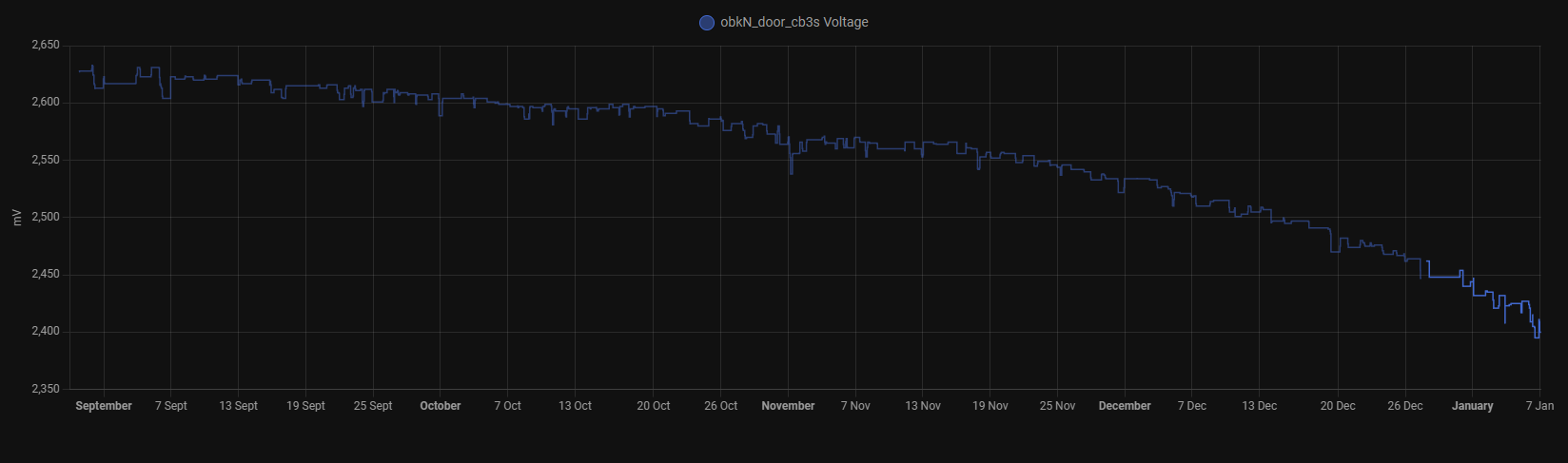

    I have this pr currently installed on 2 devices. One is cht8310 sensor with 1000mah li-ion battery, supported by a solar panel.
    The other one is a door sensor, with 2x1000mah 1.2v ni-mh batteries, and i haven't had a problem with it for 4 months. The batteries are still working.
    Graph showing door sensor voltage over time from September to January.
