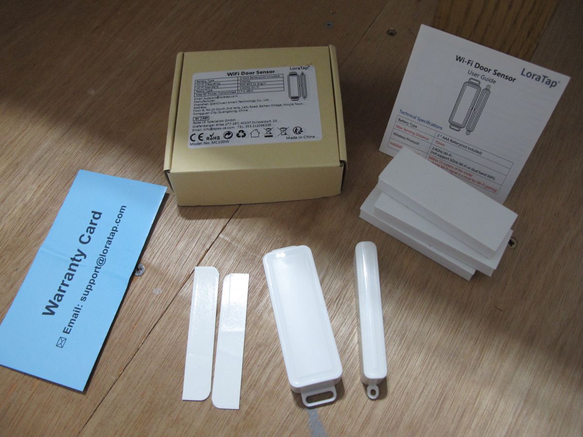

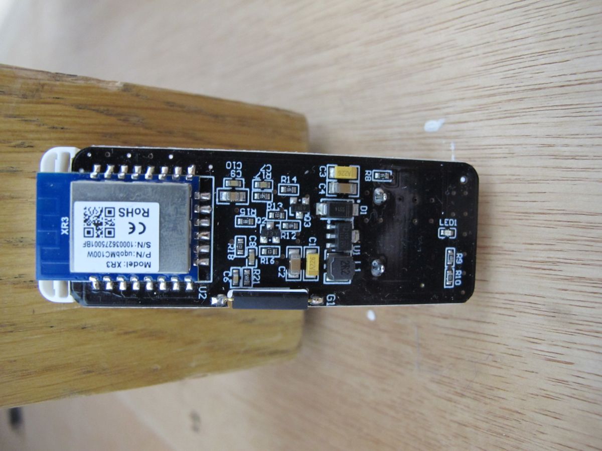

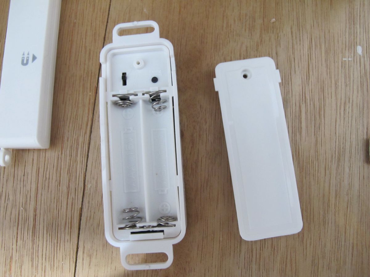

    Here I'll take a quick look inside a LoraTap/Tuya MC100W contact sensor for door/gate/window open/shut monitoring.
    Ali Express purchase
    https://www.aliexpress.com/item/1005007268034863.html
    Promotion for LoraTap WiFi/ZigBee door and window sensors.
    https://www.loratap.com/products/mc100w

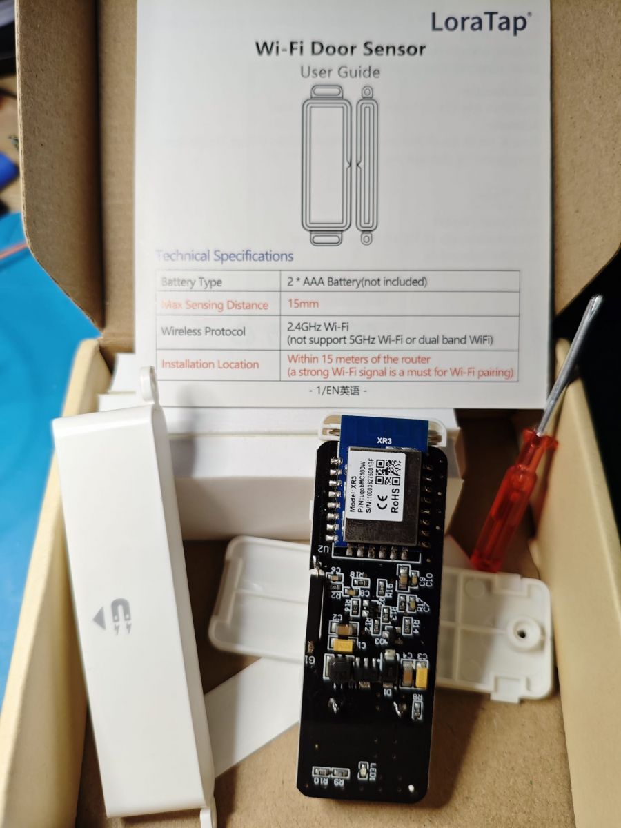

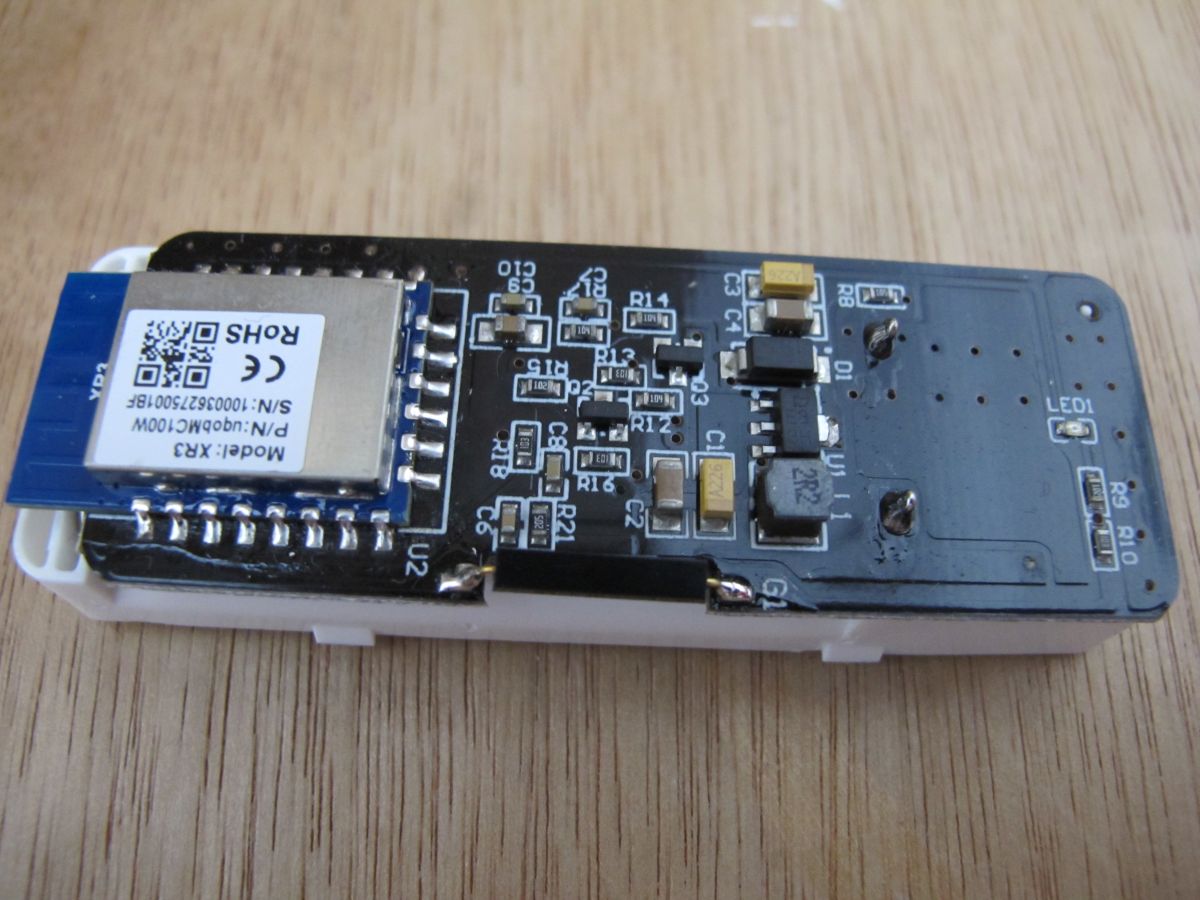

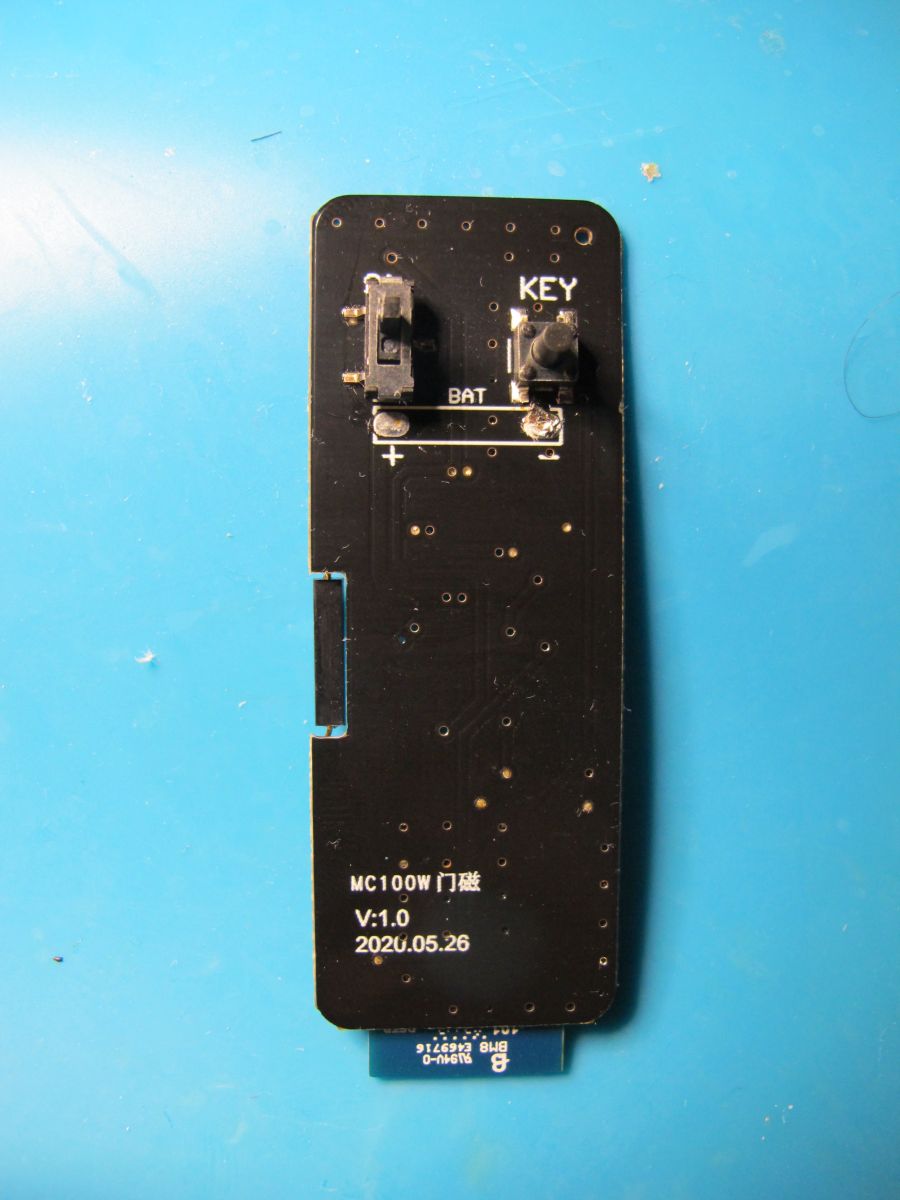

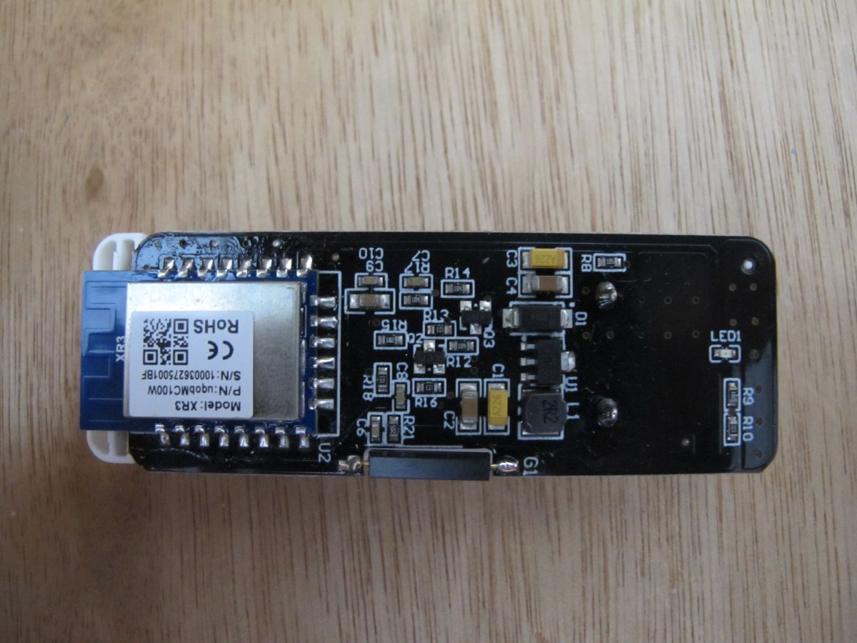

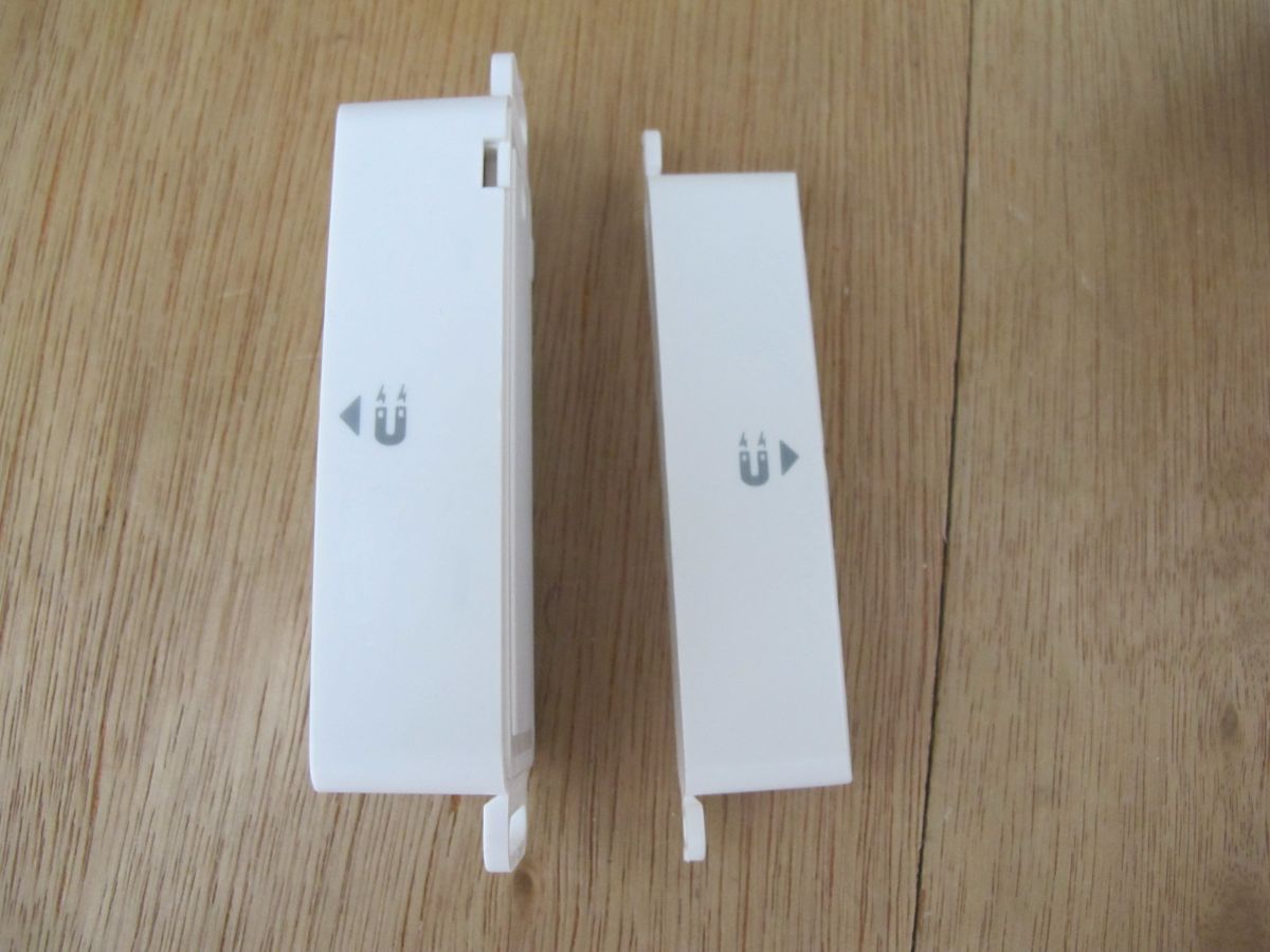

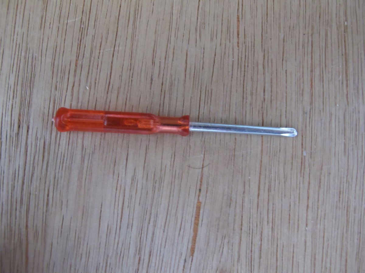

    Box, parts, device internals:
    Label of LoraTap WiFi Door Sensor packaging with technical information. LoraTap Wi-Fi door sensor kit on a wooden surface, including a user guide, warranty card, mounting tapes, and a sensor. Two white enclosed devices on a wooden table resembling sensors.Open plastic battery case with a white cover next to it. Electronic module with components on a wooden background Close-up of a digital circuit board with electronic components. Electronic module with components on a printed circuit board Small screwdriver with a transparent orange handle lying on a wooden surface. LoraTap Wi-Fi door sensor kit with user manual and components. MC100W circuit board with buttons labeled KEY and BAT on a blue background.

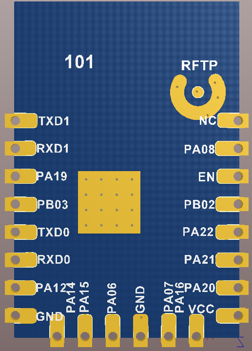

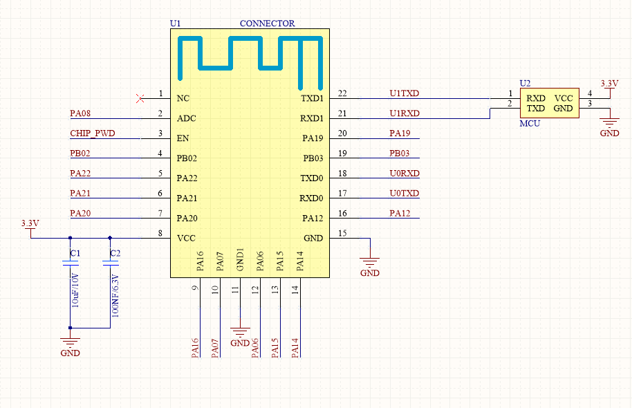

    Xradiotech (now Allwinner) XR809 on a Tuya XR3 module
    Initial OpenXR809 development can be seen here with another contact sensor https://www.elektroda.com/rtvforum/topic3806769.html
    Electrical schematic of a connector and electronic components
    Electronic module with visible pins and labels on a navy blue background.

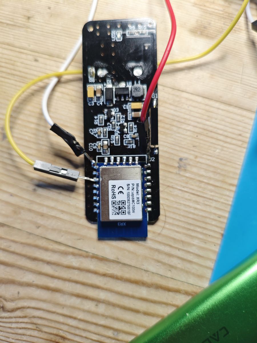

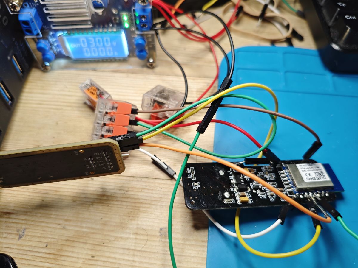

    With XR3 module powered directly with 3.3v, the boot log from RXD0 can be captured at 115200 baud
    Circuit board with attached wires and a wireless module.
    And using the same process as with this P06 XR3 motion sensor the firmware can be dumped using PhoenixMC, the official UART flash tool.
    With PB02 and PB03 common grounded with 3.3v PSU, USB-TTL GND and XR GND+
    XR3 RXD0 -> USB-TTL RX
    XR3 TXD0 -> USB-TTL TX
    Electronic circuit board with colorful wires on a wooden table.

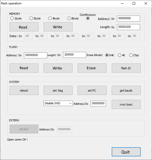

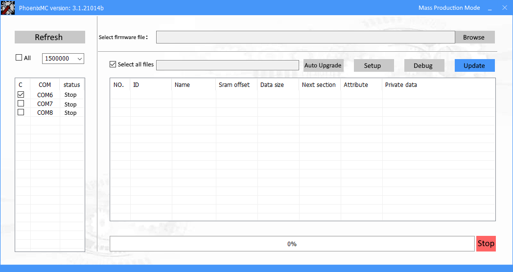

    we read the 2mb flash to file from the debug menu in PhoenixMC
    PhoenixMC software interface for mass production
    Flash operation program interface.
    output is flash_A_0x0_L_0x200000.bin at 2,097,152 bytes

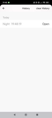

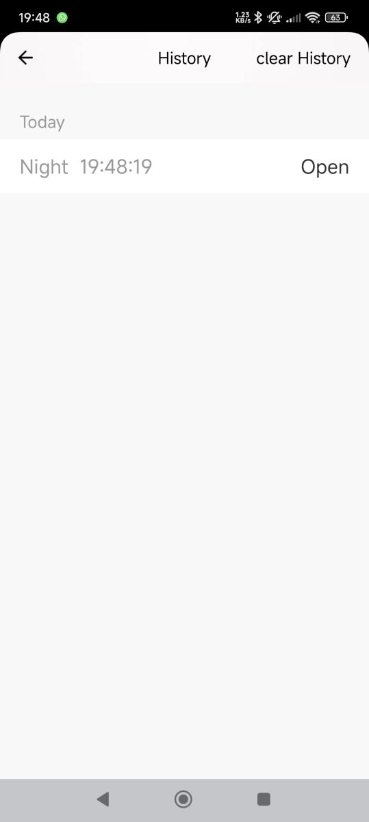

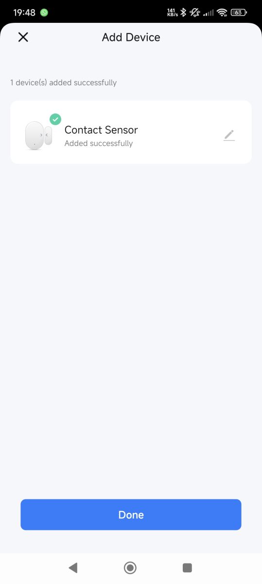

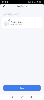

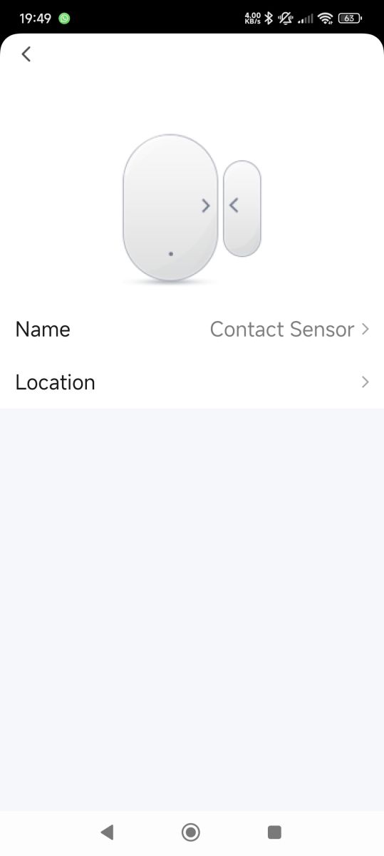

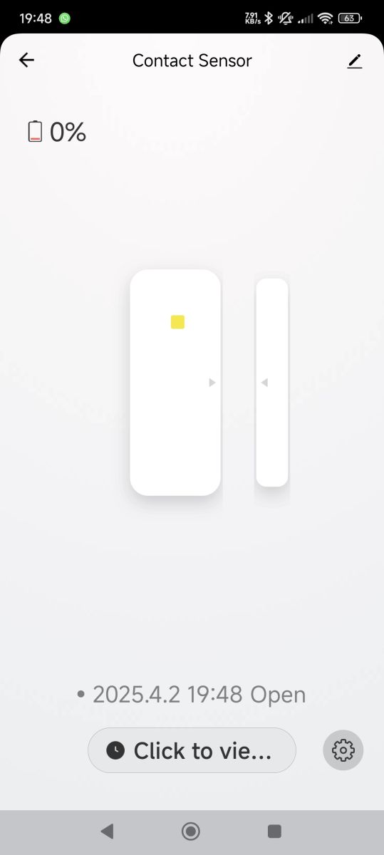

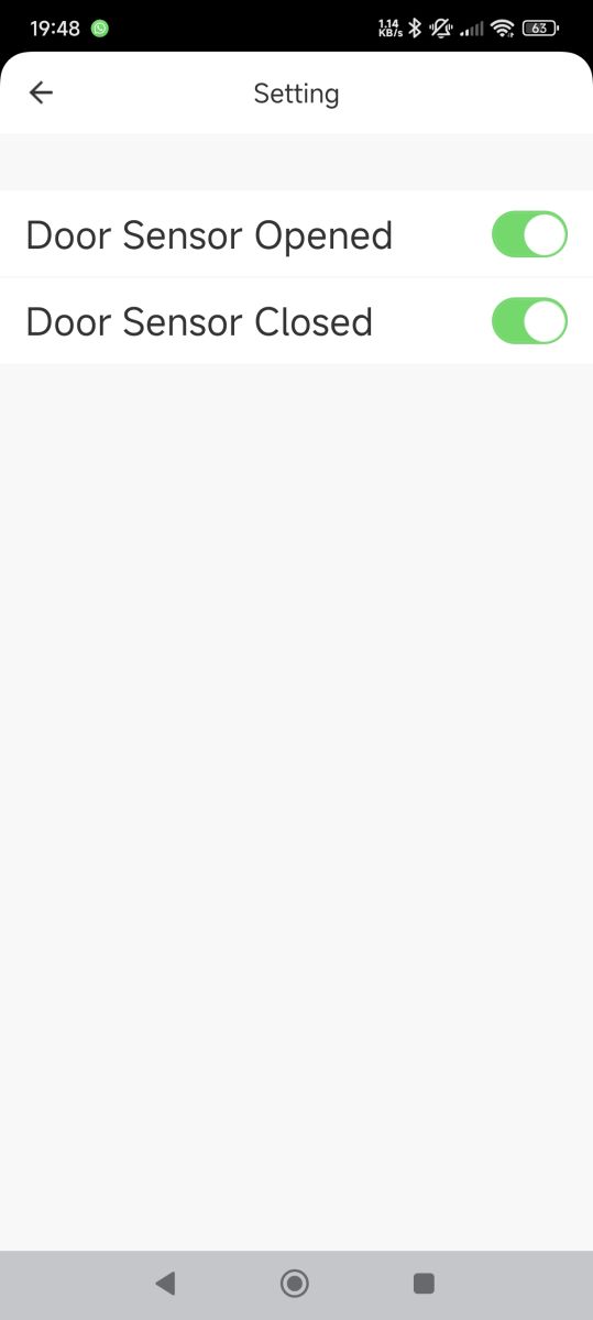

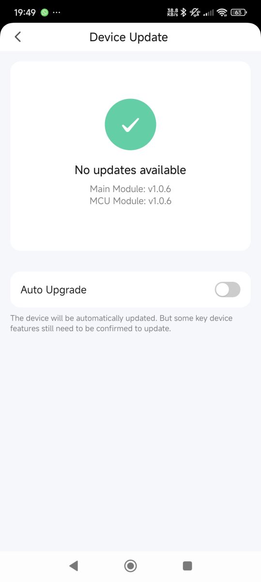

    Before flashing OpenXR809 I paired it with the Tuya app
    App screen with added contact sensor. App screen showing the status of a contact sensor with low battery and open status. Screenshot showing activity history in an app with an entry labeled Night at 19:48:19, marked as Open. Screenshot of an app settings with options Door Sensor Opened and Door Sensor Closed both activated. Device update screen showing no updates available. App screen showing a contact sensor illustration.
    Device has schema ID: 000001qrb9, firmware key8ky3d8eshuygm and firmware version 1.0.6.

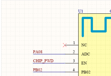

    I don't see mention of BAT_ADC assignment, but one assumes this should be P08
    Electronic schematic with pin labels.

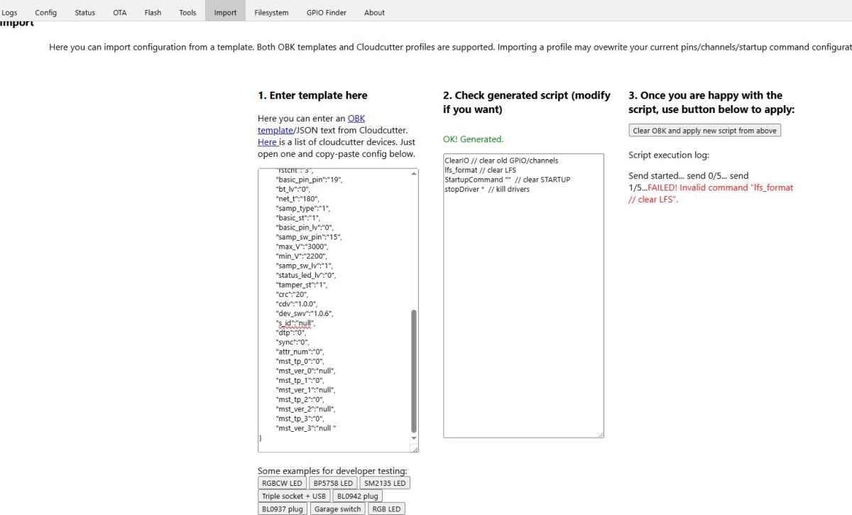

    Template import does not work because there is no LittleFS support in OpenXR809
    Screenshot of an interface for importing templates for OBK and Cloudcutter devices.

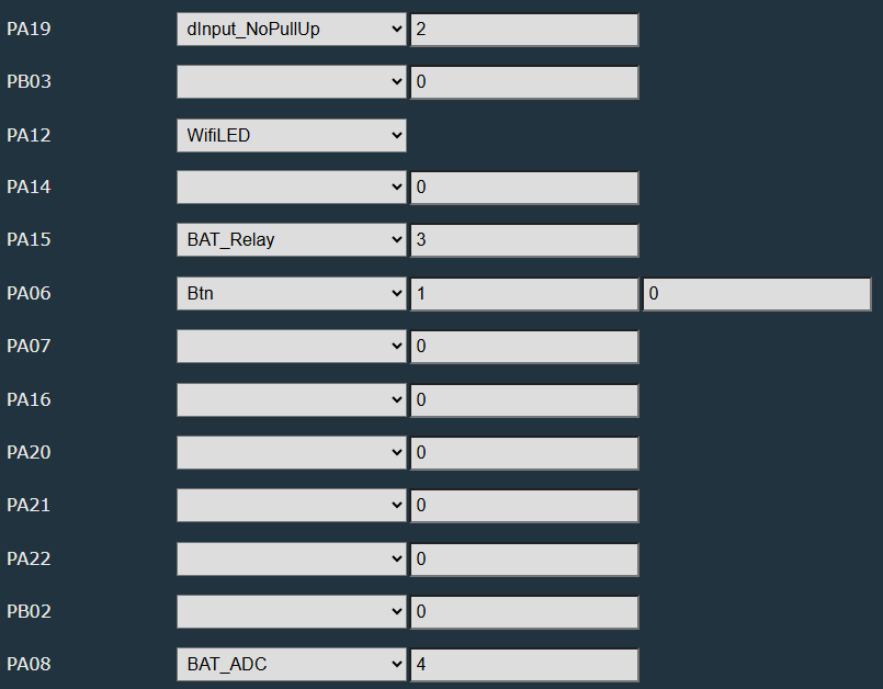

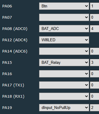

    So manual assignment is required. In it's most basic form those are:
    which, visually, is as follows
    Microcontroller port configuration with assigned functions and values.
    With this the button pushes are acknowledged
    the LED flashes when connecting to wifi but is off once connected and the channel assigned dInput_NoPullUp (channel 2) will change state depending on the proximity of the magnet to the sensor on the PCB
    Magnet close (door closed)
    Magnet removed (door open)
    Unfortunately the battery driver does not seem to be present on OpenXR809 and I don't think any deep sleep functions are available so battery operation is not practical - it will need powering from external 3v. I may be corrected on this and XR809 support may get developed to enable these functions.

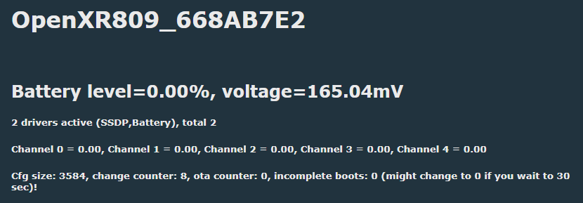

  • Battery driver enabled but ADC readings are invalid
    #2 21506197
    Posts: 5208
    Help: 446
    Rate: 914

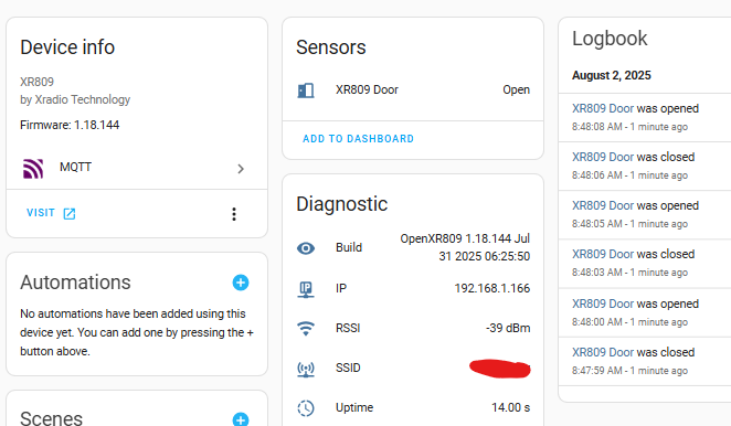

    got the battery and SSDP drivers enabled in a custom build https://github.com/openshwprojects/OpenBK7231T_App/pull/1591
    I'm sure the assignments are correct but the readings do not seem to be
    Screenshot showing diagnostic information for the device OpenXR809_668AB7E2.
    SSDP seems to be working.
    Screenshot of the properties of the OpenXR809_668AB7E2 network device.

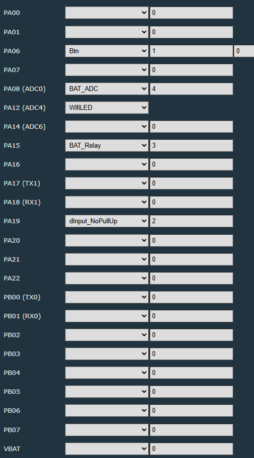

    Because of the pin sort the assignments for this MC100W are now
    GPIO pin assignment configuration for XR809 shown in web interface
    I think this is a reasonable starting autoexec, not thoroughly tested.

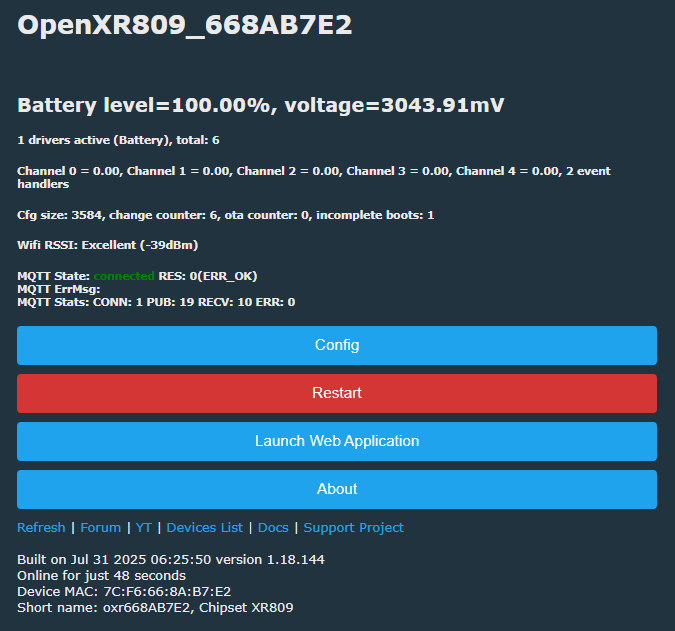

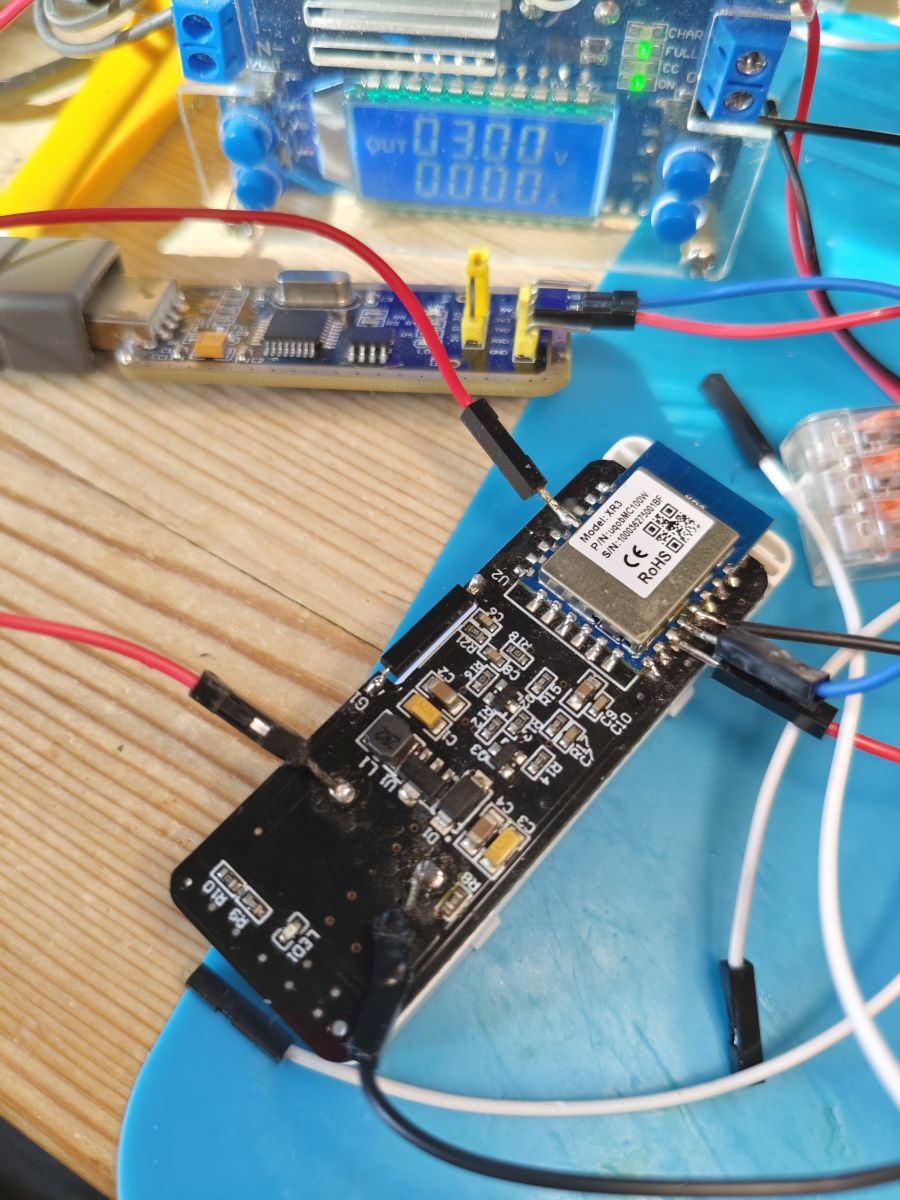

    Battery measurement seems to be OK sometimes, but will often drop to 0, even without autoexec configured
    Web interface of OpenXR809 device showing battery status and configuration buttons
    My setup is currently 3v fed through battery terminals
    XR809 module connected to USB power supply and measurement circuit

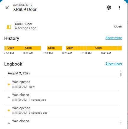

    HomeAssistant registering changes in state as I move magnet close/away
    HomeAssistant XR809 Door panel showing door open/closed history and logbook events
    Screenshot of Home Assistant UI showing XR809 Door device info and door activity log

    On XRs powersave has two parameters.
    Second one is DTIM interval. Values like 6 or 10 can be good for battery life.

    oh cool. didn't know (not sure i fully understand it) what DTIM was or that XR powersave had this option. thanks. what's the trade-off? a potentially slower reflection of state change in HA?
    regarding free mem, with MQTT, battery driver configured, device runs at around ~80k

    just to add that battery measurement appears to have stabilised somewhat, but occasionally drops to 0
    Battery level 99.26%, voltage 2994.09 mV, 1 driver active (Battery)

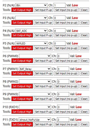

    I notice however, that, OK, so the pins have changed, but that the new numbering means a template cannot be extracted from any info Easy Flasher may be able to get or presumably, what might be visible in factory boot log. What I mean by that is that this was seen initially in EF (missing some stuff though)
    but the new template doesn't line up with that at all
    not sure I can work out why. Is GPIO Dr/web app aligned OK with pins visible in GUI?
    Screenshot of GPIO Dr/web interface showing assigned pin functions and status Screenshot showing GPIO assignments from PA06 to PA19 in the configuration interface
