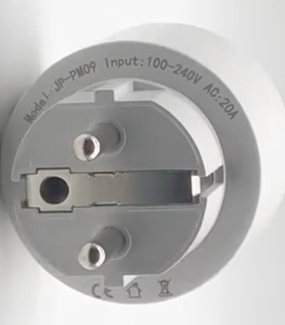

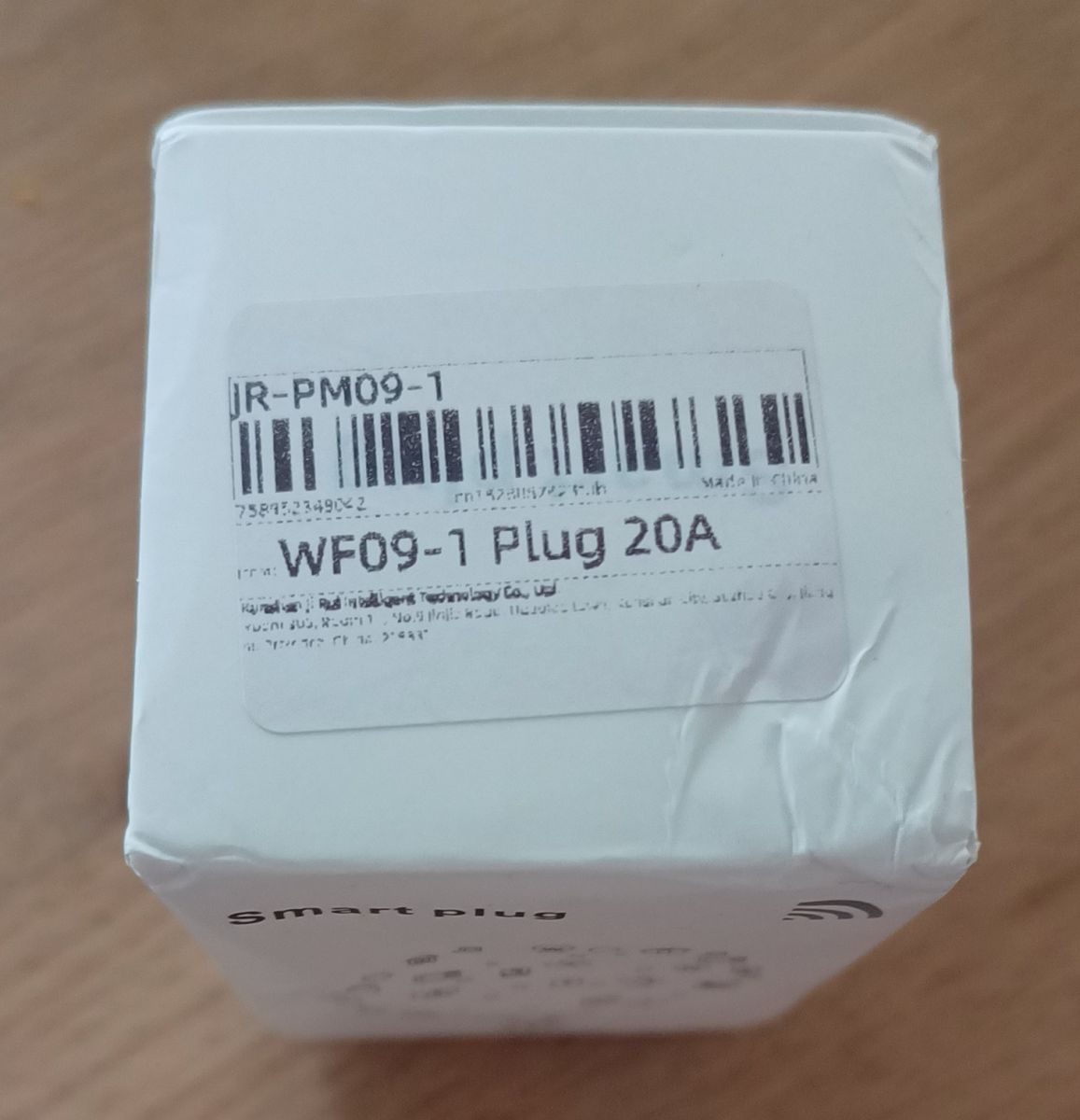

    I purchased this EU Power Monitoring Plug on ALIEXPRESS in July 2024. It has the reference JR-PM09.
    Girier EU Power Monitoring Plug with 20A Energy Metering label.
    Top view of an EU Power Monitoring Plug, model JR-PM09.

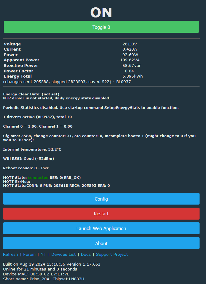

    Web interface of the EU Power Monitoring Plug showing electrical parameters.

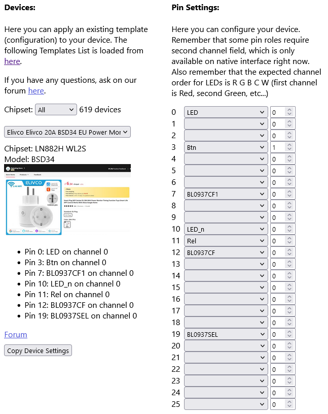

    I used the pinout of the ELVICO plug.
    Elivco plug configuration page with pin settings details and device description

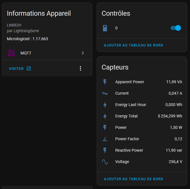

    My plug is recognized in Home Assistant
    Energy monitoring app screen displaying readings from LN882H plug

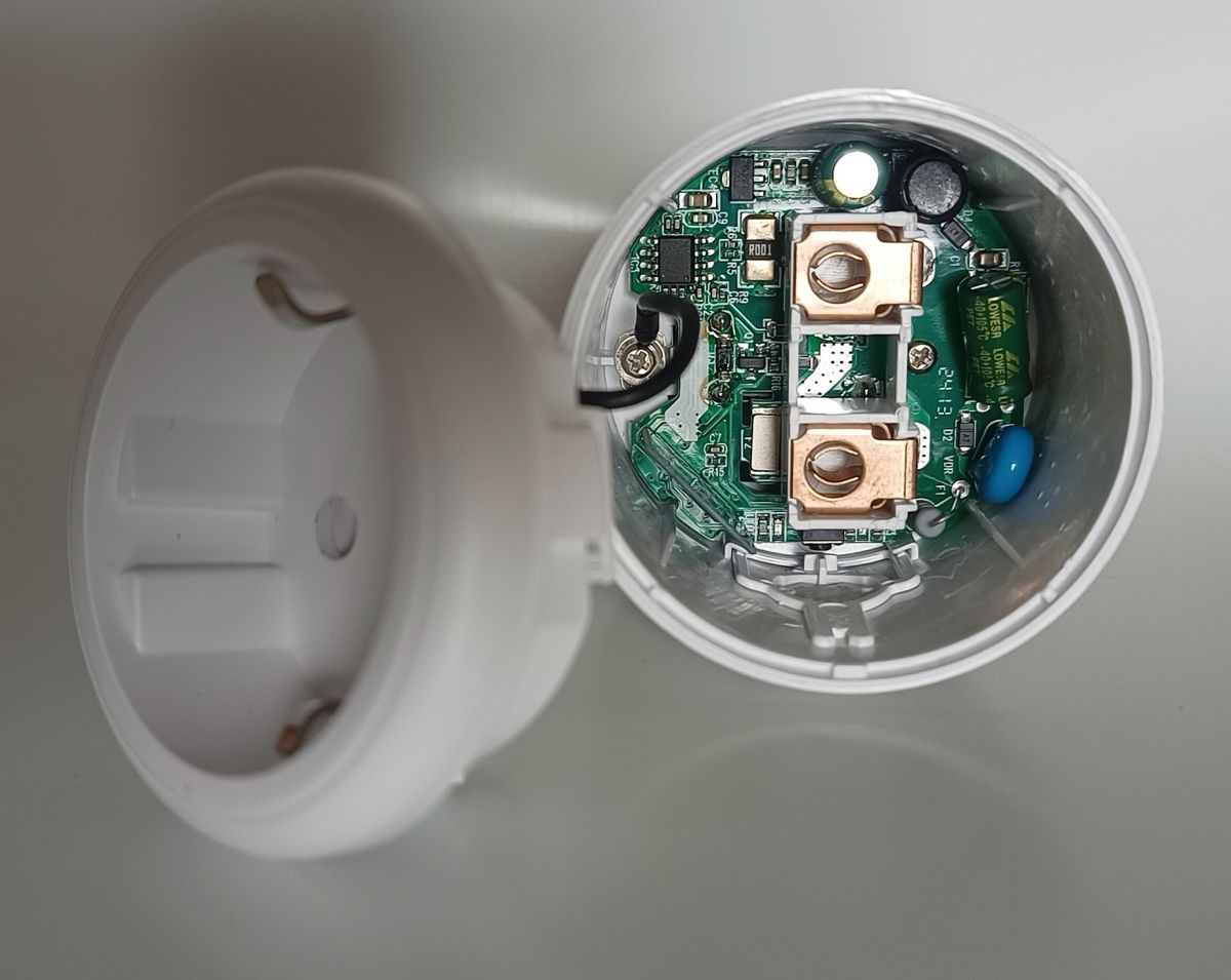

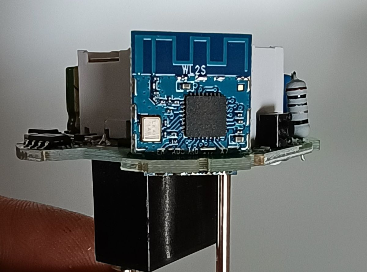

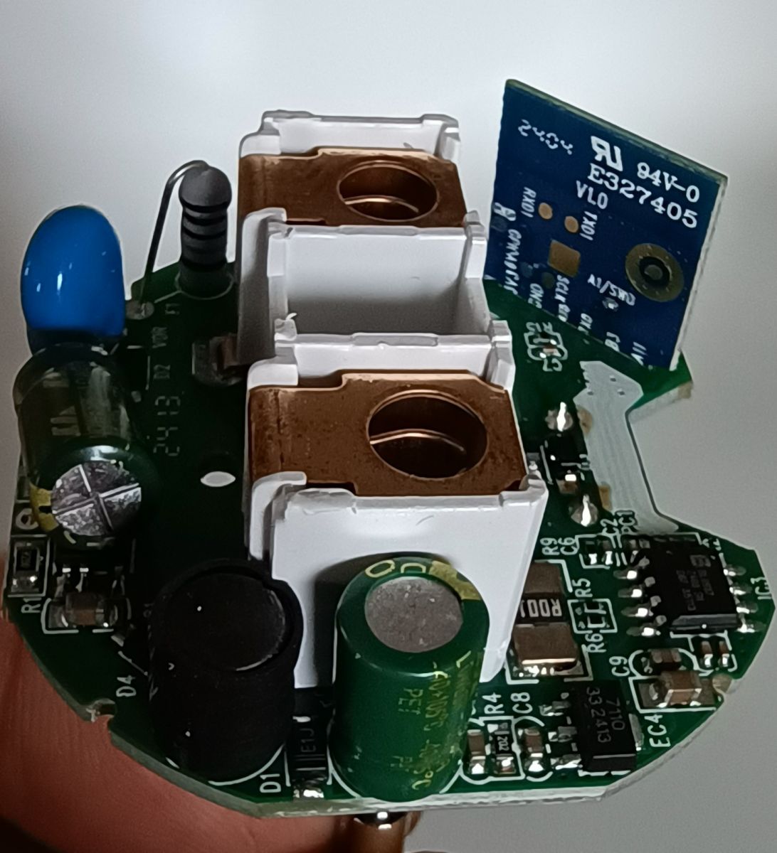

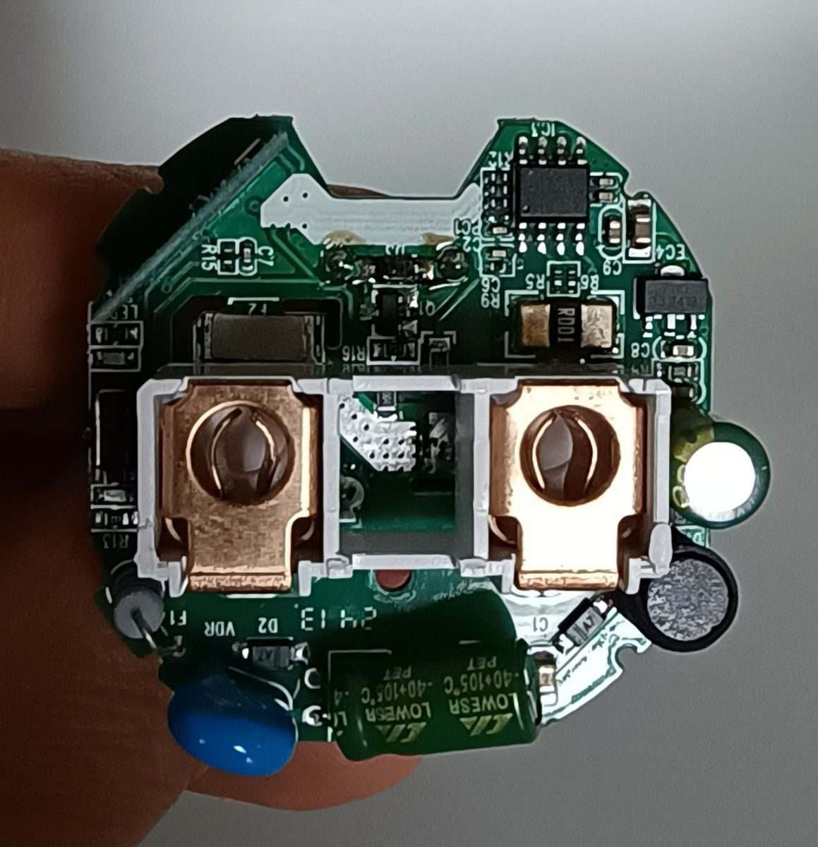

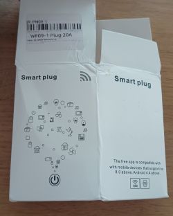

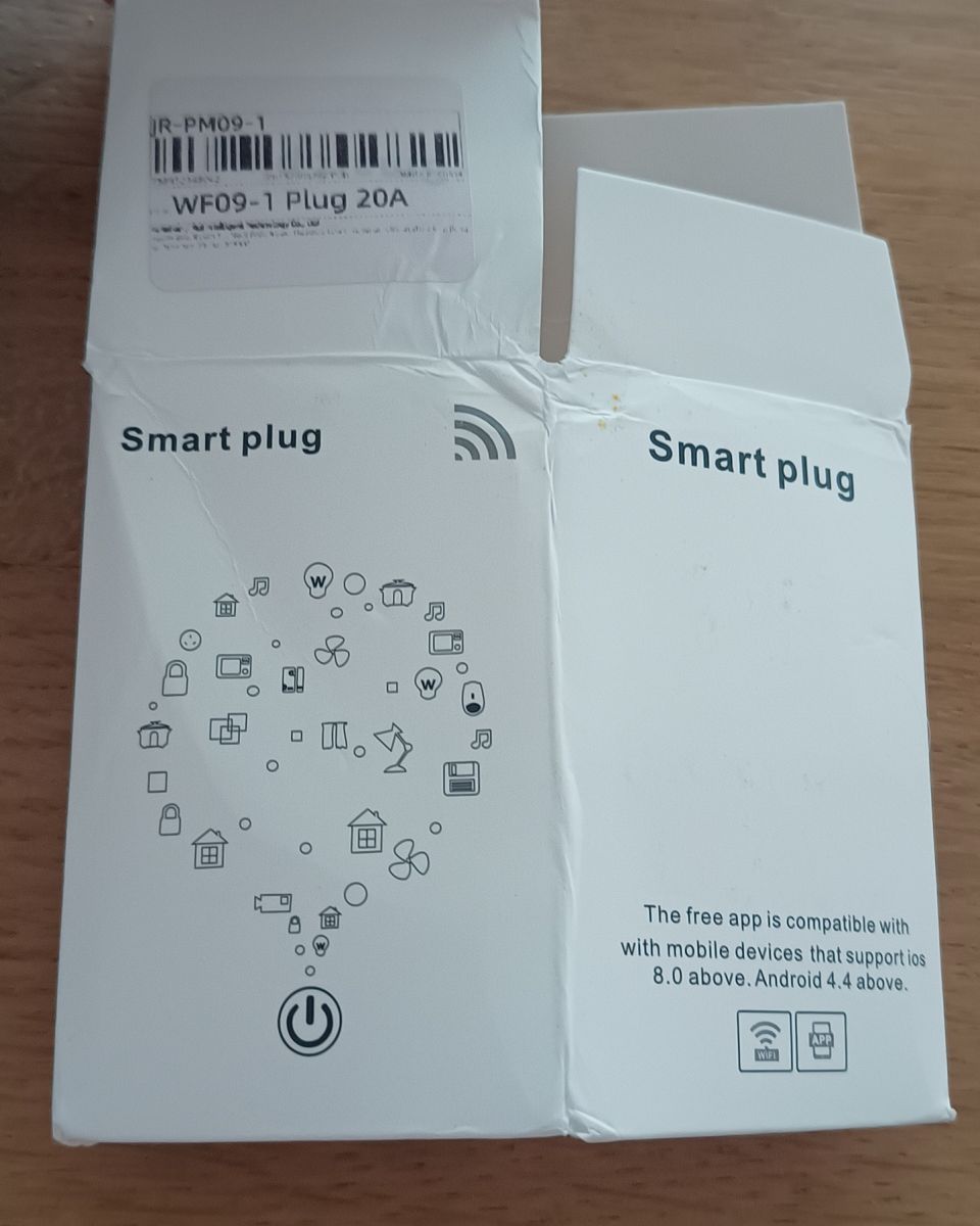

    Here are photos of the plug:
    Close-up of the interior of a plug with visible electronic components. Interior of the plug with electronic components on a circuit board. Close-up of the internal components of the EU Power Monitoring Plug showing the WL2S module. Girier brand EU Power Monitoring Plug with visible power button. View of the interior of the EU Power Monitoring Plug JR-PM09 showing the circuit board and electronic components. Packaging of the EU Smart Plug power monitoring plug with reference number JR-PM09. Packaging of JR-PM09 smart plug with compatibility and manufacturer information. Box of JR-PM09-1 plug with WF09-1 Plug 20A label

  • #3 21203294
    Posts: 5220
    Help: 449
    Rate: 918

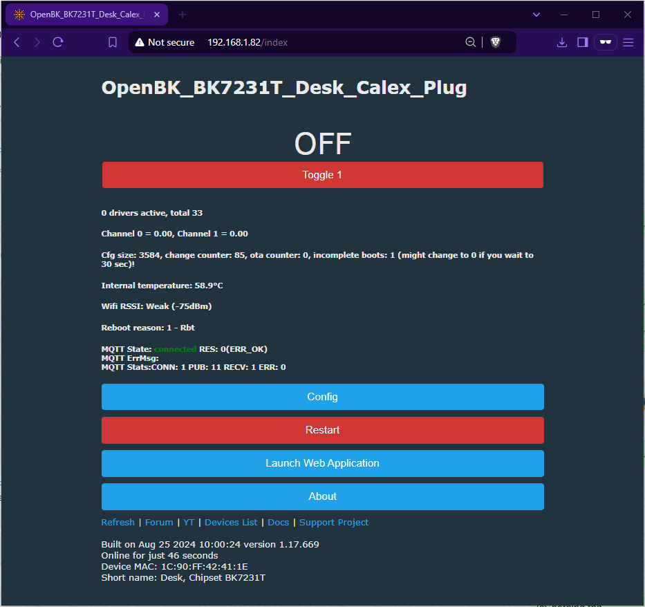

    Web interface of OpenBK for BK7231T device with control options displayed.
    Crushing the plug opened the case easily

    Is this the YAML template?
    "vendor": "GIRIER",
    "bDetailed": "0",
    "name": "GIRIER 20A Power monitoring plug EU [JR-PM09]",
    "model": "JR-PM09",
    "chip": "LN882H",
    "board": "TODO",
    "flags": "1024",
    "keywords": [
    "TODO",
    "TODO",
    "TODO"
    "pins": {
    "0": "LED;0",
    "3": "Btn;1",
    "7": "BL0937CF1;0",
    "10": "LED_n;0",
    "11": "Rel;0",
    "12": "BL0937CF;0",
    "19": "BL0937SEL;0"
    "command": "IPAddress2 255.255.255.0",
    "image": "https://obrazki.elektroda.pl/6206467900_1724503854.png",
    "wiki": "https://www.elektroda.com/rtvforum/topic4072130.html#21202204"
    It opened easily.
    I crushed it gently several times.
