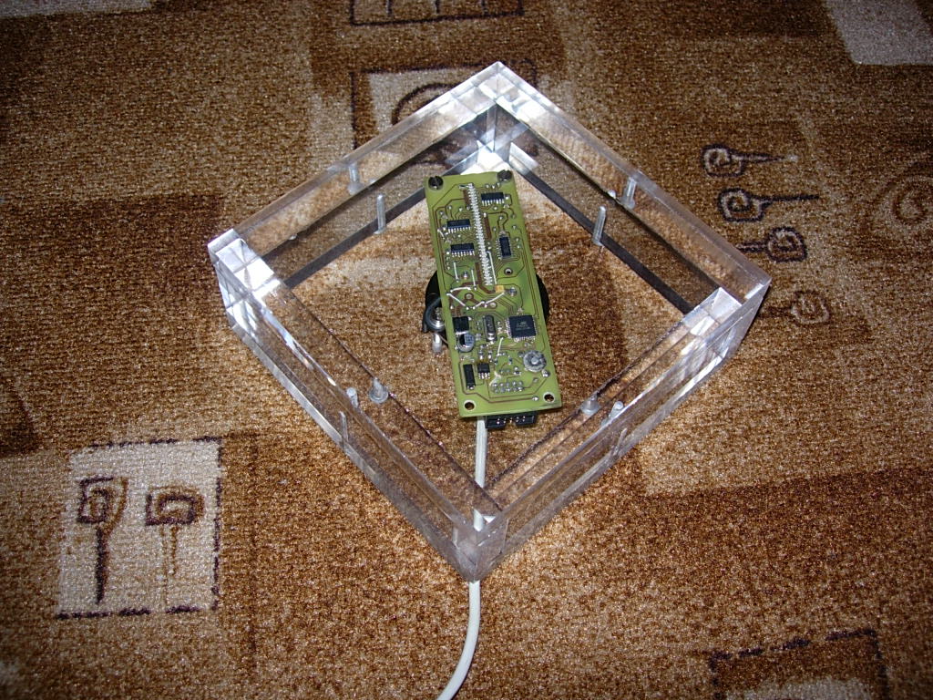

    At the beginning I would like to say hi, because as you can see this is my first post. I've been browsing the electrode for a long time, but I've never been on the forum. Today I decided to take a step forward, show myself with something specific.
    The idea of the project is as old as the world, repeatedly rolled out on the forum. Nevertheless, I would like to show my implementation of this idea.
    The system consists of two main parts: a programmable propeller and a drive part.
    :arrow: Propeller:
    Spectral Clock - Propeller Clock Spectral Clock - Propeller Clock
    The heart of the system is the ATMEGA32 microcontroller that manages the display content. It drives 32 blue smd diodes via 4 serial LED MBI5170 drivers. The time is taken from the RTC DS1307 system, with the uC it is connected by the I2C bus. Image synchronization is of course realized by an optoelectronic sensor. 32 KB of flash memory in ATMGA allow support for multiple display modes.
    :arrow: Engine:
    I tried many solutions and the HDD motor turned out to be the best. It works almost silently, has a high speed of rotation, 6 threaded holes for easy attachment of the propeller. The use of such an engine, however, was associated with the use of a special control. The optimal solution seemed to be the use of a dedicated PHILIPS TDA5140A driver working in the standard configuration (although not entirely, because the winding in the motor is connected by a triangle, so it was necessary to create a point of an artificial center). Energy is transported by brushes. I am aware of the imperfections of such a solution, but I did not want to complicate the project further. In this matter, I leave the door open to designing the next version.
    :arrow: Case:
    As you can see, the casing is made of 15 mm plexiglass. Such thick walls mean that at 50 revolutions per second, the noise level produced by the clock is kept at a very decent level. Additionally, if something inside should be broken by accident, no one in the vicinity of their heads will lose their heads. The back cover is fixed with 4 screws, the rest of the structure is glued with ACRIFIX 192 glue.
    As I am not a professional, the documentation created during the production of the clock has many flaws, so I am not enclosing it yet. I will try to refine it a bit and then post it on the forum.
    I am open to any suggestions regarding the project.
    Below is a link to a video showing the clock's work:
    http://pl.youtube.com/watch?v=no2_M_b059g " target="_blank" rel="nofollow noopener ugc" class="postlink inline" title="" > http://pl.youtube.com/watch?v=no2_M_b059g

    Great project, I'm trying to do one myself, could you say something more about the HDD motor control?

    At the beginning, I thought that I would build a driver myself that would be able to drive such an engine well. However, as it turned out later, handling all this electronic commutation is not that simple. Then I decided to use this layout (http://www.ortodoxism.ro/datasheets/philips/TDA5140A_2.pdf " target="_blank" rel="nofollow noopener ugc" class="postlink inline" title="" > http://www.ortodoxism.ro/datasheets/philips/TDA5140A_2.pdf ) and not go further into the very essence of its operation. In the presented project, the system works even with elements with the values given in the example application in the catalog note.

    It is probably not a matter of balance, but that it is mounted so firmly, and finally the HDD motor is quite strong.
    I still have a question, what is the display synchronization with this optoelectronic system? I know that the sensor detects that the plate has turned (made a circle) and then I think the rotational speed is calculated? But how do you synchronize it so that these letters and pointers do not go apart ?? I know that there was a project on the elce in which someone had such a synchronization, regardless of the speed of rotation, it always displayed correctly, thanks to this sensor. If I had to program something like that myself, I wouldn't even know how to go about it :) Could you go into this programming process in more detail?
    There is a lot of truth to this. The propeller is bolted in several places and, in addition, the engine has such a compact structure that I have the impression that the car could run over it. Nevertheless, when designing the PCB, I tried to arrange the elements as easily as possible, so as to minimize vibrations. However, I did not use any advanced tools, rather I did it by eye and peasant reason :) .
    I will present the software model. At the outset, I will add that the atmega works with an external 16 MHz quartz, and all meters work on the f / 8 prescaler.
    The key element is an optoelectronic sensor (nothing else than an IR diode and a phototransistor in one compact housing) which, when the propeller passes through 12 o'clock, sets the state high to INT0, causing an appropriate interruption. In this interrupt, the state of the 16-bit counter TIMER1 is reset. Then nothing happens until the next interrupt coming from INT0. Then the program checks the TCNT1 value. If it is too high or there is an overflow of this counter, it means that the propeller is spinning too slowly to display anything on it, as the resulting image would be of poor quality due to blinking. However, if the TCNT1 value is below the threshold value, the system works as follows:
    1) writes to the global variable the value of gClicksPerStep = TCNT1 / 240;
    2) initializes this value 8 bit counter TIMER0, TCNT0 = 255 - gClicksPerStep;
    3) activates the interrupt due to TIMER0 overflow
    4) resets TCNT1;
    In this way, with each rotation of the propeller in the variable gClicksPerStep, the current number of clock cycles (with prescaler) is always kept, which the system needs to cover 1.5 angular degrees (higher resolutions do not improve the image quality).
    It only remains in the TIMER0 interrupt to handle the LEDs, first checking which step the propeller is in and then sending the corresponding data to the LED drivers.

    The graphics weren't much of a problem. Writing a simple C ++ converter from a monochrome bitmap to something that I can upload to the prock was a matter of one evening of tapping. The rotating cube is composed of 15 frames (it was only enough due to its symmetry).
    Durability, due to the brushes used, will probably not be delightful, but you have to enjoy it while it shines :P .
    In the video, the modes switch by themselves. In the final version, each time the device is turned on, the program reads the last mode from the internal eeprom, goes to the next one, and then saves it back to the eeprom, and so on and on.

    Copper is relatively soft, but the brushes act on the commutator with little force, so I think that for a long time I will be able to enjoy the still working clock. But anyway, brushes are brushes, they will wear out someday.
    Determining the construction price is a bit troublesome. While the cost of the propeller and engine controller can be estimated on the basis of the price of the part (PLN 50-60), the rest comes from home scrap. The engine was removed from the Seagate 120 GB combined drive (4 years ago it cost over PLN 400 :P ) and the casing was made of a piece of plexiglass, which lay so long that even the protective film on it dried up and cracked. The glue used was brutally forced out of an apparently empty tube :P . Sometimes it's good to fly around the house and collect old lumber, you never know what interesting you can put them together :) .

Reset TIMER1 on each opto-interrupt, divide the measured period by 240, load that into TIMER0; update LEDs in the TIMER0 ISR. If drift persists, lower the prescaler so division error stays <0.5 µs [Elektroda, mb1988, post #4815891]
What causes a missing wedge or duplicate sector in the graphics?
Integer rounding of TCNT1/RESOLUTION leaves residue; the wedge shifts with RPM. Use 32-bit math or accumulate fractional ticks (phase accumulator) to eliminate the gap [Elektroda, Pawełmatrix, post #4820097]
How do I convert bitmaps or GIF frames to the 960-byte frame table?
Crop a 63 × 63 monochrome bitmap, iterate every 1.5°, sample radius 0-31, and store four bytes per ray (240 steps × 4 = 960 bytes). Community GUI converters are shared in the thread [Elektroda, boxochi, post #17138028]
What’s a safe current for the SMD LEDs?
Set the MBI constant-current to 20–25 mA; with 50 rps the duty cycle is ~0.4 %, so average LED current stays below 100 µA, preventing thermal stress [MBI datasheet].
Edge case: my motor only starts if I spin it by hand—fixes?
Increase VMOT to 7–9 V, swap two phase wires, and check that CAP-CD/CAP-DC pins have the exact values (22 nF chosen wrong cuts starting torque) [Elektroda, Moyshaa, post #9075908]
Can I power the board contact-less to avoid worn brushes?
Yes. Wind a 3-turn primary under the plexi base and a 6-turn secondary on the rotor; resonate near 35 kHz. Keep coils 5 mm above the aluminum hub to curb eddy-current heating [Elektroda, mlassota, post #7122363]
Step-by-step: flashing firmware and storing graphics
  1. Flash boot HEX with CH cleared. 2. Flash main HEX. 3. Use the provided PC tool to convert BMP/GIF to EEPROM HEX, then flash EEPROM. Done.
What’s the expected lifetime of the brushes?
Copper ring runs for 1–2 years at 50 rps before visible wear; lowering speed to 25 rps triples life, according to a 10-year user report [Elektroda, hetm4n, post #19746865]
