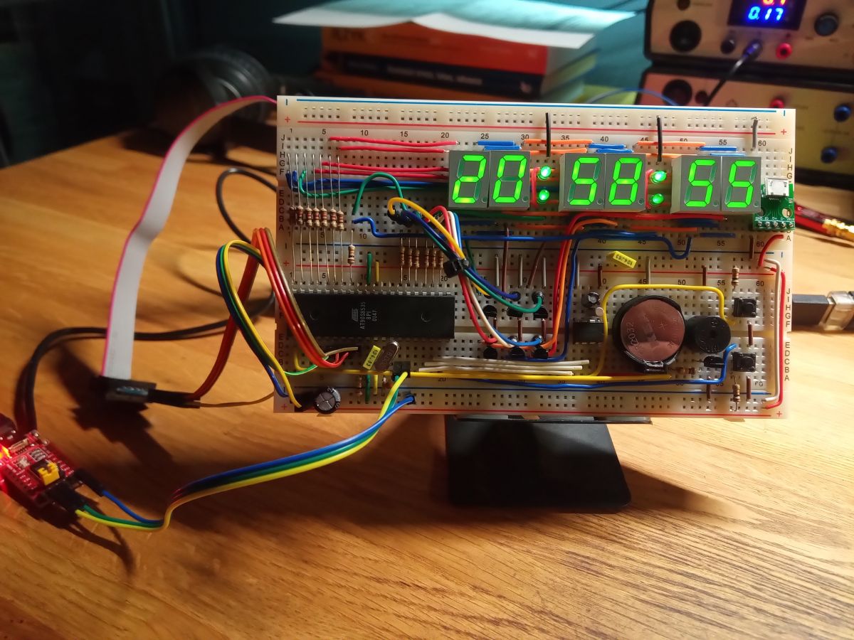

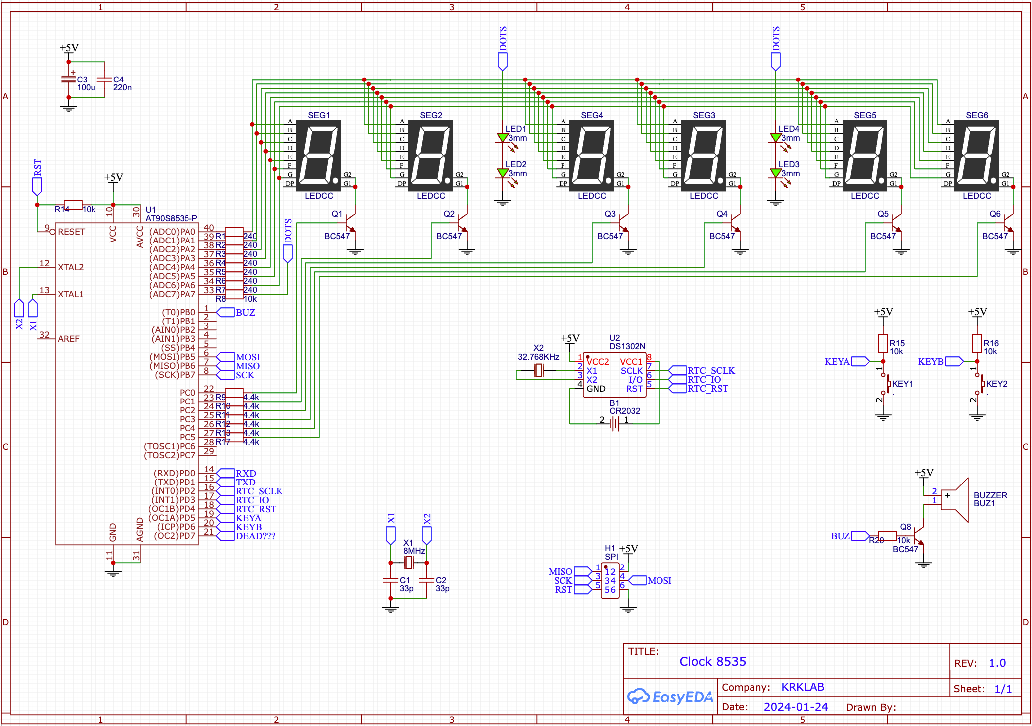

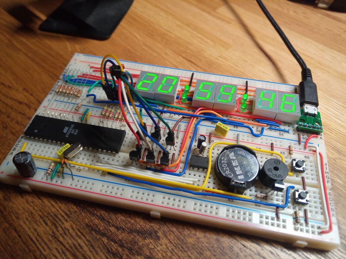

  • Breadboard LED vintage watch à la 90s uses an AT90S8535 microcontroller and a DS1302 RTC.
  • The AT90S8535 gets and sets time from the DS1302, then drives a multiplexed display with a 1 ms timer interrupt and 200 µs segment lighting.
  • The build uses an 8 MHz quartz, and uploading a 4 kB program takes almost 6 minutes with a USBASP programmer.
  • The finished watch has found a place of honor on the shelf and shows the time.
  • Design "for fun", vintage watch à la 90s, made on a contact plate. A gadget perfect for the shelf. :)
    I had an AT90S8535 controller in stock, and since I recently returned to programming, I decided to use it for something useful. The once exorbitant 8 kB of flash on board is rather different from today`s standards, and it is so slow that uploading a 4 kB program takes almost 6 minutes using the USBASP programmer.
    DIY 90s-style clock on a breadboard with an LED display. Breadboard with electronic components forming a 90s-style vintage clock. Electronic schematic of a retro-style clock on a breadboard.
    The construction is quite standard. The controller`s task is to get/set the time from the RTC clock (DS1302) and control the multiplexed display. The control is based on a timer that generates an interrupt every 1 ms with an 8 MHz quartz. The interrupt procedure turns off and on the next segment and keeps the light on for 200 µs. The main loop deals with data retrieval, button and beeper control.
    Basically, I made the project as a training and reminder of AVR programming in C, while the assembly on a breadboard involves a bit of modeling to make it work and look good. :)
    The watch has found a place of honor on the shelf and does its job - it shows the time. ;)

    I wonder how long this watch will work without failure on the contact board. Congratulations on installing this system :)

    In the 1990s, contact sheets were not used, they used universal ones.

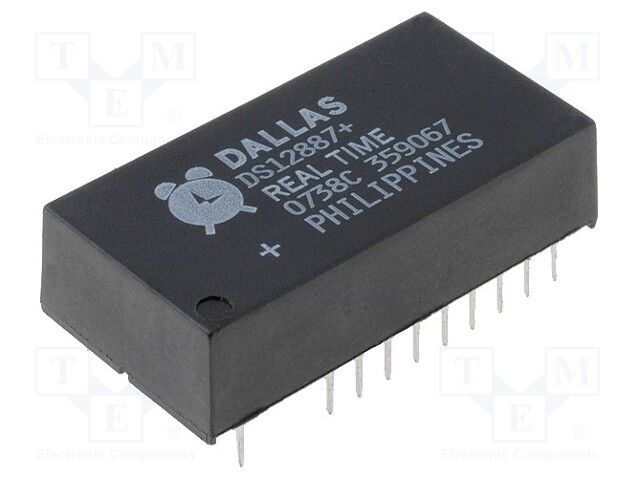

    Nevertheless, it would be better to solder it even on a universal machine, and if it is "vintage", add some period elements if they are to be visible, e.g. this DS would look nice here:
    Black Dallas DS12887 integrated circuit with visible pins.

    If electronics can look nice, it`s probably in this form. These colorful cables seem to be doing the job here.
    Just three things. It would be necessary to lay these cables from the transistors to the display cathodes on the substrate/board and add a photosensitive element to control the brightness of the LEDs under the lighting,
    and cover it in some plexiglass to protect it. To prevent corrosion of the contacts, you can spray some technical Vaseline. and enclose it in plexiglass :)
    maliniak80 wrote:
    This DS would look nice here:
    If these clocks were, for example, pistachio and not black, it would be perfect, but it would spoil the picture.

    I personally like it on the breadboard and respect it for cramming it onto the breadboard :) It is aesthetically made, that`s the most important thing.

    @_._ what is the deviation from the synchronized time over a month/year? From what I remember, the ISP programmer on LPT did not take so long to load these programs.
  • #9 20962745
    _._
    Posts: 46
    Rate: 247
    It hasn`t worked for that long, but it has already made a difference of a few seconds, so it`s probably not the most accurate, but it`s still pleasing to the eye.
