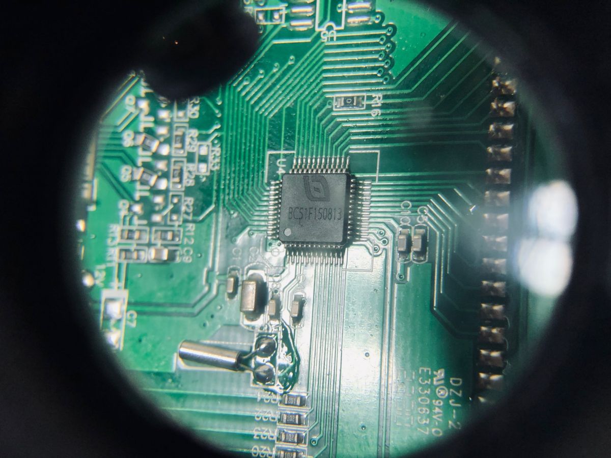

    I purchased a MOES BHT-002-GCLW version v4 thermostat hoping to upload Tasmota.
    It turned out that there is a TUYA CB3S BK7231N chip inside.
    Printed circuit board of MOES BHT-002-GCLW thermostat with TUYA CB3S BK7231N chip.
    With the BK7231Flasher program I read the contents (details attached), having previously soldered out the two components marked in red in the picture, without this it did not work.
    The thermostat is managed by the MCU from the picture below:
    Close-up of a circuit board with a BCSF1508 chip and other electronic components.
    Question to the experts: can I sflash this device with OpenBK software without dire consequences ?
    Thank you and regards

    This device is based on TuyaMCU. OpenBeken supports devices with TuyaMCU at a fairly good level, but you need to know the dpID of the variables you want to support. Then again, it's the same with Tasmota. Without knowing which dpID is which variable you won't get started.
    This topic about TuyaMCU:
    https://www.elektroda.pl/rtvforum/topic3880546.html
    You need to either find the documentation of this device e.g. for Tasmota (maybe the dpIDs match the version on BK), or on the dev account of Tuya approach what dpIDs are there (I've never done it this way, but it was mentioned on the forum) or capture the dpID e.g. with my analyzer:
    https://github.com/openshwprojects/TuyaMCUAnalyzer
    Then in OpenBeken you map dpID to channels and script anything you want.

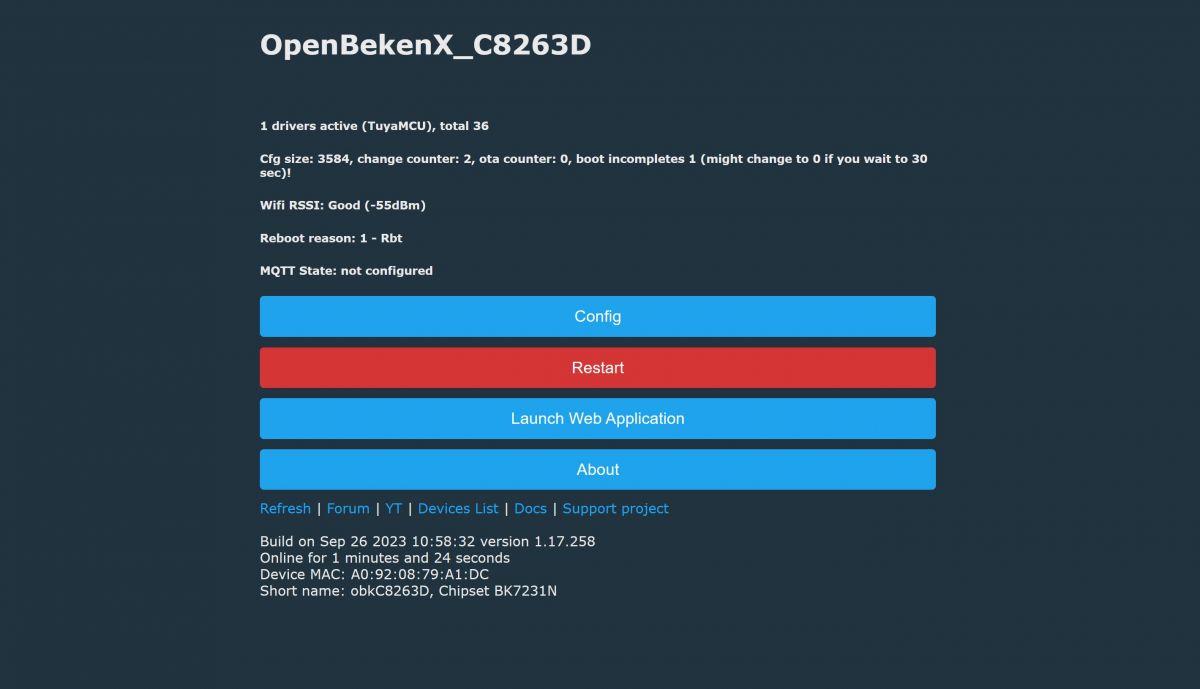

  • #16 20748487
    tomik67
    Posts: 111
    Rate: 11
    I'm trying to upload OBK but it won't start, I guess I'll have to solder these two components again.
    I succeeded but after re-soldering the components
    OpenBeken interface screen with buttons and device information.
    Now they are back in place.
    These commands I fired in Execute custom command, is that right or were they supposed to be in Startup command ?
    First logs attached.
    • first_log.txt (7.97 KB) You must be logged in to download this attachment.

  • MCU communication works after upload
    #18 20748639
    tomik67
    Posts: 111
    Rate: 11
    I have completed the previous post.
    After the successful upload, can I already unsolder the wires from the CB3S or will they still be needed?
    Communication with the MCU works:
    Info:TuyaMCU:TUYAMCU received: 55 AA 01 07 00 08 03 02 00 04 00 00 00 28 40
    Info:TuyaMCU:TuyaMCU_ProcessIncoming[ver=1]: processing command 7 (State) with 15 bytes
    Info:TuyaMCU:TuyaMCU_ParseStateMessage: processing dpId 3, dataType 2-DP_TYPE_VALUE and 4 data bytes
    Info:TuyaMCU:TuyaMCU_ParseStateMessage: raw data 4 int: 40
    Debug:TuyaMCU:TuyaMCU_ApplyMapping: id 3 with value 40 is not mapped
    Info:TuyaMCU:TUYAMCU received: 55 AA 01 07 00 08 66 02 00 04 00 00 00 F8 73
    Info:TuyaMCU:TuyaMCU_ParseStateMessage: processing dpId 102, dataType 2-DP_TYPE_VALUE and 4 data bytes
    Info:TuyaMCU:TuyaMCU_ParseStateMessage: raw data 4 int: 248
    Debug:TuyaMCU:TuyaMCU_ApplyMapping: id 102 with value 248 is not mapped

    #19 20748861
    Posts: 14797
    Rate: 12954
    Now you need to map the dpID to OBK channels. Wires are unlikely to be needed.
    Start with:
    1 - enable-disable
    startDriver TuyaMCU
    tuyaMcu_defWiFiState 4
    setChannelType 1 toggle
    setChannelLabel 1 OnOff
    // linkTuyaMCUOutputToChannel dpId verType tgChannel
    Then add:
    # Włączenie trybu Energy saving.:
    Type Bool Values 0,1
    Received by WiFi module:
    55 AA	00	06		00 05	0501000101	12									//R 25.09.2023 11:25:51 WiFi received:
    HEADER	VER=00	SetDP		LEN	dpId=5 Bool V=1		CHK						55AA00060005050100010112
    That is, we have:
    startDriver TuyaMCU
    setChannelType 2 toggle
    setChannelLabel 2 EnergySaving
    linkTuyaMCUOutputToChannel 5 bool 2
    Test to see if what I gave works. And now I think I need to add a special channel type for this device. Do I see it correctly:
    # Zmiany temperatury od 5*C do 35*C co pół stopnia.:
    Type Val, Values min=10 max=67
    55 AA	00	06		00 08	020200040000000A	1F
    HEADER	VER=00	SetDP		LEN	dpId=2 Val V=10		CHK
    55 AA	00	06		00 08	020200040000000B	20
    HEADER	VER=00	SetDP		LEN	dpId=2 Val V=11		CHK
    10 corresponds to 5C, and 11 is 5.5C? I have not encountered this yet, I will add to the firmware of this support immediately.
  • #20 20748901
    tomik67
    Posts: 111
    Rate: 11
    Yes, here these values are doubled temperature.
    This is certainly a silly question but since I have with OBK as well as with Tasmota only the first experience, where should I enter these commands ?.
  • #21 20749460
    Posts: 14797
    Rate: 12954
    autoexec.bat is created in LittleFS:
  • Energy saving mode maps to dpId 2 and 5
    #22 20749698
    tomik67
    Posts: 111
    Rate: 11
    Both commands work perfectly.
    This is what it looks like in the logs:
    Energy saving OFF. :
    Info:MQTT:Channel has changed! Publishing 0 to channel 2
    Info:TuyaMCU:TUYAMCU received: 55 AA 01 07 00 08 02 02 00 04 00 00 00 32 49
    Info:TuyaMCU:TuyaMCU_ParseStateMessage: processing dpId 2, dataType 2-DP_TYPE_VALUE and 4 data bytes
    Info:TuyaMCU:TuyaMCU_ParseStateMessage: raw data 4 int: 50
    Info:TuyaMCU:TUYAMCU received: 55 AA 01 07 00 05 05 01 00 01 00 13
    Info:TuyaMCU:TuyaMCU_ProcessIncoming[ver=1]: processing command 7 (State) with 12 bytes
    Info:TuyaMCU:TuyaMCU_ParseStateMessage: processing dpId 5, dataType 1-DP_TYPE_BOOL and 1 data bytes
    Info:TuyaMCU:TuyaMCU_ParseStateMessage: raw data 1 byte:
    Info:GEN:No change in channel 2 (still set to 0) - ignoring
    Energy saving ON.:
    Info:MQTT:Channel has changed! Publishing 1 to channel 2
    Info:TuyaMCU:TUYAMCU received: 55 AA 01 07 00 08 02 02 00 04 00 00 00 28 3F
    Info:TuyaMCU:TUYAMCU received: 55 AA 01 07 00 05 05 01 00 01 01 14
    Info:GEN:No change in channel 2 (still set to 1) - ignoring
    OnOff ON.:
    Info:MQTT:Channel has changed! Publishing 1 to channel 1
    Info:TuyaMCU:TUYAMCU received: 55 AA 01 07 00 05 01 01 00 01 01 10
    Info:TuyaMCU:TuyaMCU_ParseStateMessage: processing dpId 1, dataType 1-DP_TYPE_BOOL and 1 data bytes
    Info:GEN:No change in channel 1 (still set to 1) - ignoring
    OnOff OFF.:
    Info:MQTT:Channel has changed! Publishing 0 to channel 1
    Info:TuyaMCU:TUYAMCU received: 55 AA 01 07 00 05 01 01 00 01 00 0F
    Info:GEN:No change in channel 1 (still set to 0) - ignoring
    Added after 3 [hours] 39 [minutes]:
    I added two switches to myself as a test, a Button Lock and a Manual/Programmable Mode switch.:
    startDriver TuyaMCU
    setChannelType 3 toggle
    setChannelLabel 3 ButtonLock
    setChannelType 4 toggle
    setChannelLabel 4 ManualMode
    linkTuyaMCUOutputToChannel 6 bool 3
    linkTuyaMCUOutputToChannel 4 bool 4
    While the lock works, the Manual/Programmable Mode does not. Maybe because of the variable type "Enum".
    When I started Programmable Mode manually in the logs it showed this:
    Info:TuyaMCU:TUYAMCU received: 55 AA 01 07 00 05 04 04 00 01 00 15
    Info:TuyaMCU:TuyaMCU_ParseStateMessage: processing dpId 4, dataType 4-DP_TYPE_ENUM and 1 data bytes
    Info:GEN:CHANNEL_Set channel 4 has changed to 0 (flags 0)
    Info:MQTT:Channel has changed! Publishing 0 to channel 4
    After manually re-enabling Manual Mode I got this:
    Info:TuyaMCU:TUYAMCU received: 55 AA 01 07 00 05 04 04 00 01 01 16
    Info:GEN:CHANNEL_Set channel 4 has changed to 1 (flags 0)
    Info:MQTT:Channel has changed! Publishing 1 to channel 4

    The relay status works flawlessly.
    I have a related question:
    When I turn on power save mode it shows in the logs :
    Info:GEN:CHANNEL_Set channel 5 has changed to 0 (flags 0)
    ...and MQTT publishes.:
    Info:MQTT:Channel has changed! Publishing 0 to channel 5
    Why is it that when the MCU reports the current temperature, MQTT similarly does not bother to publish that information ?:
    Info:TuyaMCU:TUYAMCU received: 55 AA 01 07 00 08 03 02 00 04 00 00 00 2A 42
    Info:TuyaMCU:TuyaMCU_ParseStateMessage: raw data 4 int: 42
    Debug:TuyaMCU:TuyaMCU_ApplyMapping: id 3 with value 42 is not mapped
    ...or at least there is nothing about it in the logs.
