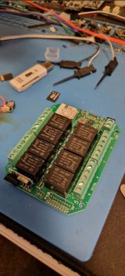

Experience with LLXLJY 8-Channel Tuya Switch and OBK Compatibility?
io2345 8391 115
Can the LLXLJY 8-channel Tuya switch be used with OBK, and how should it be flashed or configured?
Yes — the LLXLJY box turned out to be a BK7231N TuyaMCU device, so OBK compatibility is realistic; for flashing/backing up, choose BK7231N, and one user found that leaving the 3.3 V line disconnected during readback helped because the board was already powered via RX [#21212778 #21218438 #21218602]. OBK support became workable after newer TuyaMCU handling was added: the device uses relays on DPs 1–6 and 101/102, and with `tuyaMcu_setBaudRate 9600`, `tuyaMcu_defWiFiState 4`, `setChannelType ... Toggle`, and `linkTuyaMCUOutputToChannel ... bool ...` the eight relays could be toggled normally [#21223289 #21246749 #21247143]. The sticking point was TuyaMCU status handling (the 0x22 status-report path); once OBK learned to reply properly, relay control started behaving as expected [#21228786 #21229901 #21240579 #21245009]. If the relays behave linked or inverted, the original Tuya interlock settings are still likely stored, so resetting back to Tuya and clearing those settings fixed it for the user [#21247189 #21247345]. The RF remote is not learned in the app; pairing is done by pressing the onboard button five times quickly, then binding each remote button one by one [#21264721]

    Let's try this autoexec and report back if possible with log as well.
    startDriver TuyaMCU
    setChannelType 1 Toggle
    SetChannelLabel 1 "Room 1"
  • Tuya MCU sends unhandled cmd 34 frames

    Thank you for your patience. Sadly, the result is the same:
    A 03 22 00 28 01 01 00 01 01 02 01 00 01 00 03 01 00 01 00 04 01 00 01 00 05 01 00 01 00 06 01 00 01 00 65 01 00 01 00 66 01 00 01 00 3D
    Info:TuyaMCU:ProcessIncoming[v=3]: cmd 34 (Unknown) len 47

    Funny enough, there are still eight controls in the Interface, only the names of the others changed to "Toggle #"- and there is no reaction on the relays when pressing them, only the color changes. (To be precise, there are even nine controls, as there is a "Toggle 0" as well).

    If your buttons are staying on the index page like that you should try rebooting your device and check again.
    You seeing actions being done and buttons changing colors that means that OBK is trying to do something and since the output of that device is unusual (at least to me right now) there is something we are missing.
    I'll try the dump you provided to see if there is something obvious from there but you would have to be patient about that for some time.

    Thank you so much. Of course I did power the device off/on and did several reboots as well. Next, I will try to reset it to factory and check, if anything has changed.
    Hinzugefügt nach 11 [Minuten]:
    After the factory reset the other controls are gone, but "Room 1" is still present. The autoexec.bat survived the reset, it is still there. But the behaviour did not change: Switch relay on works, switching off doesn't.

    @io2345 I am expecting this device next week so please be patient as that command is clearly not yet supported fully as we didn't encounter it before.
  • Tuya switch datapoints mapped to dp_id 1–5

    So, let's start to find out more details (hopefully):
    Starting with device recently powered up and SmartLife App connected. Most basic function is switching relays on and off:

    Next is the response after Relais 7 (I chose just any) is activated:

    And now relay 7 is switched off again:

    Update!
    WiFi module with relays on a blue service mat
    It will have to wait until I manage to steal some time from somewhere or next weekend.

    I've checked with @DeDaMrAz and concluded that we need to parse 0x22 packet data which seems to be the same as 0x07 packet data:
    https://github.com/openshwprojects/OpenBK7231...mmit/1dfd42f1b303751a1fabc56b2b662801641dd1a3
    We're testing
