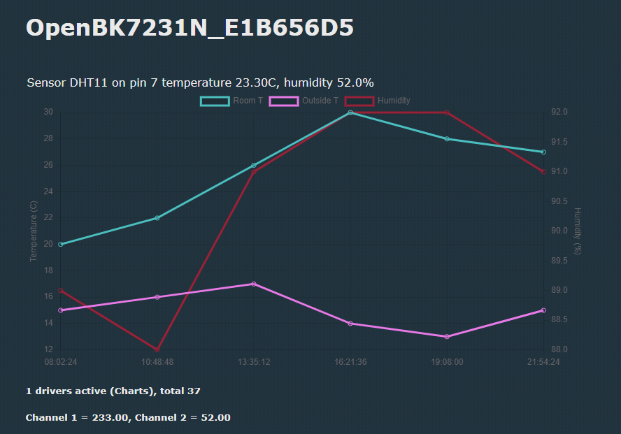

  • Charts driver supports multiple variables and axes

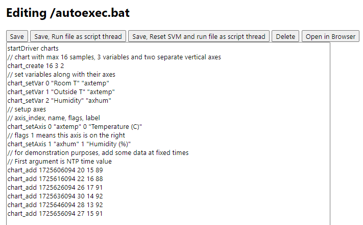

    #6 21222608
    Posts: 14770
    Rate: 12912
    @divadiow are you able to get any OBK platform device with DHT11 or anything working for some tests?
    https://github.com/openshwprojects/OpenBK7231T_App/blob/main/src/driver/drv_charts.c
    Added after 3 [minutes]:

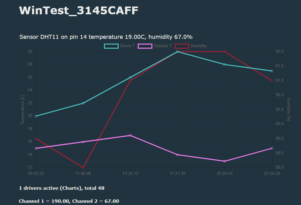

    This:
    startDriver charts
    // chart with max 16 samples, 3 variables and two separate vertical axes
    chart_create 16 3 2
    // set variables along with their axes
    chart_setVar 0 "Room T" "axtemp"
    chart_setVar 1 "Outside T" "axtemp"
    chart_setVar 2 "Humidity" "axhum"
    // setup axes
    // axis_index, name, flags, label
    chart_setAxis 0 "axtemp" 0 "Temperature (C)"
    // flags 1 means this axis is on the right
    chart_setAxis 1 "axhum" 1 "Humidity (%)"
    // for demonstration purposes, add some data at fixed times
    // First argument is NTP time value
    chart_add 1725606094 20 15 89
    chart_add 1725616094 22 16 88
    chart_add 1725626094 26 17 91
    chart_add 1725636094 30 14 92
    chart_add 1725646094 28 13 92
    chart_add 1725656094 27 15 91
    gives:
    Chart displaying indoor and outdoor temperature and humidity data from a DHT11 sensor.

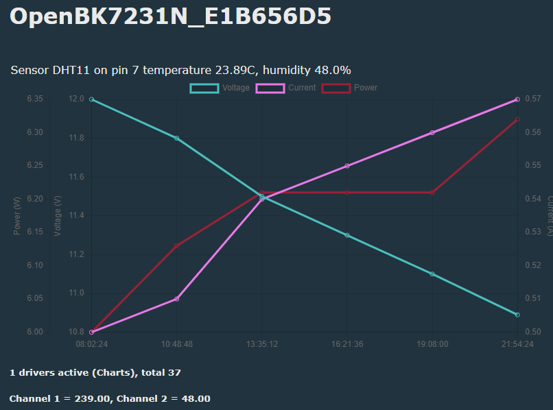

    This:
    startDriver charts
    // chart with max 16 samples, 3 variables and 3 separate vertical axes

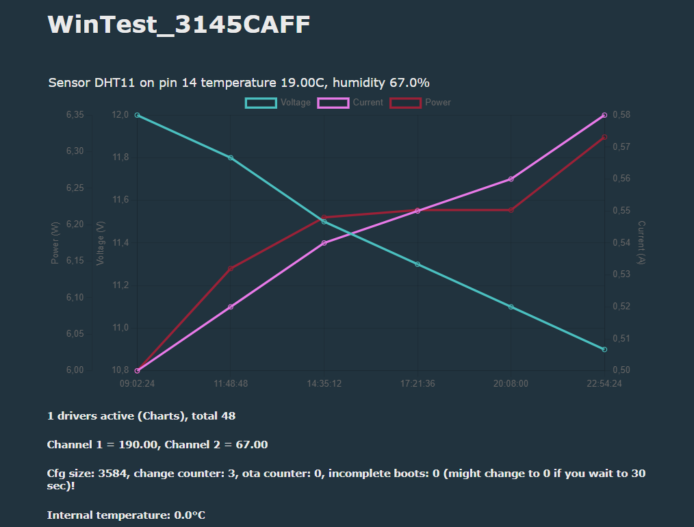

    chart_create 16 3 3
    chart_setVar 0 "Voltage" "axvolt"
    chart_setVar 1 "Current" "axcurr"
    chart_setVar 2 "Power" "axpower"
    // setup axes
    chart_setAxis 0 "axvolt" 0 "Voltage (V)"
    chart_setAxis 1 "axcurr" 1 "Current (A)"
    chart_setAxis 2 "axpower" 2 "Power (W)"
    chart_add 1725606094 12 0.5 6
    chart_add 1725616094 11.8 0.52 6.14
    chart_add 1725626094 11.5 0.54 6.21
    chart_add 1725636094 11.3 0.55 6.22
    chart_add 1725646094 11.1 0.56 6.22
    chart_add 1725656094 10.9 0.58 6.32
    gives:
    Chart displaying data on voltage, current, and power over time.

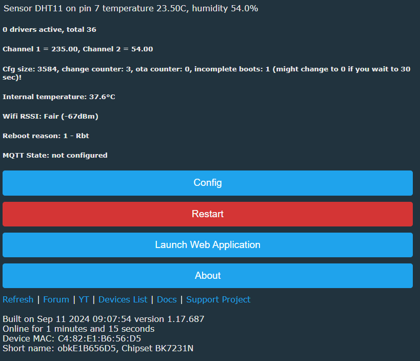

  • #7 21222626
    Posts: 5220
    Help: 449
    Rate: 918
    yes. I see your PRs and the releases but startdriver charts doesn't seem to start
    User interface screen displaying information about DHT11 sensor and configuration options. Text editor window with a script in the /autoexec.bat file containing commands for chart drawing.
  • #8 21222643
    Posts: 14770
    Rate: 12912
    You need to enable it for your platform in obk_config.h
  • #9 21222664
    Posts: 5220
    Help: 449
    Rate: 918
    my bad. assumed it was ready to rock.
    neat.
    Temperature and humidity chart from DHT11 sensor at various locations.

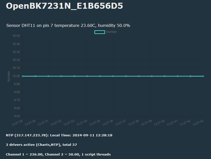

    #10 21222689
    Posts: 14770
    Rate: 12912
    Try this sample, but you need to manually refresh page for it to refresh measurements, not sure why:
    startDriver charts
    startDriver NTP
    //waitFor NTPState 1
    chart_create 16 1 1
    chart_setVar 0 "Number" "ax"
    chart_setAxis 0 "ax" 0 "Number"
    again:
    // EDIT: fixed
    setChannel 5 $rand*0.001
    chart_addNow $CH5
    delay_s 1
    goto again
    or we can try to use a real DHT and capture measurements over a day, idk, one per 15 minutes?
  • Manual refresh needed for chart updates
    #11 21222820
    Posts: 5220
    Help: 449
    Rate: 918
    this in autoexec verbatim gives a single line that does refresh itself but never changes
    Chart from OpenBK7231N app showing a flat line representing an unchanged numerical value.

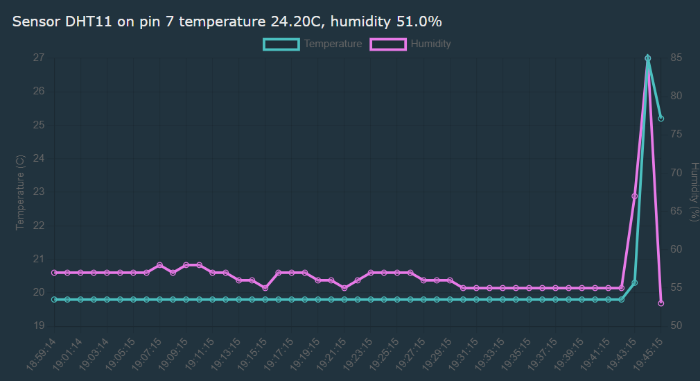

  • IndexRefreshInterval added to reduce auto refresh

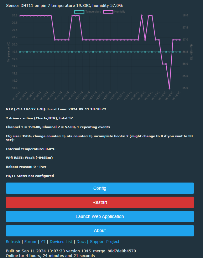

    #12 21222830
    Posts: 14770
    Rate: 12912
    Auto refresh is annoying, I've added IndexRefreshInterval command.
    For now, for DHT11 setup, I'd suggest:
    // Sample 8
    // DHT11 setup
    IndexRefreshInterval 100000
    startDriver charts
    startDriver NTP
    waitFor NTPState 1
    chart_create 48 2 2
    chart_setVar 0 "Temperature" "axtemp"
    chart_setVar 1 "Humidity" "axhum"
    // setup axes
    // every 60 seconds, -1 means infinite repeats
    // assumes that $CH1 is temperature div10 and $CH2 is humidity
    addRepeatingEvent 60 -1 chart_addNow $CH1*0.1 $CH2
    For a start, try with repeating event every 10 seconds or so.
    Take care with number of samples, 48 samples with two variables (and 8 bytes time) it's 48*(4+4+8) = 768bytes

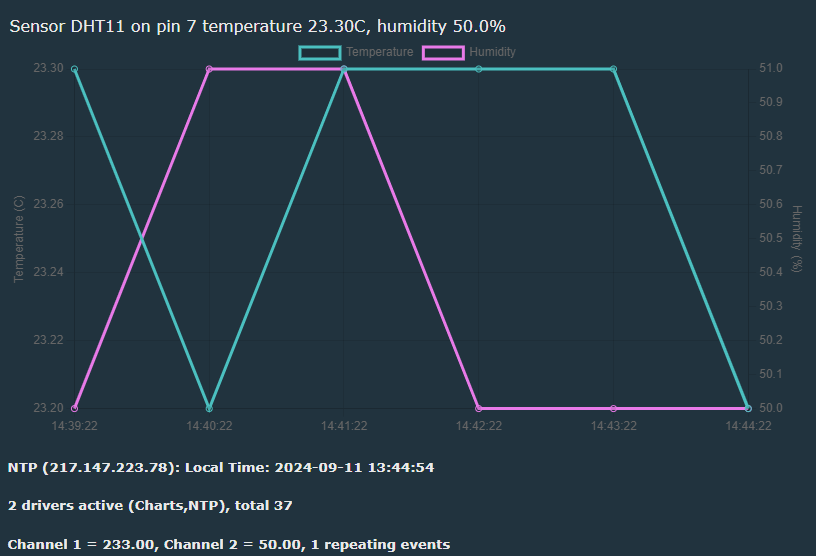

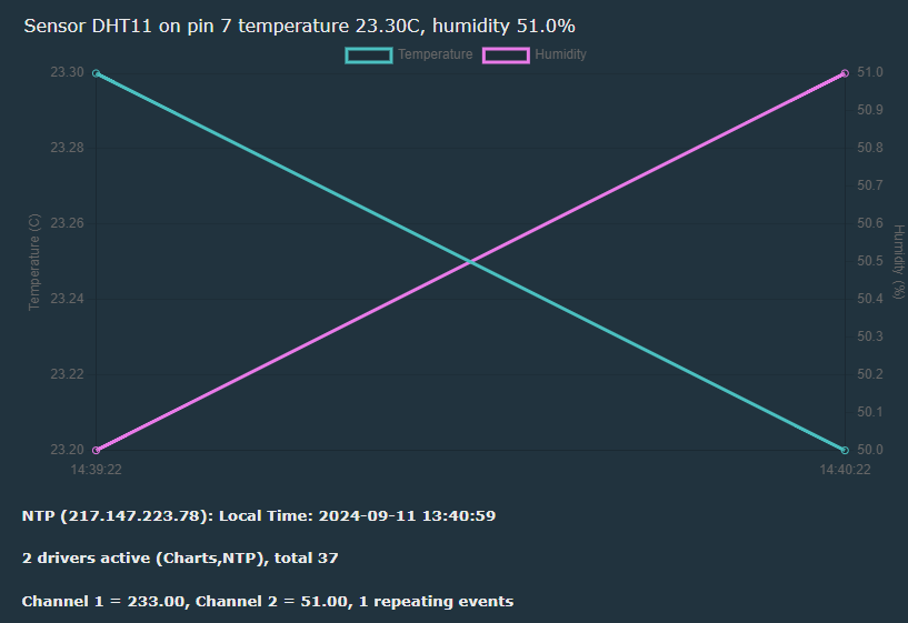

  • #13 21222859
    Posts: 5220
    Help: 449
    Rate: 918
    >>21222830 1345_merge_b0d7de0b4570
    Graph showing temperature and humidity from DHT11 sensor on pin 7: temperature 23.30°C, humidity 51.0%.
    Temperature and humidity chart recorded by DHT11 sensor on pin 7, showing values of 23.30°C and 50.0%.
  • #14 21222948

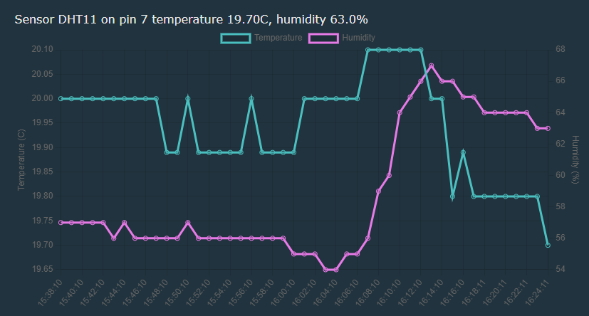

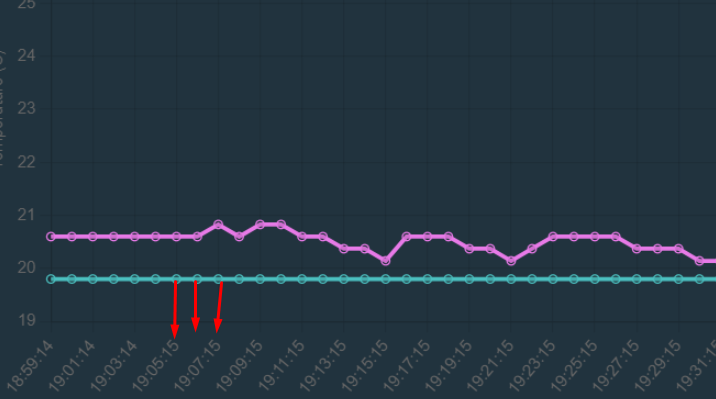

  • DHT22 temperature drift and 2-minute time updates
    #19 21223182
    Posts: 5220
    Help: 449
    Rate: 918
    well. not entirely sure tbh. I don't believe the temperature hasn't changed at all. I'll warm it up a bit
    oh no, it's OK. maybe it has stayed constant. held it in my hands for a while and it climbed to 27
    Graph showing temperature and humidity readings from the DHT11 sensor.
    im about to harvest another CB3S to sit alongside with the DHT22. want any specific setup for that apart from maybe event every 5 or 10 mins?
    also, if it's every 60s, how come the time reading is every ~2mins?
  • 96-sample chart fits in 1.5 kB RAM
    #20 21223280
    Posts: 14770
    Rate: 12912
    Well, with two variables and time, we get 4+4+8 , which is 16 bytes per sample. My sample BK7231 device has currently.... let me check... free 83024 bytes of RAM. Let's say we want a one day of measurements, and measurements every 15 minutes, so it's 24*4 = 96 samples, somewhat 1.5kB memory. Still not much.
    So, set 96 samples in chart_init and change event time to 15 minutes, which is, 15*60=900 seconds.
    Maybe we can already set it for two days, then it will be 192 samples.
    Regarding the timing issue - I have no idea. It seems we may need to check this. But... no, actually it's not every 2 minutes! Take a closer look:
    Line chart showing measurements every 15 minutes with alternate time labels omitted.
    It's just that every second label is skipped. Probably chart determined that it has not enough space for all of them.

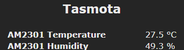

  • DHT11 chart setup with NTP and axes
    #21 21223313
    Posts: 5220
    Help: 449
    Rate: 918
    ah yes :)
    this is running with DHT11 now
    DHT22 doesn't seem to work on the pins I've tried on CB3S or WB3S. I get one reading rarely, then nothing. oh well.
    OK in Tasmota
    Screenshot showing temperature and humidity readings from the AM2301 sensor in Tasmota.
    Added after 8 [hours] 25 [minutes]:
    Graph of temperature and humidity from sensor DHT11 on pin 7, showing temperature 19.10°C and humidity 64.0%.
    and for temp/hum comparison purposes the DHT22 reports similar right now

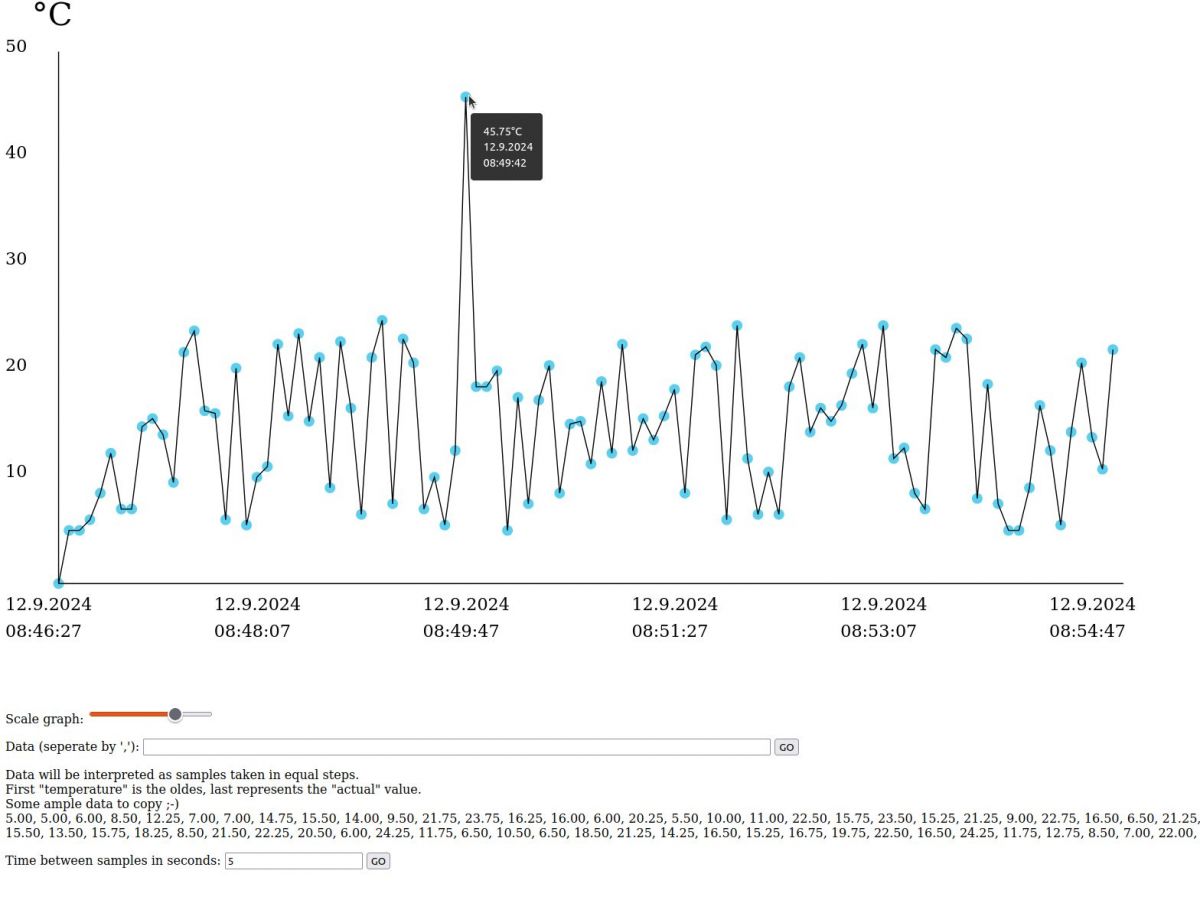

    max4elektroda wrote:
    I'll try to share my first thoughts and ideas tomorrow.
    Sorry, I was busier than expected, first day back from holiday is hard ;-)
    I like the actual possibility,especially because it's open to all sorts of date.
    But still I hope it's ok if I share "my idea", not as far as your working code:
    The actual idea is to keep data to store information as low as possible, that needs to make some hard requirements, which I think are acceptable in many cases.
    - all data is stored periodically with a fixed rate, e.g. every 5 seconds, every minute ...
    - the data is "actual", so we don't need to store timestamps (easily adopted to a slightly "lower constraint", that it's complete (no gaps) and we store the timestamp of the latest data)
    This way we can build our graph with only data and the knowledge of the timestamp of the latest data point.
    Up to now I'm struggling with a first implementation in OpenBeken, but I can give an idea of how it looks and that it's not so demanding related to memory footprint...
    Graph showing temperature changes over time from 12.09.2024, with temperatures measured every few minutes.
    I attached a simple HTML page for that, so you can try it out yourself - feedback highly appreciated ;-)
    (it's without a separate .js file to have only one file - just remove .txt extension, couldn't upload HTML file)
    • draw_graph.html.txt (5.4 KB) You must be logged in to download this attachment.

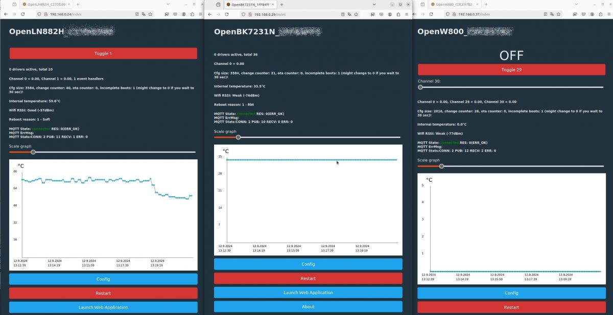

    Finally some result:
    LN882H is really good in powerSaving, on BK-N I see no difference in temperature (but it's much lower anyway) and no gain of information on W800 ;-)
    Screenshots of three interfaces showing data from OpenLN882H, OpenBK7231N, and OpenW800 devices with temperature graphs.

  • HTML chart library with createsvg and draw calls
    #26 21232406
    max4elektroda
    Posts: 758
    Help: 49
    Rate: 189
    An updated version with some kind of a "library".
    The HTML-File shows, how the library can be used:
    Place a <div> on the HTML page where the graph shall be
    call "createsvg" to initialize a graph (arguments are the div-element, size of the image and an id for the image)
    Then call "draw" to actually visualize the data (the argument is an option element, containing the id of the image created in the step before plus information about the data tor draw...
    Attached is again an HTML file, including a minimized JS version and the "full" JS (still with some testing and commented out lines.
    (again: remove .txt to use ;-), it's just to make the attachments possible)
    But with quite some text to explain the calls ...
