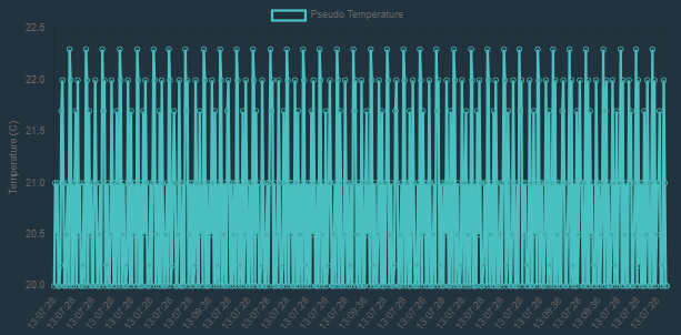

    2a. How high can the first value after Chart_create (for the number of measurement points) be? Is there an upper limit?
    I don't know but I've just started a 600-point chart in the Windows OBK simulator with
    Screenshot of application diagnostics data with a temperature chart.

    Added after 9 [minutes]:
    whatever you set it to the number displayable is still limited though?
    Temperature chart with multiple data points shown as vertical lines.

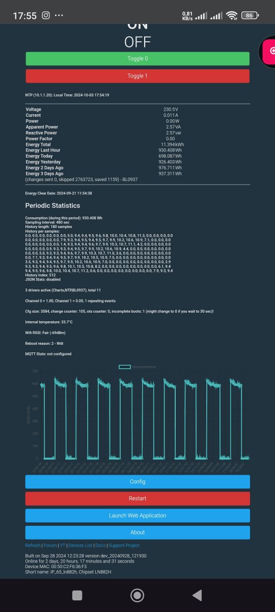

    Update 02.10.
    The Count with 1440 works fine. 😊
    Screenshot of a device's statistical data with chart and detailed energy consumption information.
