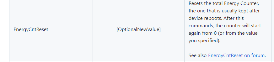

    Dear forum
    Got a BK7231N on a CB2S module, with a BL0937 = energy meter chip.
    I can reset the readings of the BL0937 chip to zero, but what I'd like is to set it to a specific value and let it run from there.
    I use it for monitoring a small set of solar panels, and I already have some 10 months of data. I'd like to preset the 'Energy total' to what it has delivered so far.
    Is this possible?
    Thanks.
    #2 21230060
    Maybe this can help?
    Table with the EnergyCntReset command and its description.
    EnergyCntReset [OptionalVal]
    Resets the total Energy Counter, the one that is usually kept after device reboots. After this commands, the counter will start again from 0 (or from the value you specified).
    Source: https://github.com/openshwprojects/OpenBK7231T_App/blob/main/docs/commands-extended.md
