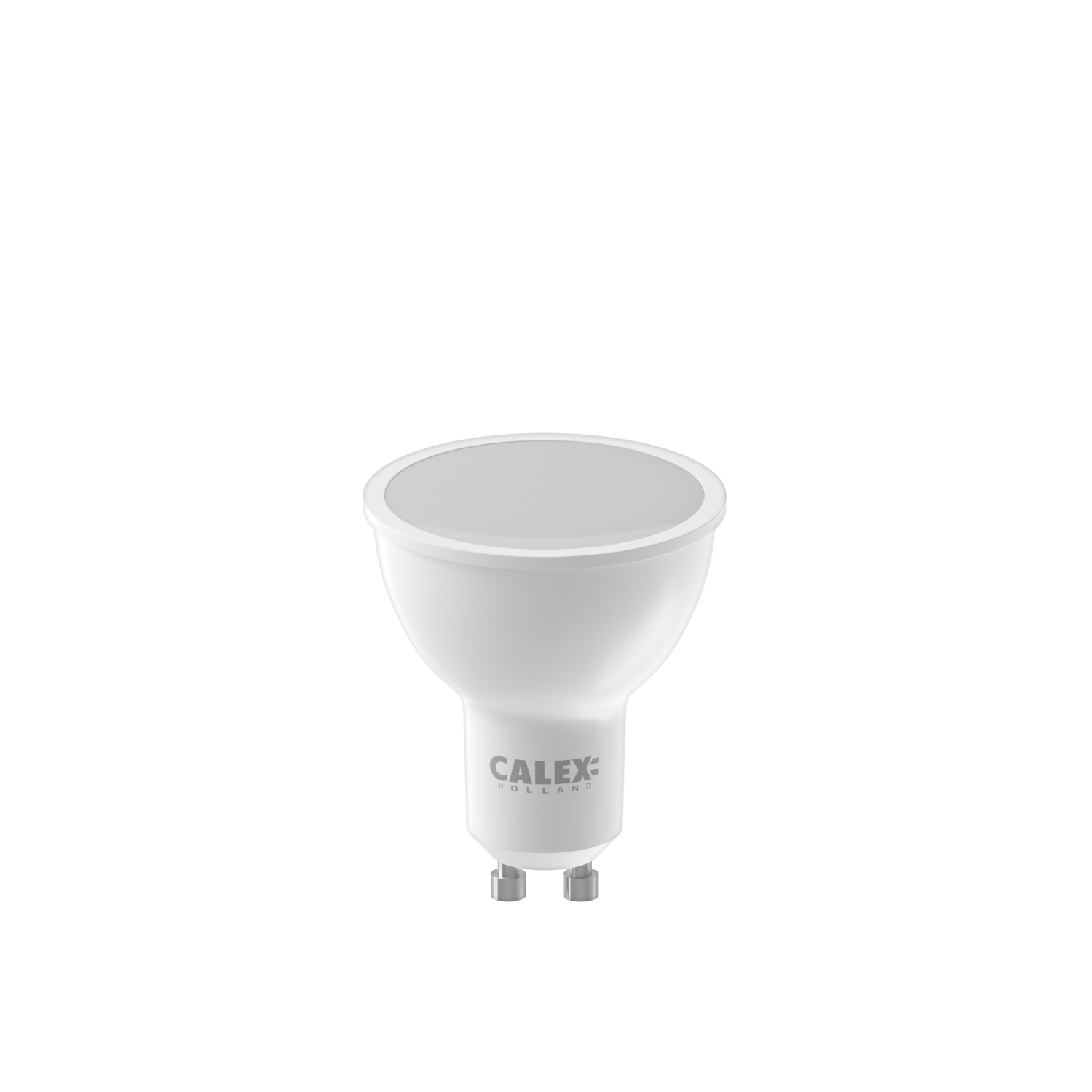

    Packaging of a Calex GU10 smart LED lamp with feature information.
    Calex GU10 smart LED bulb in reflector shape.
    Calex Smart LED Lamp - GU10- Reflector - RGB Warm White - 5W
    Article Number: 429002.2
    - SM2135DAT on P24
    - SM2135CLK on P26
    - LED remap is 1 0 2 4 3
    Device seems to be using WBLC5 module, which is using BK7231T.
    And the Tuya section starts at UNCOMMON POSITION 0
    Flashing OpenBeken
    Used tuya-cloudcutter to flash
