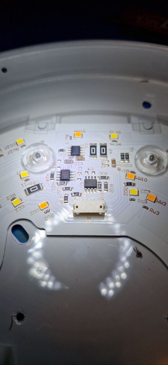

    We remove the diffuser. Inside is a separately large PCB with the LEDs and their drivers:
    Ceiling light 24W Modee MSL-CL24WRGB on BK7231N and SM2235 .

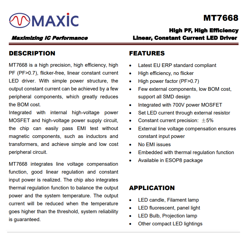

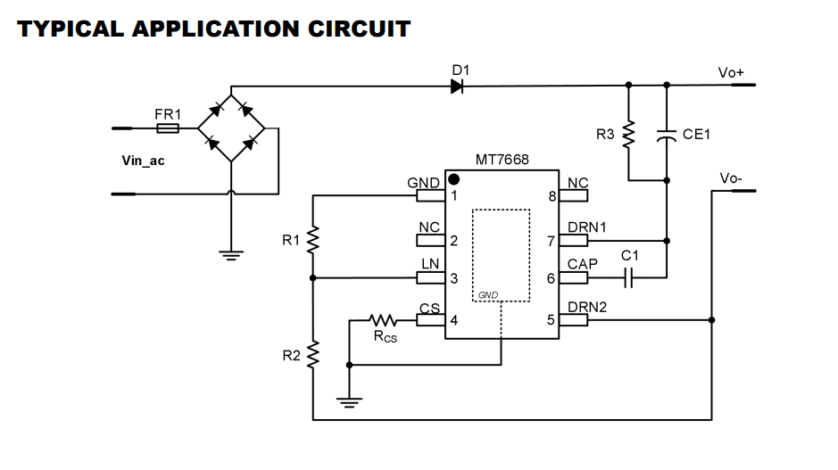

    The MT7668 (two pictured) is a single-channel constant-current LED controller:

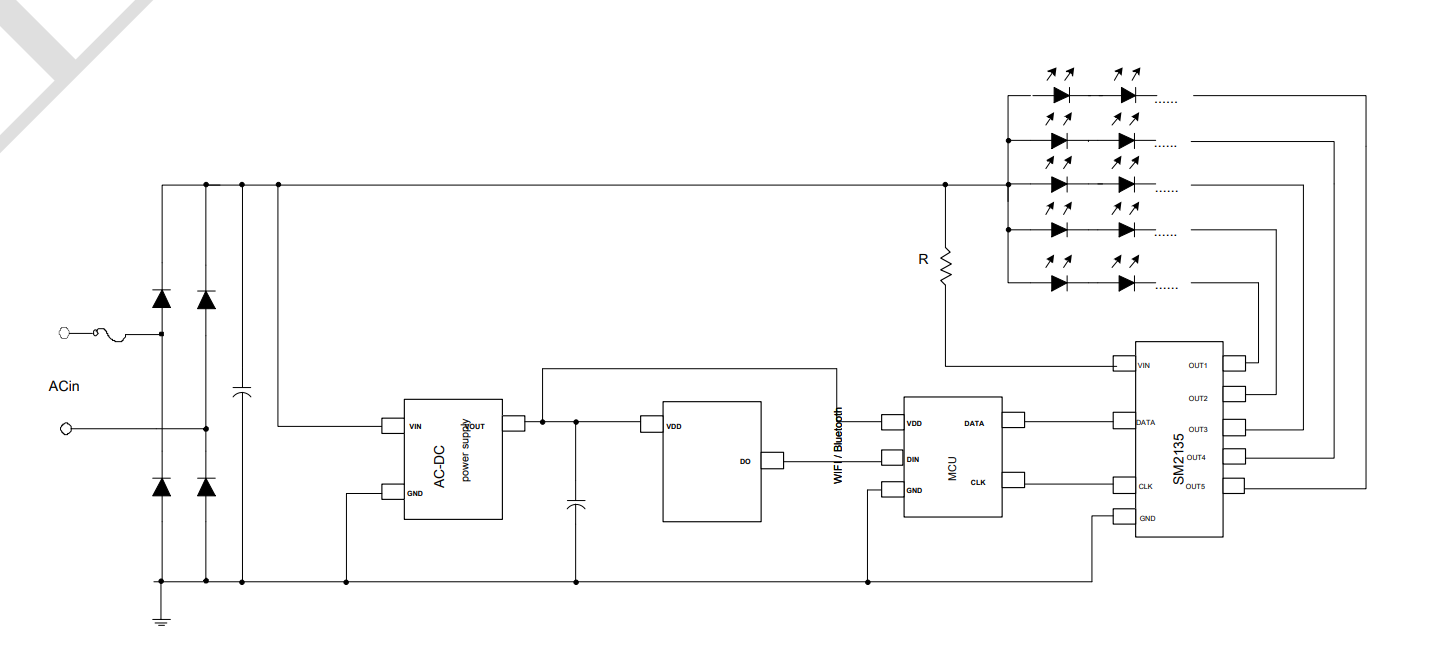

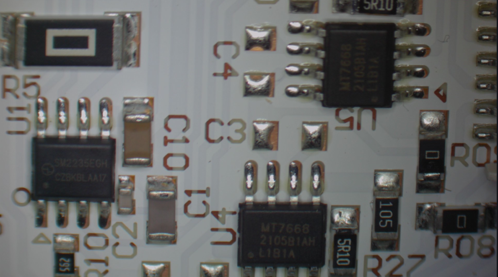

    Next to it is the SM2235, which seems to perform a similar function, it too is a constant-current LED controller but with a two-wire interface:
    It looks like the SM2235 here has separately one MT7668 each for the RGB and CW LEDs, but I haven't analysed how exactly this is connected.

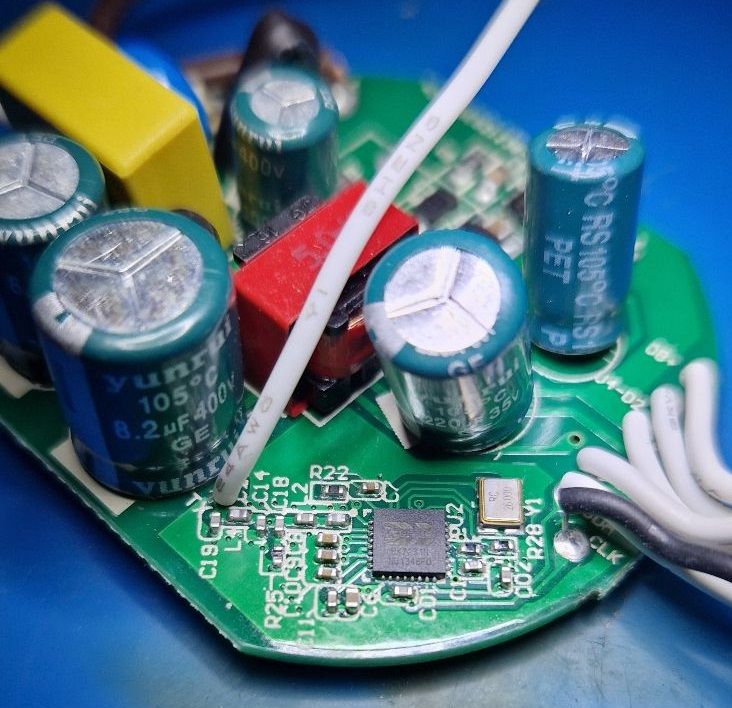

    Separately is the green PCB with the power supply and WiFi chip (BK7231):

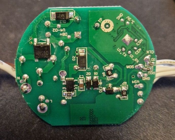

    Firmware change .

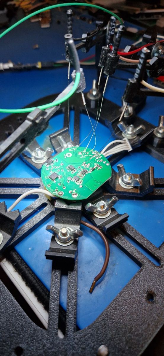

    There are signed test pads on the bottom of the board. The UARTs are for example U1_TX and U1_RX.
    The board with BK7231 on the needle stand - for flashing:
    According to our flasher's instructions:
    All you need is a USB to UART converter.

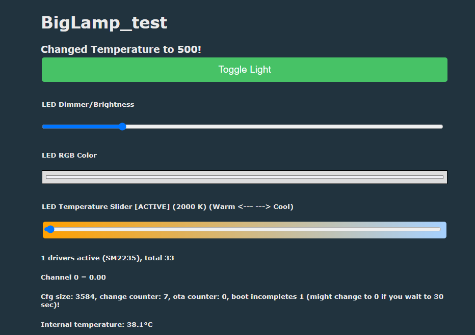

    OpenBeken handles importing this JSON without any problems:
    OpenBeken supports the SM2235 communication protocol and this is fully sufficient to drive this lamp.

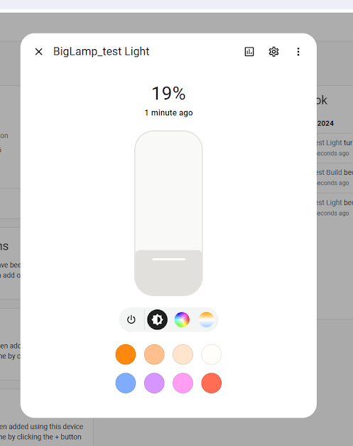

    Pairing with HASS:
    Result:
    The lamp is correctly seen by Home Assistant and you can already remotely control its colours and brightness level.

    Apart from that, we were a bit intrigued by the simultaneous presence of the SM2235 (a constant current controller) and the MT7668 (also I think it's a constant current controller), as why there are both of these chips here at once, but unfortunately the owner of the lamps didn't have the opportunity to analyse further - the wife is waiting and the corridor needs to be lit. If anyone has any ideas why the construction is there and not the other, feel free to share suggestions.
