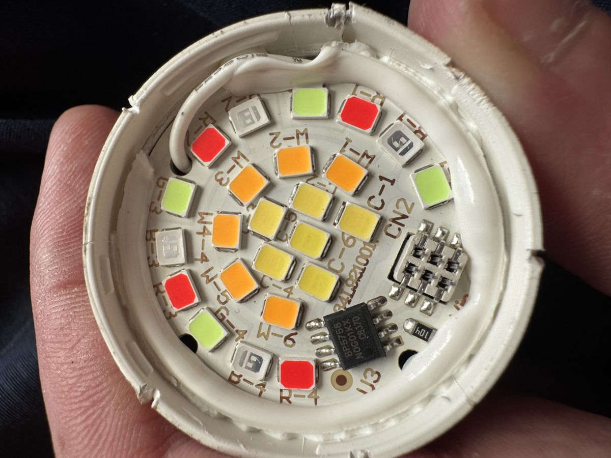

    Clear view of the BP5758

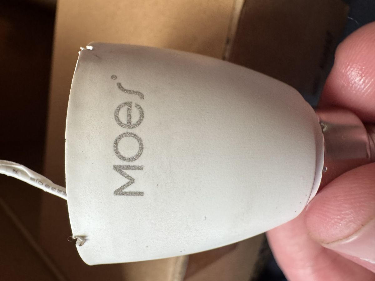

    It was pretty difficult to remove the clear plastic as it seems to snap into place along with being held with glue. I damaged the housing getting it off both times.
    Teardown of Moes bulb showing internal components.

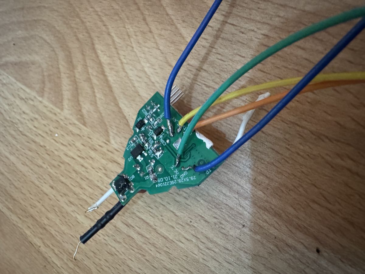

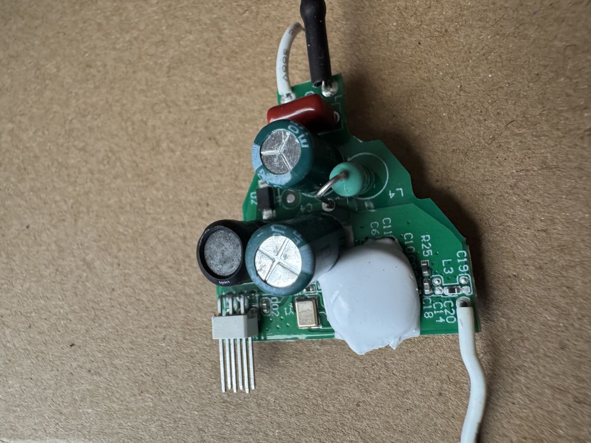

    Fortunately, the serial connections on the back of the board are relatively easy to get to and unobstructed. I was able to solder on wires without even removing it from the housing.
    Interior of Moes 5W candelabra bulb showing the PCB and electronic components.
    The E12 base on these are very thin. If you want to remove the PCB, pry the base off from the bottom. I wouldn't recommend trying to just pull it off.

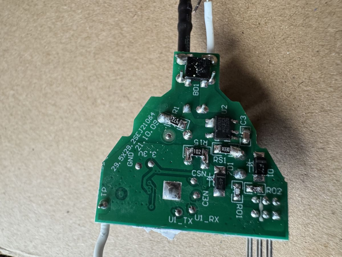

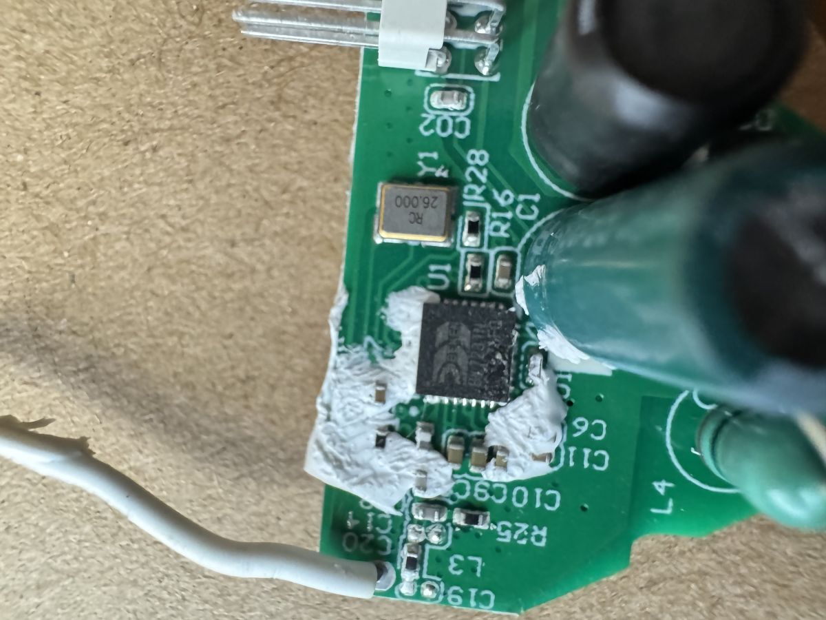

    The BK7231N is hidden under thermal putty.
    Inside Electronics:
    Interior of the Moes candelabra bulb circuit board. Circuit board with BP5758 chip and thermal shield. Details of the PCB in a Moes light bulb
    PCB: 29.5X29.2SEJ21064
    Date Code: 21.10.09
    Programming:
    As I mentioned earlier, the serial connections are relatively easy to access without removing the PCB, so for one I flashed it inside the housing. The second one I removed and soldered 3.3v, GND, U1_TX, U1_RX, and CEN (touch to ground for restart)
    Close-up of a PCB with soldered wires in various colors.
    This was connected to my USB to UART and flashed with OpenBeken 1.17.798

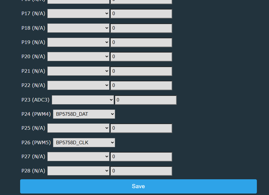

    OpenBeken Setup:
    Setup the pins for the BP5758
    Screenshot of BP5758 pin configuration in OpenBeken.

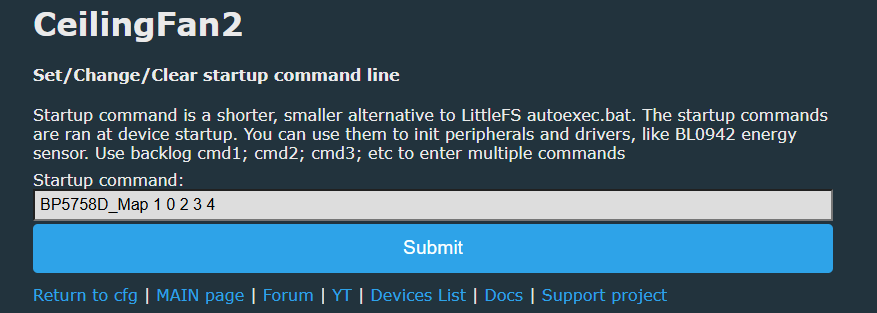

    Finally add the startup command to fix the color mapping
    BP5758D_Map 1 0 2 3 4
    Interface for setting startup command in CeilingFan2

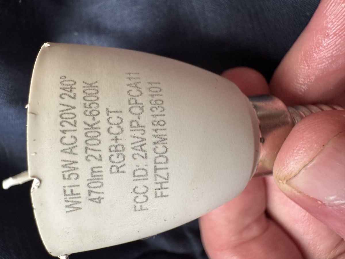

    FCC ID: 2AVJP-QPCA11
    Model: FHZTDCM18136101
    WiFi 5W AC120V 240° 470lm 2700K-6500K RGB+CCT
