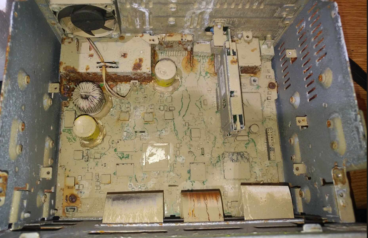

    In my case, the radio (from a Tucson, 2015) was unlikely to be from this year's flood, which doesn't change the fact that after washing the motherboard - it would probably work (better or worse). Condition - it would have had to have had no power from the first seconds. And it probably had power until the battery died.
    Many photos I don't have, but it was roughly covered that nicely:
    Interior of a rusted audio device with visible signs of corrosion. .
    Surprisingly, after washing, it turned out that the I.MX6 processor and its memories were in pretty good shape - the insulating varnish was doing the job. All the flex tapes had signs of corrosion, but none had corroded to the point of being unusable. Unfortunately, one of the inverters from the I.MX - the one that reliably applied voltage all the time - fell off completely when washing the board. The previously mentioned legs of almost all the mosfets in the power supply also fell off.
    Of course, nothing could be done about it. Maybe with a schematic it would have worked, but without - chapel.
    And the amplifier cube circuit also lost one, but only one leg - the rest was in perfect condition :D .
    Oh, the fan works - as the one thing that survived on this board.

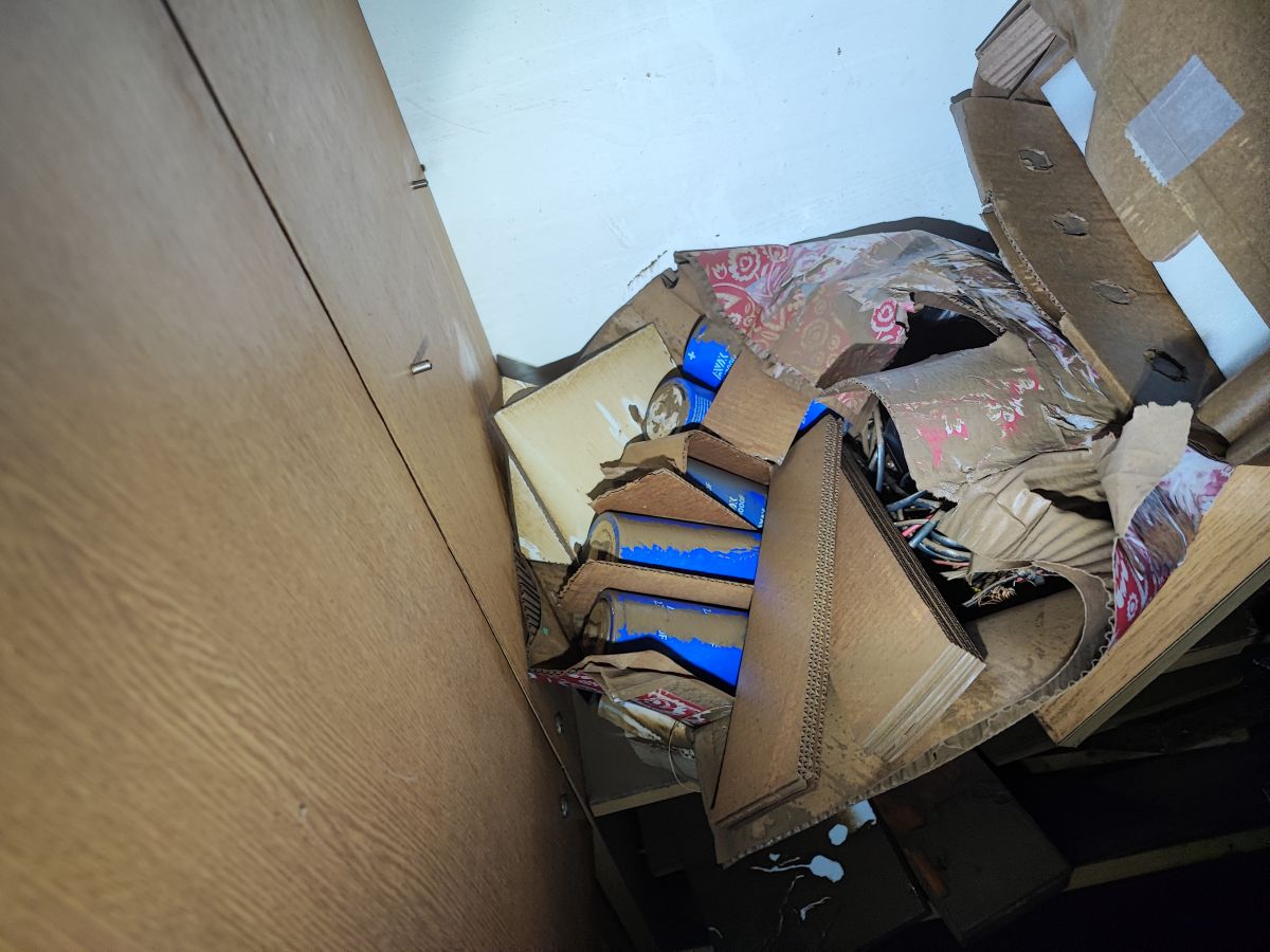

    I would seriously love to showcase some more flooded equipment on the forum, but alas.... my "storage" rooms have all been flooded with water up to the ceiling and are now emptied to 0, even of furniture, and awaiting further cleaning and disinfection. At the moment there is one complete blockage in the flat and no possibility to store anything.
    And literally 100kg has already gone for scrap.... Only pre-cleaned of plastic. So much so, you know, I evacuated most of the more valuable stuff before the wave, only the less valuable stuff and the stuff on the top shelves that I thought wouldn't flood remained (I didn't expect that 60cm above ground level water or whatever it was)

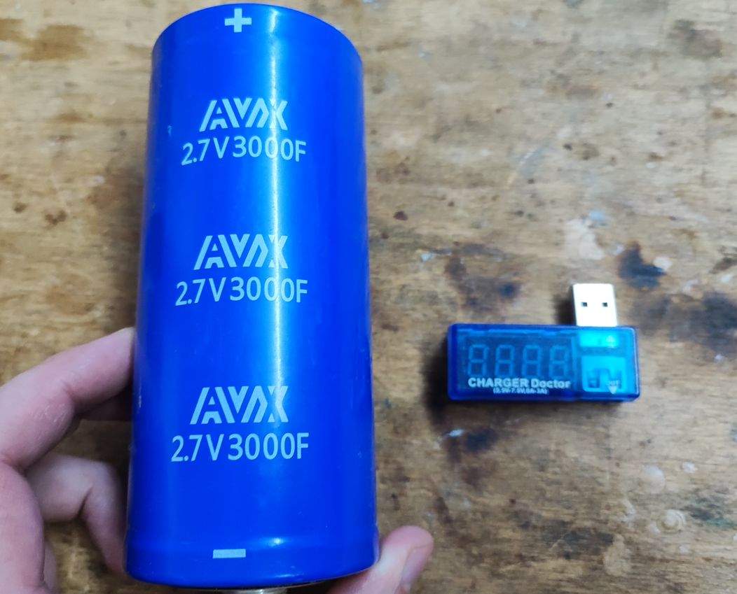

    I kept the most important ones, e.g. here my poor unreviewed 3000F supercapacitors:
    Damaged cardboard boxes with flooded supercapacitors in a room. AVX 3000F supercapacitor next to USB Doctor meter .
    Pictured above, the USB Doctor is for scale.

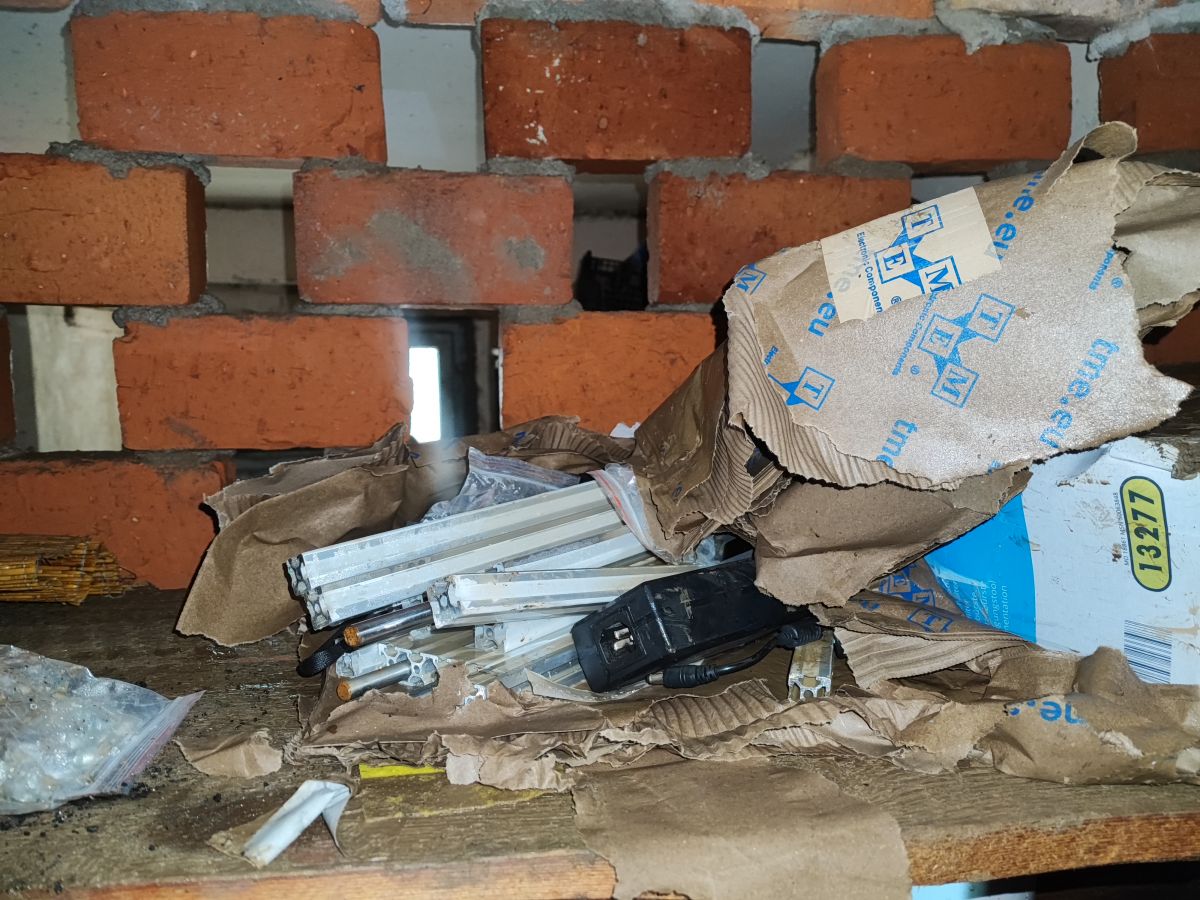

    And here, too, is the yet-to-be-described CNC kit (on the top shelf):
    Exposed brick wall with scattered, damaged cables and paper.
    @Ture11 I haven't yet moved the CNC kit beyond a basic rinse, dry out, because there's simply nowhere to put it together. Time is also unlikely...
    But that's just a little offtopic, and as for the flooded equipment itself, maybe something else will come up on the forum, but not much. Maybe some attempt at power tools.

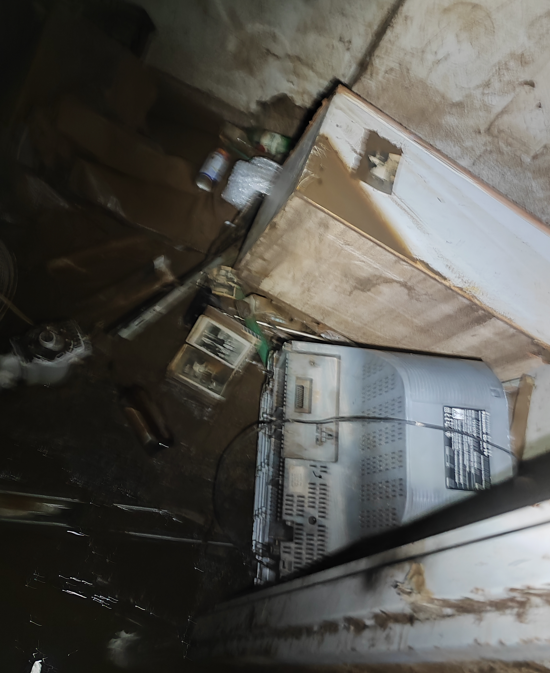

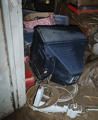

    There were also flooded CRTs but due to the size they were immediately scrapped:
    Flooded room with various items covered in mud and sludge. Old CRT device in a flooded room filled with mud and debris. .

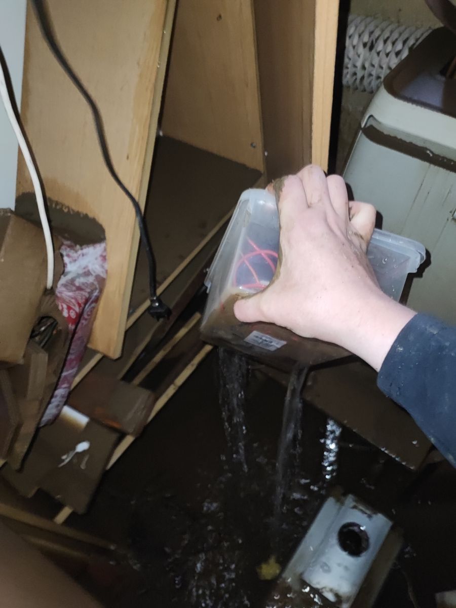

    This is what a room like this looks like after flooding (and the photo shows bad practice - no gloves - but we didn't get them in the gifts until the next day...):
    Flooded storage area with water pouring from a plastic container held by a person. Plastic containers covered in dirt and mud after flooding. .
    It's not just water, it's sludge, slime, everything dirty, furniture dislodged.

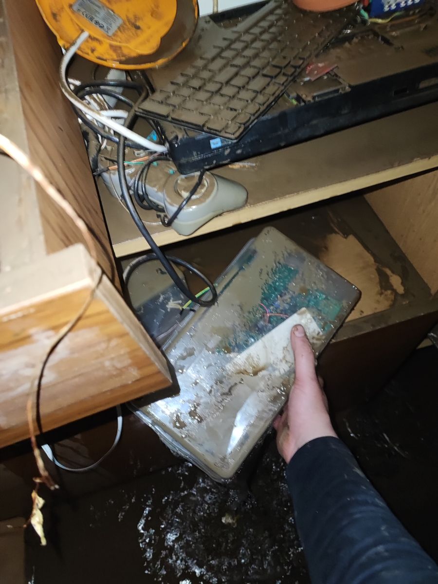

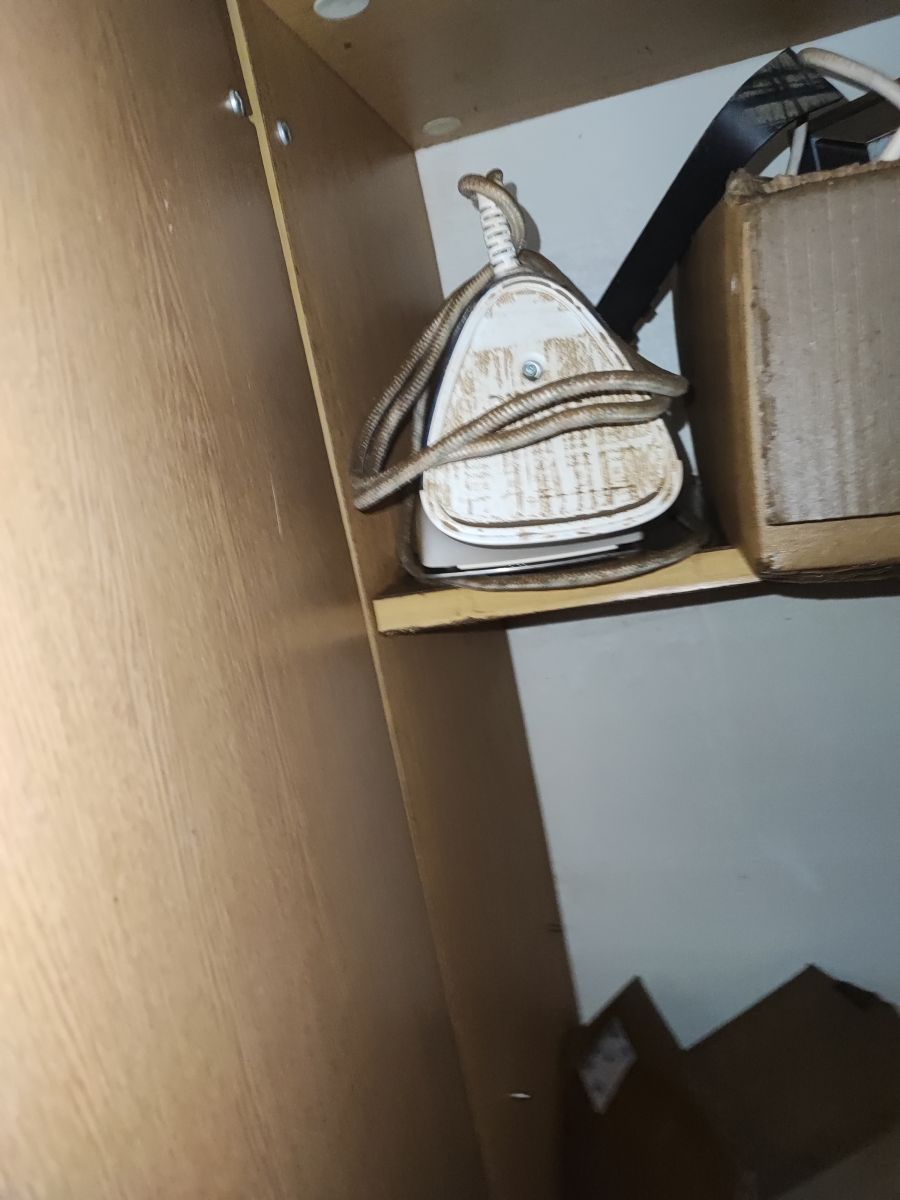

    Old laptops and thermatransfer iron, I didn't play with that either, I deleted it straight away:
    Hand holding flooded electronic equipment in a destroyed and flooded room. Rusty iron on a wooden shelf. .

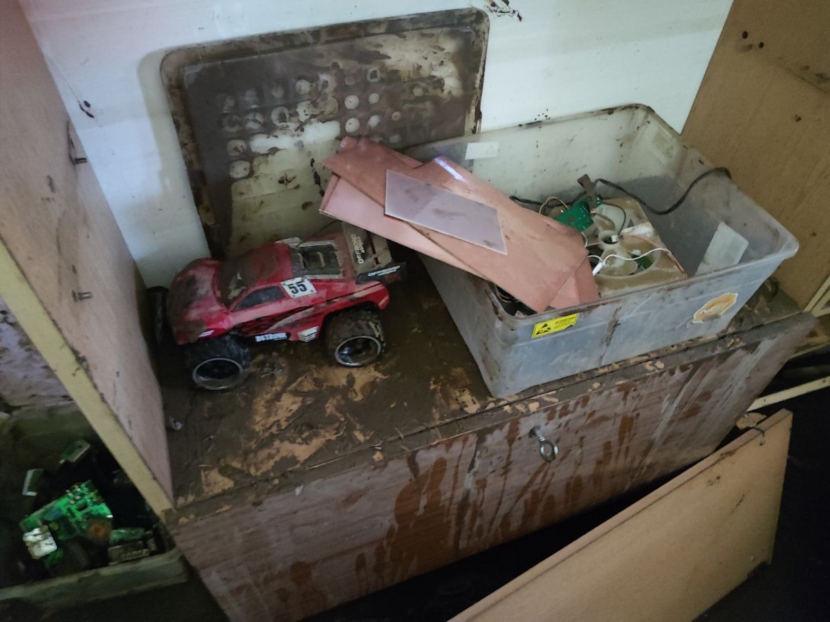

    This car also "went", and there were plans to convert it to RF 433 or ESP:
    A flooded room with damaged equipment, including a red toy car and a container full of electronic parts.

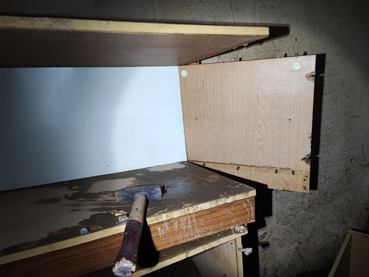

    Furniture deletion:
    Cabinet with damaged doors and a hammer on the shelf.

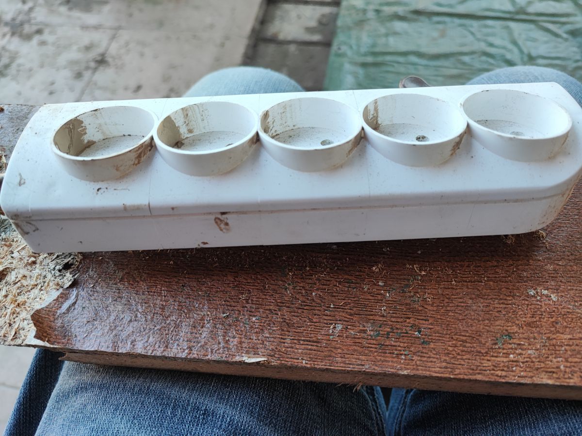

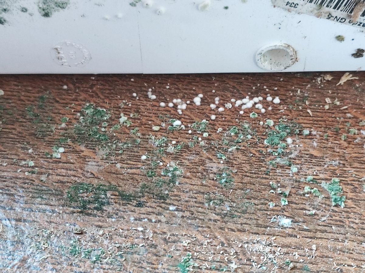

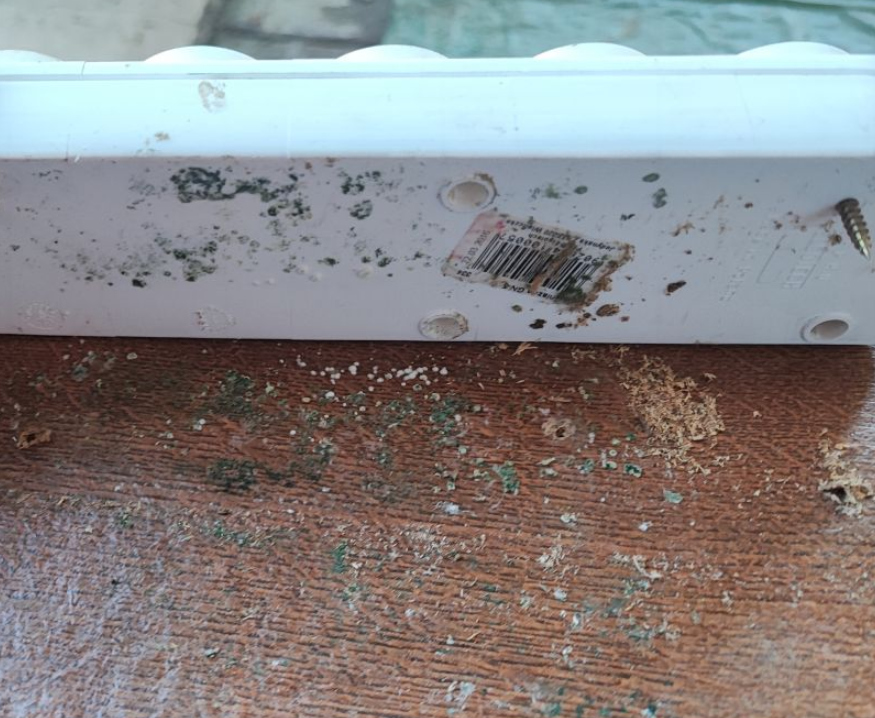

    So in general I have left very little stuff myself. Here, as if to back up my words, a photo from today - what is happening on the boards e.g. behind the extensions even though the water was only there for 6 hours:
    Power strip soiled with silt. Dirty power strip on a damaged wooden surface covered with mold. Close-up of a countertop covered with mold and dirt after a flood. .
    The sanitary hazard is as real as can be and this needs to be borne in mind with any experiments with flooded equipment.

    #30 21260490
    nostromo
    Posts: 89
    Rate: 23

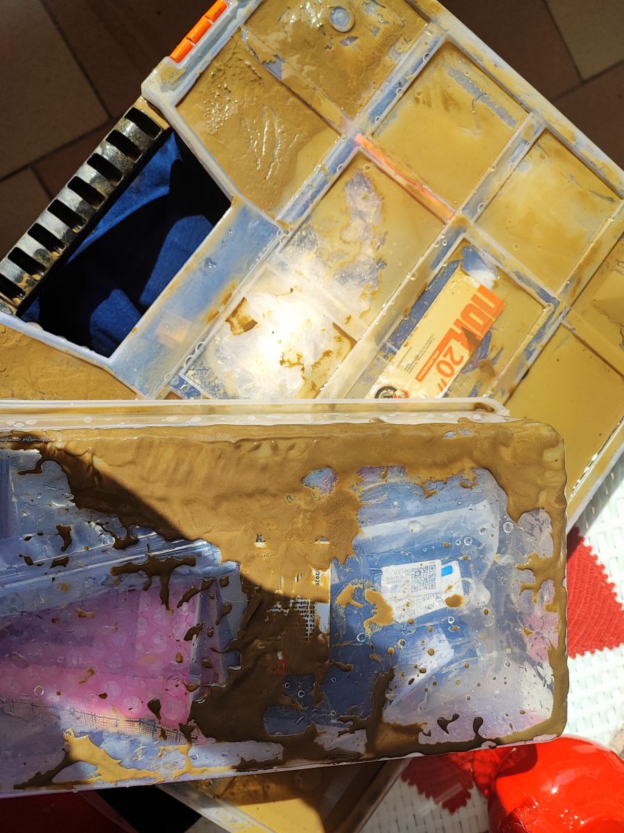

    Well done, I brought a Ferroli Divatech cooker, two Grundfos pumps, garage door and gate controls into service for flood victims I know. I used almost 3 litres of Isopropanol. A terribly stubborn job and time-consuming. But it had to be helped. The appliances were rescued, without too much trouble, as the power had been cut off before flooding. A colleague managed to salvage two TVs with LED matrices. I am waiting for some information on how the supply of these TVs went after the flooding. Respect to all those who are helping the flood victims.
    Added after 6 [minutes]: .
    >>21258428 You are right. A friend gave me some modules from a flooded car (battery not disconnected). Mogul. In several places, very thin tracks, they were simply digested.
    Added after 1 [minute]: .
