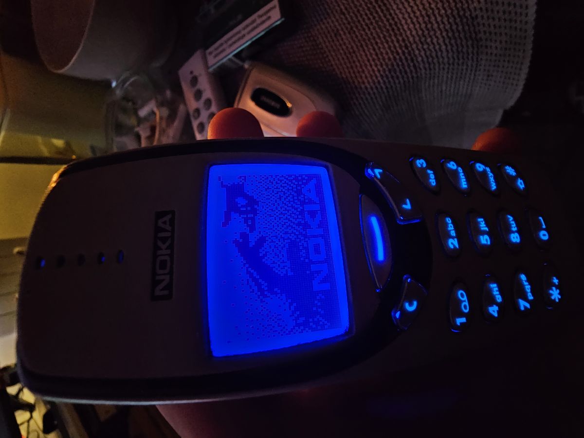

    I'll also brag - Nysa, basement flooded with sewage that has erupted from a sewer. Sewage level ~1m. The phone floated in this wonderful cesspit for over a week before it was pumped out and could be accessed normally. Then a wash under normal water with washing up liquid. Then a rinse in IPA and heating on an aluminium plate for 3 hours (~45 deg C - I put a simple ceramic resistor under the plate and heated it up). Where the motherboard was heated, sprayed several times with IPA and left to dry. Further left unheated until the next day. Then assembly and the result we have is this. Nokia 3310 phone with a blue backlit screen in a dark setting. .

    It's good that you got it up and running, but that sewage saves a phone like this?

    After all, this is the iconic Nokia 3310 😀 How dare you question the point of saving it....
    Modern smartphones wouldn't be worth saving but this is so much more than a phone...😀

    Help: 5

    I'll brag too - Nysa, basement flooded with sewage that spewed out of a sewer. Sewage level ~1m. The phone floated in this wonderful cesspit for over a week before it was pumped out and could be entered normally. Then a wash under normal water with washing up liquid. Then a rinse in IPA and heating on an aluminium plate for 3 hours (~45 deg C - I put a simple ceramic resistor under the plate and heated it up). Where the motherboard was heated, sprayed several times with IPA and left to dry. Further left unheated until the next day. Then assembly and the result we have is this. Nokia 3310 phone with a blue backlit screen in a dark setting.
    You could have put the phone in your pocket beforehand and that's it, I don't think you were swimming in sewage so why did you leave the phone in it???.

    >>21269060 .
    The phone had been lying in the basement for years, nobody remembered it. And since it flooded the neighbourhood and basements on the estate in about 30 minutes, the essentials were saved, no one took care of the small stuff. Of course I could have blown it in the bucket, but just for fun I tried the rescue and it went 😊.
