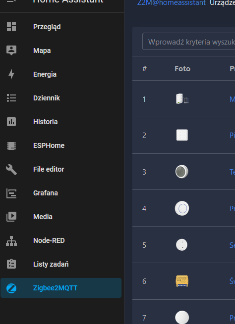

    Well it's better, but still not ideal:

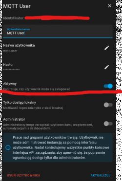

    hkielp745
    Posts: 43
    I already have an ember.
  • #34 21274430

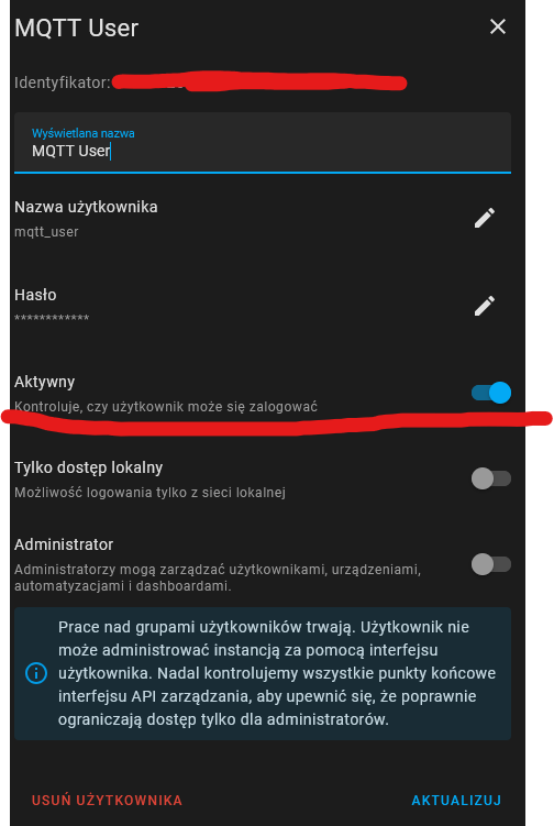

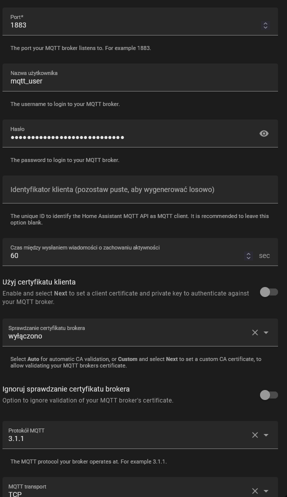

  • MQTT authorization failure blocks Zigbee2MQTT startup
    #35 21274435
    hkielp745
    Posts: 43
    From the ezsp something like this:
    [19] INFO: Preparing to start...
    [19] INFO: Socat not enabled
    [19] INFO: Starting Zigbee2MQTT...
    Starting Zigbee2MQTT without watchdog.
    [2024-10-23 19] info: z2m: Logging to console, file (filename: log.log).
    [2024-10-23 19] info: z2m: Starting Zigbee2MQTT version 1.40.2 (commit #unknown)
    [2024-10-23 19] info: z2m: Starting zigbee-herdsman (2.1.3)
    [2024-10-23 19] warning: zh:ezsp: 'ezsp' driver is deprecated and will only remain to provide support for older firmware (pre 7.4.x). Migration to 'ember' is recommended. If using Zigbee2MQTT see https://github.com/Koenkk/zigbee2mqtt/discussions/21462
    [2024-10-23 19] info: z2m: zigbee-herdsman started (resumed)
    [2024-10-23 19] info: z2m: Coordinator firmware version: '{"meta":{"maintrel": "3 ", "majorrel": "6", "minorrel": "10", "product":8, "revision": "6.10.3.0 build 297"}, "type": "EZSP v8"}'
    [2024-10-23 19] info: z2m: Currently 0 devices are joined.
    [2024-10-23 19] info: z2m: Zigbee: disabling joining new devices.
    [2024-10-23 19] info: z2m: Connecting to MQTT server at mqtt://core-mosquitto:1883
    [2024-10-23 19] error: z2m: MQTT error: Connection refused: Not authorized
    [2024-10-23 19] error: z2m: MQTT failed to connect, exiting... (Connection refused: Not authorized)
    [2024-10-23 19] info: z2m: Stopping zigbee-herdsman...
    [2024-10-23 19] info: zh:controller: Wrote coordinator backup to '/config/zigbee2mqtt/coordinator_backup.json'.
    [2024-10-23 19] info: z2m: Stopped zigbee-herdsman
    Added after 37 [seconds]: .
    And how do you do such a thing?

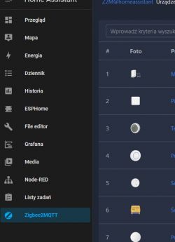

    hkielp745
    Posts: 43
    I only have 502: Bad Gateway.
  • #38 21274449
  • #39 21274452

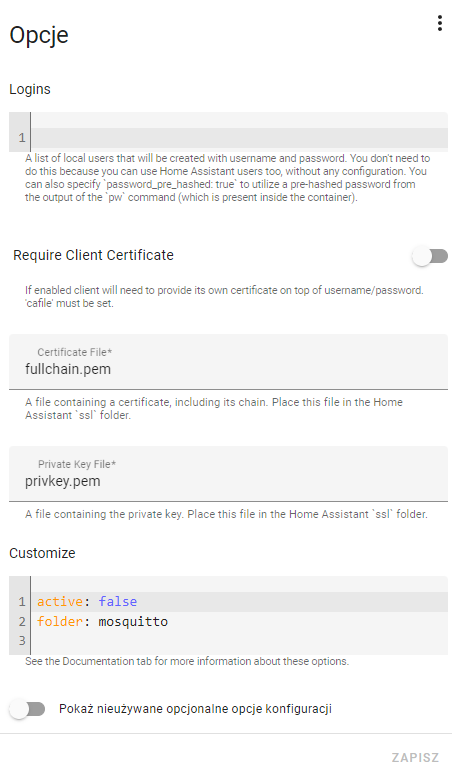

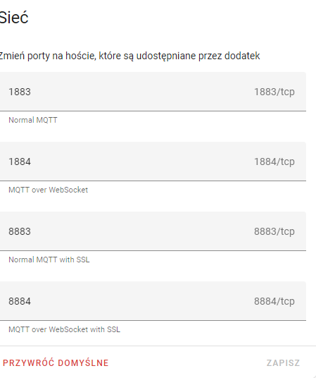

    hkielp745
    Posts: 43
    I didn't move Mosquitto Broker as it was so.
  • #40 21274473

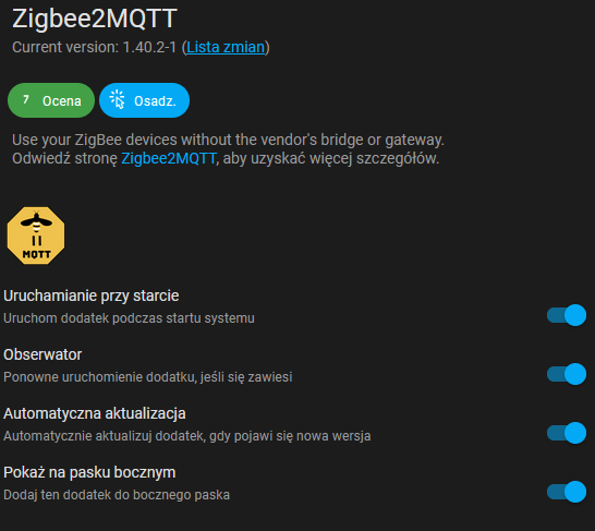

    hkielp745
    Posts: 43
    I have not ezsp changed to ember.
  • #44 21274501

    hkielp745
    Posts: 43
    In mqtt I have these logs:
    2024-10-23 20:26:12: New connection from 172.30.32.2:43624 on port 1883.
    2024-10-23 20:26:12: Client <unknown> closed its connection.
    2024-10-23 20:26:30: New connection from 172.30.33.2:39126 on port 1883.
    2024-10-23 20:26:30: Client mqttjs_eb6a6824 disconnected, not authorised.
  • #46 21274517

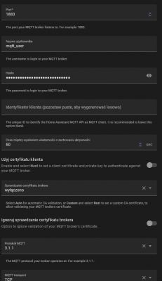

    hkielp745
    Posts: 43
    Well, I have
  • MQTT reconfigure and HA reload steps
    #50 21274531
  • #51 21274559
    hkielp745
    Posts: 43
    HA has on Dell Wyse 3040 Thin Client Atom x5-z8350
    Added after 7 [minutes]:
    But it still doesn't work.
